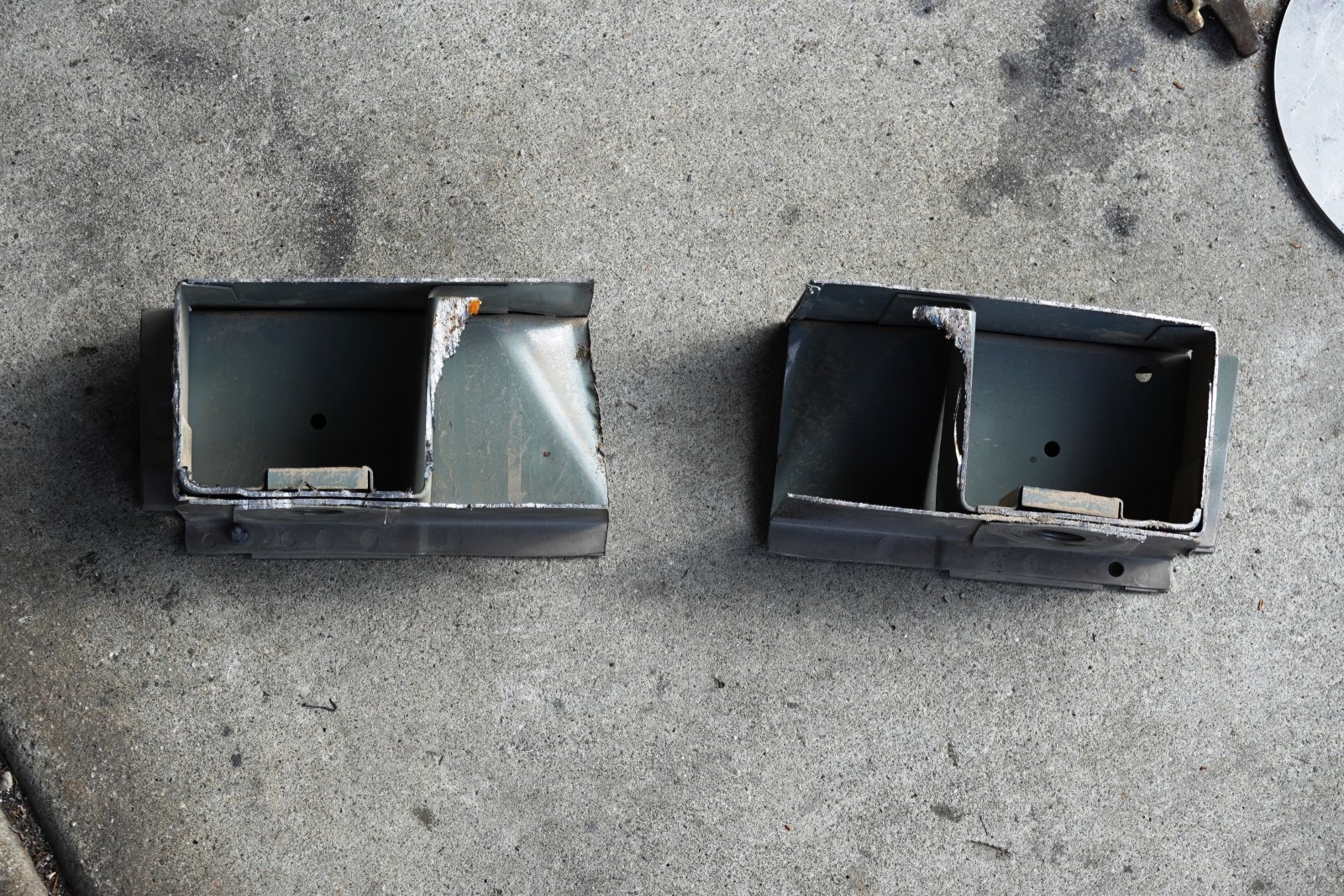

Lots don't know what the inside of the ends of the torque box look like over the rear body mounts.

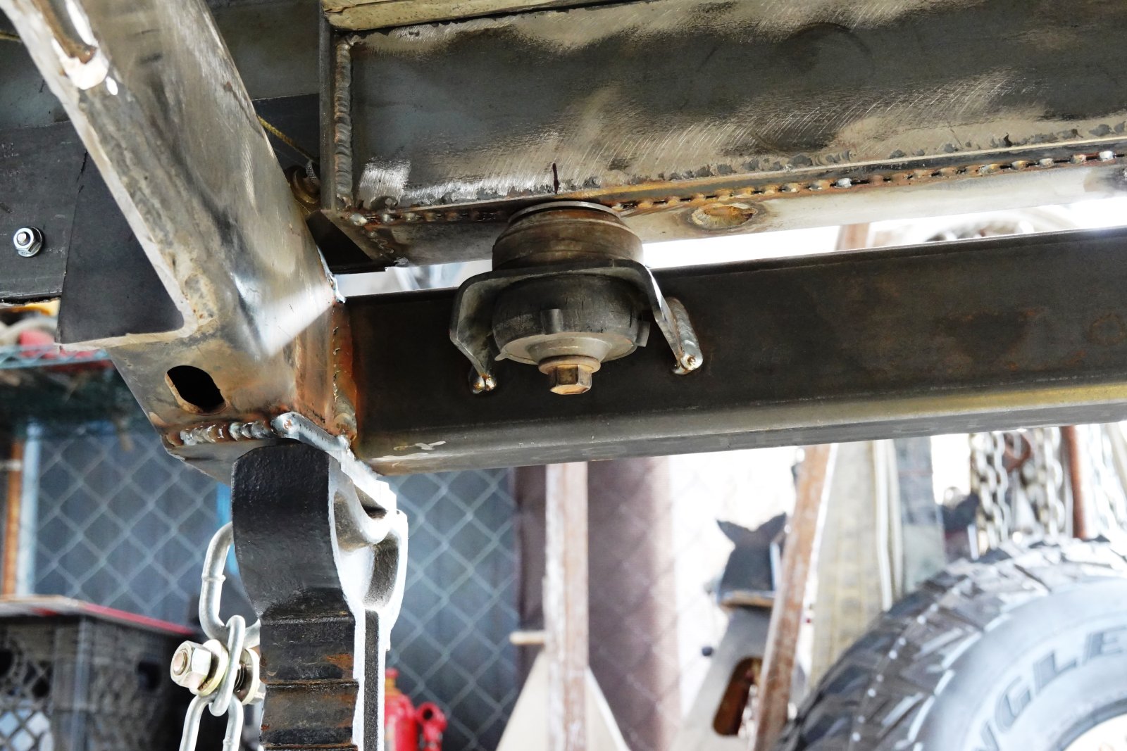

the torque box is not super stout so it needs a bolster (a shim) between the body mount and the body to disperse load. i also put nut plates in there to catch those body mount bolts and disperse that pinch/clamp load.
My body mounts I mentioned- I used the mounts from under the doors since they use a 1/2-13 bolt and I have nutserts for that.

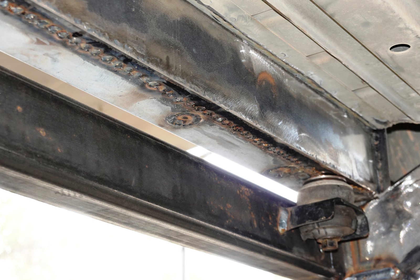

You can see the lap plate that goes from the capped cut on the frame rail across the bottom of the rear crossmember to add another tie in point.
Stitch welding of the lower sheet metal onto the new torque box.

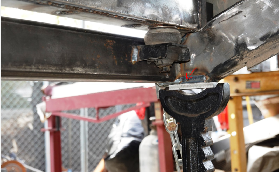

i like your rear body mounts a bit better than what i ended with, mine are more visible from the back end than i'd like. i kept the cross member under the torque box so the finished bumper only sticks back about 1/2 off the tub. it works but it could have been tighter and neater.

If you get the angle just right, this is what you see from the View attachment 319772rear or will when the server wakes up and lets the images load.

Looking mostly down on the rear crossmember.
