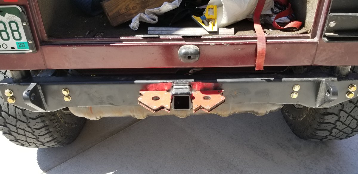

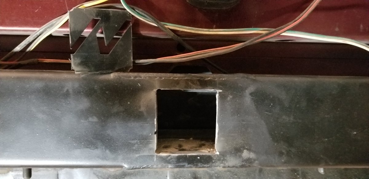

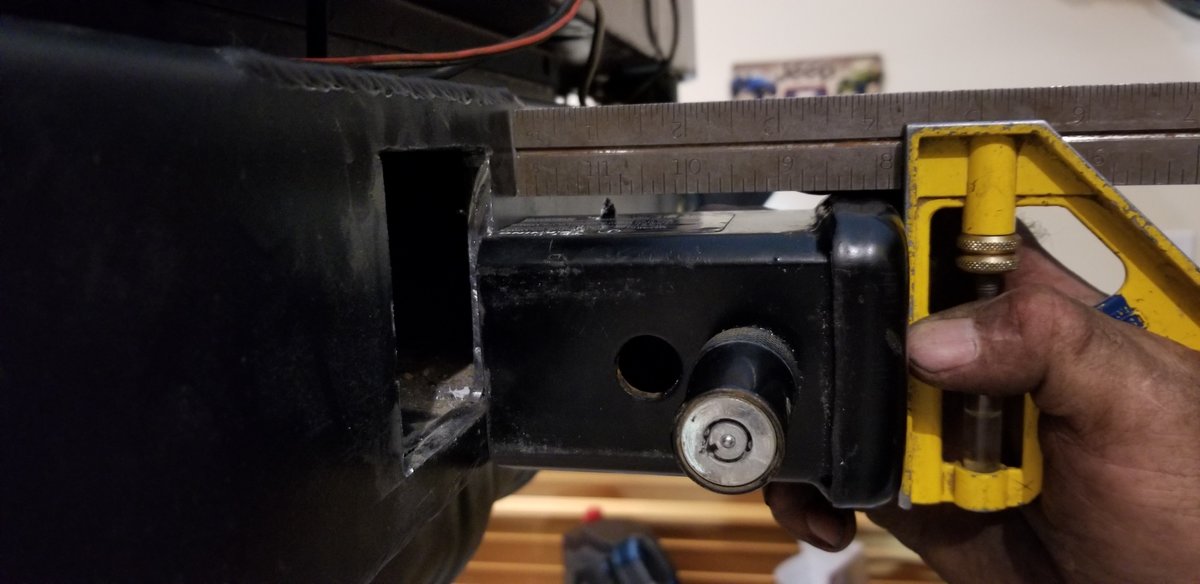

The rear bumper got a recessed hitch receiver.
A surface mount sticks out this far.

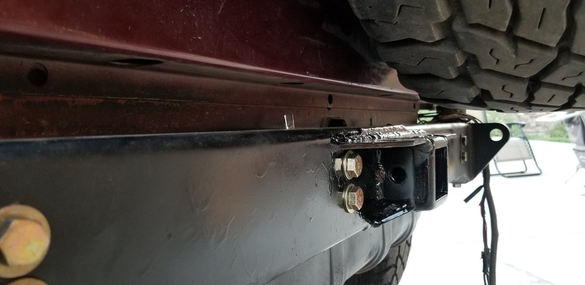

Mine goes back to the back lip of the frame crossmember. The receiver protrudes 2.25". I could have gone another quarter inch, but I didn't have it in me too drop the gas tank for that last little bit.

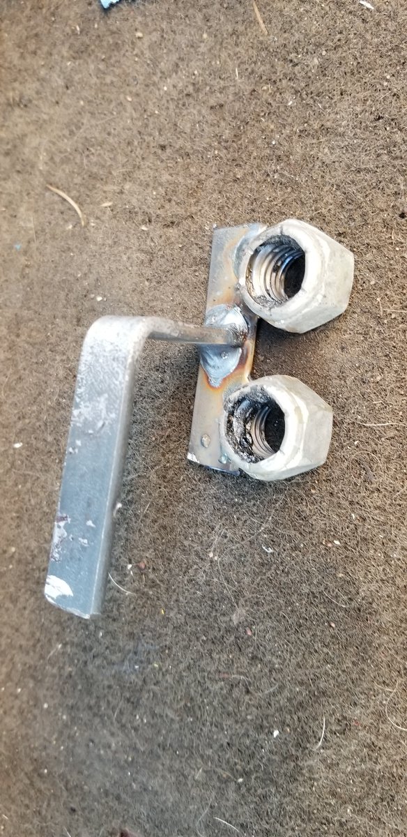

Two pairs of bolts surround the receiver to attach the bumper to the crossmember. I needed a pair I flag nuts because there is no room to reach in behind. All I had on hand were nylock nuts that no longer lock.
The safety chain tabs sit on top and act as a gusset. There is a smaller gusset on the bottom that is also a ramp

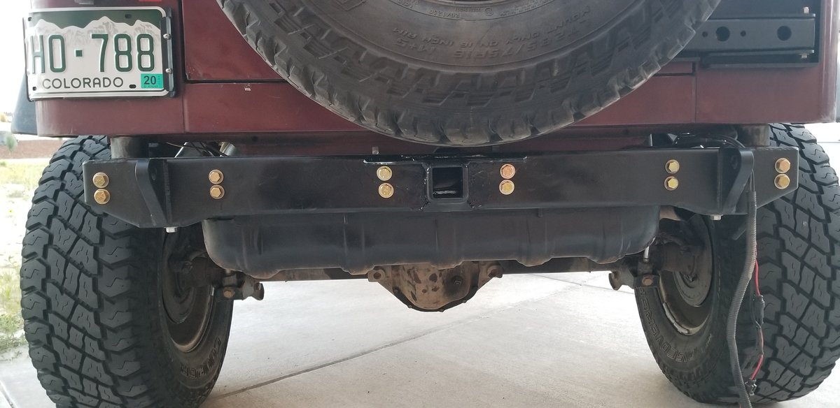

One thing Josh did that i still need to is adding a few more bolts around the receiver itself. There's pics somewhere in this thread....

Yeah I did see that, I do plan on doing that too. My lazy ass never finished putting in all the bolts for the bumper to begin with lol (didn't realize they weren't holes for looks).
It's all on page 70 FWIW. I've been looking at it a lot this week lol

I don't know that I'd tow with it. I installed it mainly for a recovery point and a place to install my bike rack. Because its so tucked up under the tire (I still carry it "on" the tailgate) you'd need a really long hitch. I need an extension for my bike rack.
I also installed a few extra bolts...
