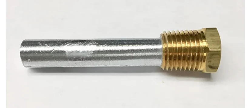

I have a zinc anode screwed into my radiator as well. The aluminum heads, radiator and heater core coupled with the iron block makes for a corrosive environment. The zinc anode makes a nice sacrificial lamb…

Where/how did you install the zinc anode.??
I unscrewed my drain and installed the anode. 1/4” npt for both. I measured the depth of the hole to the core first and made sure the anode wasn’t too long. Didn’t feel like driving it into my radiator core, lol…
https://www.amazon.com/gp/aw/d/B001QV1CF4?ref=ppx_pt2_mob_b_prod_image
If a person really stays on top of the flush and fill of the coolant it’s not quite as big of a deal, but I didn’t want to take a chance…

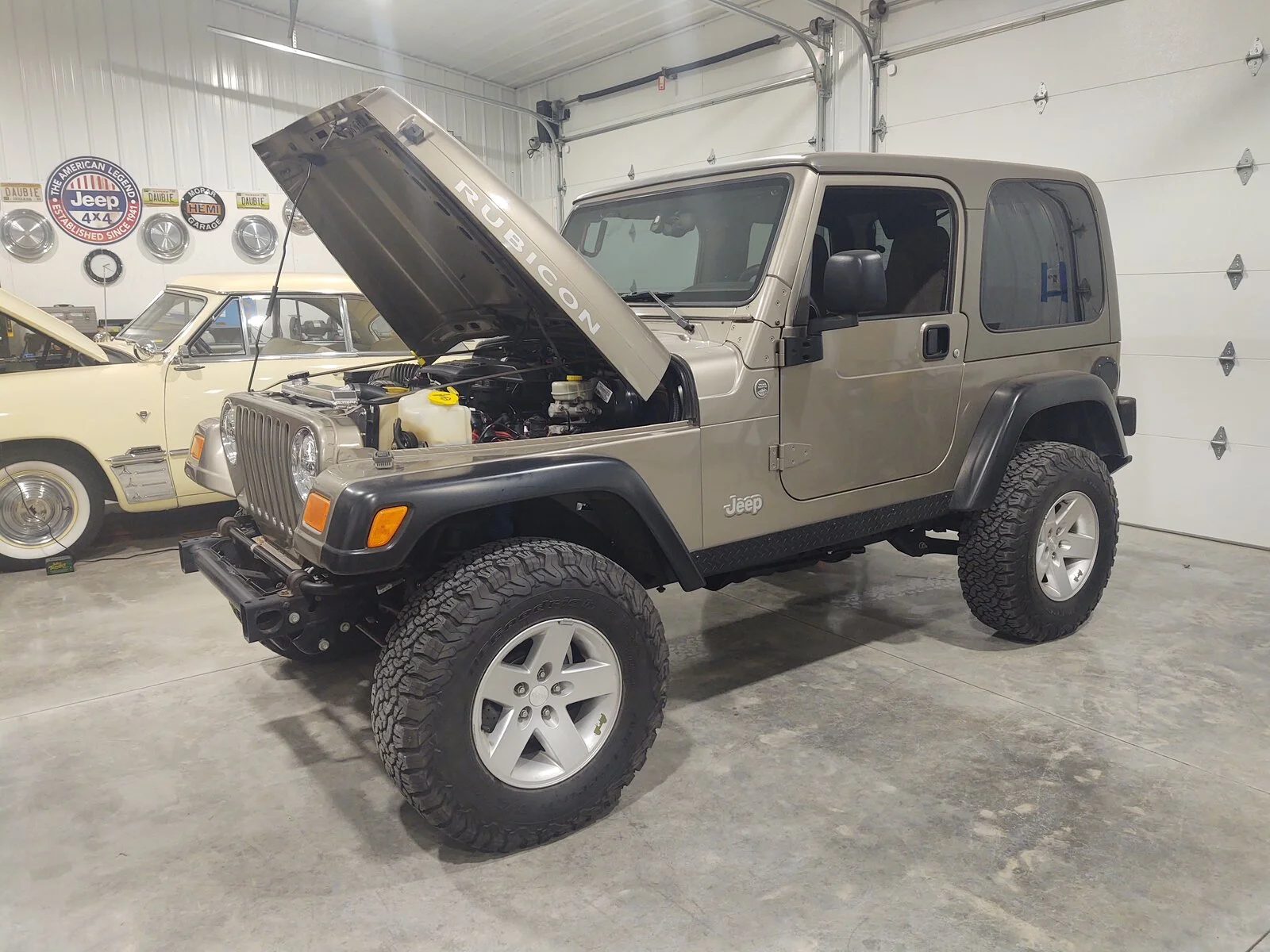

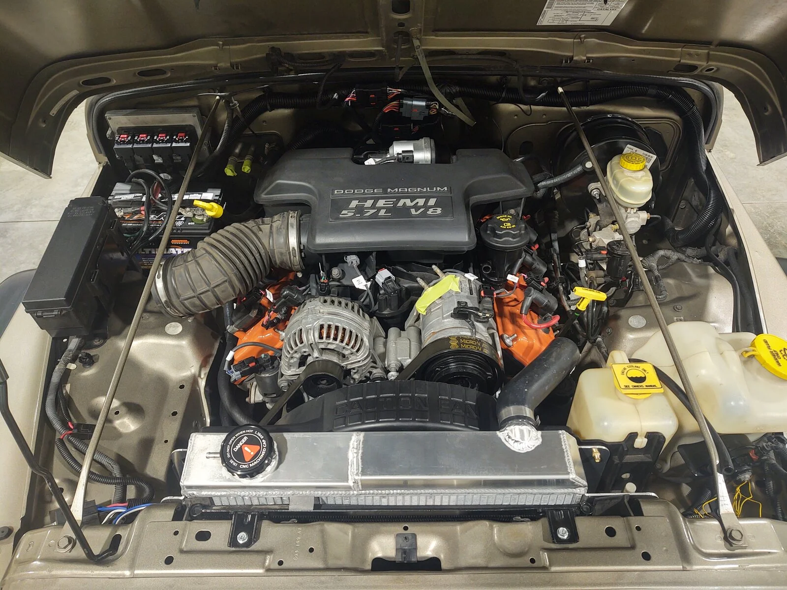

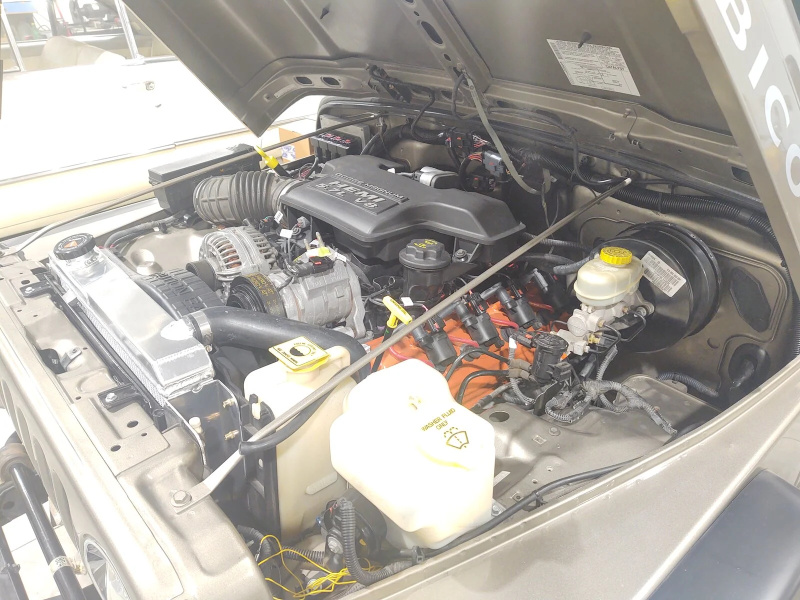

Had some time yesterday (Saturday) to get some work done.
Got both of the shifter brackets and linkages modified and hooked up and put the front driveshaft on.
Installed the body mount bolts.
E Brake cables installed.
Heater hoses put on.
Installed a zinc anode in the radiator drain location and filled radiator with coolant.

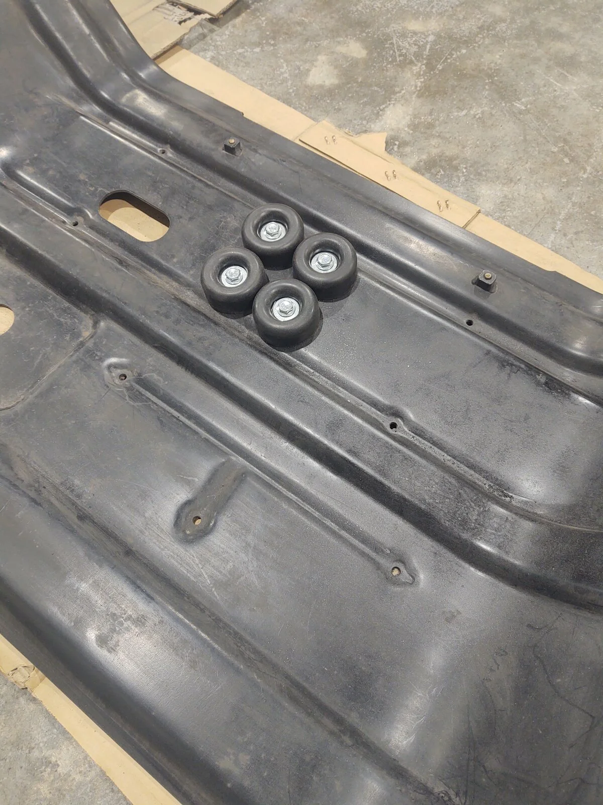

Put the belly skid back on with these rubber bumpers that sit about a 1/2" below the transmission crossmember just as a safety device in case the crossmember were to fail.
They are trailer ramp door bumpers.
So it was ready to start it let it get up to temp and check for any fluid leaks. Took a while to get up to temp but no leaks.
Today (Sunday)
Let it get up to temp again, looked good. So figured now was as good a time as any to see if it'll move. It does, took a short drive to the gas station to get some more gas.
Well, it did ok......
The idle seems low to me and it doesn't rev very fast at all and seems like it is choked down or restricted somehow. Even in park with no load it is slow to rev and when in gear it really bogs down.
No more time this weekend to try to start sorting that out.
I don't have any CEL codes showing.
Took a little time and picked up a few messes in the shop and moved the Jeep about of the lift bay.
Any input or ideas?

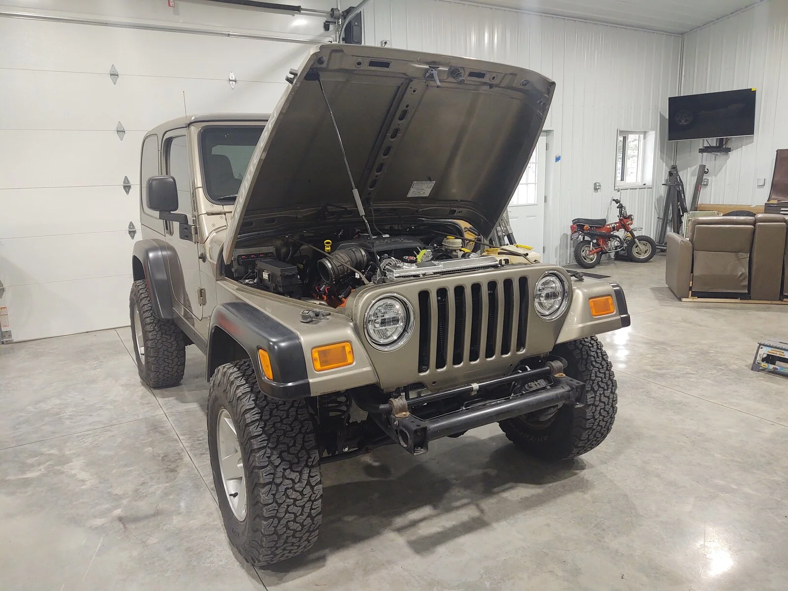

Here are some gratuitous pics..
Obviously there are still a few things left to do but pretty happy at the stage it's at.

Old Honda trail 70 it looks like in the back, cool little bike. Jeep is coming along great, going to be a blast to drive.
Had to work this Saturday so didn't have a lot of time to sort the low power issue, but my Buddy brought his Snap-On scanner over for me to borrow.
On the engine running lame issues.
I ran a full scan on the Snap On scanner and no codes or errors.
I pulled the muffler and tailpipe off to be sure wasn't somehow choked down, no difference. Was a suggestion by a mechanic friend just to help diagnose.
I unplugged all the engine and O2 sensors one at a time like was also suggested and made no difference.
I then went old school and started pulling coil signal wires one at a time and discovered this odd condition that is in this video.
Check this out,
I have a 4 cylinder HEMI..
https://photos.app.goo.gl/PFDNyZ9ZnRYVHfid6
It was only running on 4 cylinders, 3 on the left bank and 1 on the right bank. Cylinders 2, 3, 4 and 6 not firing. Can't believe it was running and driving at all, especially not throwing any codes.
I don't show in the video but I took an extra plug wire and plug and checked each cylinder and had spark in all 8.
So I figure it has to be fuel. I pulled the fuel rails and injectors and the 4 that matched up with the dead cylinders would not click when I bench tested them. I still have the injectors I took out of the engine when I got it, bench tested and sprayed cleaner through them, put them in and runs like it should.!! I'll also include that video.
So much better when all 8 are hitting...
https://photos.app.goo.gl/bKCsuuWAFZTPTgaUA
Put the exhaust back on and took it for a drive. WOW, what a difference
Drove it a few miles and everything seemed pretty good, then on my way home (just had to do it) I stood on it WOT and the instant I did that I got the CEL on and went into limp mode. I got 6 codes, 3 for the TB, P0121, P0123, P0223 and 3 for the accelerator pedal, P2101, P2110, P2135. Limped home cleared the codes and was out of time for the day.
Yesterday I took it out for another drive seemed to run very strong and perform as it should but I never went full throttle and didn't have any issues.
I may have an issue with the drive by wire not being fully synced between the TB and pedal at this time and need to look into that after i put a few more close to home test miles on it and see if it might self learn/adjust.
