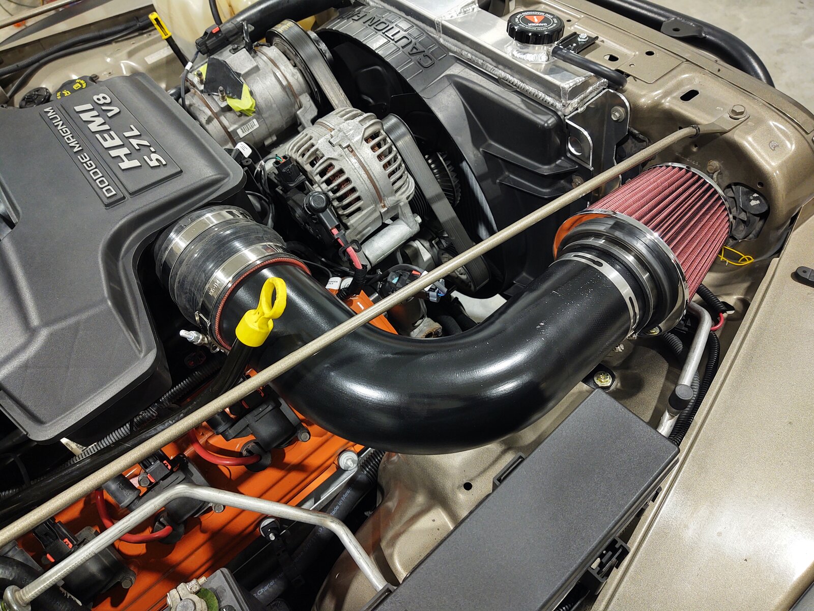

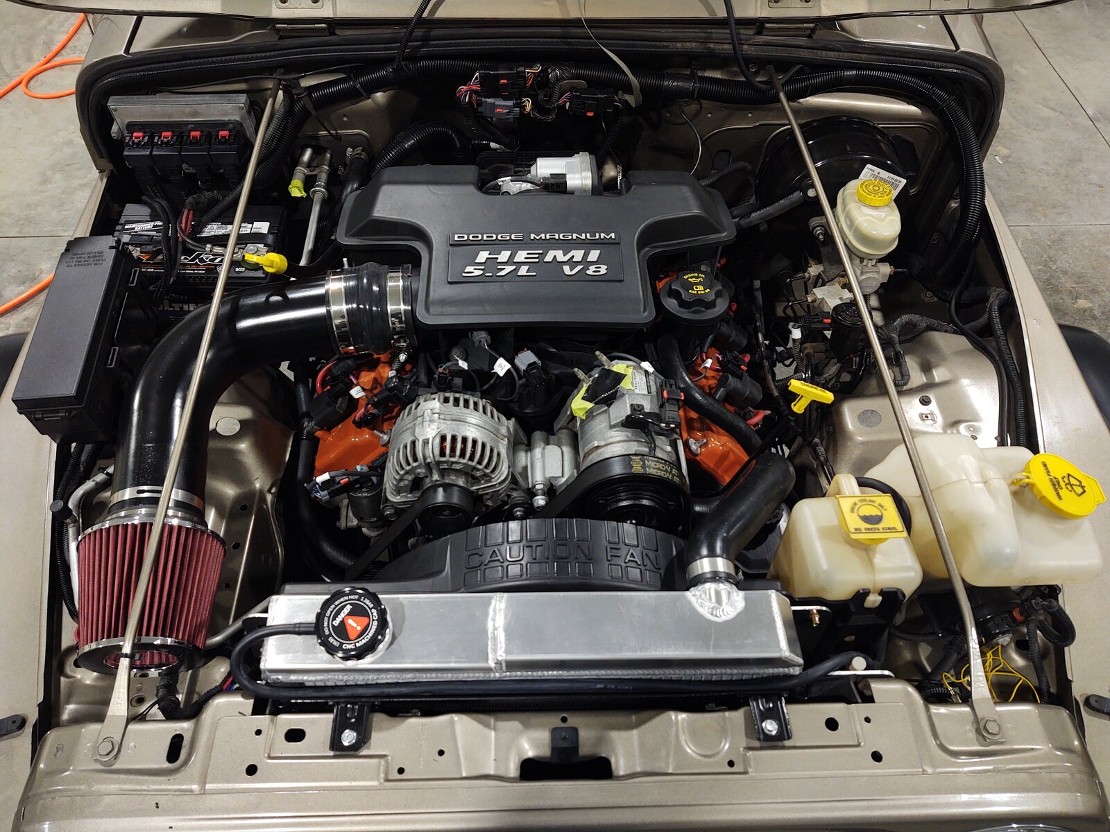

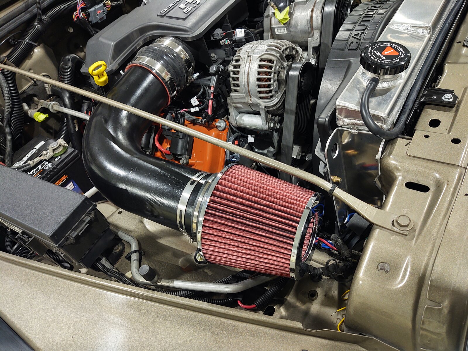

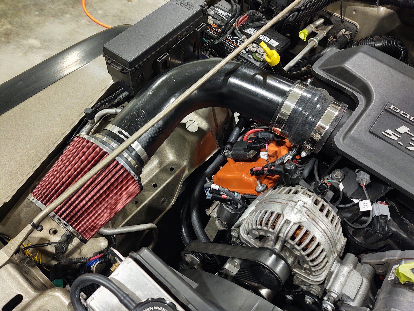

Got the rest of the pieces yesterday to make my air intake.
It's 4" mandrel bent stainless steel tubing. Ought to breath ok..
I put the filter element just forward of the fan blast hoping it'll catch a little cooler air. I'll watch the IAT and see if I'll need to fab a heat shield for the filter.

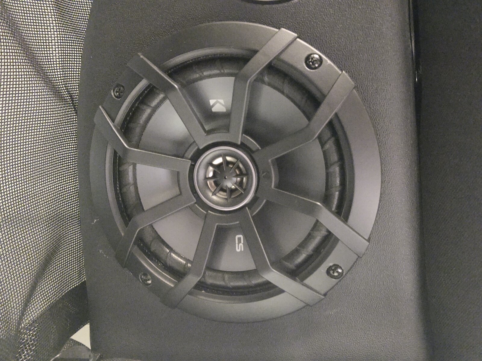

Not any performance things today, but I did change out all the old speakers for Kickers.
5 1/4 in the dash, 6 1/2 in the overhead and 6 3/4 sub woofer in the console. Head unit and amp still factory. Made a huge difference. Won't win any system contests, but nice improvement for the money and effort. I did put poly fil in all the enclosures which always helps on the low end.. I also had to add 2 screws to the side of the console above the sub woofer to keep it from buzzing real bad with the new sub.

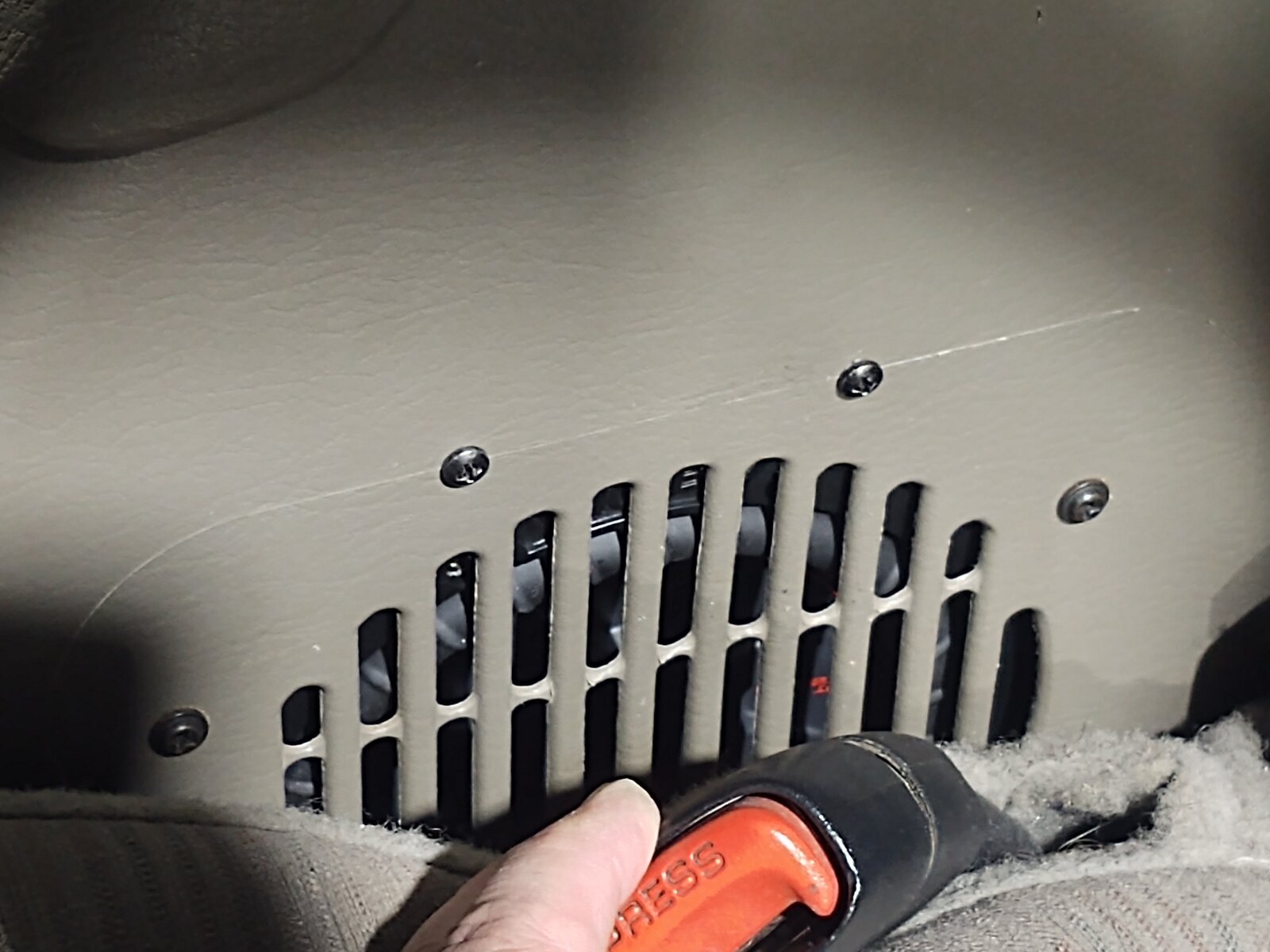

I’ve been thinking about trimming the factory grill out of there. I’m running the same speaker, and I’m pretty sure the surround is hitting the plastic. I haven’t been able to find anything to replace it with, though, that also won’t interfere with the seatbelt.

I really don't think that the surround is hitting the grill on mine. I initially thought that was the problem, but on close inspection it doesn't appear to. When I pushed the area above the grill against the sub box the buzz completely went away, so that is why I added the 2 extra screws. You might check yours and see if you might have the same thing going on..
