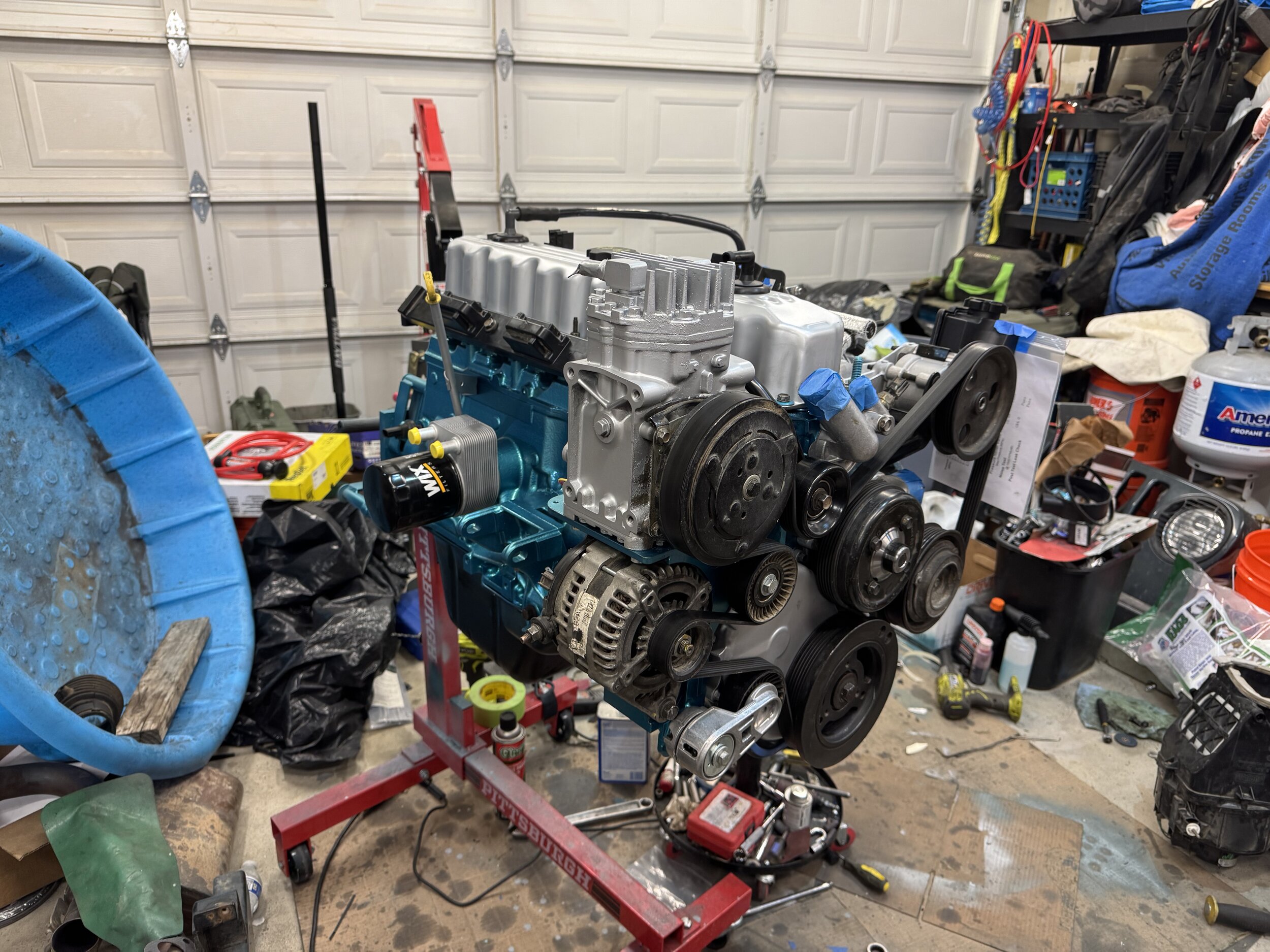

Engine is fully assembled!

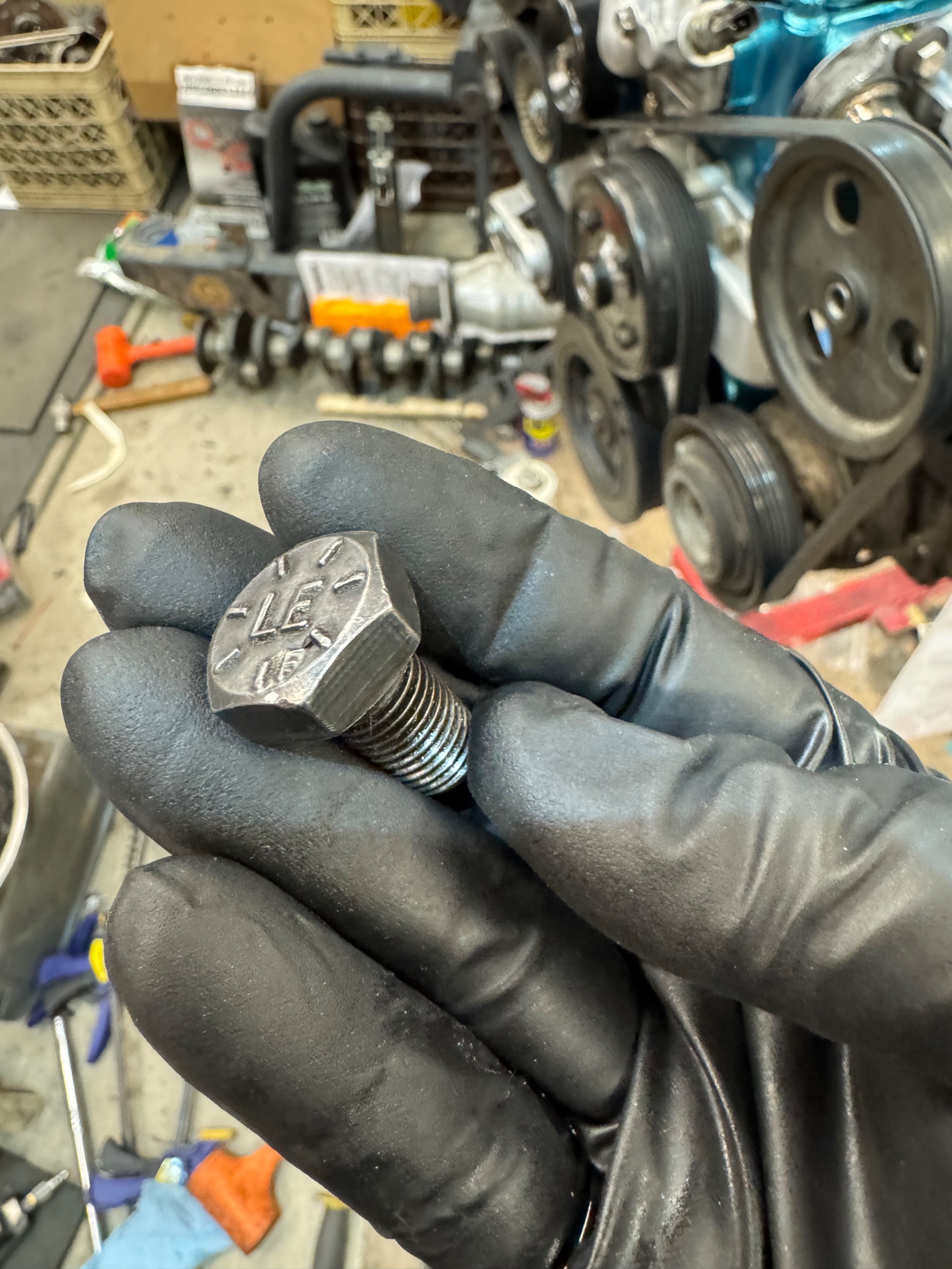

Found this bolt. Smells like it was internal, but doesn’t fit the old camshaft, so that’s not where it’s from. Any ideas?
im in the middle of doing a 5.0l stroker kit on mine and i didn't see any bolts that looked similar to that when I stripped mine. I'd assume possible crank pulley bolt, flywheel bolt, motor mount or other accessories?
Crank pulley bolt is installed, motor mounts are coarse thread, and all six flywheel bolts are accounted for
Engine to transmission bolts? Dust shields on transmission? What about timing cover bolts? I recall seeing 2 weird ones on mine when I took it apart, however mines 04

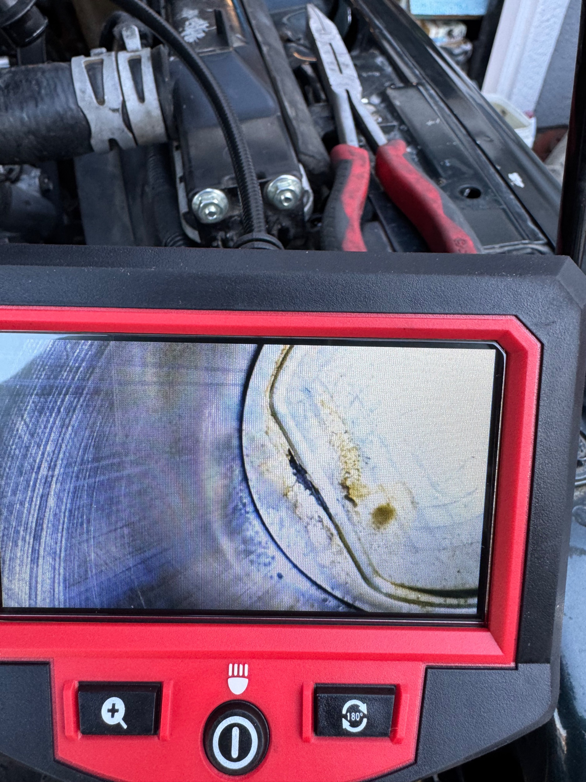

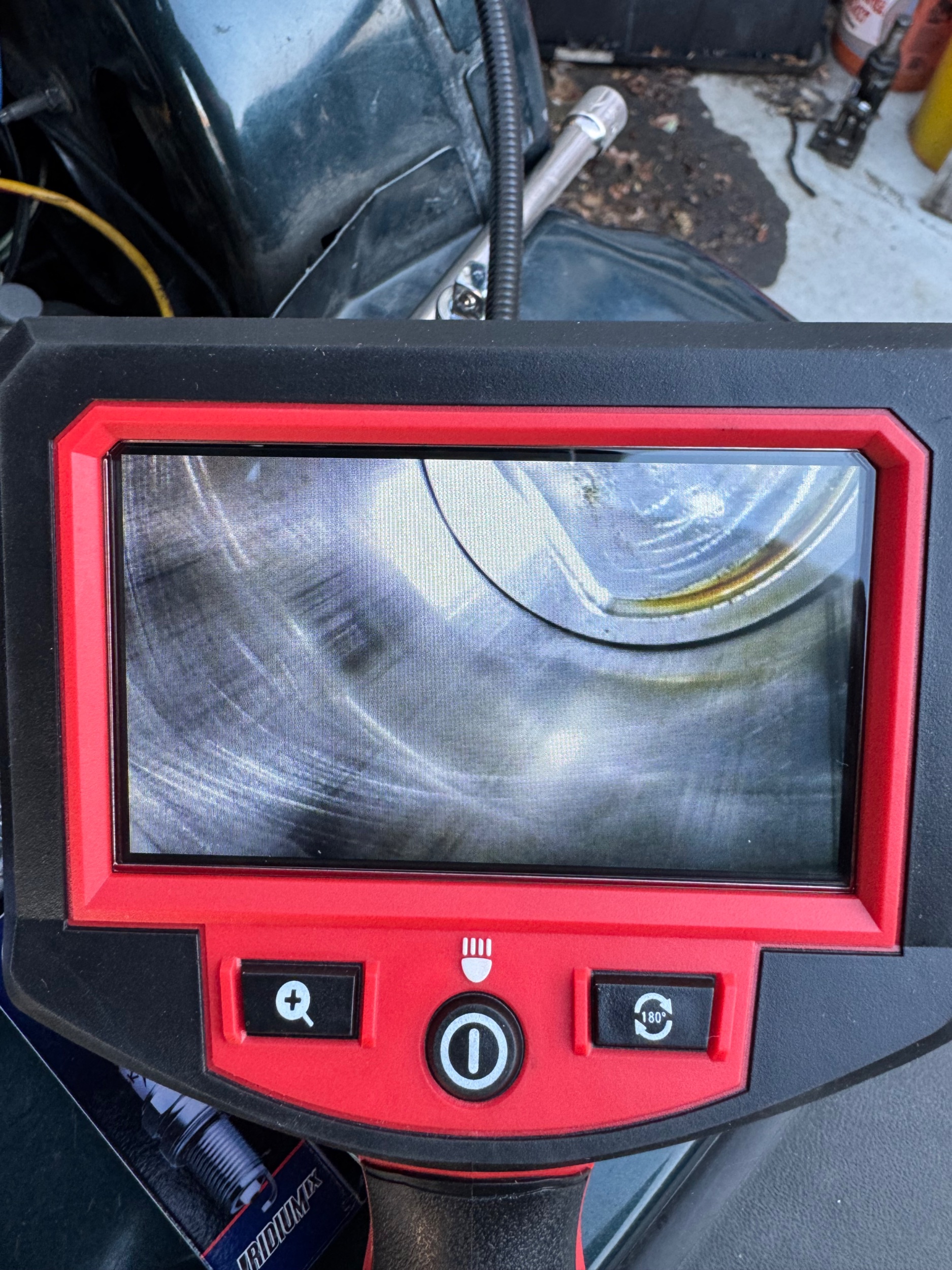

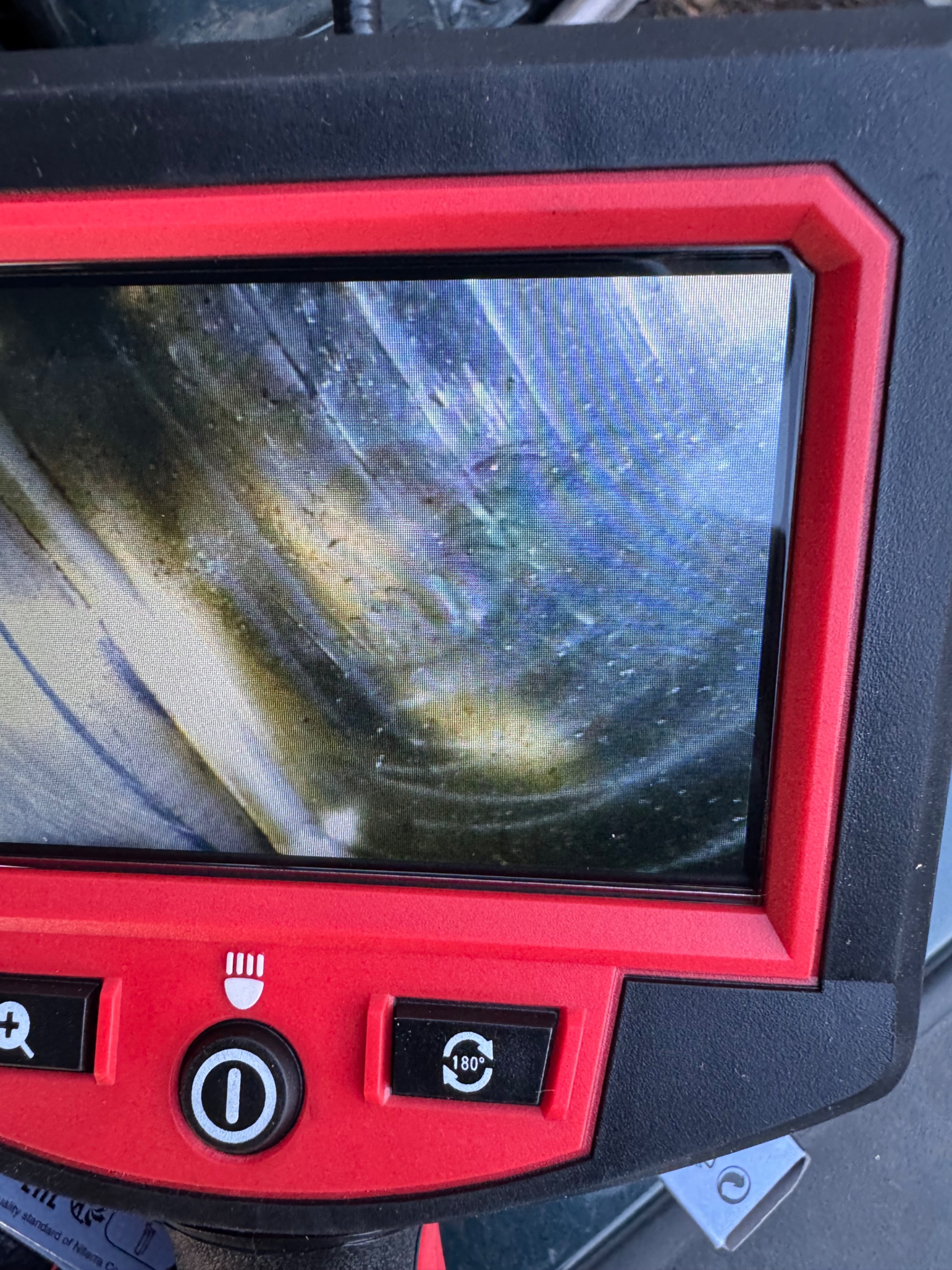

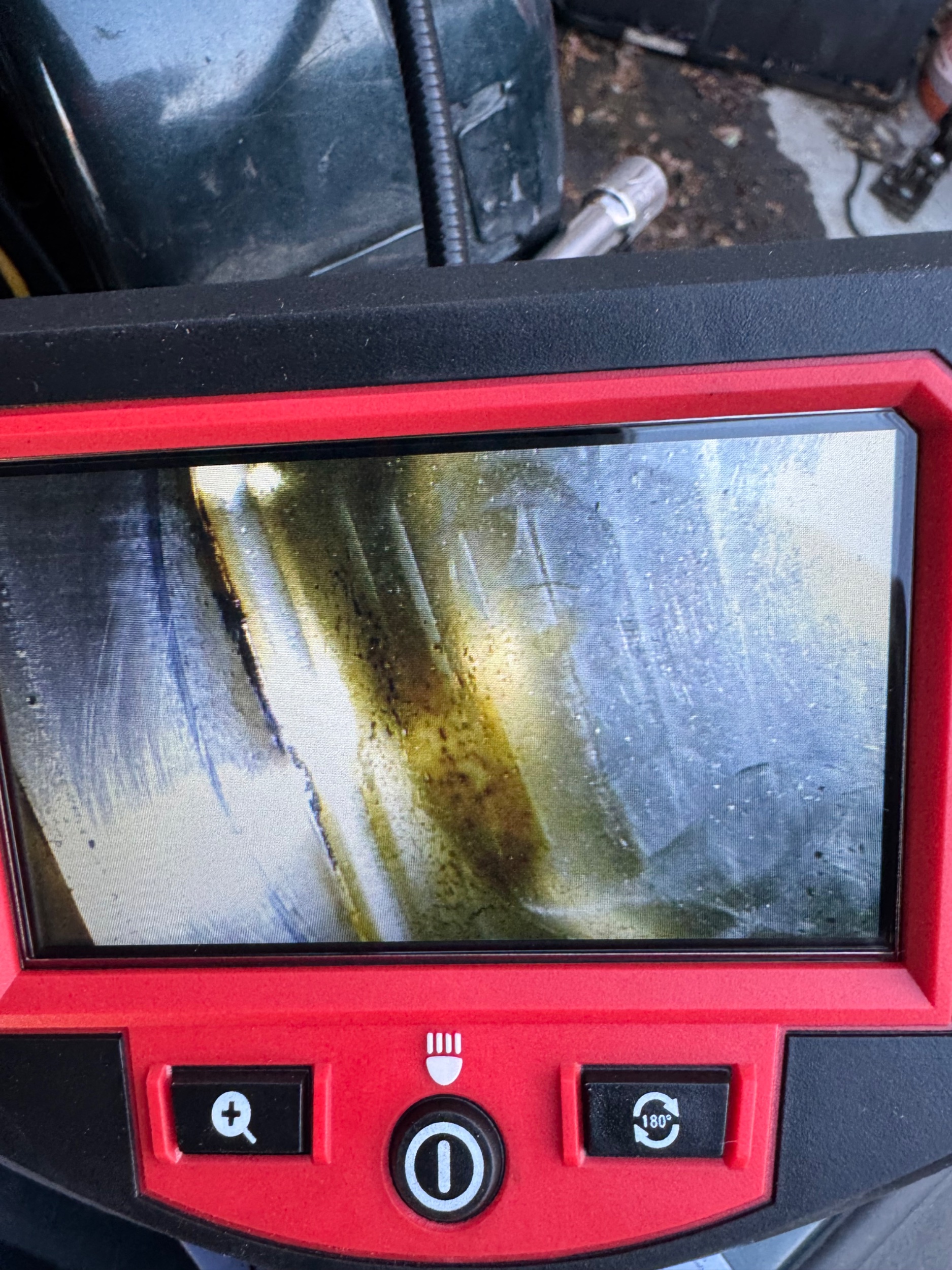

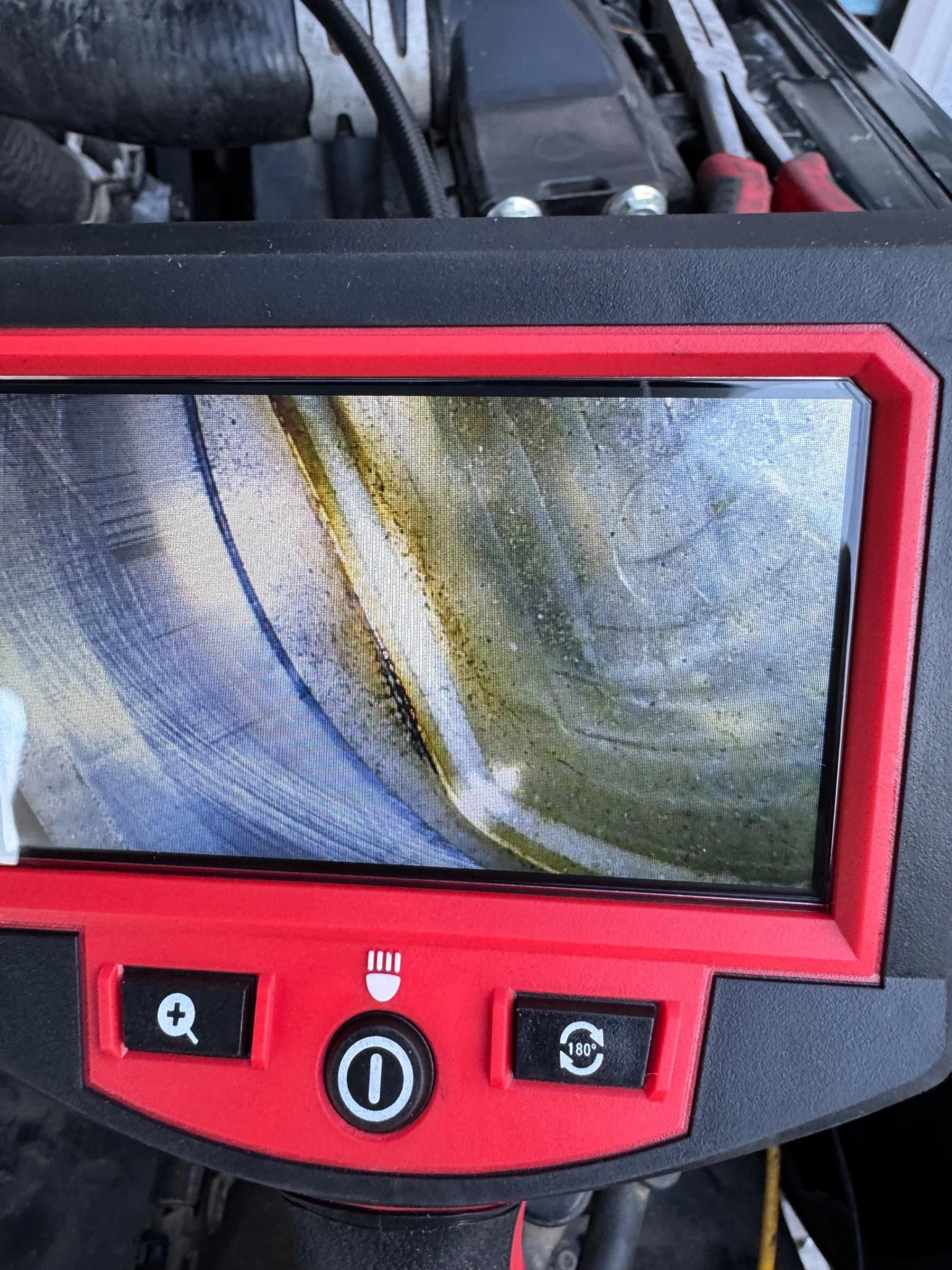

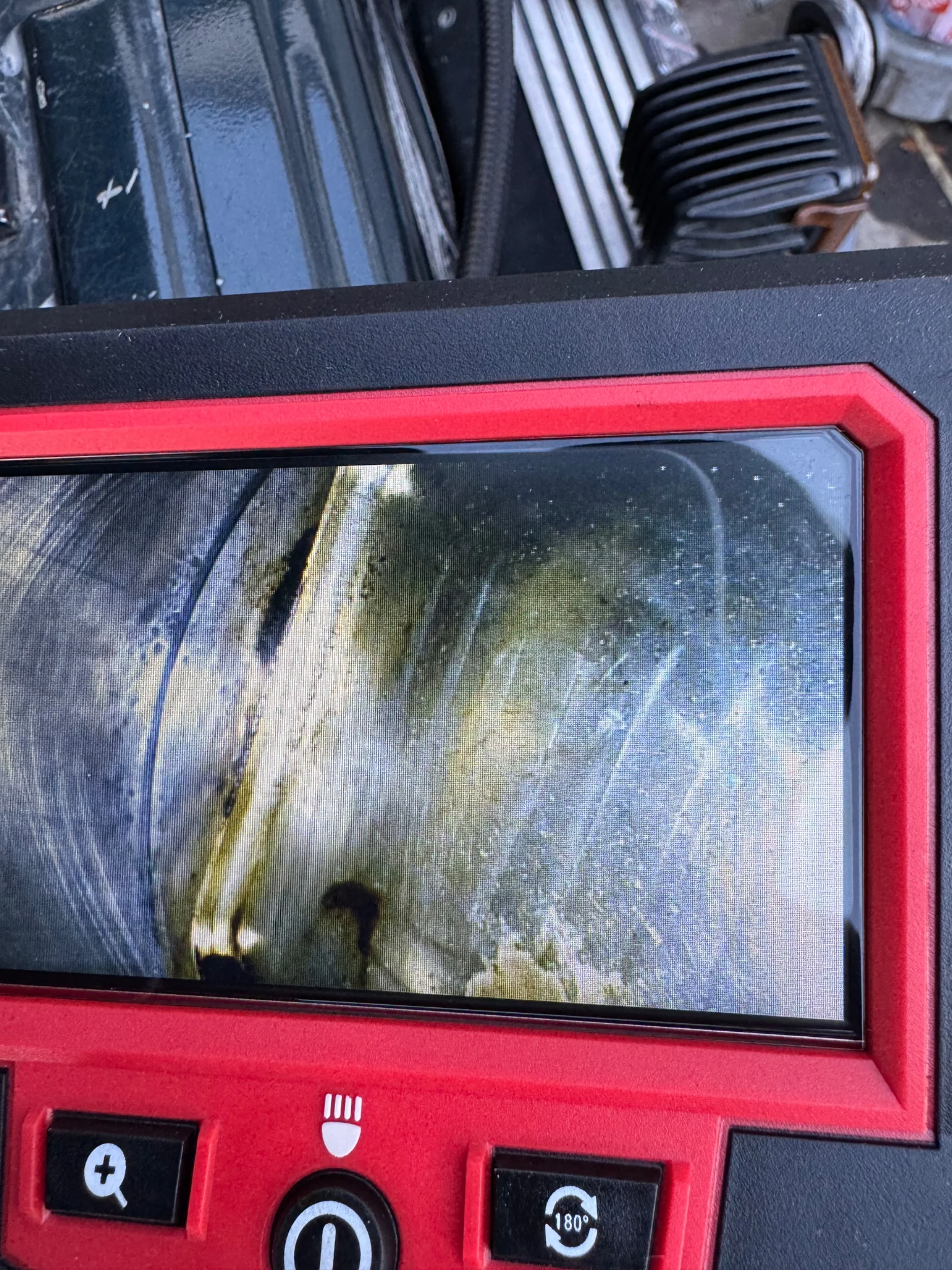

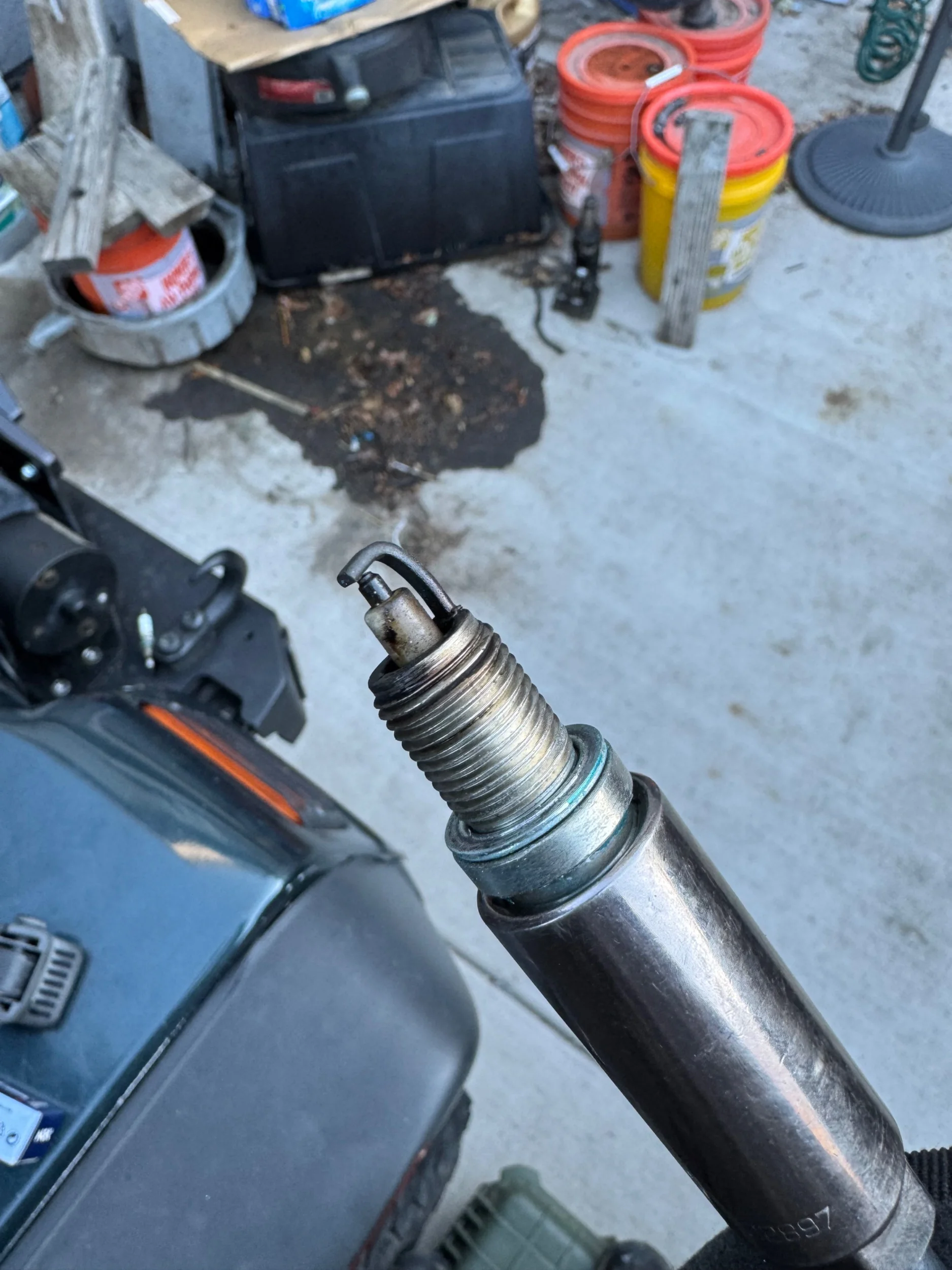

Weird residue on #2 plug. Oil or water? Scoped all six cylinders. Looks like a little bit of oil or water sitting on top of each piston?
