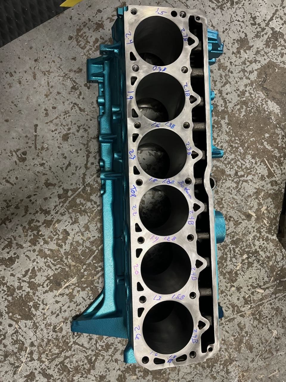

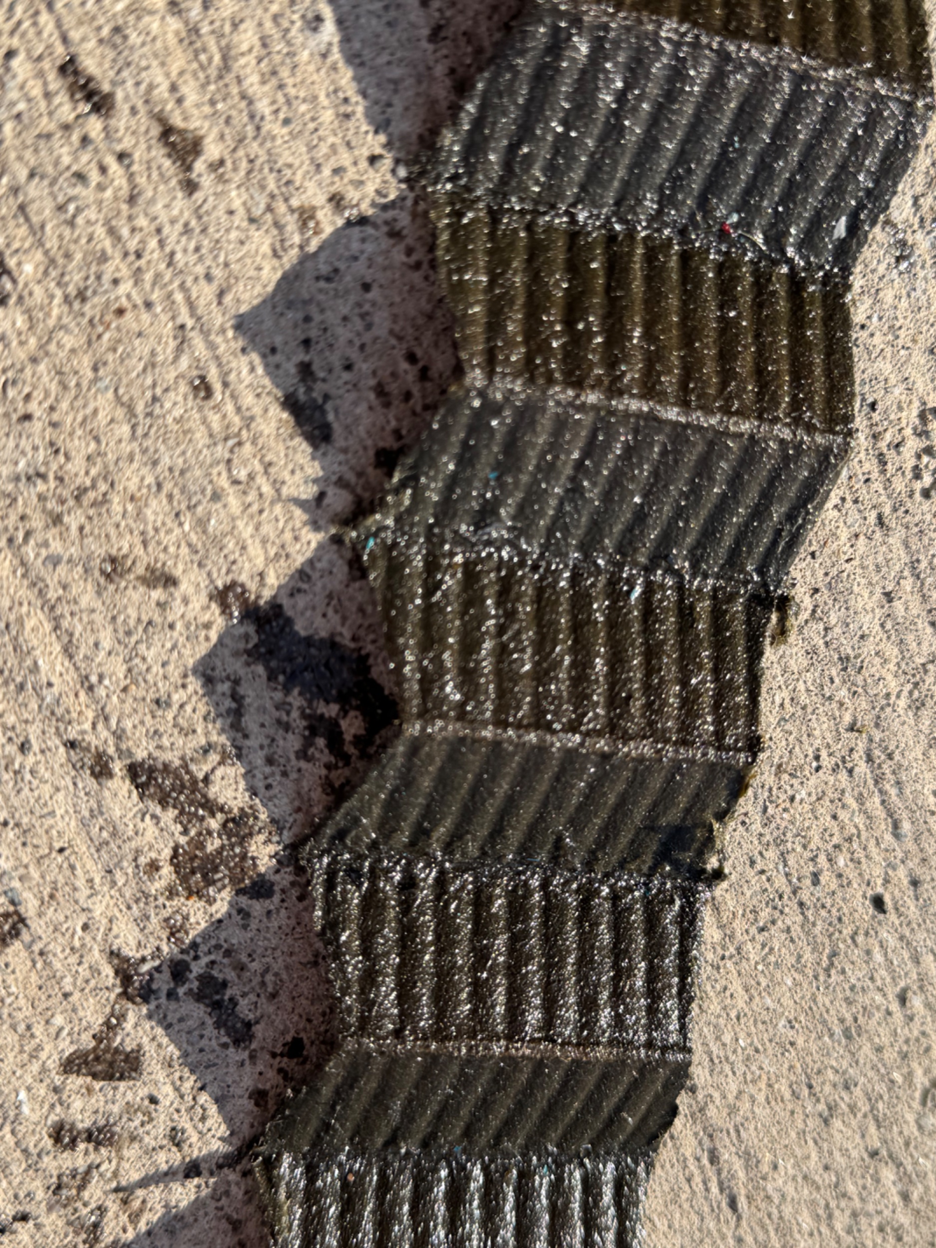

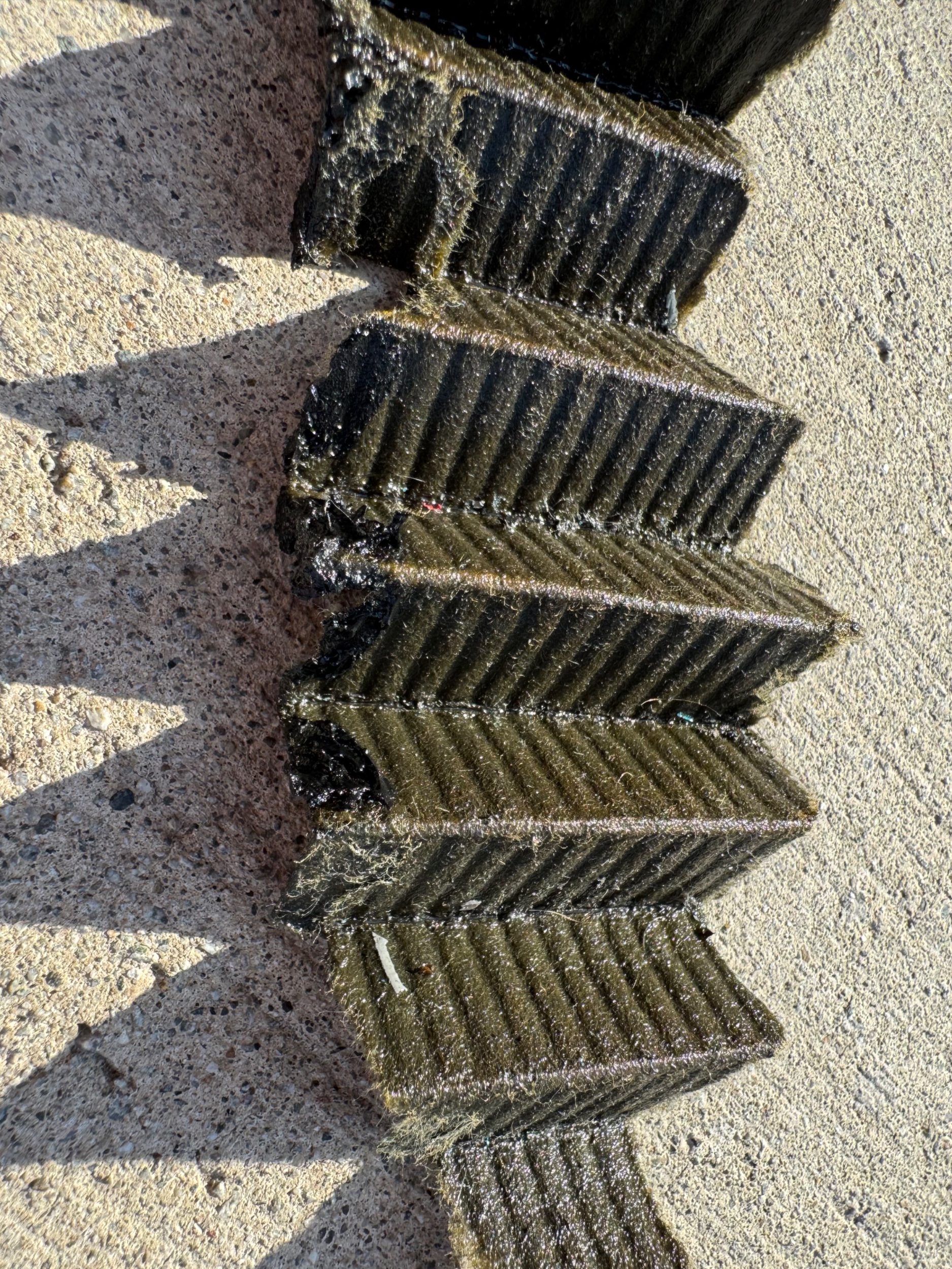

New machinist will evaluate on Monday. My hope is that as the piston ground away it contaminated the oil and bearings, leading to those failures.
Did friction overheat and warp the block? I'm very curious about the cam bearings woes
The machinist who put my short block together for me was pleasantly surprised my mains were straight. I guess that applies to cam bores too?
Been quiet for a bit while the dust settled. New machinist found that all cylinder bores were undersized, out-of-round, AND tapered.
They were able to fix it, but had to take the cylinders 1.5 thou over nominal to do it. I’m planning to get the pistons Line2Line coated, so that’s fine.

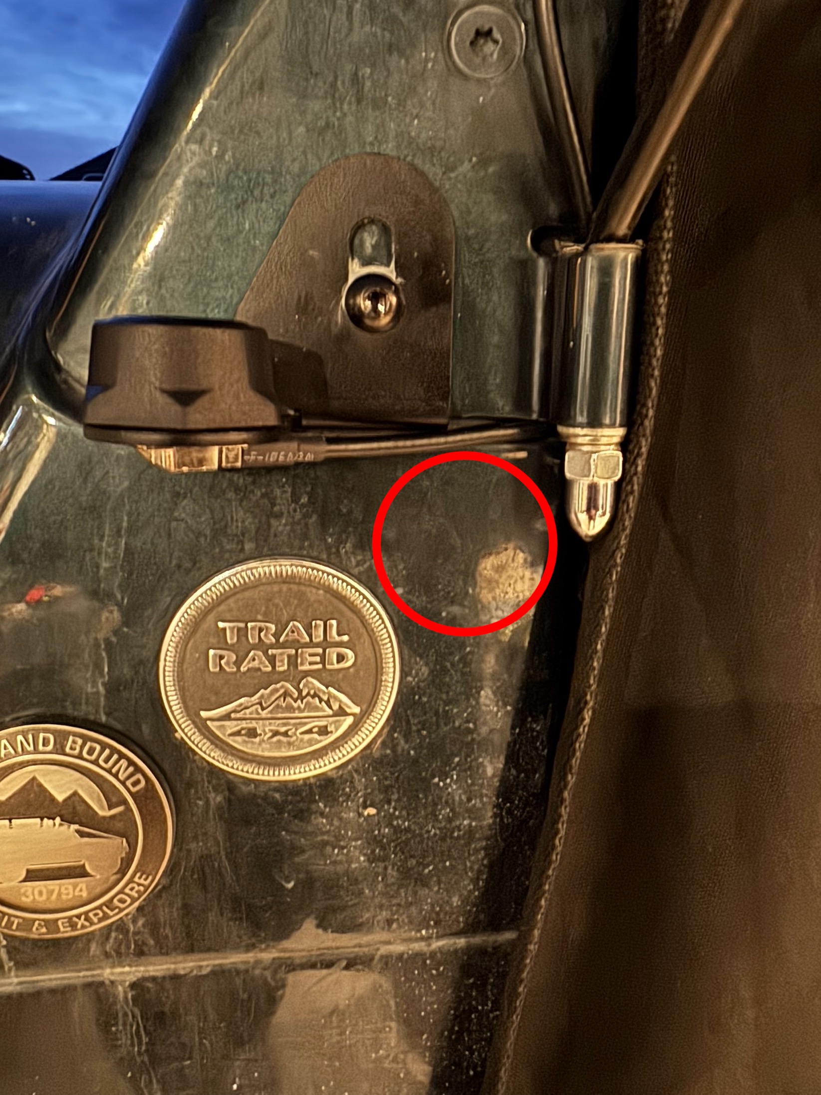

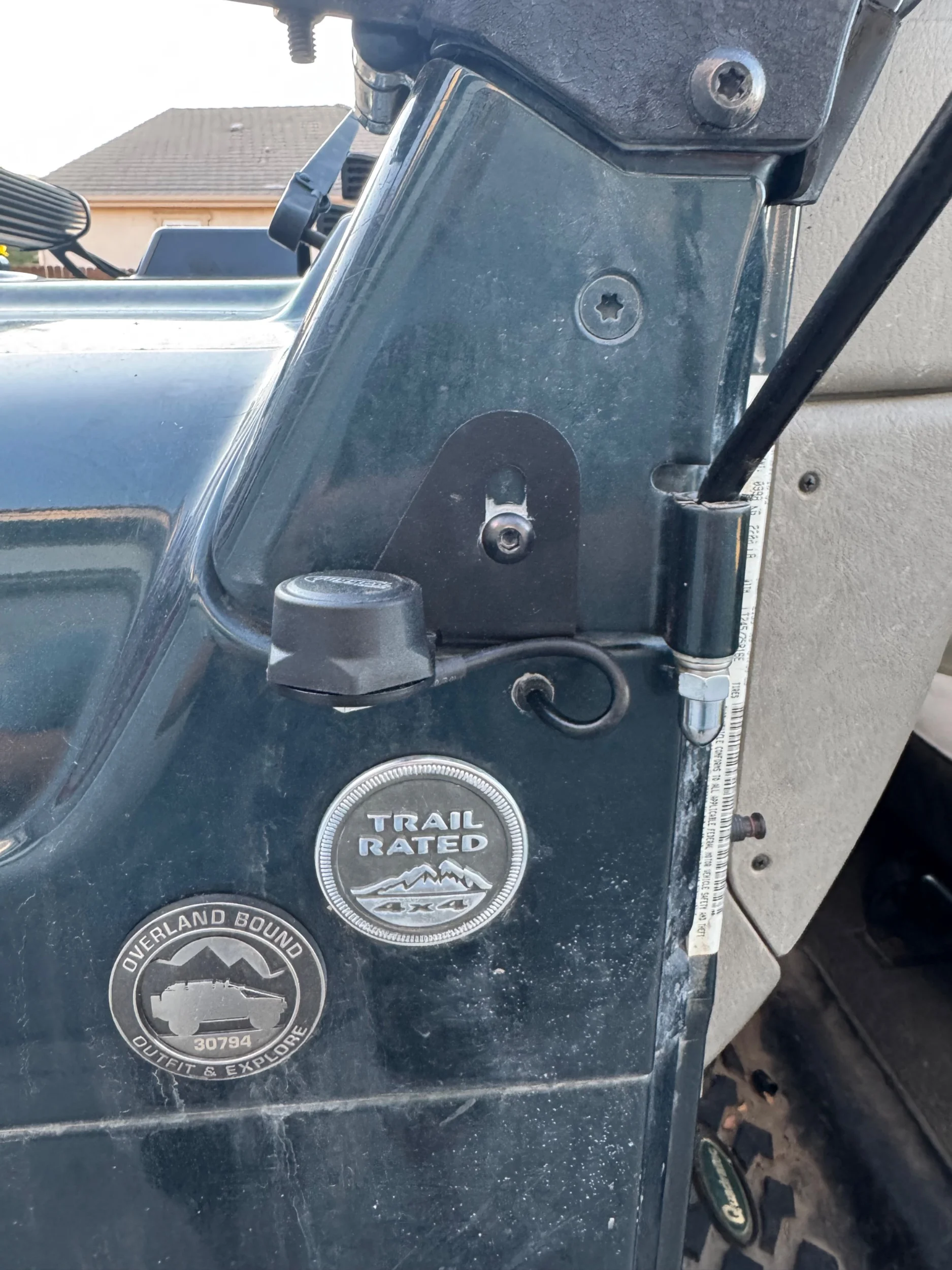

Can anyone confirm that this is just sheet metal that I could drill through and install a grommet for a GMRS antenna cable?
