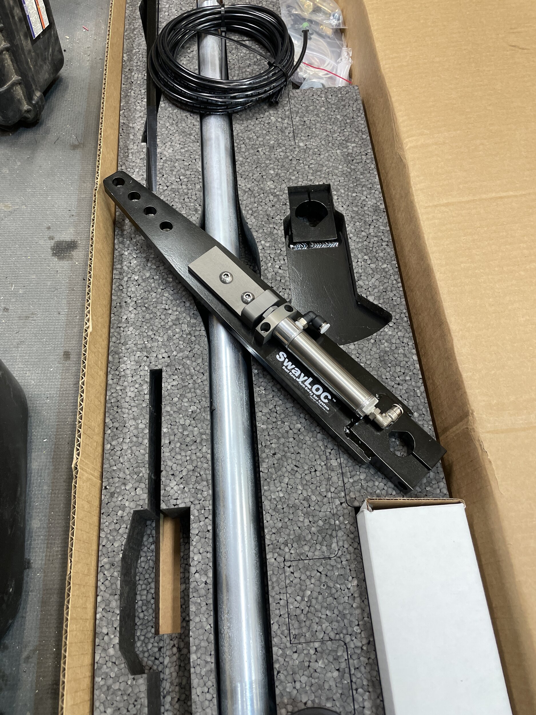

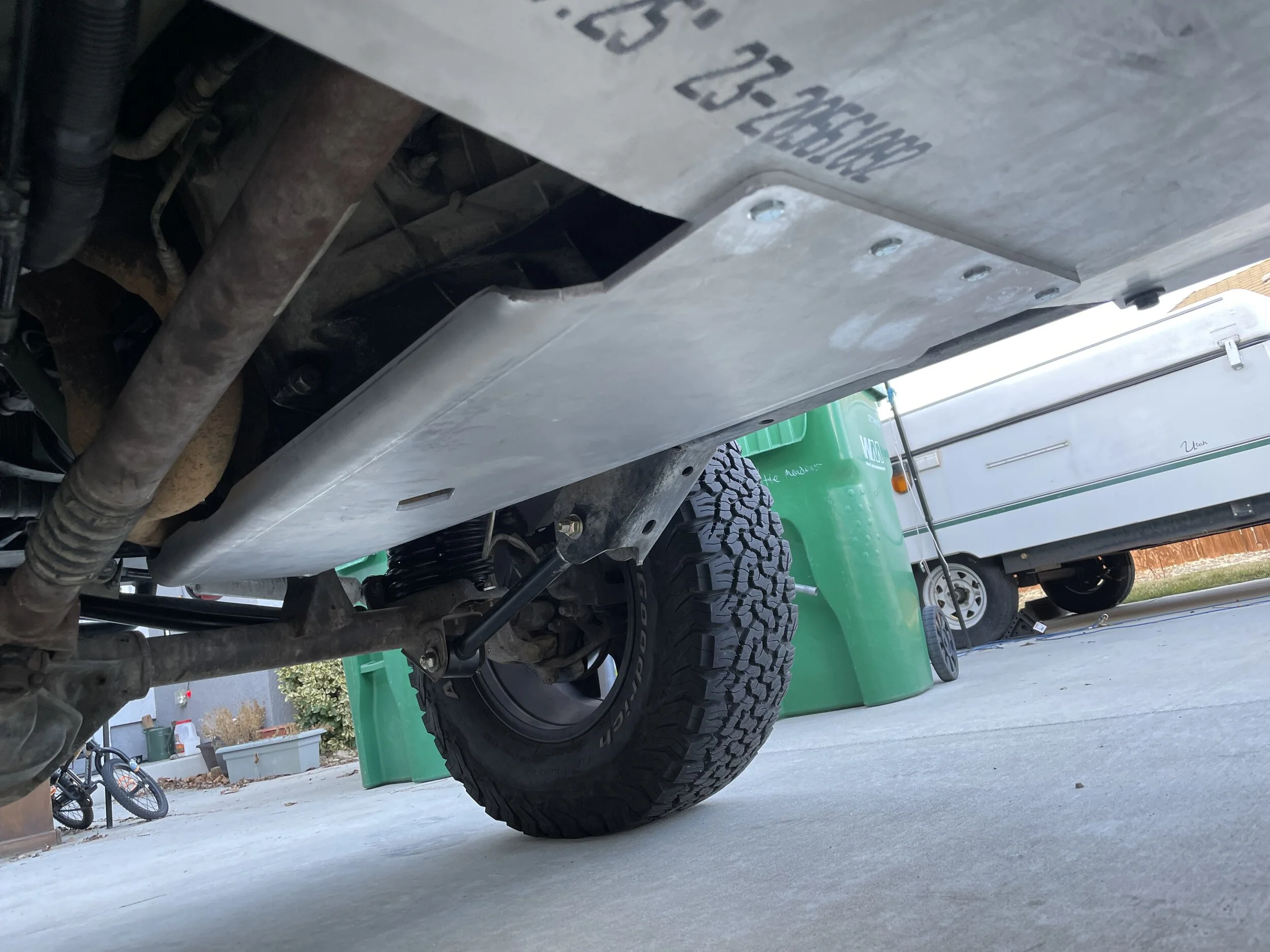

Been a busy week! UAM is fully installed. New rear driveline (from a local shop) is running well. Steering is good and stable. Dialing in the detailed adjustments in front. Ordered an ORO SwayLoc from Poly Performance, looking forward to putting that in. The RE disconnects aren’t great, and the heims are wearing out.

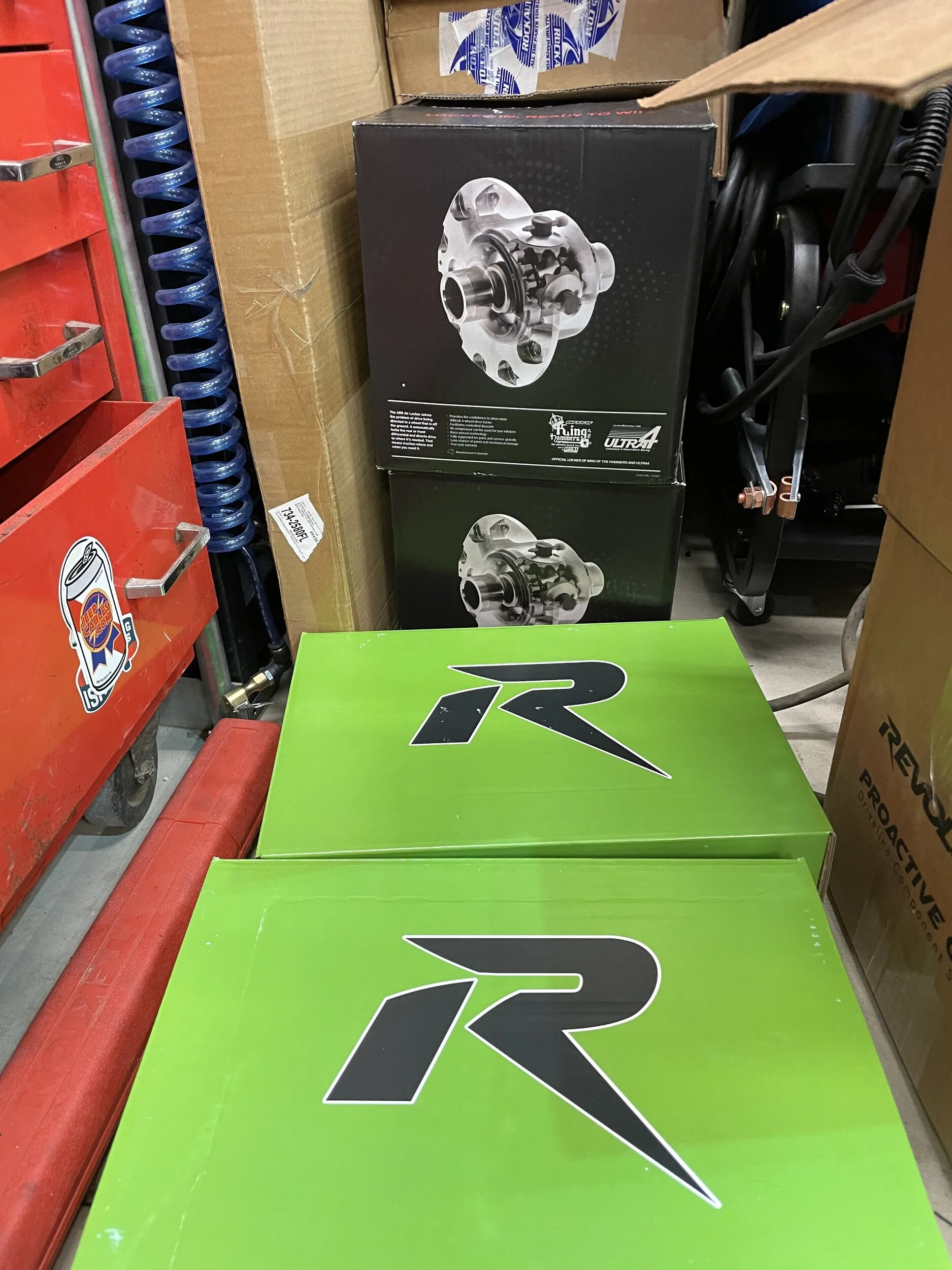

Finally pulled the cover to diagnose the rear locker, which won't stay engaged under any load. Discovered that I have a fully open LSD/locker. So I pulled the trigger on ARBs for both axles. And, since I placed the order after a wine tasting AND a beer tasting, I'm apparently installing 4.56 gears as well. 😆
Wondering why the 4.56 when most here recommend 5.13 manual or 5.38 auto on 35s.
Reactions: Rickyd and jjvw
W
If you know what it is, why not make the right choice now?
I've played around with ratios on http://www.grimmjeeper.com/gears.html, comparing to what I have now and what my old TJ had. The 4.56 matches closest to my TJ (which I was happy with), and since these aren't my "forever" gears I want to try something a little different.
Reactions: PNW_LJ
The one thing none of these charts ever show is the rolling resistance & added weight of the larger tire. So if you are trying to match a ratio you had before with the same RPM's you might not be as happy once you drive it. If you can find them there are some articles out there that talk about this.
I have found that gear ratio's are a known quantity around here. There's a few threads that simply state what you SHOULD run based on many TJ/LJ folks that have gone before you. I'm on 35's with the 42RLE with 5.13's and it's pretty peachy. That being said, I could DEFINITELY see the benefit of going 5.38's, if I had a heavier 35 or small 37's in mind.
For now, we're gonna wheel it as-is and see where we end up.
Edit: For your build, OP, My thought is that 4.56's aren't gonna be optimal, but if you'll be running 33's for a long time, maybe they'll be livable before you head up to 4.88's or 5.13's.
Reactions: Rickyd and Wildman
Yep,for that reason i almost never post gear charts.information without context is worse than none
Inertia of the larger tire is not something I had considered, thanks.
However, I have stock 4.10s currently, and I don’t hate them. So 4.56 should be a bit better. We’ll see. 🤷‍♂️

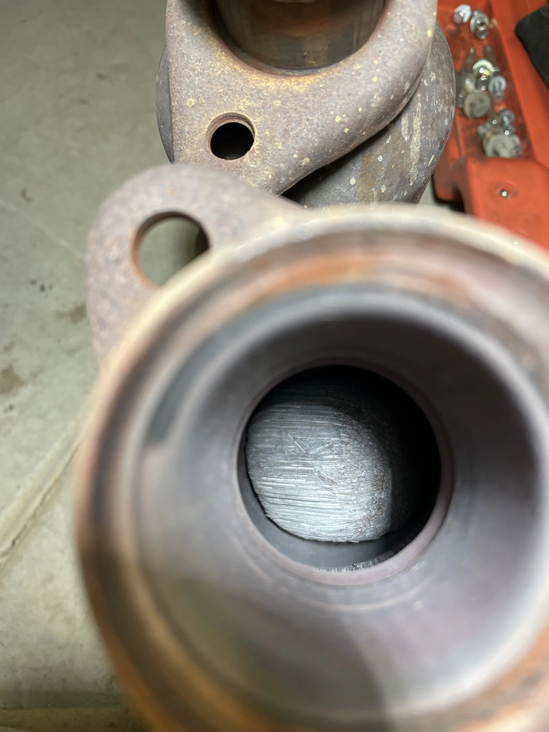

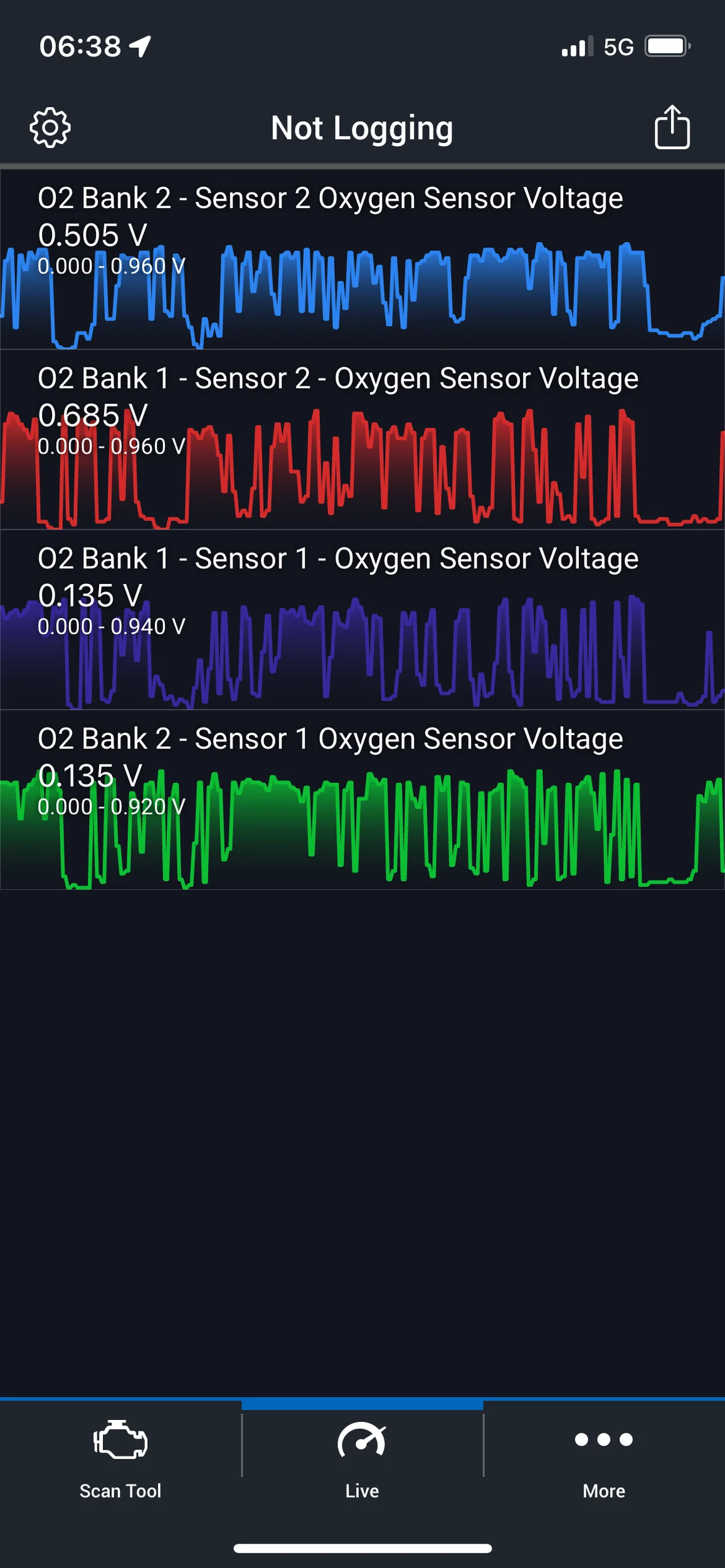

Threw a P0241 yesterday. Here’s a snapshot of the O2 sensor readings. Peaks are just above 0.9V, and based on the downstream sensors and code it looks like it’s time for new 🐈, correct?. 114k miles.
