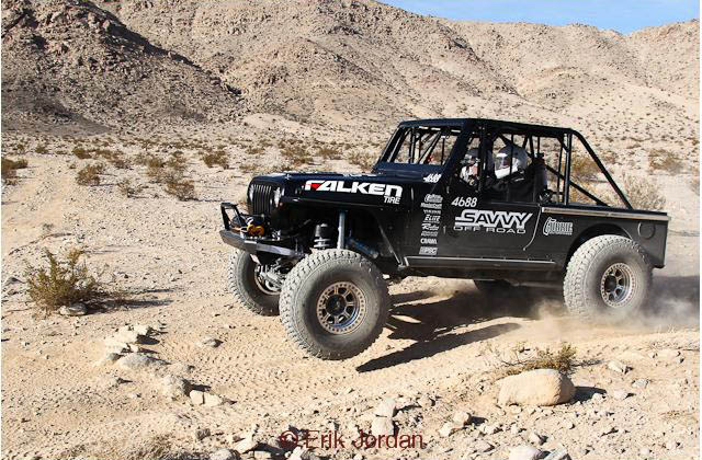

I’m curious how the cage in the Savvy EMC LJ was setup. I’ll have to see what pics I can dig up. They kept the windshield frame, although it was modified for weight savings I believe.
The windshield frame was gutted completely and the only part left was the single layer outer skin that weighed maybe 8 lbs. It was purely for looks, nothing else. Odd thing about the original cage, when they ran in the stock class and even though it was done properly with a firewall X tied into the legs of the A pillar and then the door bars going through the A pillar out under the front fenders to tie into the front of the frame, I never worried about them at the stock class speeds. When they stepped up in class and started going a whole bunch faster, I wasn't sure the cage would hold up if they rolled it at speed.

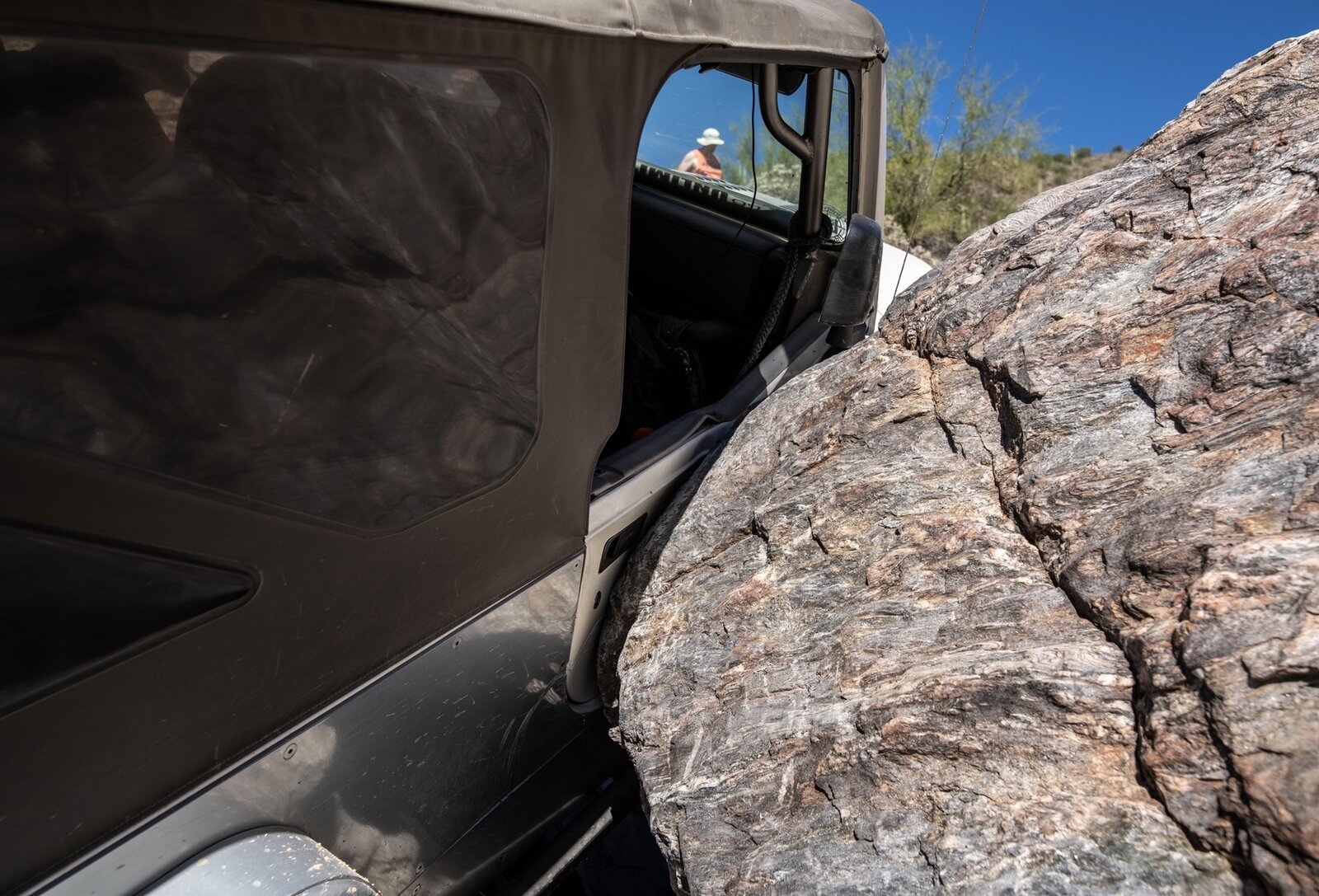

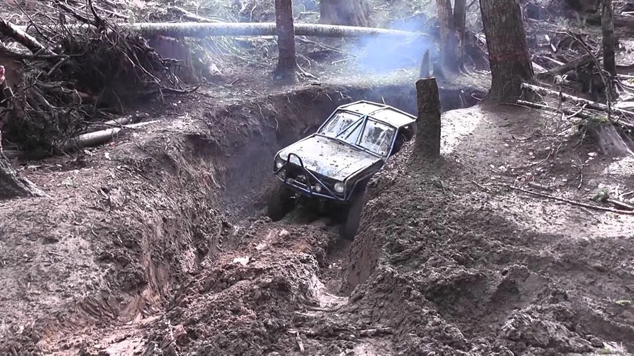

Here’s a typical Elbe yota build. At worst, the exoskeleton maybe robs a couple inches in some spaces. But when you inevitably lean into a tree, it’ll rub off the tube, rather than cause further body damage.
Since my Jeep is my daily, I don’t intend to do an exoskeleton. But I am doing what I can to minimize the physical space it takes up (which I am already at a disadvantage given the LJ).
Things like no rear flares, 0” front flares, spare delete, minimal bumpers, soft top etc. Maybe I would consider wider flares if I had 65” WMS+
All that tells me is an exoskeleton isn't enough of a hindrance in that environment to seek alternatives to protecting the body.
I can think of many other scenarios where the Jeep not being in the way of itself are far more desirable to keep moving forward.
You can make that argument. That is until the first major chunk of body damage. When there is poor traction and line repeatability is low, I don’t think that’s always the case.
There are trails here that in just a few weeks as the rains come in, I will no longer be able to do, though I could probably make them on my 35s/TT and lots of winching. I care about preventing major body damage, even with corners/sliders etc.
Thus I’ll accept the compromise with my build, and will do what I can to get stuff out of the way. The things I mentioned earlier were a good first step. Tucking the GTS is next.
8lbs is crazy.
Was there something you would’ve redesigned in that original cage?

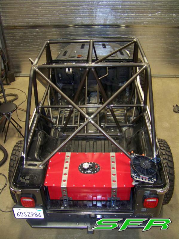

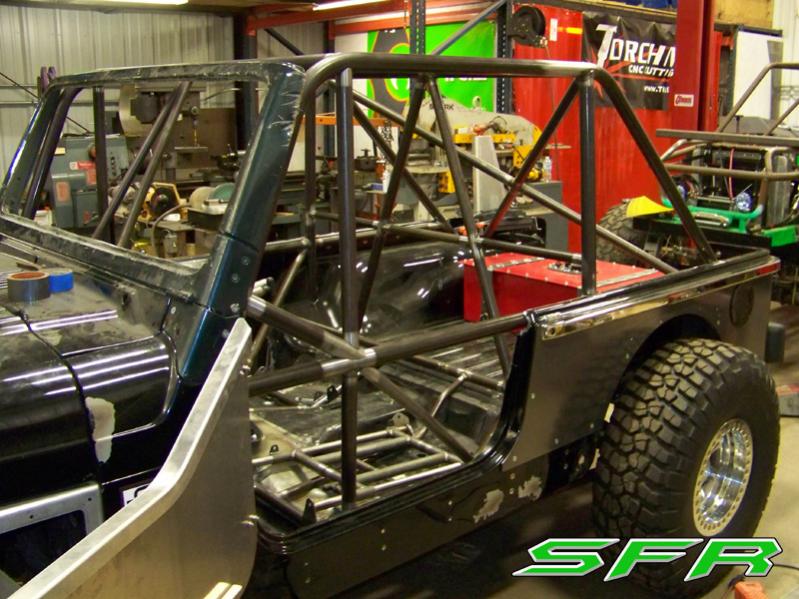

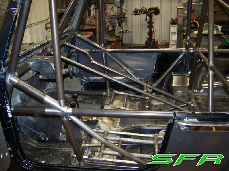

Not that I have much experience with cages but I've not seen a cage built quite like that. Do you have anything that would show the changes?
I do not. I mostly recall that it arrived back to them and John wasn't exactly happy with the way it was laid out.
As for how it was done, that's a pretty standard level of cage work. I would have liked it to have a better X in the B pillar. The harness bars are problematic and mess up that lay-out though. I'm not a fan of tubes that don't land at or on nodes. The B pillar to C pillar braces are an example. They land on the inner fender on a base plate and they should be closer together if one was to nit pick. It never failed so what do I know?
You mentioned a few things I was seeing and wondering about. It looked like it wasn't doing a great job of transferring the load where it needed to go.
