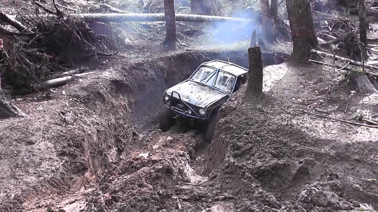

I’m not sure that’s the case. I look some of the trails we have up here, which I’d argue are some of the most damage inducing out there. There are trails/lines that are nearly guaranteed to give you body damage, no matter the rig or build level.
What you mentioned, an exoskeleton cage, I believe, is frequently used to prevent that sort of damage, and also damage from flops, that are also frequent in the area. These trails are also tight enough that if the added tubes were a detriment to the physical profile, it would’ve been discovered by now.

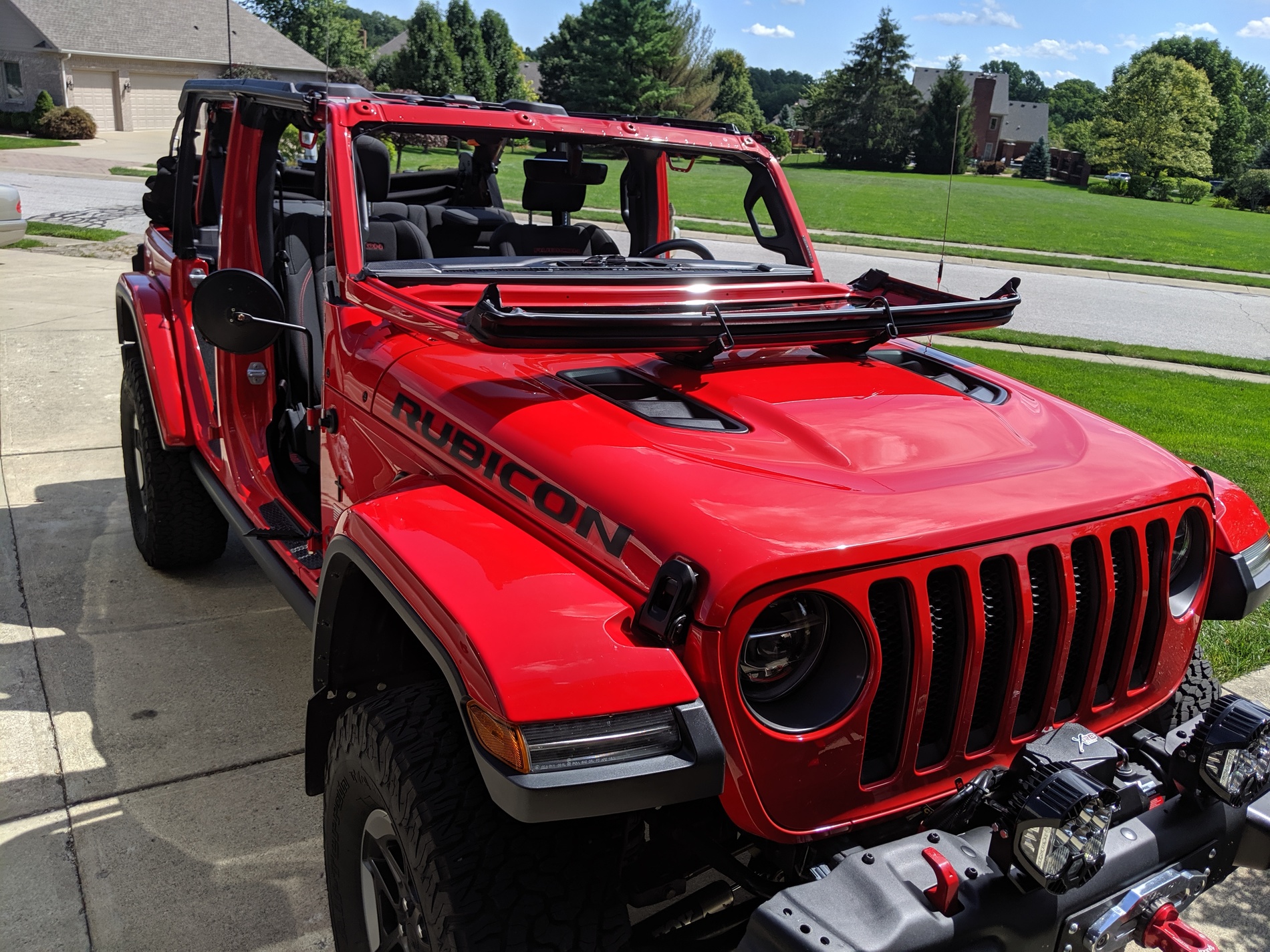

An interesting feature of the new JL is that the windshield is no longer a structural part of the cage. The cage stays in place with it folded.
Meaning it can be folded down more easily, and without impacting the rollover safety. Unfortunately it messes up the open air experience you get if you’ve ever tried this on an JK or newer.
We have a popular PNW build thread on here where, despite real compromises to the build, narrow axles were selected specifically because of the tight space restrictions you guys have out there. So, either the physicality of the Jeep matters, or it doesn't. If narrow axles are that necessary, so would trimming the bulk be in other areas.
There is a difference between those two.
Here’s a typical Elbe yota build. At worst, the exoskeleton maybe robs a couple inches in some spaces. But when you inevitably lean into a tree, it’ll rub off the tube, rather than cause further body damage.
Since my Jeep is my daily, I don’t intend to do an exoskeleton. But I am doing what I can to minimize the physical space it takes up (which I am already at a disadvantage given the LJ).
Things like no rear flares, 0” front flares, spare delete, minimal bumpers, soft top etc. Maybe I would consider wider flares if I had 65” WMS+
