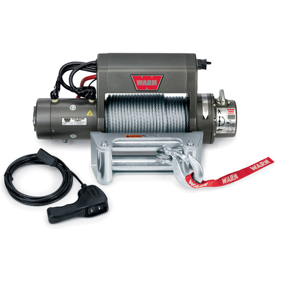

Hi, I recently purchased a used warn xd9000i. I’ve never had a winch before let alone installed one. Do I need a solenoid and a bracket for it? What about a switch for inside the dash? Any help?
Depending on what bumper you have you might need a winch plate to mount the winch. Does the winch have a grey or black box on top or beside the drum? If you can post a picture of what you have it might help with what you need.
The i stands integrated solenoid. It's in there already.
Is this what you have?
If so the solenoid is in that upper gray part

What box? Post pics. Does your winch look like the one above? Or does it have a pair of chrome bars running across the top?

Sorry. When you asked the OP if his winch had a “gray or black box on top or beside the drum”, I ASSumed you meant the cover plate for the solenoids and that you could tell the difference in the between the generation Of the winch by which color cover plate it had.
