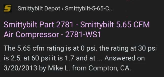

That little single-cylinder compressor comes nowhere near 5.65 CFM in actual use. If you find their more detailed specs you'll discover that 5.65 CFM is measured into 0 psi resistance... open air in other words. Our lungs can put out that much CFM into open air. Into a tire's back pressure, typically measured at 10 psi, would be likely around 1/3 that much.The 2781 (not to be confused with the earlier 2780 model) has an impressive 5.65 cfm, which is only slightly lower than the 6.16 cfm of the ARB CKMTA12.
