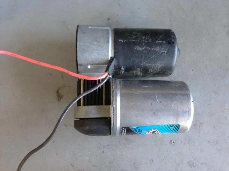

That little single-cylinder compressor comes nowhere near 5.65 CFM in actual use. If you find their more detailed specs you'll discover that 5.65 CFM is measured into 0 psi resistance... open air in other words. Our lungs can put out that much CFM into open air. Into a tire's back pressure, typically measured at 10 psi, would be likely around 1/3 that much.
Smittybilt plays games with their specifications including using that misleading type of CFM spec (into 0 psi backpressure). It is physically small enough that I knew it couldn't put out 5.65 CFM so I started digging. It took me a while to find the actual spec on that but I kept digging until I found it since you can tell by just looking at its small single cylinder design that it couldn't possibly put out that much CFM at a proper 10 psi (or so) resistance pressure like a tire has in it. I forget by now what it put out into back pressure but it was more like 2 CFM.

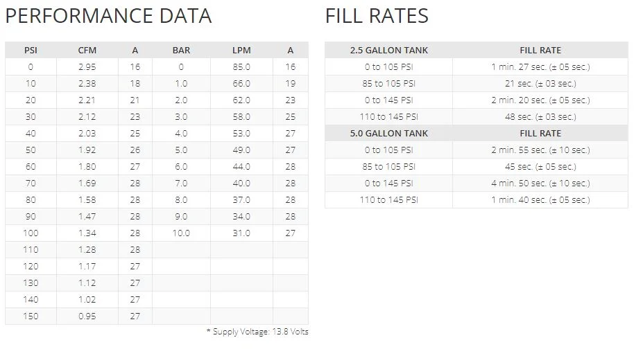

Let's be realistic here, this doesn't apply to just Smittybilt. Viair also posts CFM ratings at 0 psig. Take their Model 420C which is advertised as being 2.95 CFM drops down to 2.38 CFM at 10 psig, and 2.21 CFM at 20 psig. At least they provide a bit more technical information about their performance (see below). Even the ARB compressors all give their CFM rating at 0 psig, though like Viair they are a bit more transparent about their performance...
Viair 420C Rating:

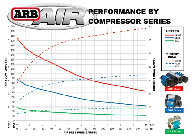

ARB Compressor Performance Data (pulled from off-road.com):
Now with that said, I go back to the Smittybilt 2781. With 2.5 cfm @ 30 psig, that's still fairly good performance for a portable unit. It is about 35% faster than my Viair 400P that I have used for a while (and quite often) without any issues. For the cost and portability, it still makes it a decent option for many.
Viair 420C Rating:

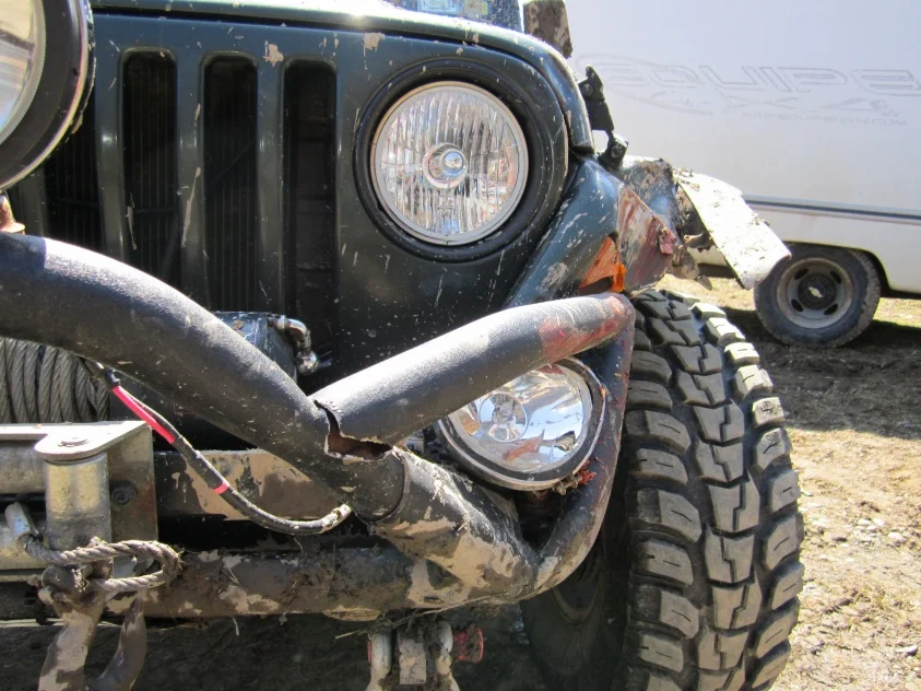

Knowing the complete history of Smittybilt, I wouldn't TOUCH a Smittybilt product. Old man Smitty built a fine company with good quality products that were popular with Jeepers. Then he died. Investors went to the Smith family and bought the rights to use the Smittybilt name. They didn't buy the company, they just bought the name and started importing junk parts from China and selling them as Smittybilt. Instant sales since Smittybilt had a good reputation. Then it was noticed the stuff was junk by many Jeepers who stopped buying their junk. Only newer younger Jeepers continued buying. Then Transamerica bought them and caused more cost-cutting like they have done with every other Jeep parts company they have bought. Misleading ads and they don't even bury the real specs, they make them unavailable on their website. Junk parts, misleading specs. Again, I wouldn't TOUCH a Smittybilt product.
Two of their fine products.

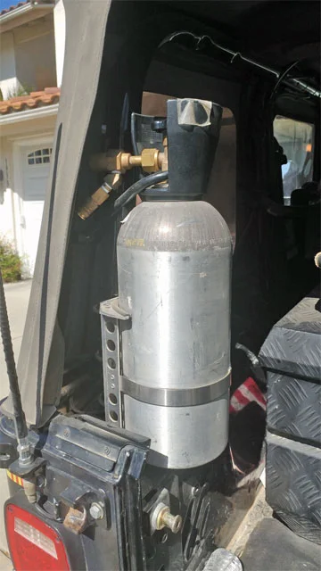

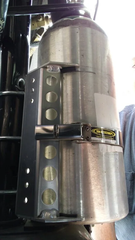

All you have to do to prevent running out of CO2 is to weigh the tank before leaving to go offroading. I do that every 2-3 trips, it's an easy way to know exactly how much CO2 remains in the tank. Weigh the tank, then subtract the tank's tare weight. The difference is how many lbs. of CO2 remains.
And as you can see, my CO2 tank takes up effectively no cargo space, it's completely up and out of the way.
View attachment 286639View attachment 286640
Agree with this. I've seen their 'rock rails' crumple like they were made with recycled aluminum cans. Made someone's door cave in.
Jerry, might you have a writeup on your mounting solution?
..and of course, who's our favorite vendor for tank and accessories?
I bought a "scratch & dent" model of this... https://www.amazon.com/gp/product/B002KC93MM/?tag=wranglerorg-20
The non-scratch/dent model is at https://www.amazon.com/dp/B078Y2Q2LQ/?tag=wranglerorg-20 but it's definitely not cheap. I only paid $56 for the scratch and dent version.
The good news is it was neither scratched nor dented, it was pristine. I think they were just trying to move more of them at a reduced price by claiming they were not first-quality.
