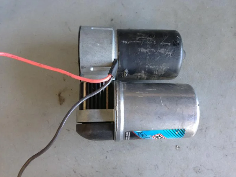

The big twin isn't even "great" at filling tires. No way the one that is 1/3 the compressor is.I have the CKMA12 and it works great for both filling up tires and for my air locker
wooooo there cowboy mines 1/2 of the twin I'm pretty sure not 1/3The big twin isn't even "great" at filling tires. No way the one that is 1/3 the compressor is.
I hadn’t seen that one before. I like the idea of it dedicated for the lockers.The mini, always.
Alright, it is half the compressor which means it is half of almost doesn't suck.wooooo there cowboy mines 1/2 of the twin I'm pretty sure not 1/3
I also only have 33s
I probably have 5 of them on the shelf. Very reliable, low amperage draw, no relay needed to hook it up, plug and play harness. And, if you run one locker, get a solenoid air valve for the other port. If you have a solenoid issue, move the connector and air line over to the spare already mounted in the tank and you're good to go. The stupid things are so small, you can carry a complete spare in less space than a tire plugging kit.I hadn’t seen that one before. I like the idea of it dedicated for the lockers.
Axles are supposed to arrive tomorrow so if everything is right there will be two ARB’s in them.I probably have 5 of them on the shelf. Very reliable, low amperage draw, no relay needed to hook it up, plug and play harness. And, if you run one locker, get a solenoid air valve for the other port. If you have a solenoid issue, move the connector and air line over to the spare already mounted in the tank and you're good to go. The stupid things are so small, you can carry a complete spare in less space than a tire plugging kit.
I'd run twin Puma's before I went Co2. Co2 has gone up so much in cost that it is less and less viable for filling tires.Axles are supposed to arrive tomorrow so if everything is right there will be two ARB’s in them.
Probably should go CO2 for the 40’s
I run a single puma! Oh wait, you said two are almost bottom of the barrel, nevermind.I'd run twin Puma's before I went Co2. Co2 has gone up so much in cost that it is less and less viable for filling tires.
Which Puma?I'd run twin Puma's before I went Co2. Co2 has gone up so much in cost that it is less and less viable for filling tires.
I'd probably do a pair of the 1006 because they are cheap with the tank. Toss the tank and related tank bits and build a dual set up plumbed into a manifold or a tee.Which Puma?
