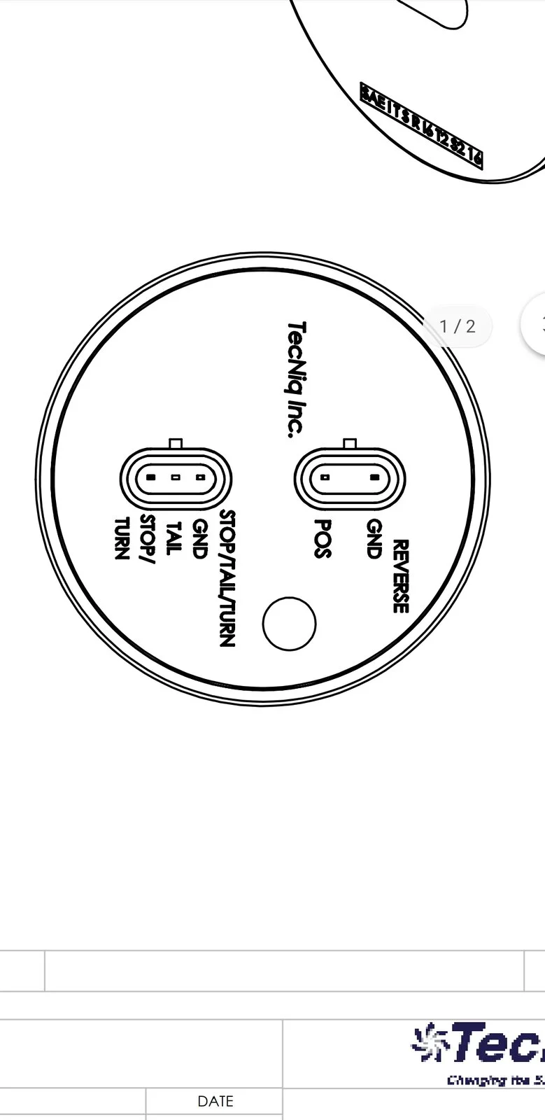

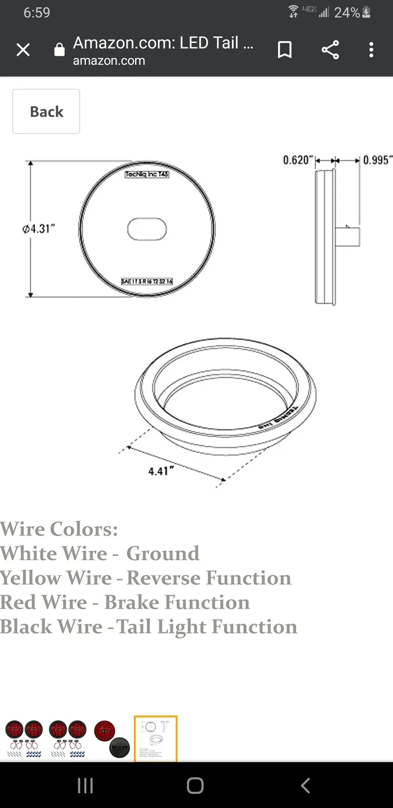

Those of you that ran these amazon tail lights can you share how you wired them? super novice over here.
If you're referring to the ones I linked in post 38 then here is the diagram for the lights.
This thread outlines the wiring for the jeep. For mine I ran the ground to the sheet metal on the wheel well.

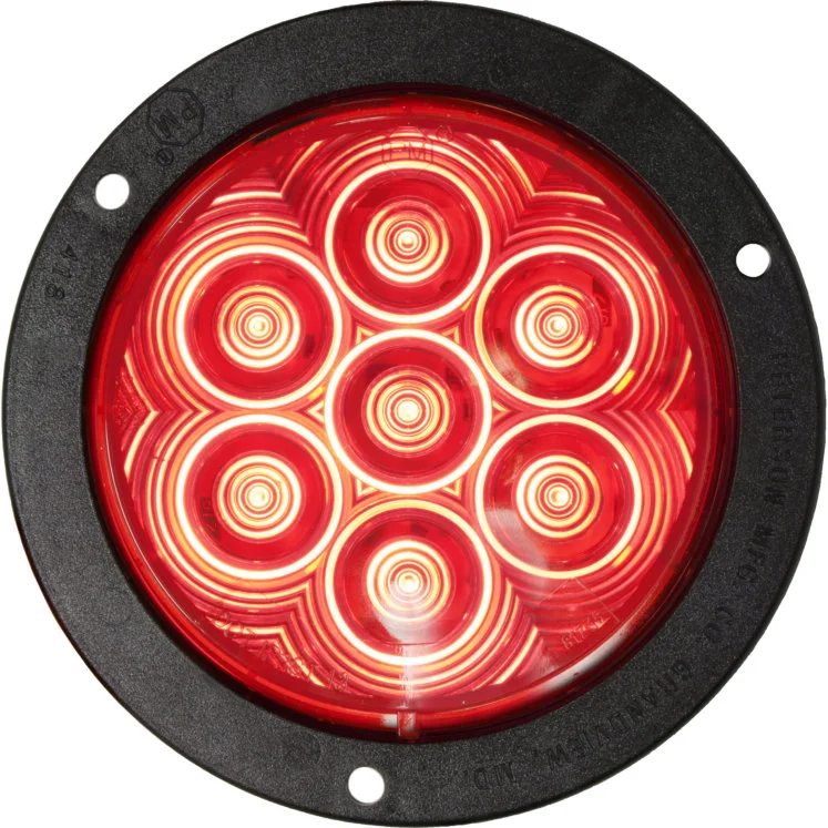

I have the same tail lights as ABQWrangler in post #53. I have had no issues with them. They are very bright and the reverse lights are really nice. https://redirect.viglink.com/?forma...4" Round Grommet Mount w/ Reverse Light
Reactions: Bigfoot-NM
I do like the Savvy ones but $240.00 compared to all of these for under a $100.00

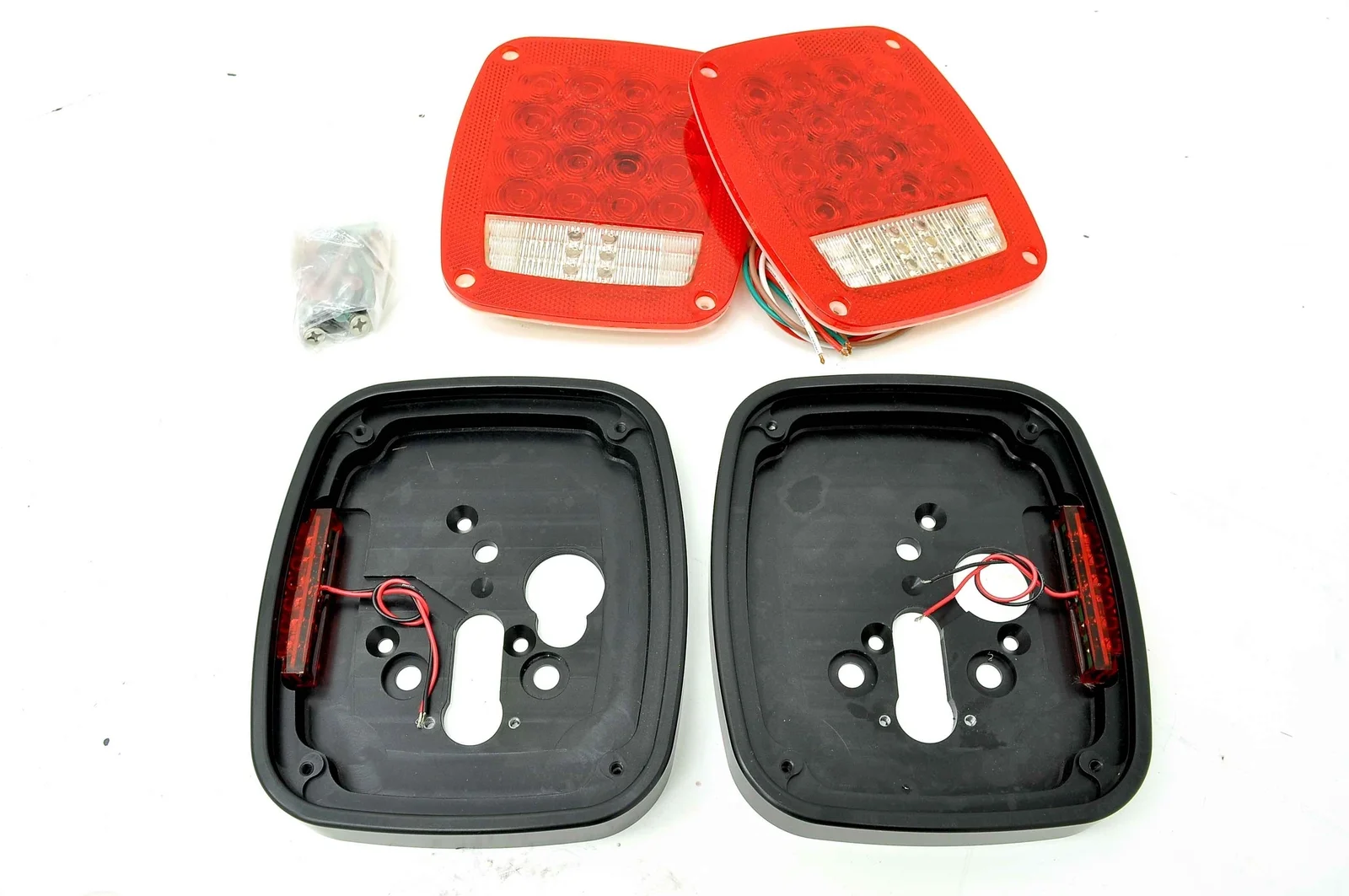

yeah but when you're on your 3rd or 4th set of those chinese made amazon specials, you''ll have to come back and tell me what a bargain they were...I'm a buy once, cry once type 'cause I don't mind spending a bit more initially for a quality part and installing things once
and besides the anodized aluminum housings on the Savvy lights are beautifully machined bits

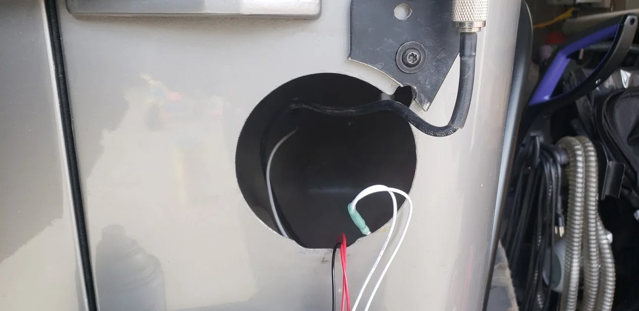

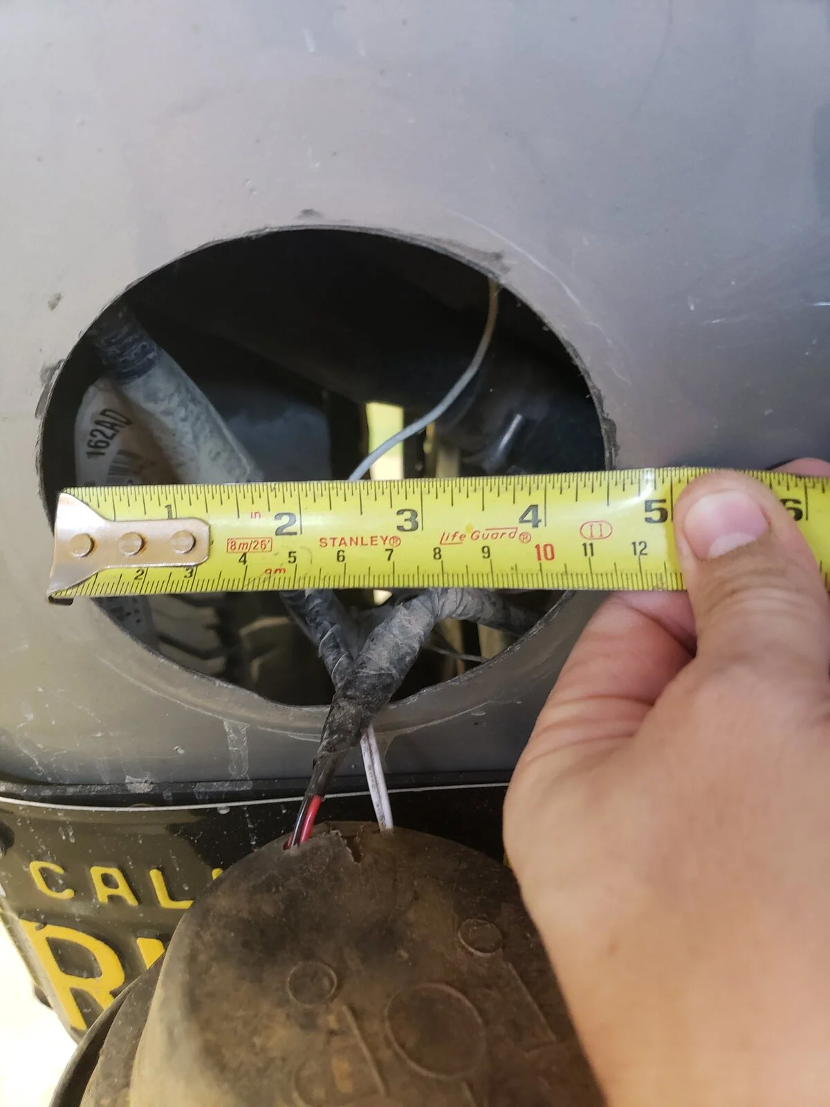

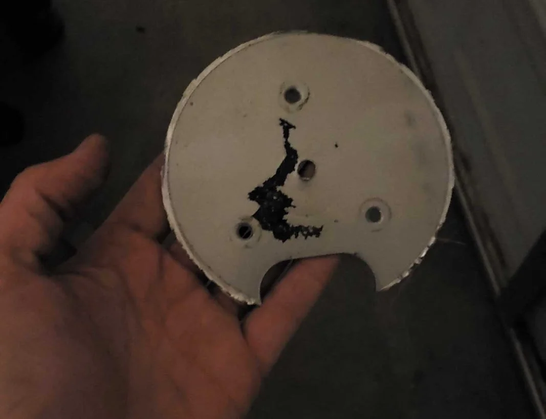

Did you drill a small hole in the tub behind the license plate bracket for the 2 license plate wires?
Yes, I drilled a hole right behind the light on the bracket.
Yea but if I screwed up I would be in real trouble as I would be drilling through my corner armor also:eek:
It's pretty easy to get them identical since you can use the factory mounting holes as a reference. I have the 4.5" bit if you want to use it, or head over and I'll help you with the cut. Also, the hole saw has a guide bit, so once you start it isn't going to jump all over the place.
X2, and once you know where you want to drill, you can dimple the tub in the center so the bit doesn’t walk.
