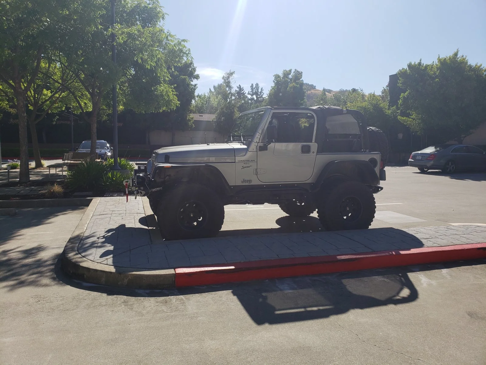

Does it look normal with 33s?
Definitely let it settle a bit before doing anything. I haven't used RE in a long time but, they were known for being generous with their lift heights. I ran their 4.5" XJ spring and it was a solid 5" after settling. If you want to stick with 33, you need that lift or a suspension and body lift combo.
You jumped in with both feet. 3.5" usually needs a sye/dc shaft and adjustable control arms. A transfer case drop or motor mount lift may help but not guaranteed.
I wouldn't do 35's unless you are ready to re-gear, beef up axles, beef up brakes, beef up steering, etc.

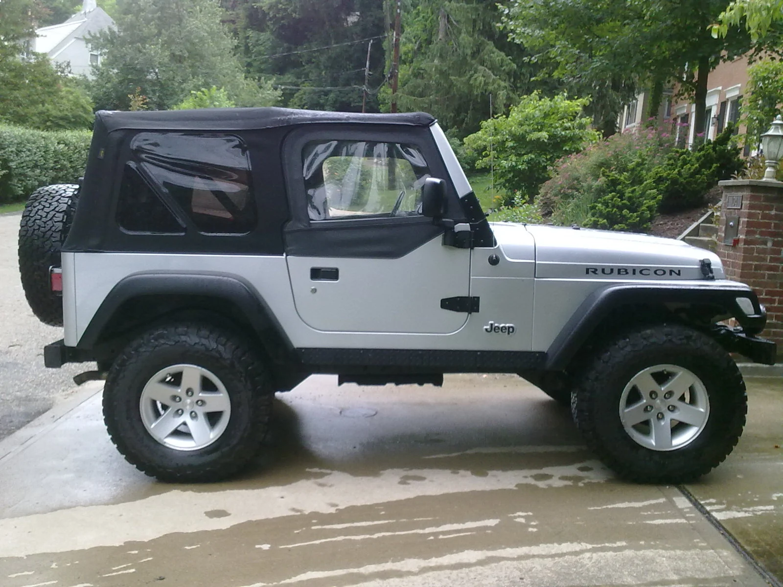

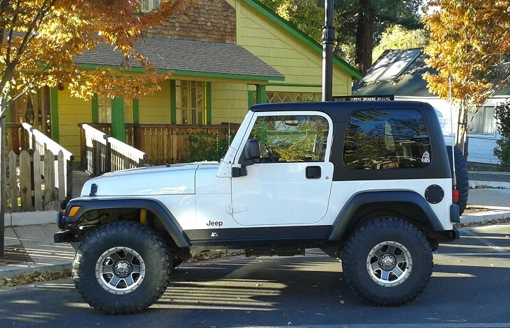

Just for contrast here is mine with 33's at a 2.5" OME lift. I personally feel mine looks better, BUT yours will do better on a trail if you need that space in the wells.
Mine must look really silly with 33s, 4" springs and a small body lift. :)

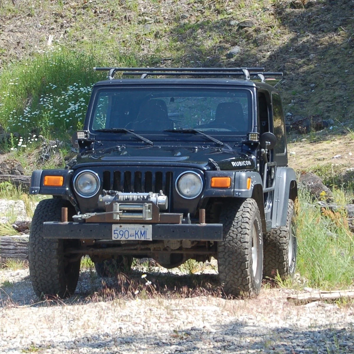

Lowranger your jeep looks perfect! Did you have any vibration after the lift? Also, what tires are you running?

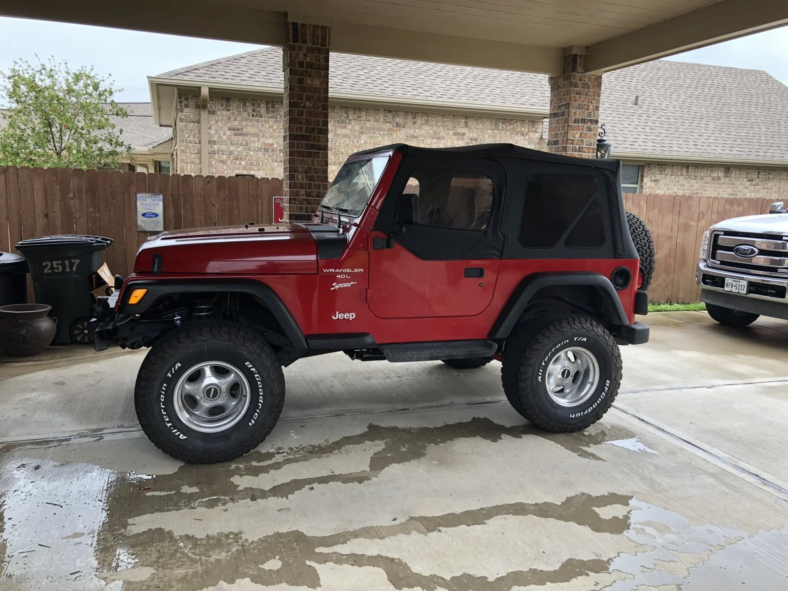

Here is mine with the stock flares/flat, RE 3.5, and 1.25 BL 35x12.5

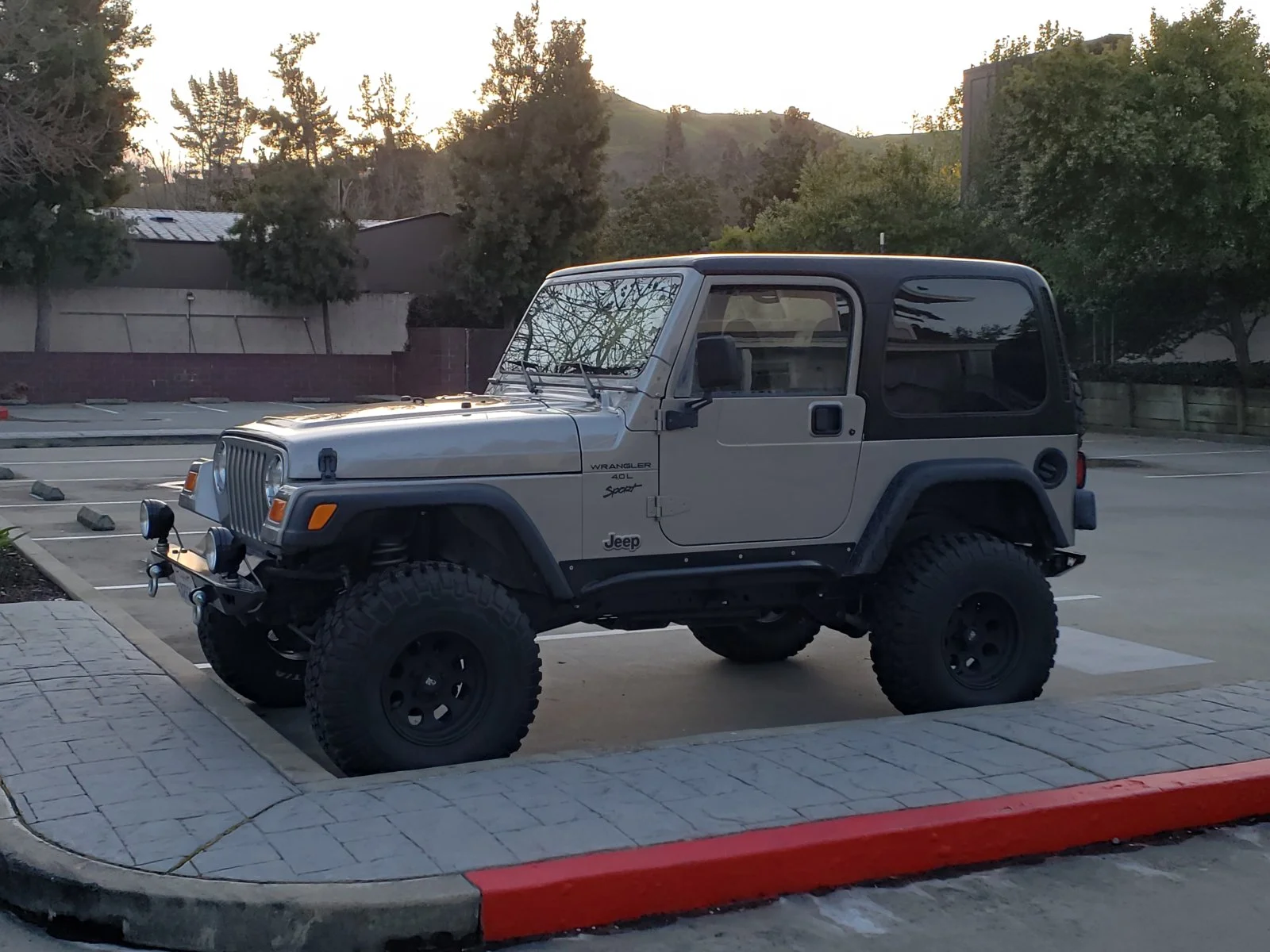

This one is the same setup with 33x10.5
