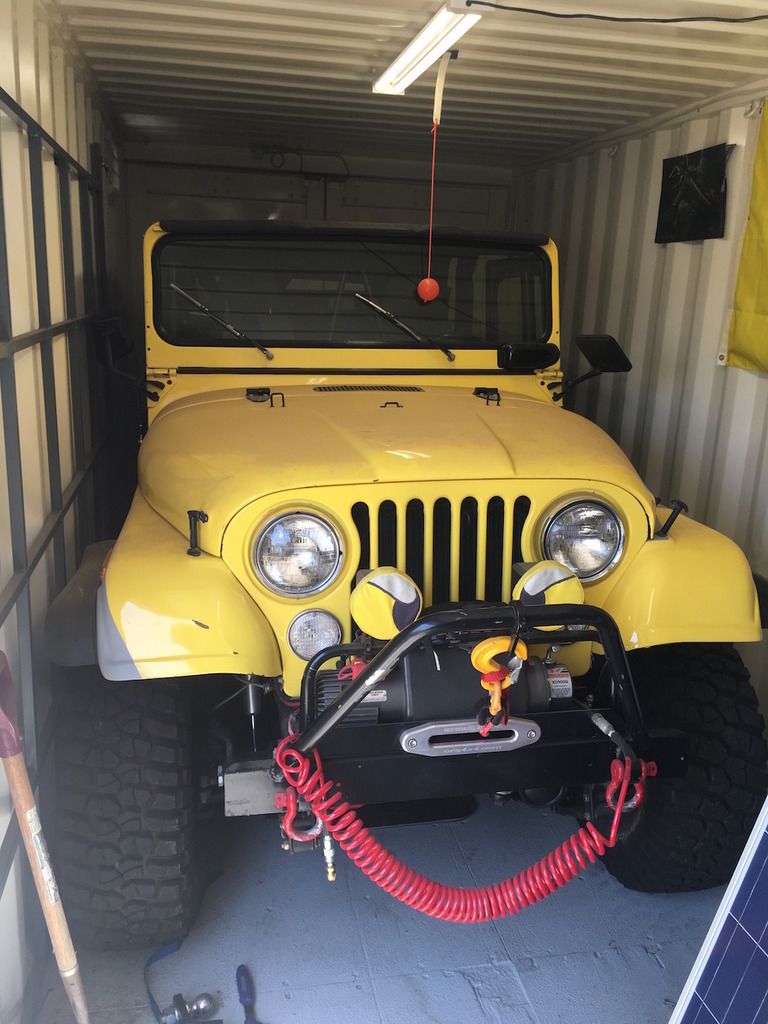

Lol I laughed my ass off on the grill jokes!!! I get it my cj7 doesn't have it on it ok...my 7 yr old son this is " his build " I just got a lil carried away ,but he wanted the angry bird so I went with it
