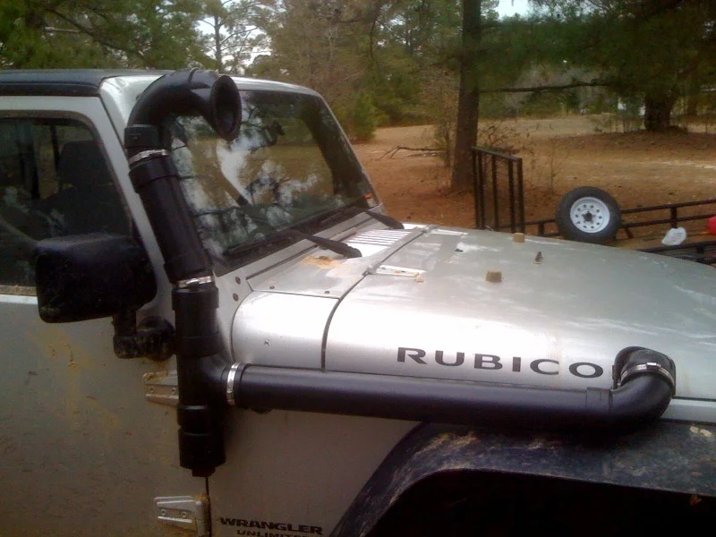

Educate me on snorkels
No offense to anyone but I've seen several in my area and they just look dumb. Short of driving thru Tampa Bay or south Westshore Blvd when it rains you'll never use one.
I'm gonna guess that the majority of those sporting snorkels did it for the "cool" factor. If my TJ didn't come with a snorkel already installed I wouldn't have one. Can't remove it or I'll have to patch the entry hole. I won't wheel through deep water....ever!
Here in Florida they seem to be the second most popular accessory, right after mounting a Hi-Lift on the hood.
