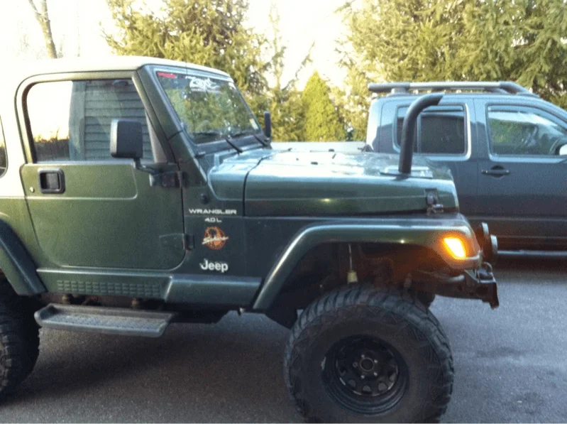

I tend to favor this yer snorkel deally.
At high-speed it gives you at least 30 additional HP through through "increased air induction"--when facing forward (says so, right on the box).
And, when treading deep water, you just spin it 180 degrees to the rear, to serve as your snorkel (says so, right on the box):

I have a snorkel in current TJ and had one on the last 2 TJ’s I owned.
Where we wheel it is common to drop off a creek/river bank so steep that even two feet of water can be enough to get into the factory air box intake and risk hydro locking.
I hear of guys hydrocking engine about once a year in the areas we go, usually only during spring runoff but it’s often enough to convince me to take precations.
And as far as the other typical arguments in favour of snorkels like cleaner air, more power, “ram air” effect, better fuel mileage I can tell you without a doubt there is NONE of those benefits present, in fact, I typically see a dirtier air filter with the snorkel than without.
