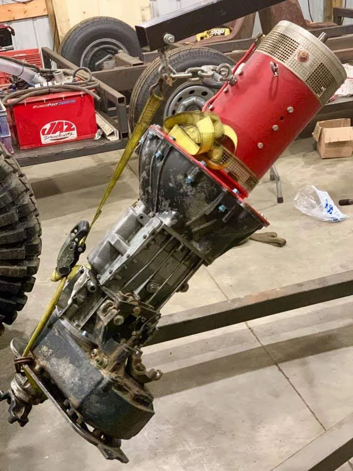

Looks like he is running an auto and dana 300 looking transfer case. I need to do some more homework on the different electric vehicles to understand how they work better. Here's a picture from his build.
The transfer case I get, at least the 2/4 part of it. I don't understand what the transmission is for.
Reactions: rasband
I really don't know unless it's there to take some of the load off of the transfer case? Or it's the only was for DIY guys to adapt an electric motor to drive train at the moment?
