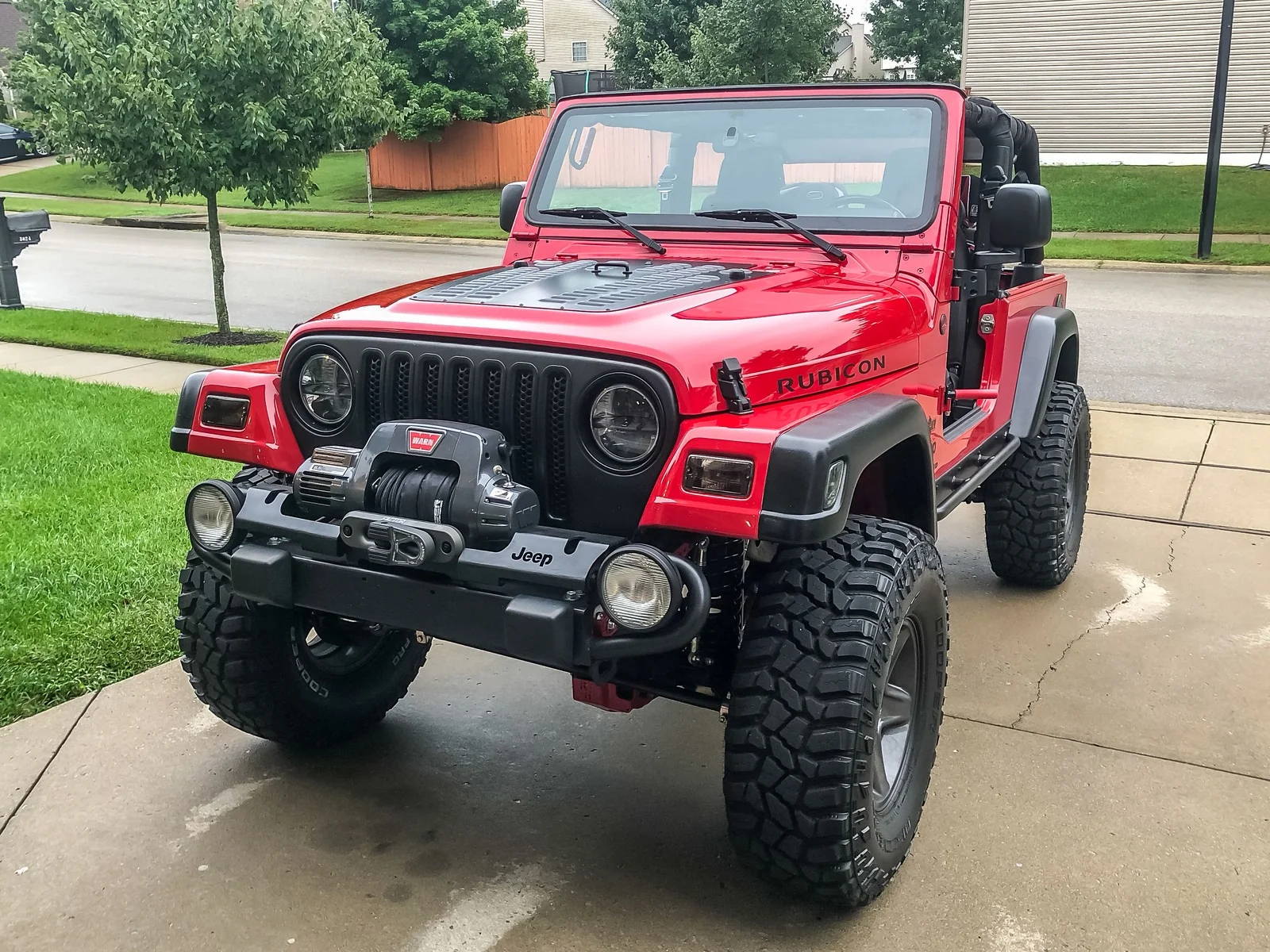

Lots to update but I've been swamped with work and then working on the LJ! We actually got to Gatlinburg this afternoon and are staying through the weekend for the Great Smoky Mountain Jeep Invasion. I still have a good bit of stuff to do on the LJ but most of the big items are done. It did great on the almost four hour drive down and I'm very happy with the 5.38 gears.

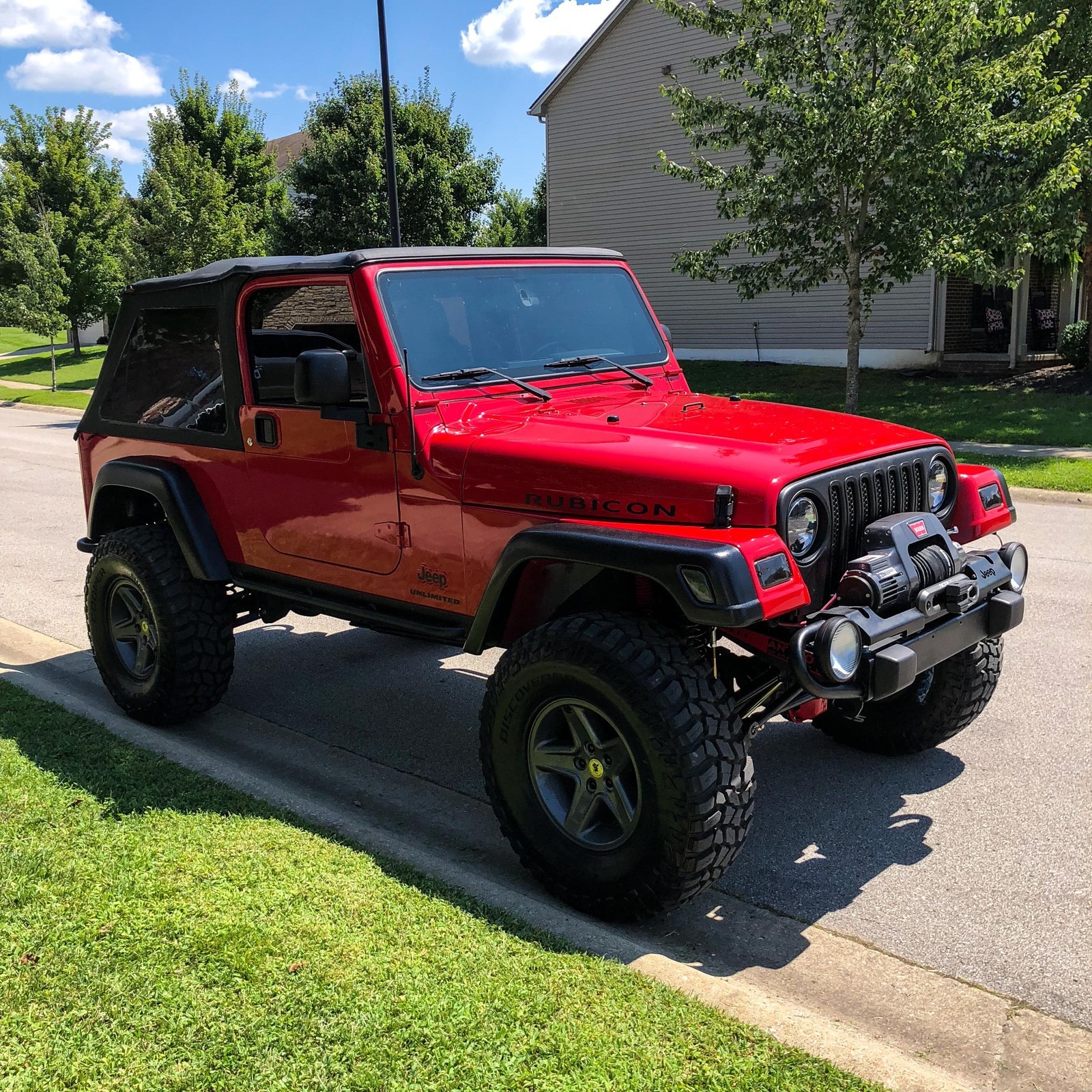

This is a shot from a couple of days ago after I had some detailing done to it before I worked on adding the decals back.

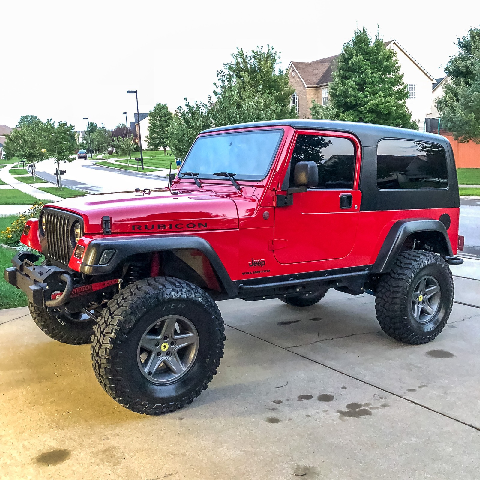

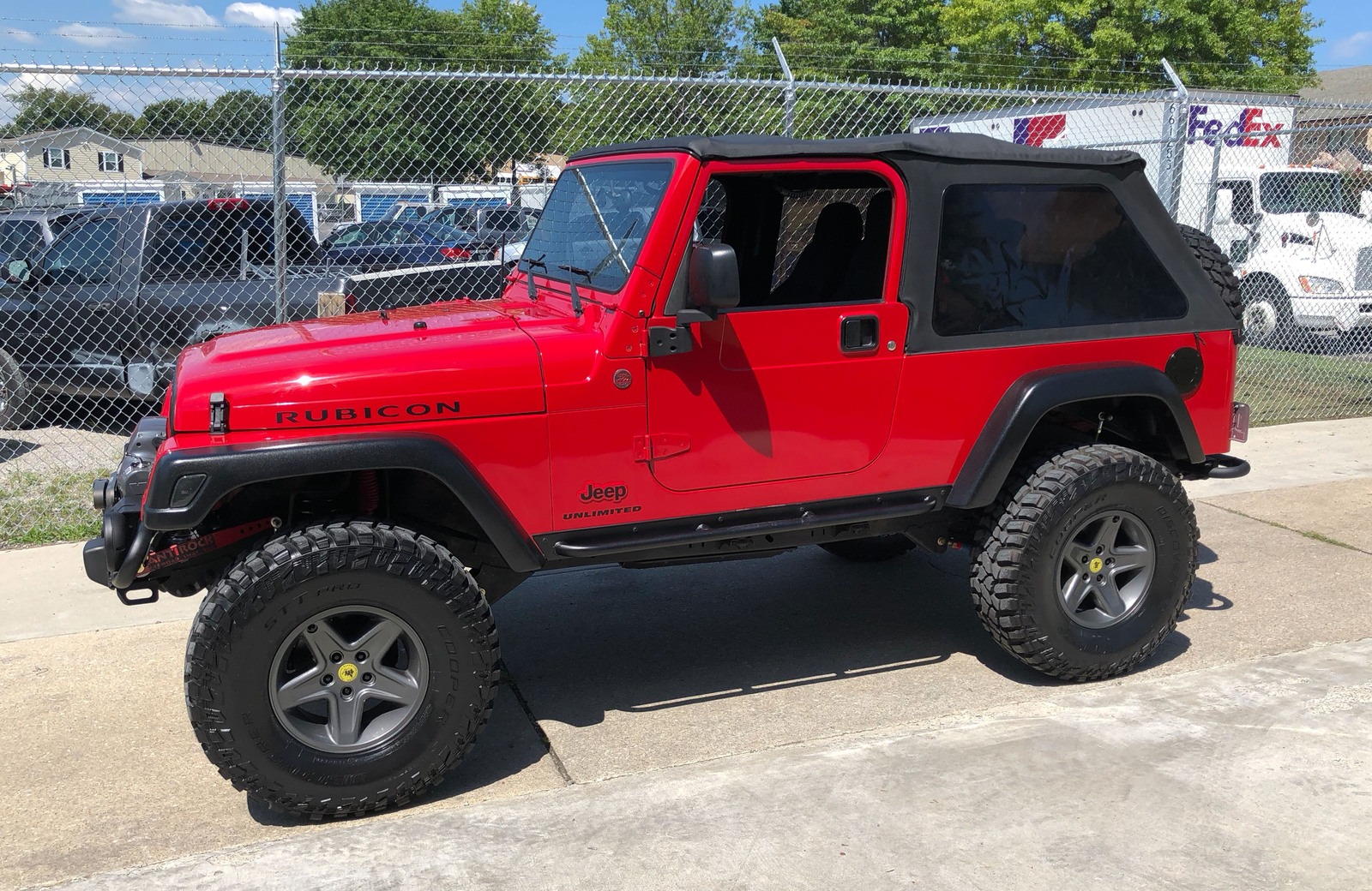

Shot from this morning when I swung by the shop to make sure bolts were still looking tight underneath. Also put away the hard top for a bit and got the soft top on for the nice weather this weekend (fingers crossed!).

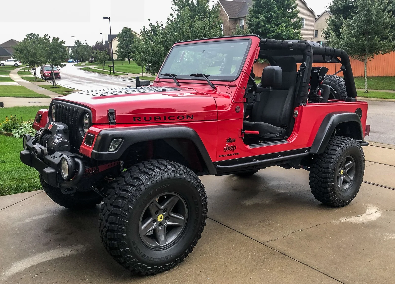

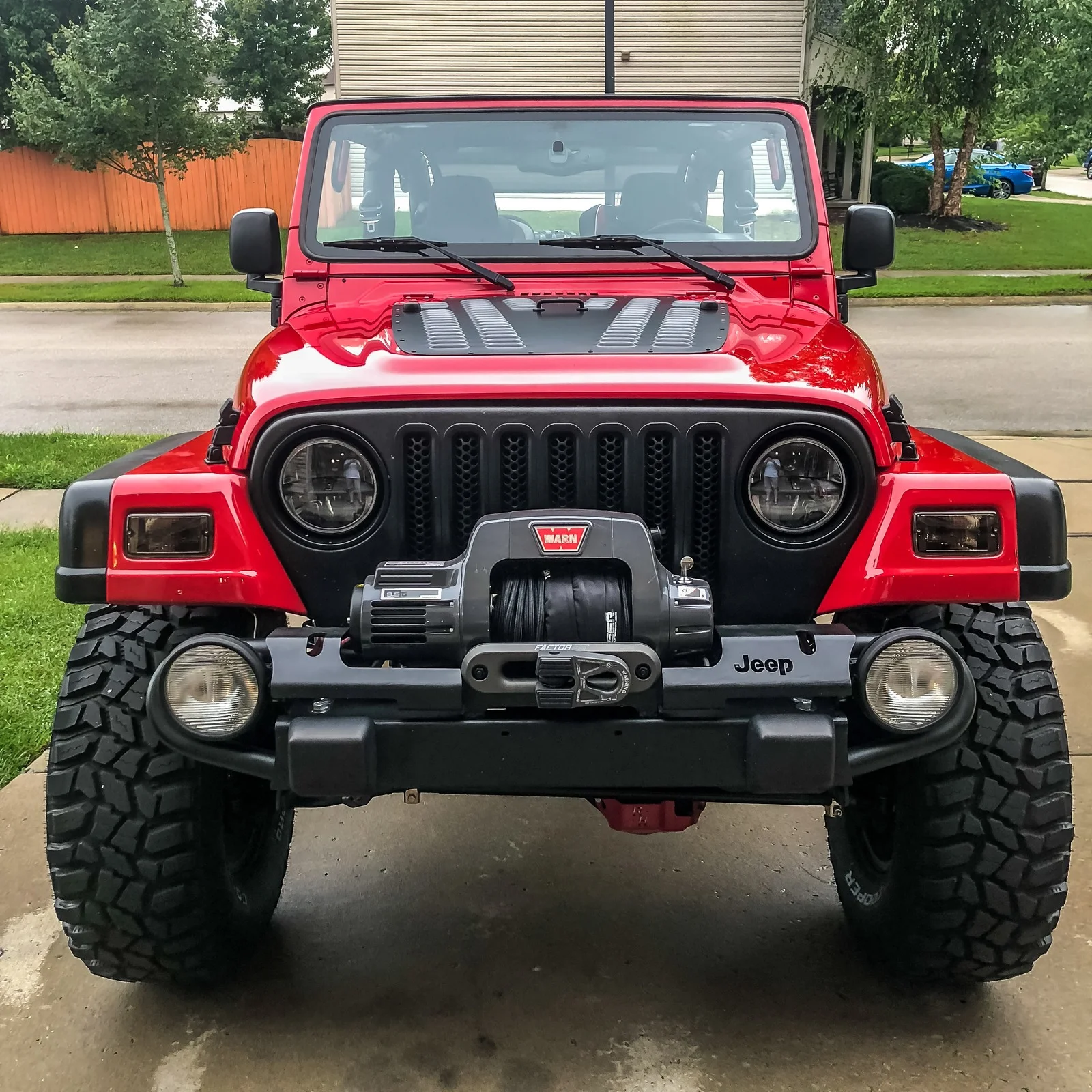

Quick pic before we headed south to TN. I finally got the front bumper, winch etc mounted (lots of fun getting all this aftermarket stuff to fit that I'll expand on when we get back).
Sitting pretty. I know you were talking about 37's one day but jeez I'm a sucker for the stance of the first picture with the hardtop and 35's, looks so good.
Yeah, she's the pretty girl at the prom right now. Don't get me wrong, I love the setup currently, and I really don't see a reason to go up right now, but its crossed my mind a few times. I may end up putting 37s on the JL to satisfy that urge and leave her be.
Reactions: Starrs and tomtaylz
I love your LJ. Like a ton haha. You did a phenomenal job. I have said this in the past about disliking trek tops unless they are on an LJ. I like the way it looks with the trek top more so than the hard top. Such a cool look. Decals look killer too. The Bridgers make it pop. 37s would be awesome, but def not needed right now. Keep it up!
I had to hit the ground running this morning for work but really enjoyed our family getaway to the Great Smoky Mountain Jeep Invasion. Thousands of jeeps and I got to meet the owners of some other LJ builds I follow as well as see some products in development for our JL Rubicon.
Originally I had planned to trailer the LJ down but the car hauler I was going to borrow fell through a few days before we needed to leave so I opted to just drive it with my wife following in the JL. At around 4 hours each way through some decent elevation changes in the mountains of KY and TN the LJ did well. The ride is pretty fantastic with the Currie/Savvy setup paired with the Rancho 5000x shocks. I still need to tweak my front and rear Antirock setup but I feel that some of the roll I originally noticed seems to have faded away as I've gotten used to how it drives. The 5.38 gears are great and allowed me to have a usable overdrive (right around 2700rpms at 75mph). I'm experiencing no vibrations which makes me happy as essentially everything underneath but the axles is new. Having not really driven it much since the purchase back in April, getting to drive it around with the doors and top off for four days was a welcomed experience. All of the thumbs up and people wanting to take photos definitely made some long hours in the garage feel more appreciated and justified.

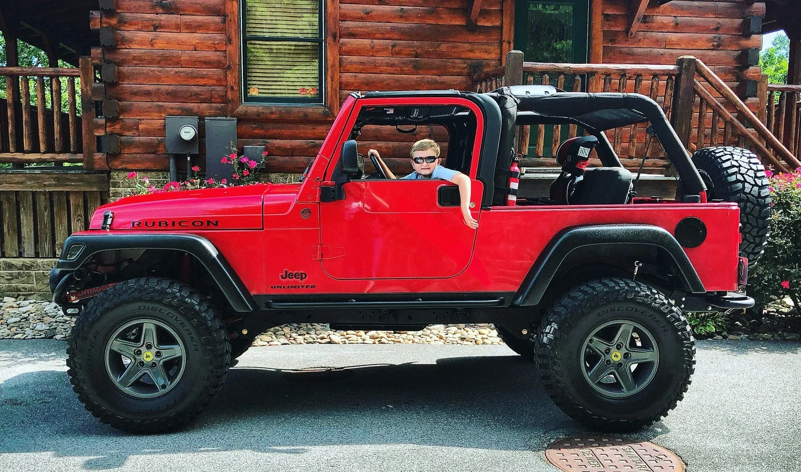

Here's a pic of my Co-Pilot in "his" LJ. He loved seeing all of the jeeps this weekend and was truly a kid in a candy store. He chose to ride with me down and back but didn't want me to tell Mama that he liked my "old school" jeep better than hers.

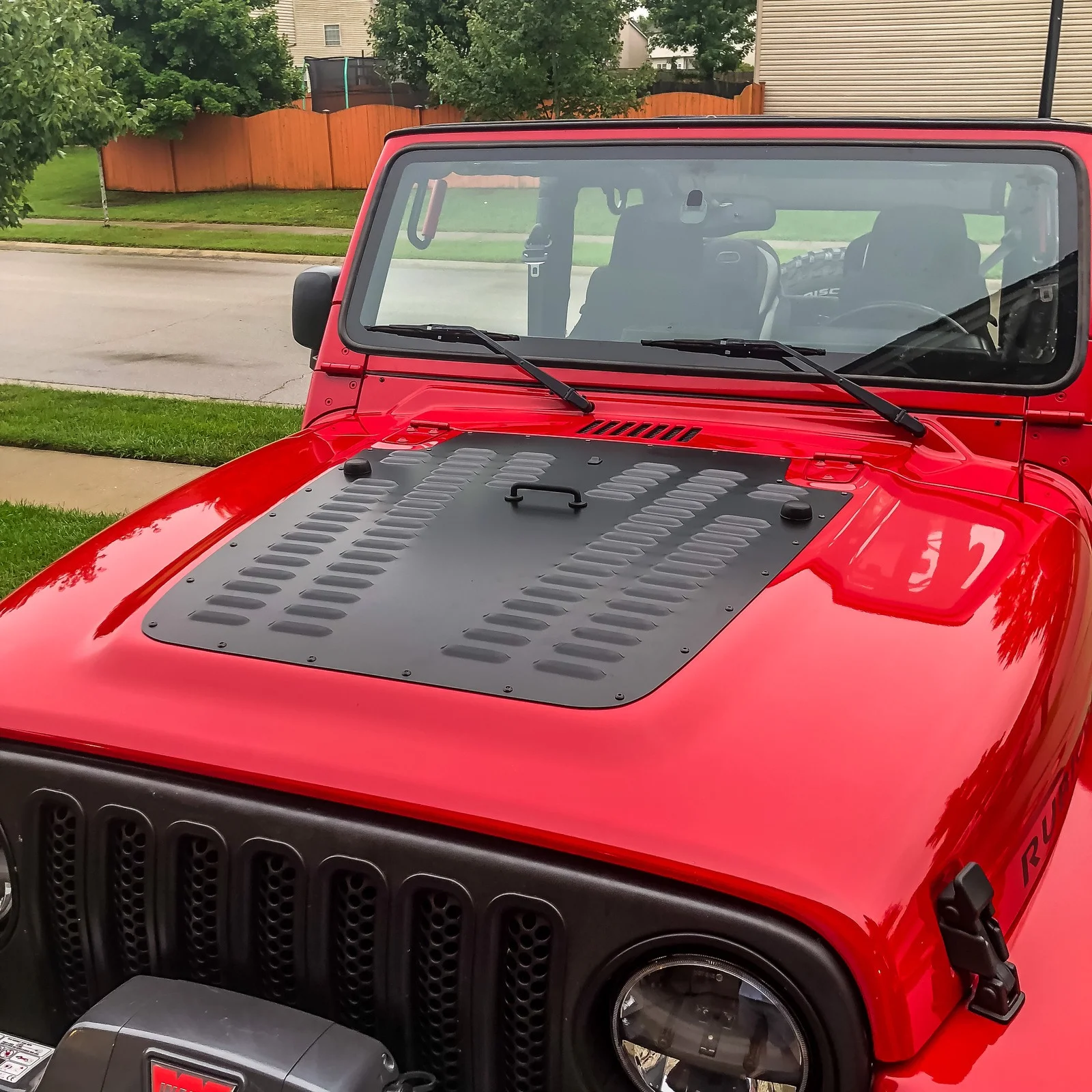

I had some time this afternoon to mess around in the garage so that gave me a chance to finish up the whole hood louver install using the GenRight version. I ended up going with this one versus the Poison Spyder because I didn't necessarily want the logo on the hood piece and I tend to think the louver pattern of the GenRight piece is a little cleaner. I do think the install takes a bit longer than the PS piece because you have to cut and fit the washer nozzle (PS offers a version for the one piece or two piece nozzle setup) and I opted to drill out the 26 bolt holes to fit a 10-32 black oxide buttonhead screw versus the 1/8" hole for a smaller buttonhead or pop rivets (no stainless exposed bolts messing up my color-scheme allowed!)
All in all I'm really happy with it even though it did take more time and trouble than I originally anticipated.
