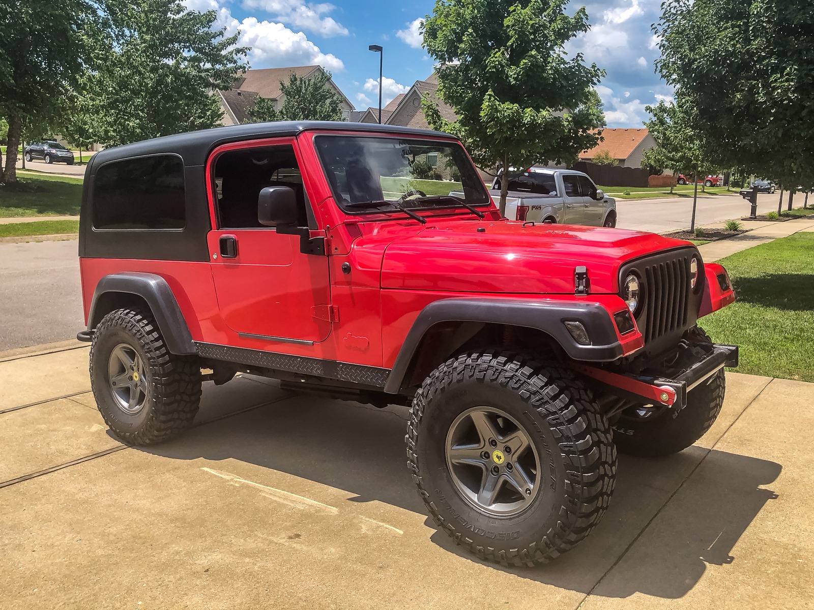

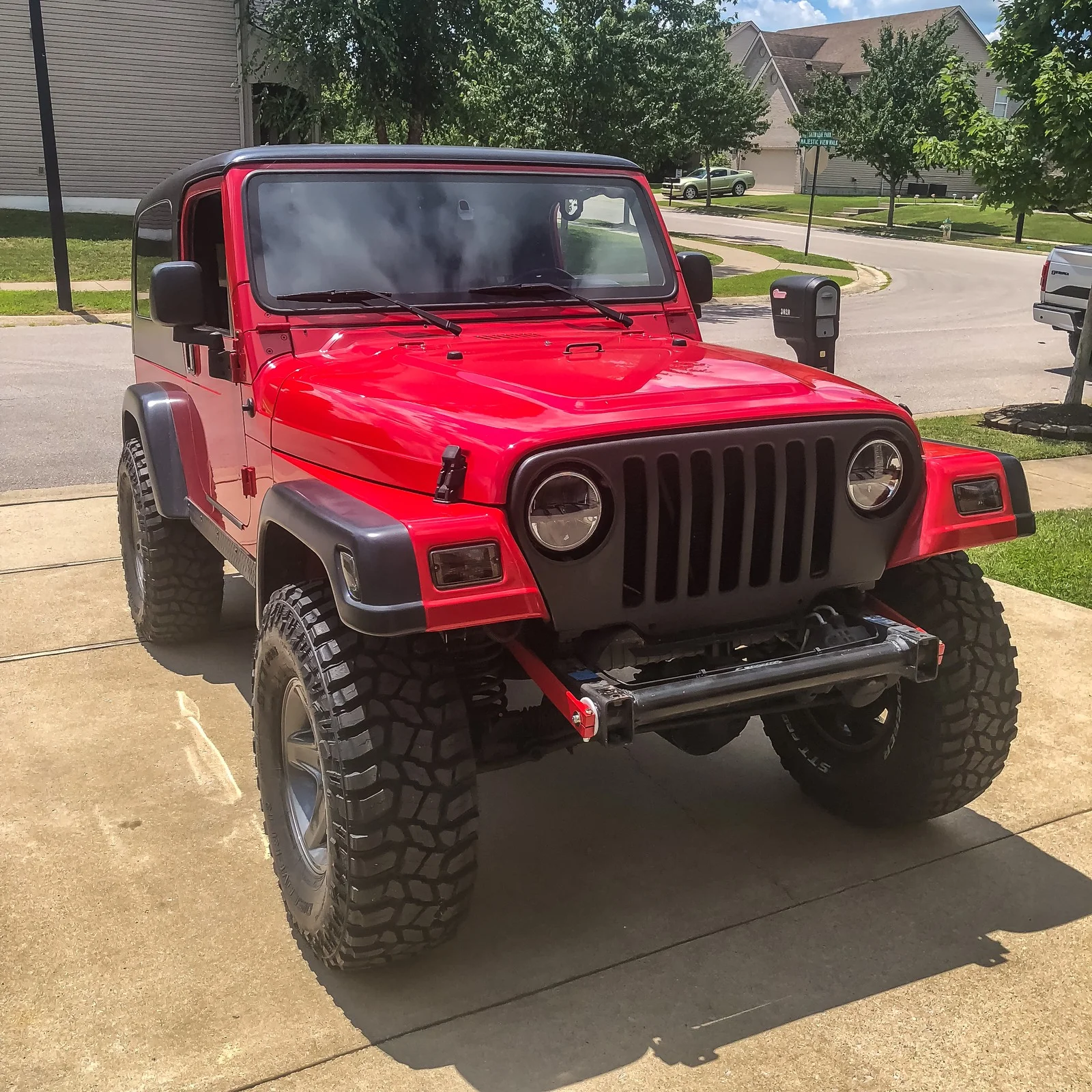

I spent yesterday afternoon installing the Savvy 1.25" body lift. The process was pretty straightforward but even after keeping one side loosely bolted while I worked on the other I ended up with the single body mount under the front grille being shifted around a 1/2" or so too far back. It puts the bolt in enough of a bind that you can thread it in to grip but not much past that. Any suggestions on a way that I can get it realigned?

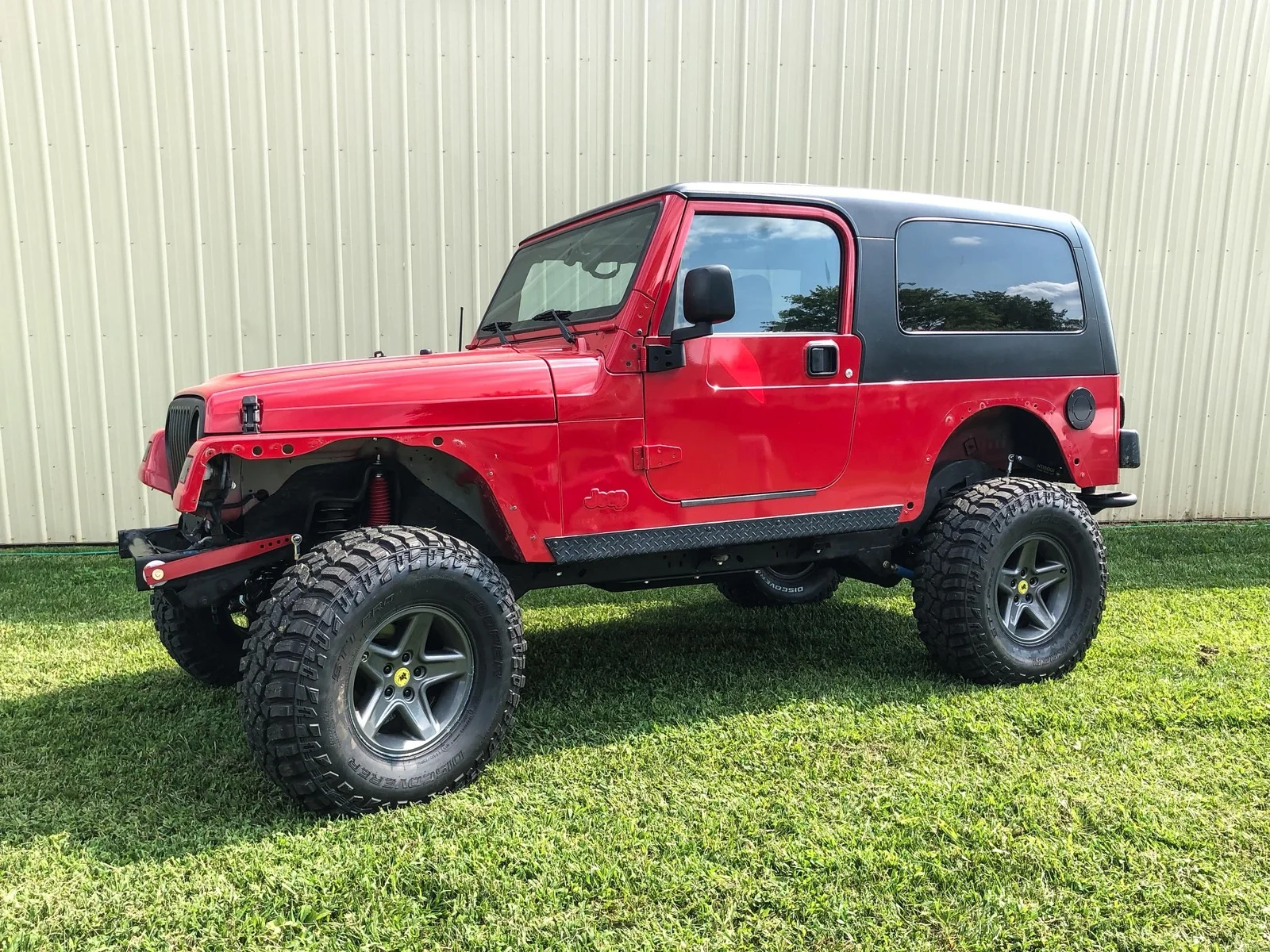

I still need to pull the old 2.5" suspension lift and get the Savvy/Currie 4" setup installed but with the body lift on I wanted to see what the wheels/tires looked like. There isn't room to flex at this point but they're on there at least........
Looks totally different with the polished wheels and tires gone and I'm getting a little encouragement that I might actually get all of this done. The goal tonight is to install the motor mount lift from Brown Dog Offroad and to remove the flares for coating and the side rail guards to replace with the Mopar Sliders. At some point I'll have the entire paint buffed and polished as its in pretty good shape now and I'd like it to last.
I'm going to have to take a little more off of the cuts I made to the Mopar Rock Crawler bumper for the AntiRock system. Its close but needs a little more breathing room.

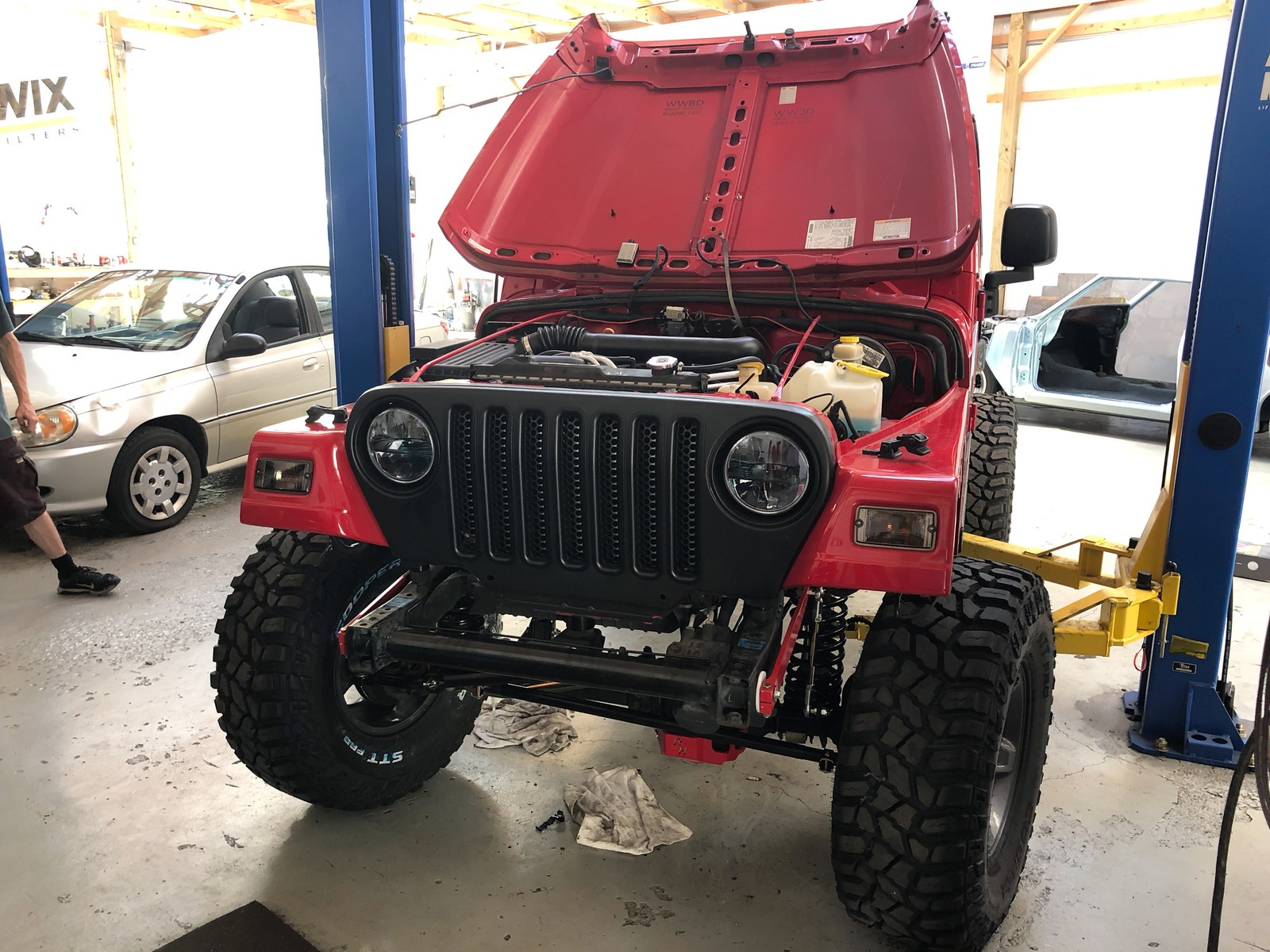

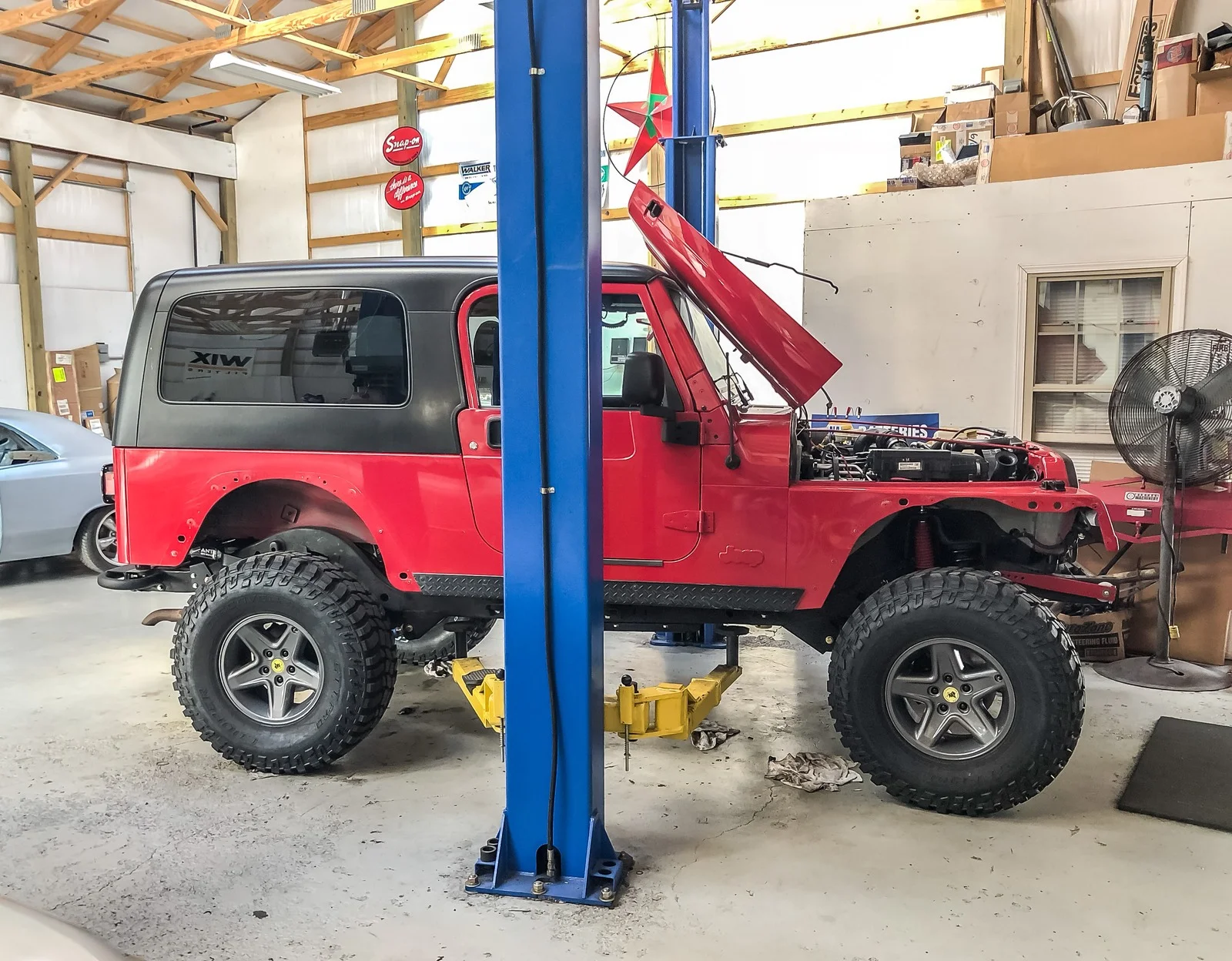

So Friday afternoon I took the LJ to a local garage that has a long history with Jeeps and left it so they could start on it first thing this morning. I went by around lunch today to drop off some small parts I had forgotten to take and got to see it up on the lift.
As much as I wanted to (and enjoy doing) the majority of work myself, leaving it in their capable hands is going to ultimately having me and the family enjoying the Jeep a lot faster.
While its there they'll be installing all the suspension upgrades, motor mount lift and tummy tuck, fixing an oil leak and general maintenance, new brakes and rotors, regearing both axles and replacing ball joints, unit bearings, axle seals etc. Once all of this is complete I'll have the paint machine polished and waxed then start to finish the cosmetic upgrades, decals, rear tire carrier, front bumper etc.
I'm moving back towards the "excited" category versus the "anxiety" one. Stay tuned for more pictures hopefully soon!

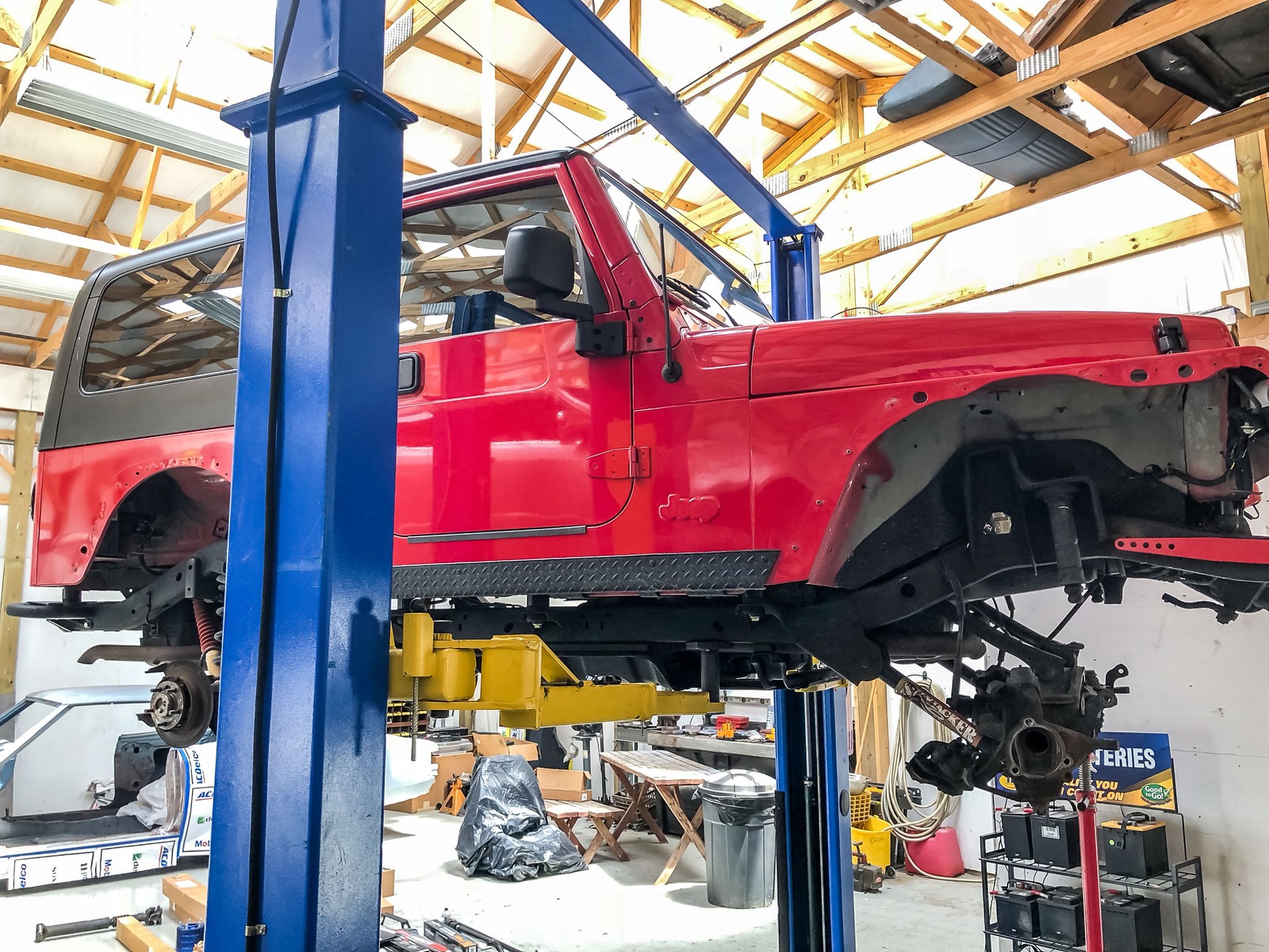

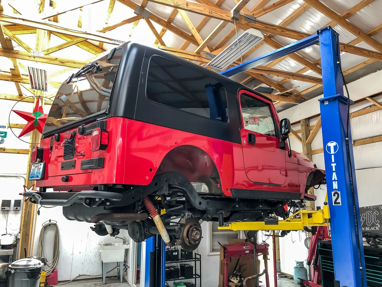

Stopped in yesterday to check on the progress as she's just about finished up. This is her back on the ground for a bit before they centered the axles and adjusted the wheelbase/pinion angle. I didn't think it would be as tall as it is but I'm sure that will change a little once the bumpers, spare tire etc are back on. (Kinda makes you want 37s doesn't it!)
They ended up replacing the rear main seal and oil pan gasket so hopefully the garage floor will stay clean.
Of course there were a few hiccups along the way such as having to shorten the exhaust bend coming around the oil pan so it didn't hit the front upper passenger side control arm, dealing with some spinning skid plate nutserts etc.

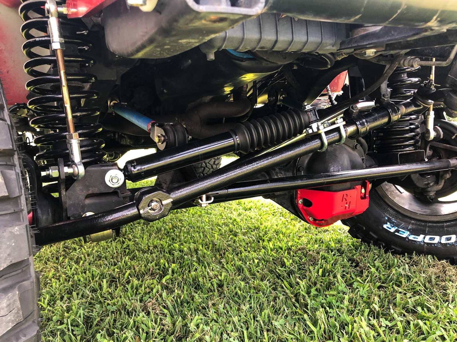

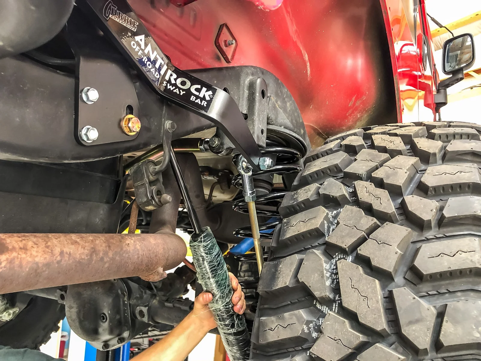

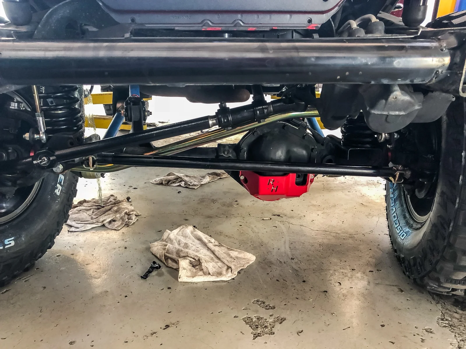

I went ahead and had a rear Antirock installed along with the front. (It isn't set up properly in this picture but will be)
Axles have been regeared to 5.38 but I'm keeping the stock axle shafts at this time. When the pocketbook allows I'd like to change them out to the US made Revolution axles or a Revolution/RCV combo.
I did pick up a Rock Hard 4x4 HardHat front diff cover to give a little protection but allow me to keep the factory diff cover for clearance.

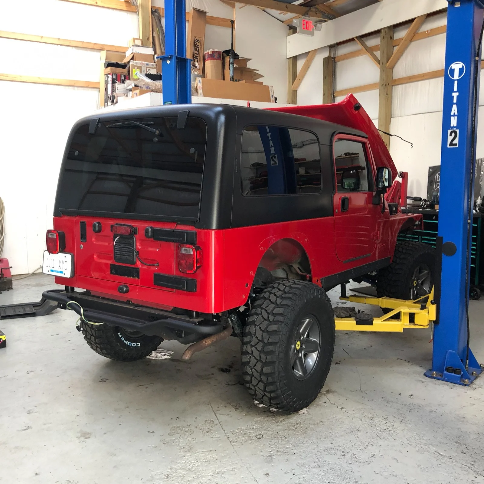

I called Tom Woods and ordered a new rear driveshaft today that should be here next Tuesday. In the meantime I'll probably bring her home this week to buff and wax the paint before installing the sliders, corner armor, flares, bumpers, decals etc. My goal is to have her running smoothly and dialed in so I can take it down with us to the Smoky Mountain Jeep Invasion at the end of the month.
I got the new rear driveshaft delivered today from Tom Woods so I headed out to the shop to drop it off. They've essentially gotten all of their work done so once they get it installed tomorrow and test everything I should be able to bring the LJ home to continue the build.

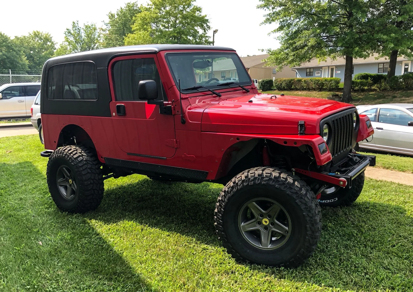

It was parked out front when I got there so I snapped a few pics to show the wife and kids.

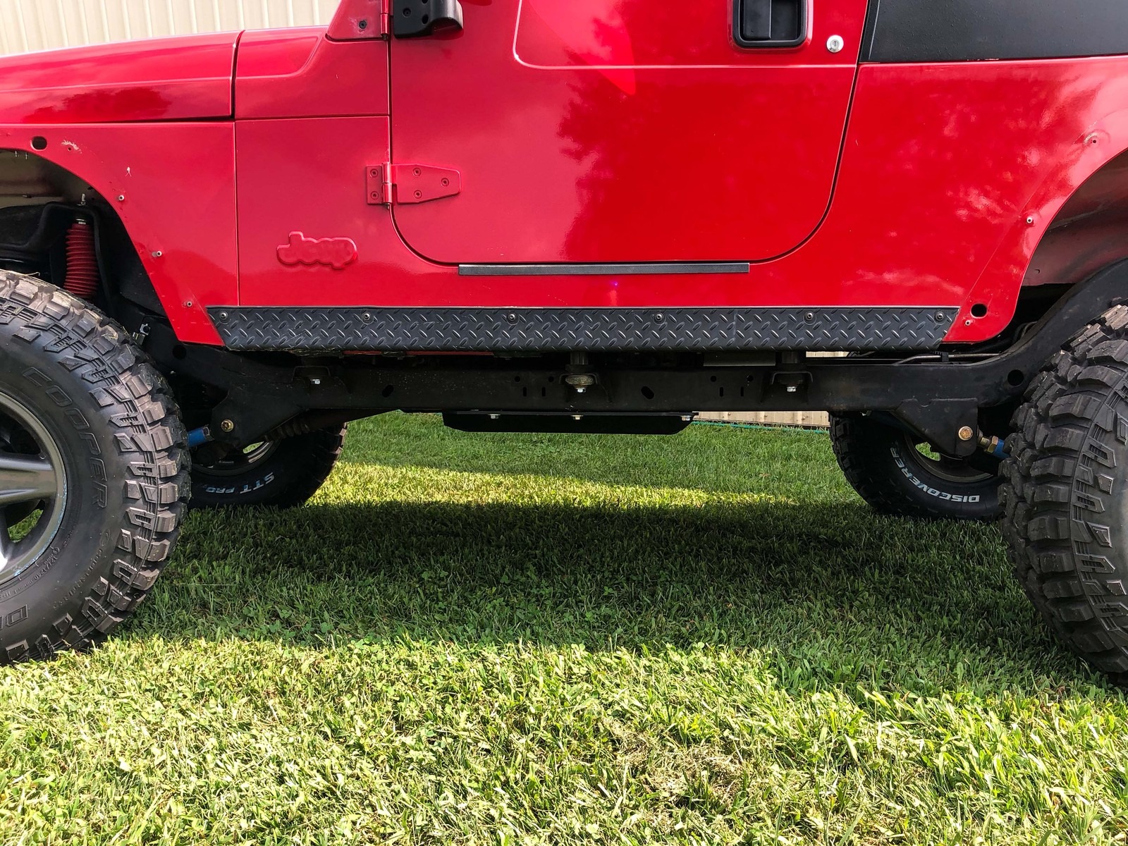

So far I'm pleased with the UCF skid plate I used for the Tummy Tuck. Its not a flat belly but definitely a big improvement from the stock setup. This is the "extra clearance" model that has I believe a 2" drop. With the motor mount lift they said the install went fine.

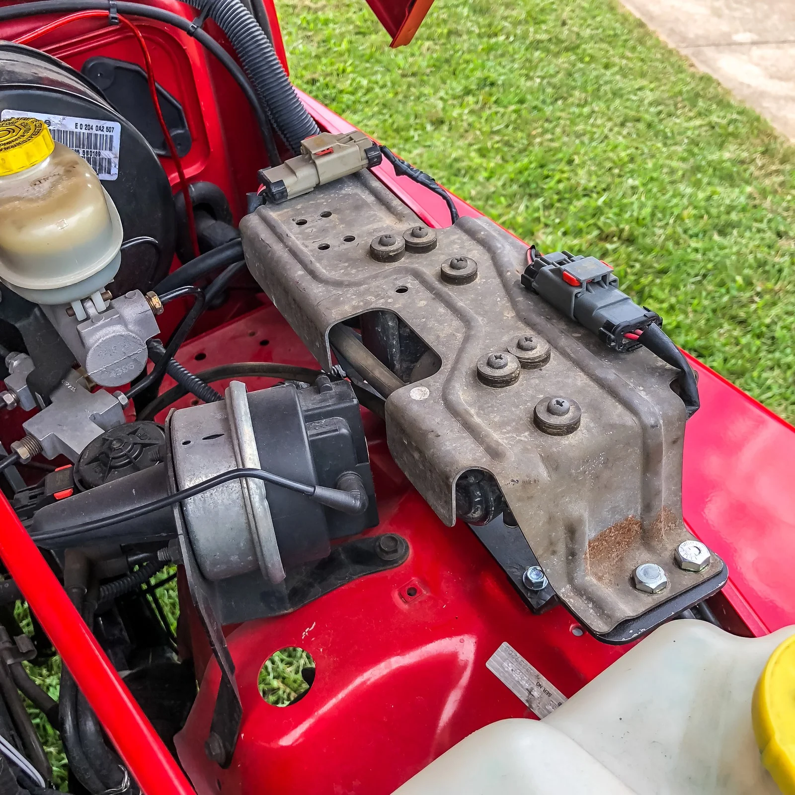

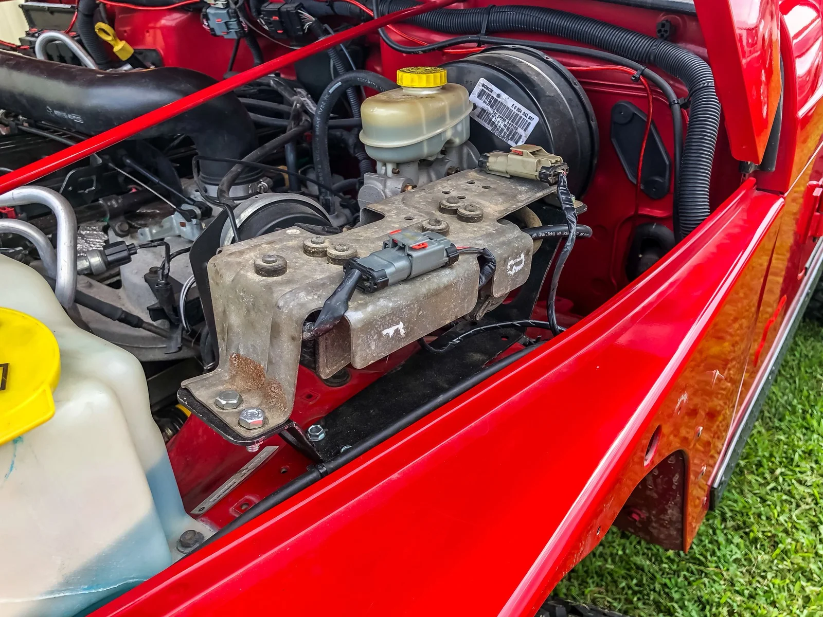

I also went ahead and had them relocate the locker pump assembly to the engine bay. Mounting it inside the skid (even with the bracket I purchased from UCF) was giving them very tight quarters and the relocation allows me to keep them out of the way of mud and debris.
Everything seems to clear up front with the Currie steering and MetalCloak Trackbar.
