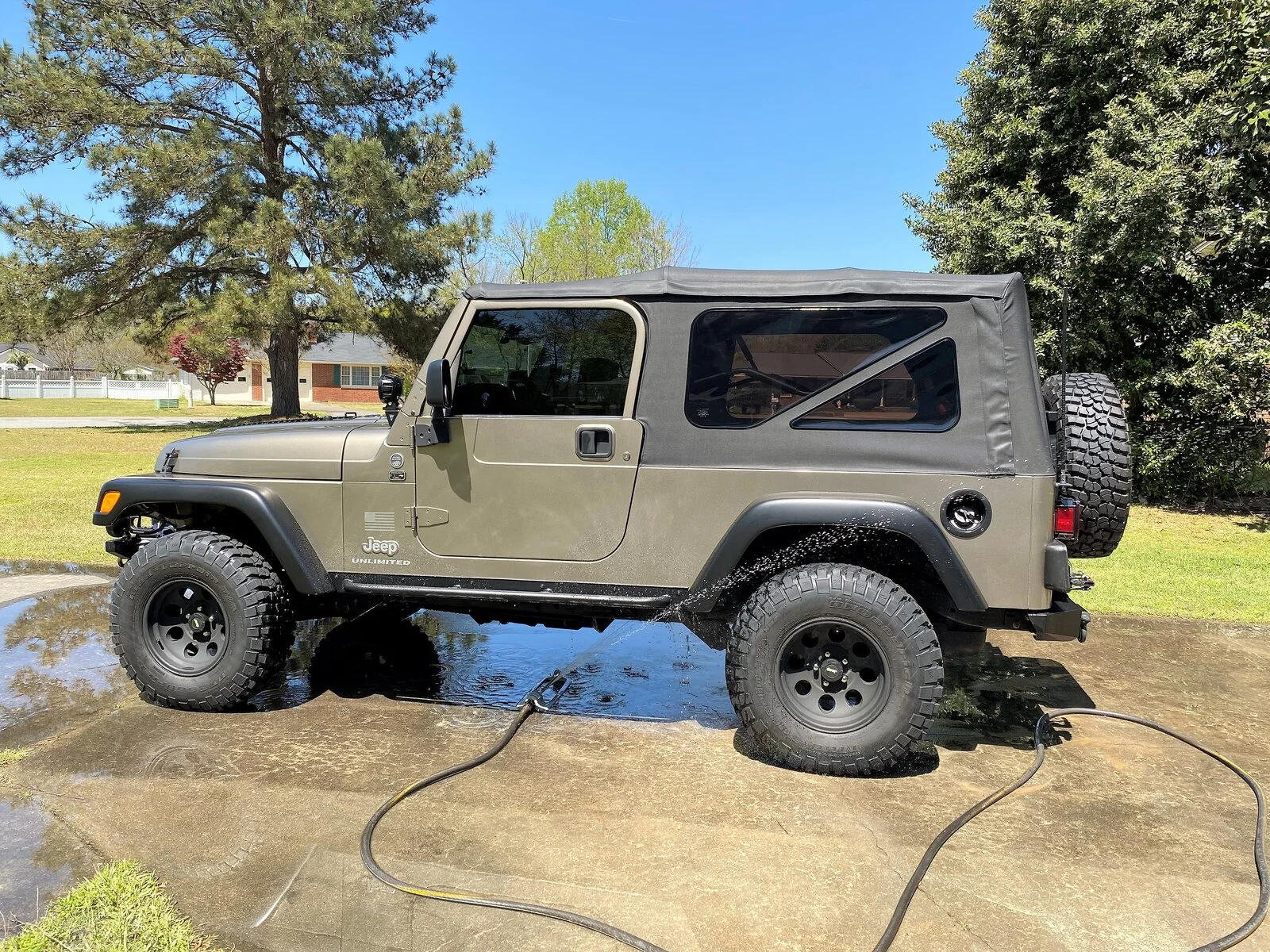

If you have one of those fan spray sprinklers, it will help clean the underside some. I do that after making trips to the Outer Banks and driving on the beach. Just move it around in 4 or 5 places for about 15 minutes each.
By the looks of your jeep, you're going to have a lot up mud under it to clean out/off.
