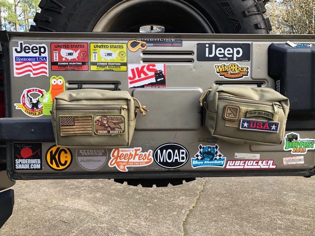

Add some spare MOLLE bags with spare spiderweb shade ball thingies:

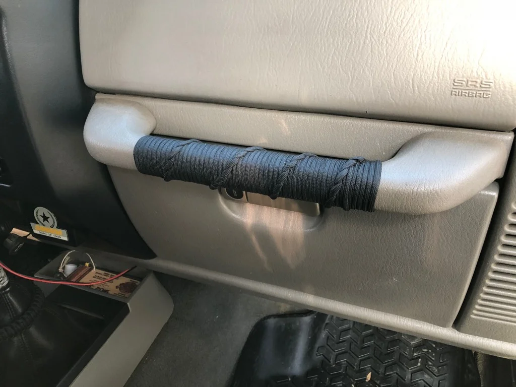

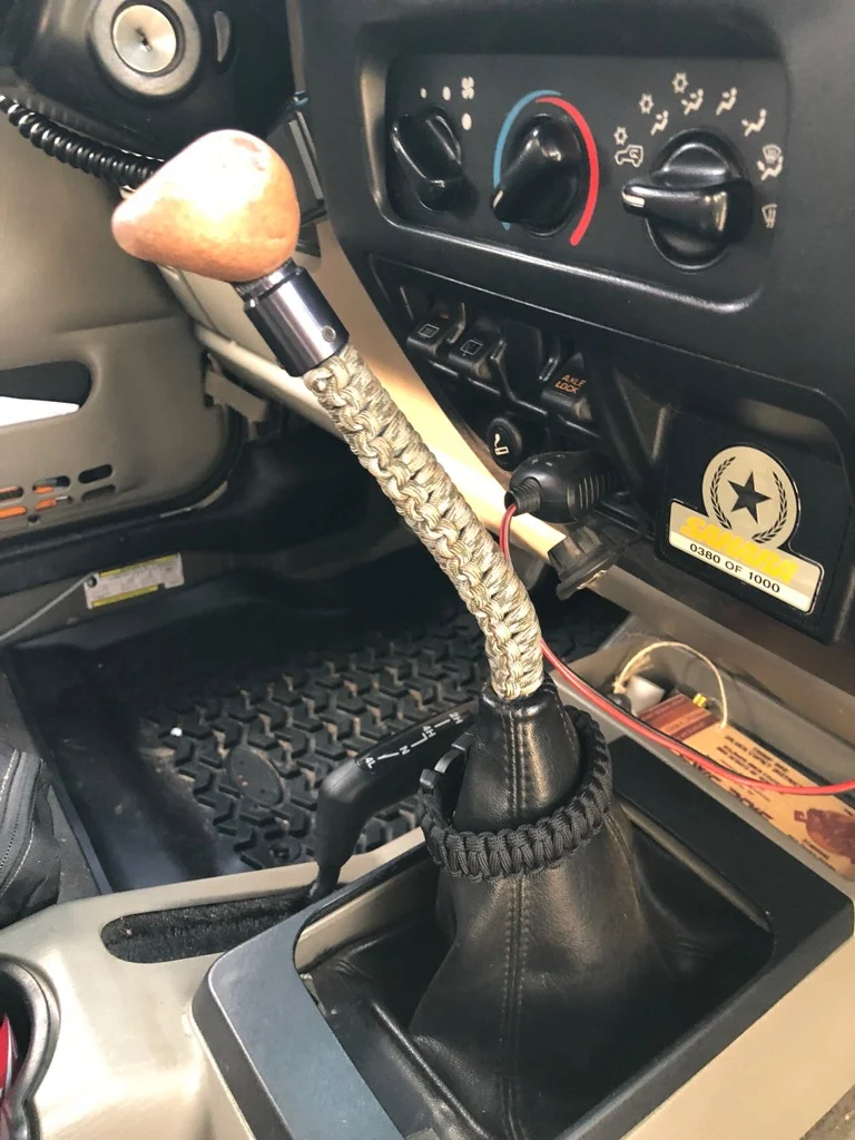

Fun with paracord:

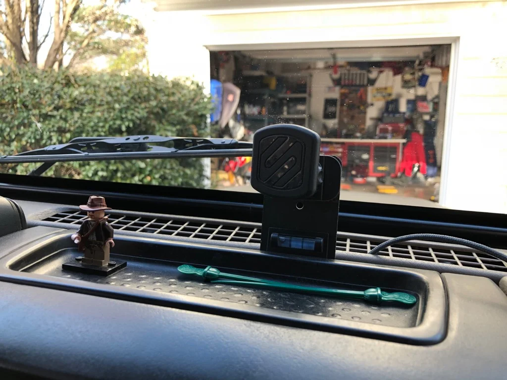

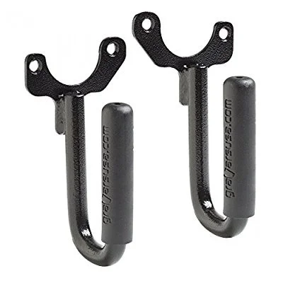

Phone mount from an old garage bracket and a scotchie magnet mount:

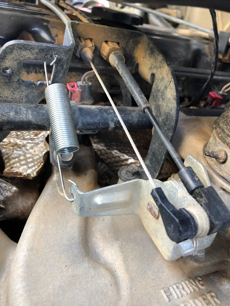

Throttle return spring. Springs came in a pack from Autozone, Dorman throttle springs, enough for my Jeep and a few friends:

Does the cruise control still play nice?

What does adding that spring do?
Before the extra throttle spring my gas pedal was extremely touchy. Hit one little bump off-road and i felt like I was always giving it too much pedal. Extra spring stiffened it up like my accelerator pedal on my 04.

Yes I have the same feeling on my throttle. What we call ‘Stiction’ in aviation; friction then release, then a little too much gas. I’ll find a correct spring..

Perfect way to describe it! Spring kit I bought had a few different weight springs so I was able to experiment some till I could find what I liked.
