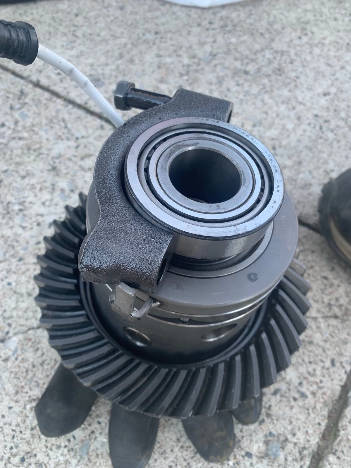

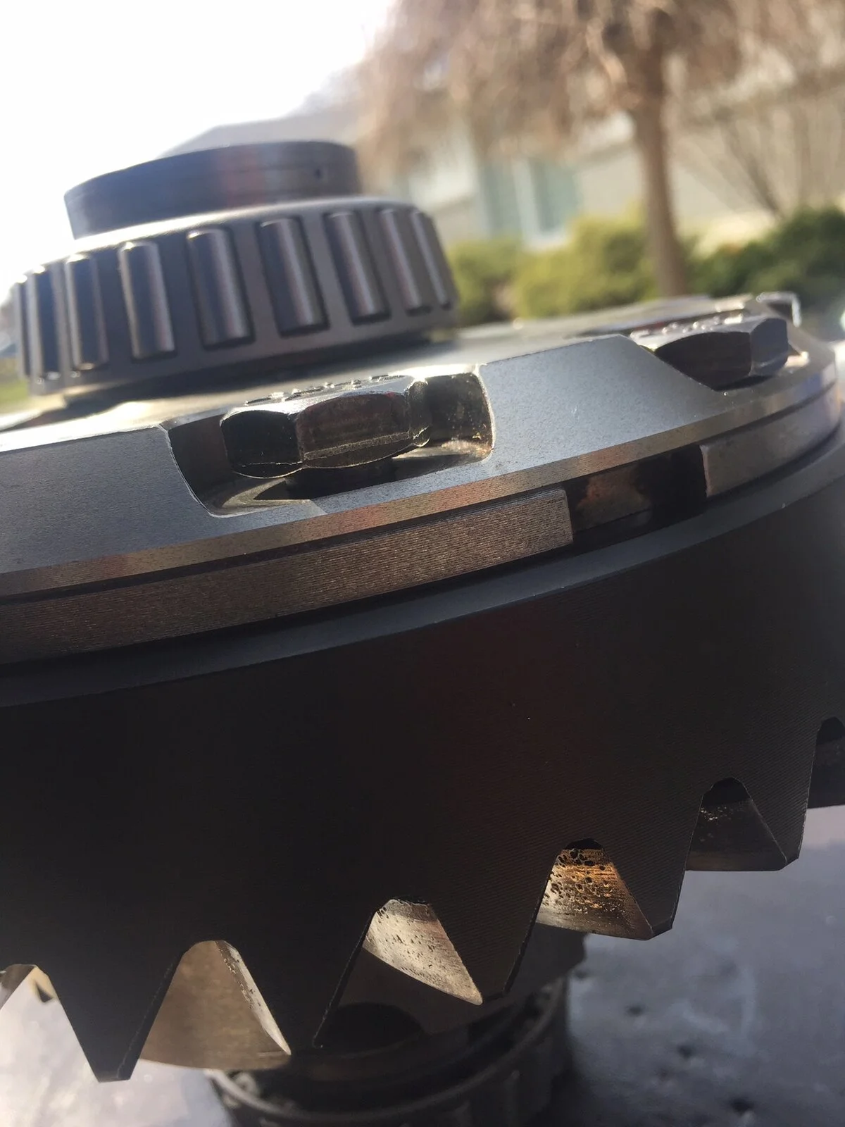

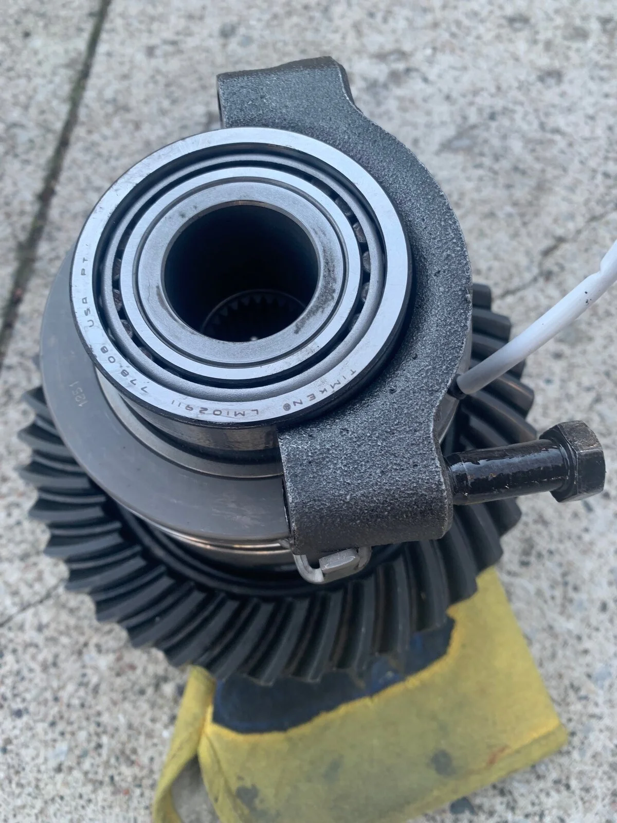

In the process of swapping my open dana 30 carrier to a locker. After a regear how much should the backlash open up if any at all, I am measuring around 14.5-15 thousandths which seems like a lot. It has run flawlessly for the last 20k km. Thinking I should slap it back together, and go no front locker or just get a lunch box if that spec seems way off. Don't want to open up a new can of worms after just doing the regear a yr from next month haha. No shavings in the gear lube and no obvious wear. @hosejockey61 @Blackjack any ideas? Thanks!
