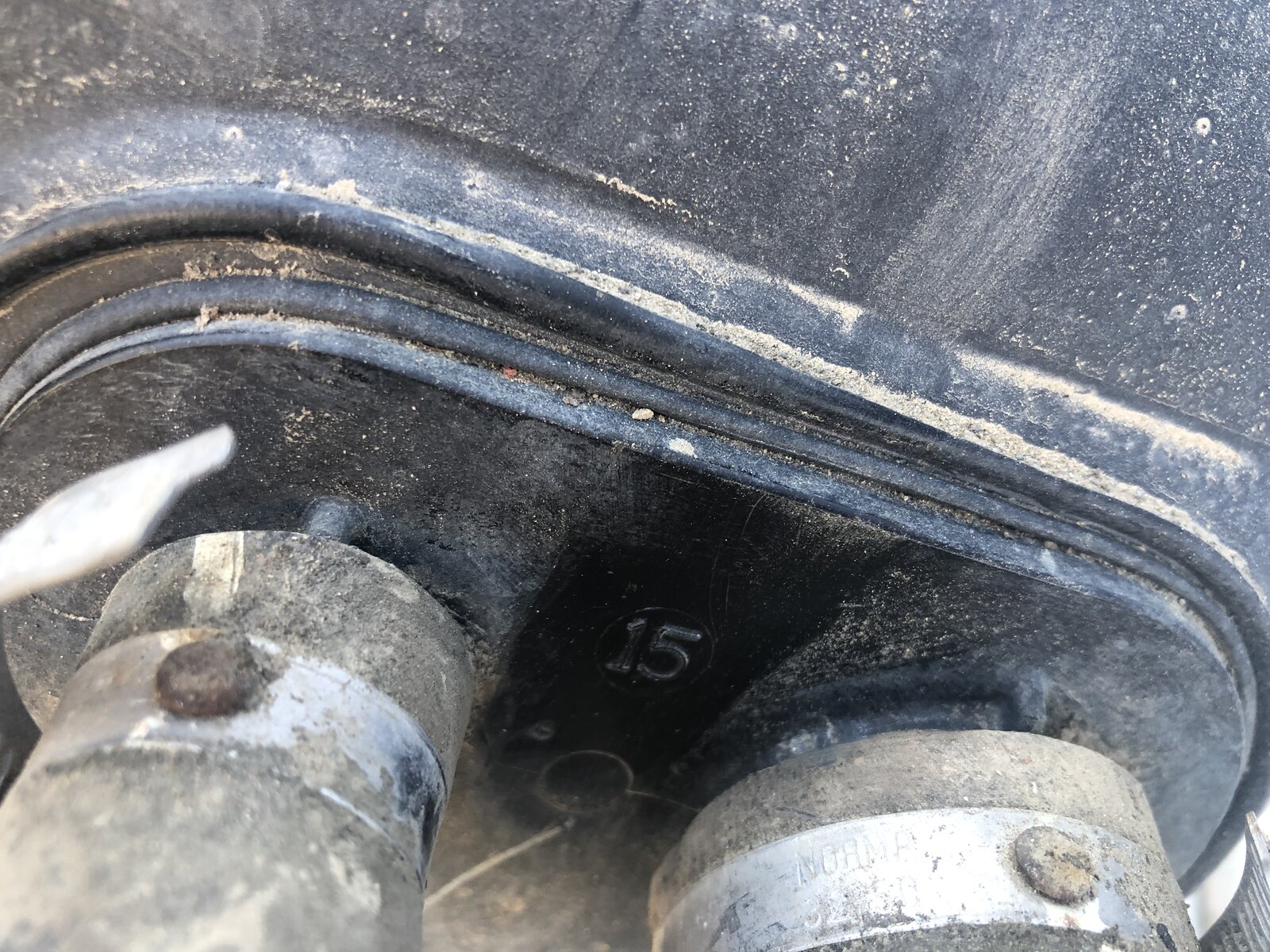

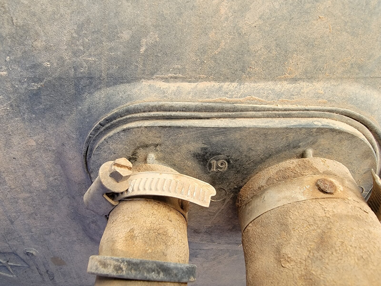

All right thanks guys. I am dropping the tank now. I was just wondering if I needed to chop it or not, but if it is truly a 19 it is probably already short. Thanks for the advice as always.
Look between the fill and vent hose on the tank. There will be a 15 or 19 stamped there.

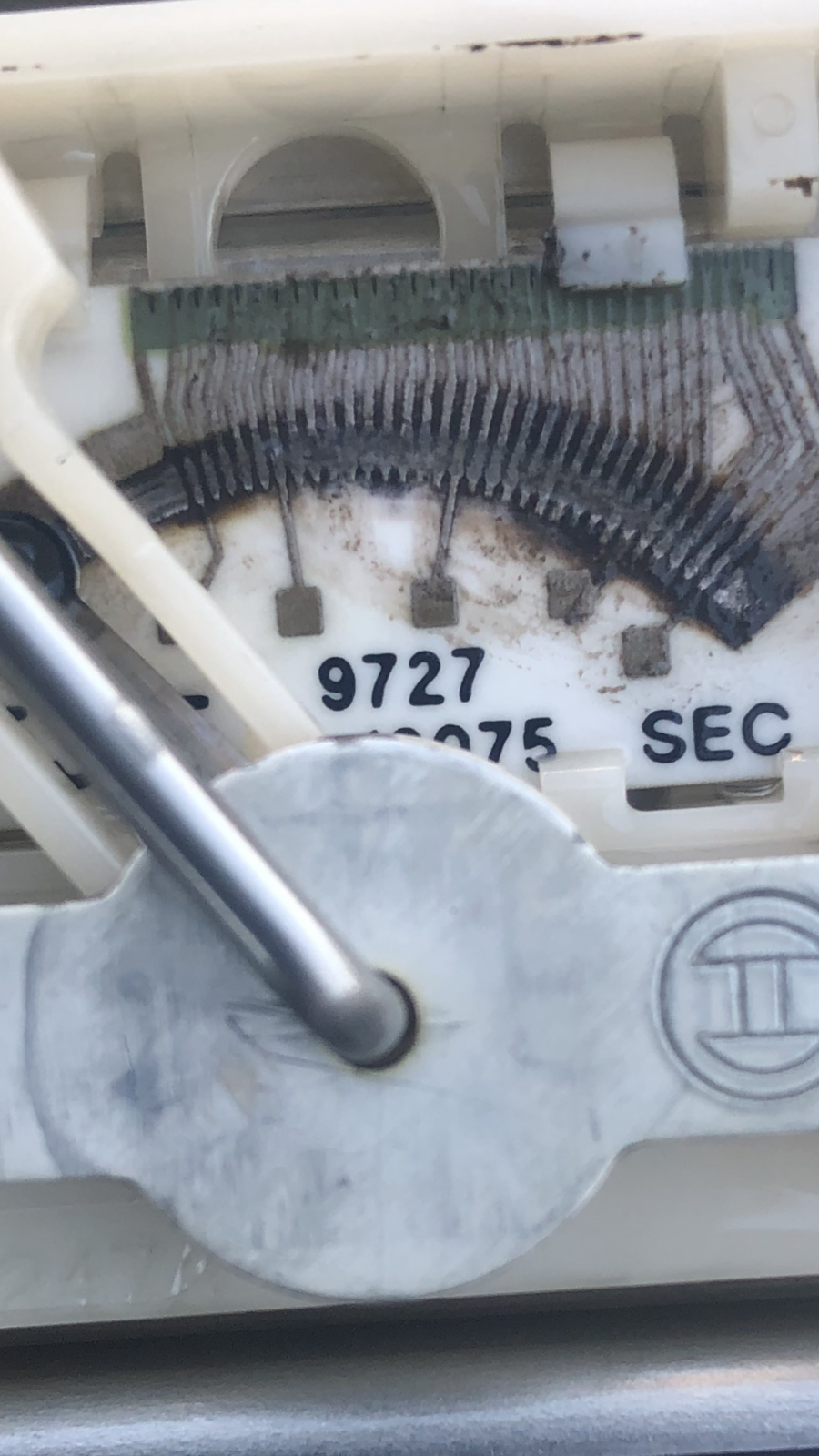

The common misconception is the light coming on and we think it’s on E. It’s not, it’s on 1/8th. It is just reminding you to look for a station before too long. Me changing my sending unit had to do with the erratic behavior my gauge had. My sending unit was pretty much worn out.

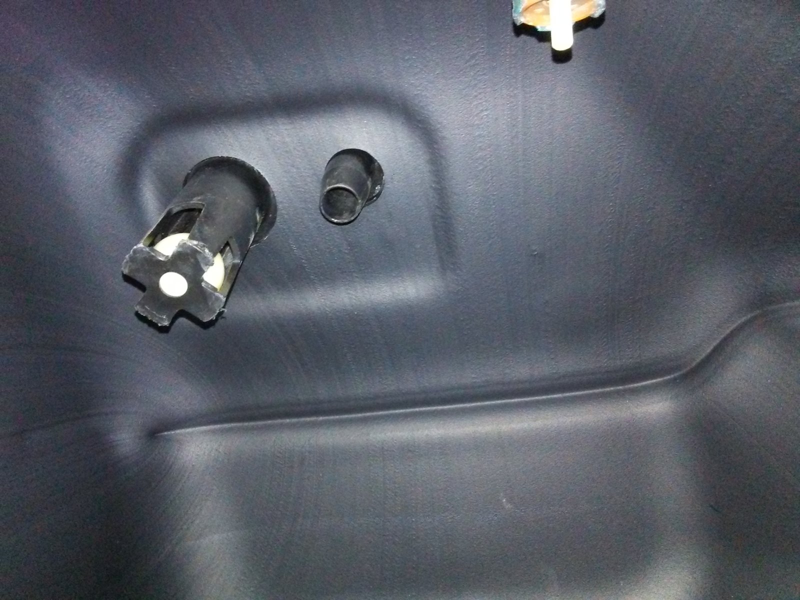

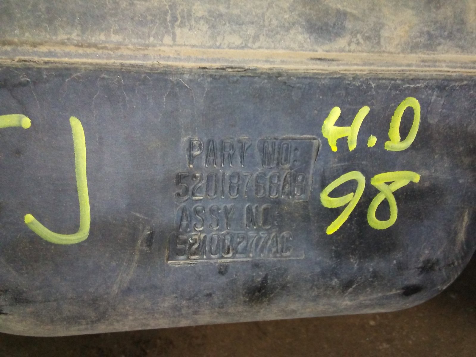

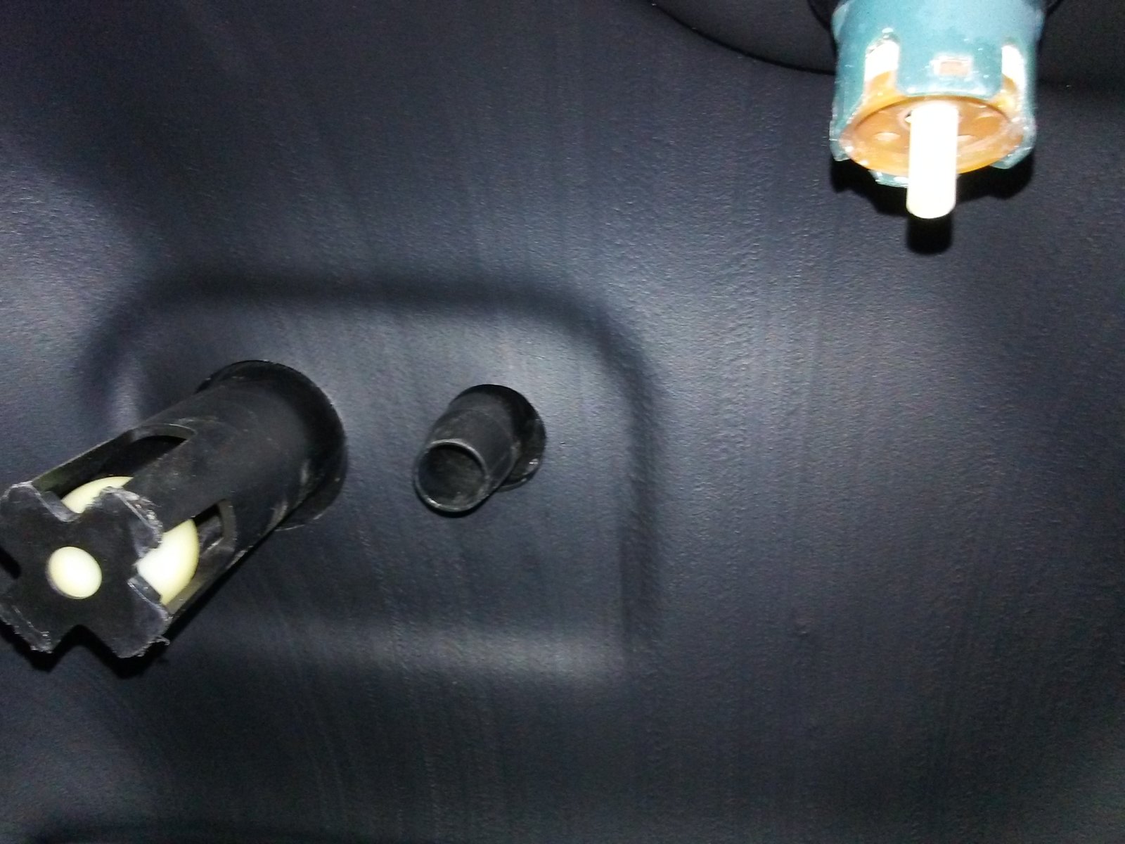

It turns out that I did not keep the fuel tank that I modified, after seeing some damage to the tank in two places. But this is a plus for this thread, since it allows a clear comparison between the two fuel tanks that Jeep offered on 1997-1999 Wranglers. Yesterday I went to FN Jeep in Colorado Springs and bought a stock 19-gallon fuel tank from a 1998 4.0L. It is part no. 52018768AB, what Jeep lists as the 19-gallon tank. You can see the part number in this photo:
The vent tube on the inside extends only a short way into the tank, as this photo shows.

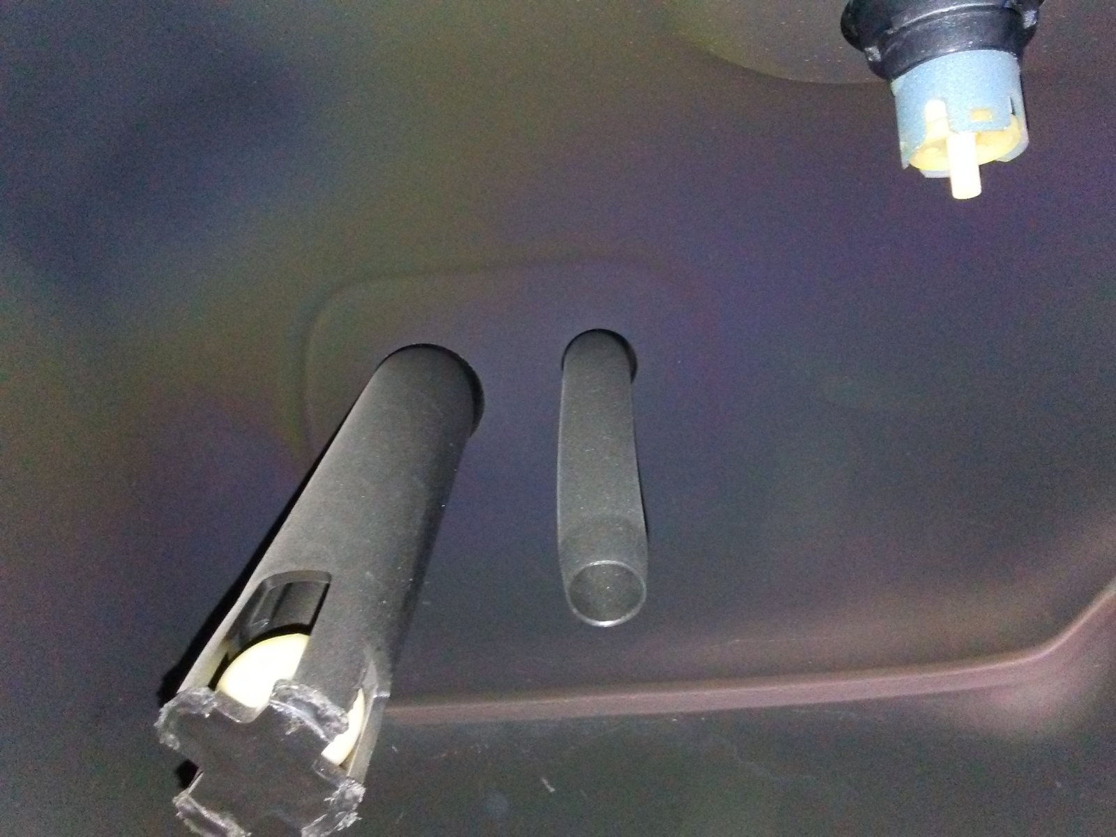

You can also see that the fuel filler tube is considerably shorter than the one on the 15-gallon tank. Here is another picture from the 19-gallon tank, showing this part better.
FN Jeep also had a 15-gallon tank from a 1998 Wrangler, like the one that came with my 1998 SE, pictured in my previous post. According to The 1999 Jeep Wrangler Owner's Manual (I found a physical copy), the 15-gallon tank still came standard on 4-cylinder models in 1999, like it did on the 1997-1998 4-cylinder models. Here is a picture of the inside of the 1998 Wrangler 15-gallon tank that FN Jeep has.
To be clear, both tanks are identical in size. Both have a 19-gallon actual capacity. The so-called 15-gallon tank only has a longer fuel filler tube and a longer vent tube, preventing more than a 15-gallon capacity.
As part of the 15 to 19 mod, does it matter if the longer fuel filler tube in the 15-gallon remains the same length? I'm assuming only the vent tube needs to be trimmed down. Thanks for the great comparison.
