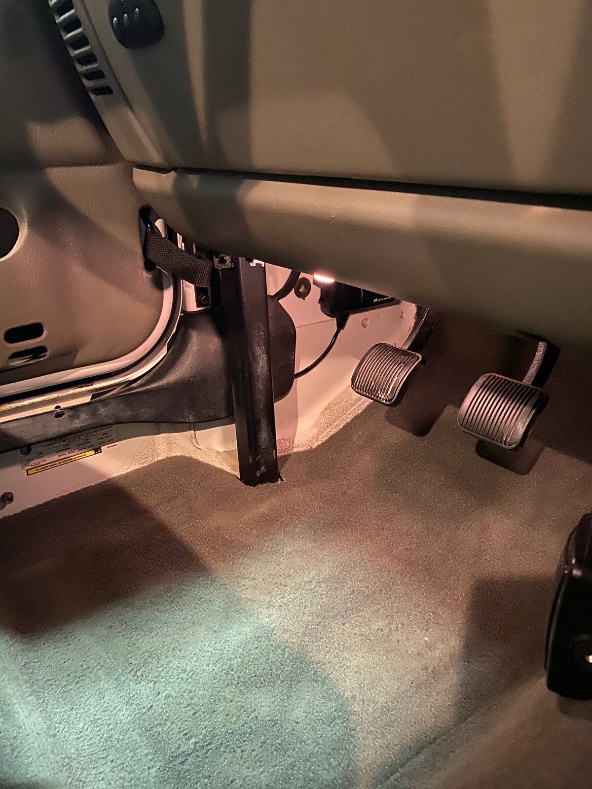

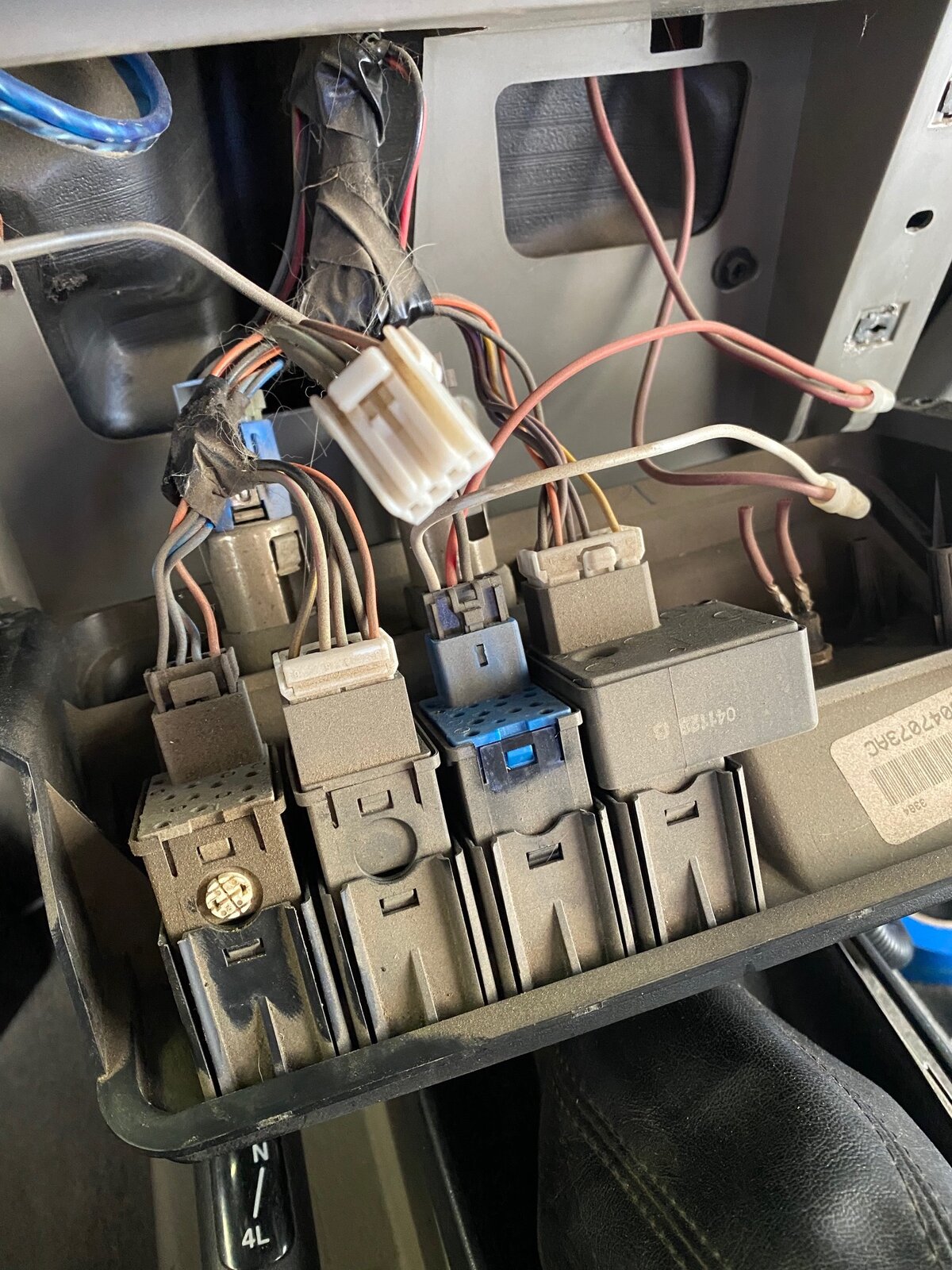

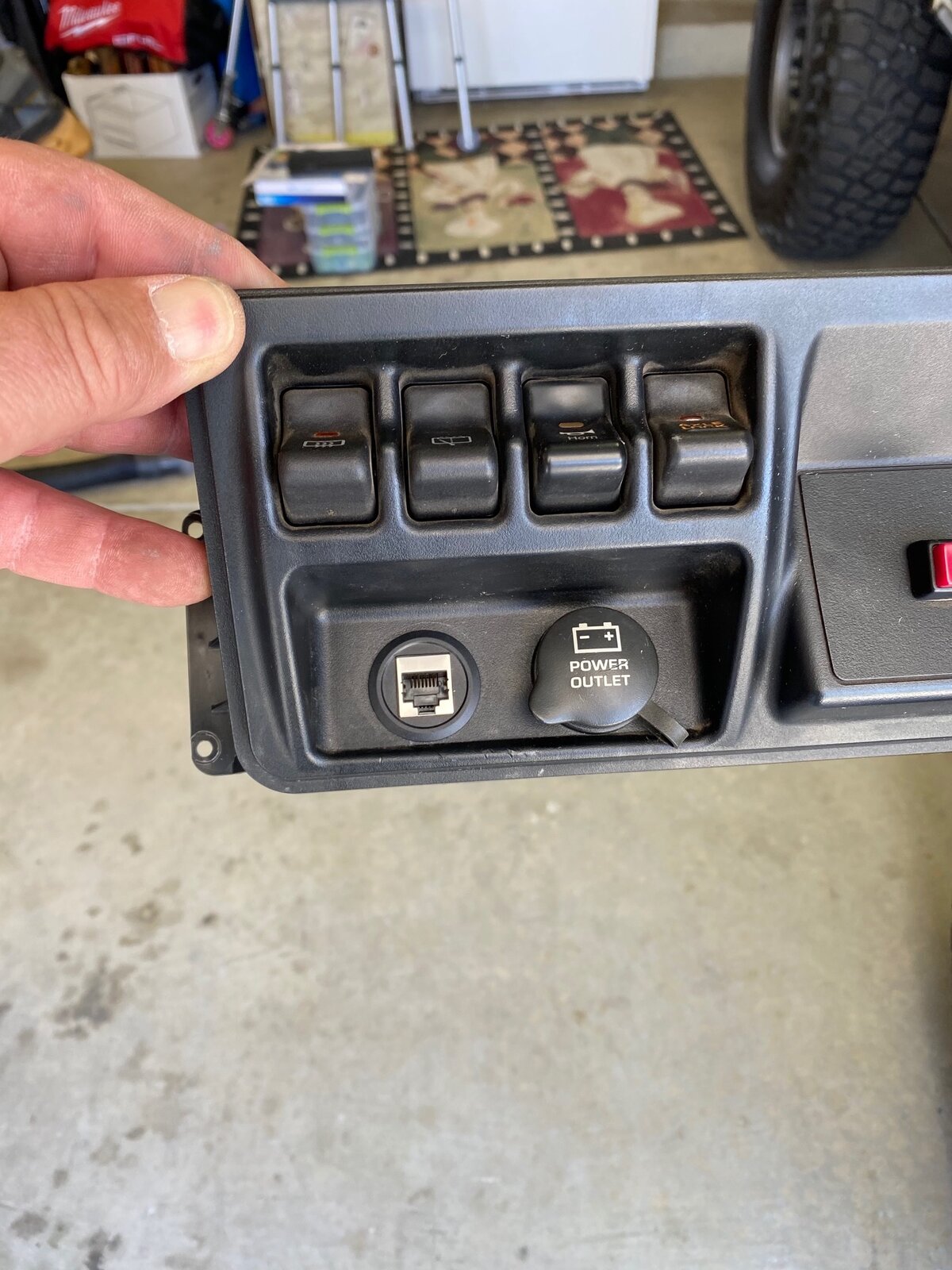

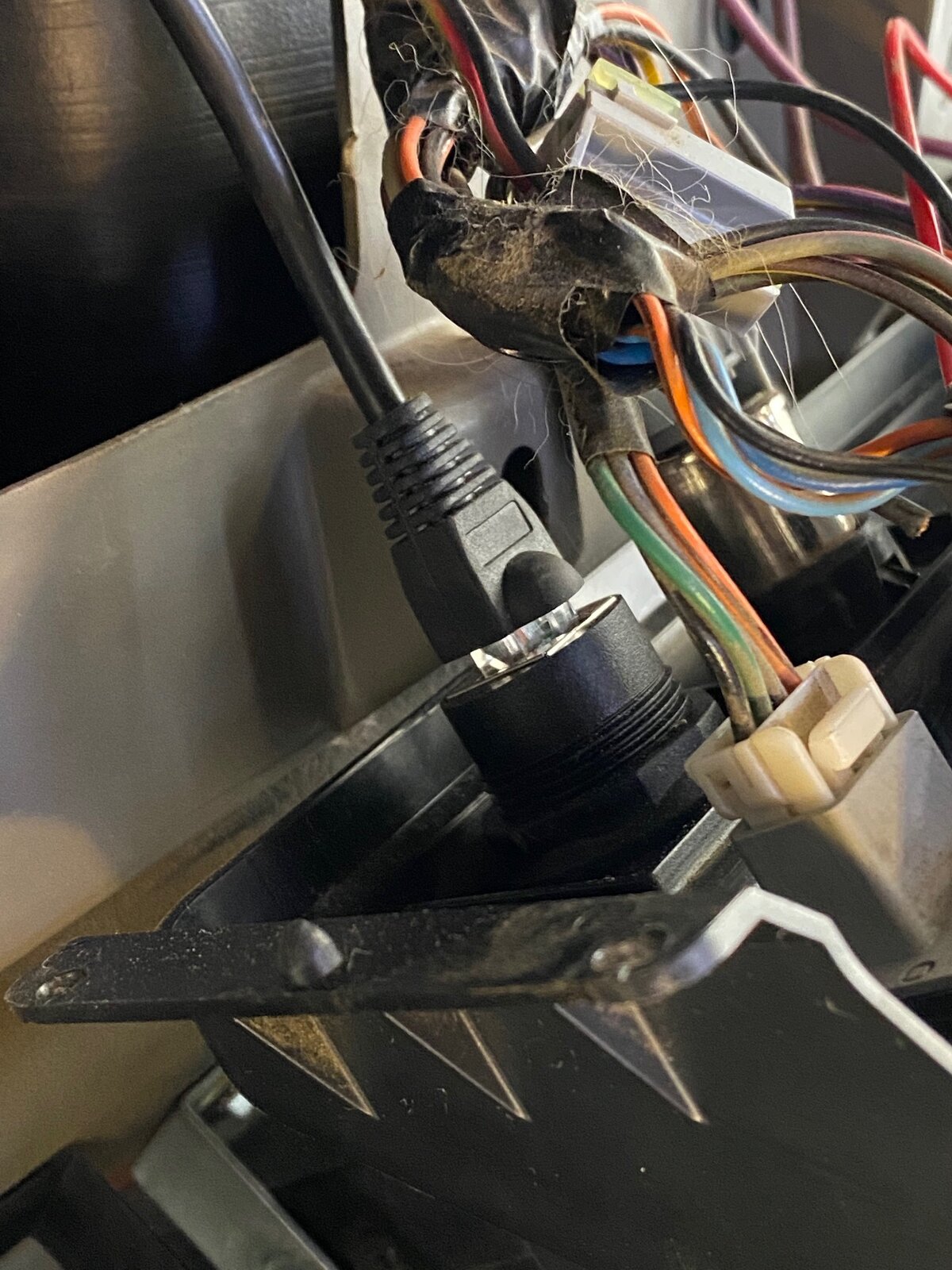

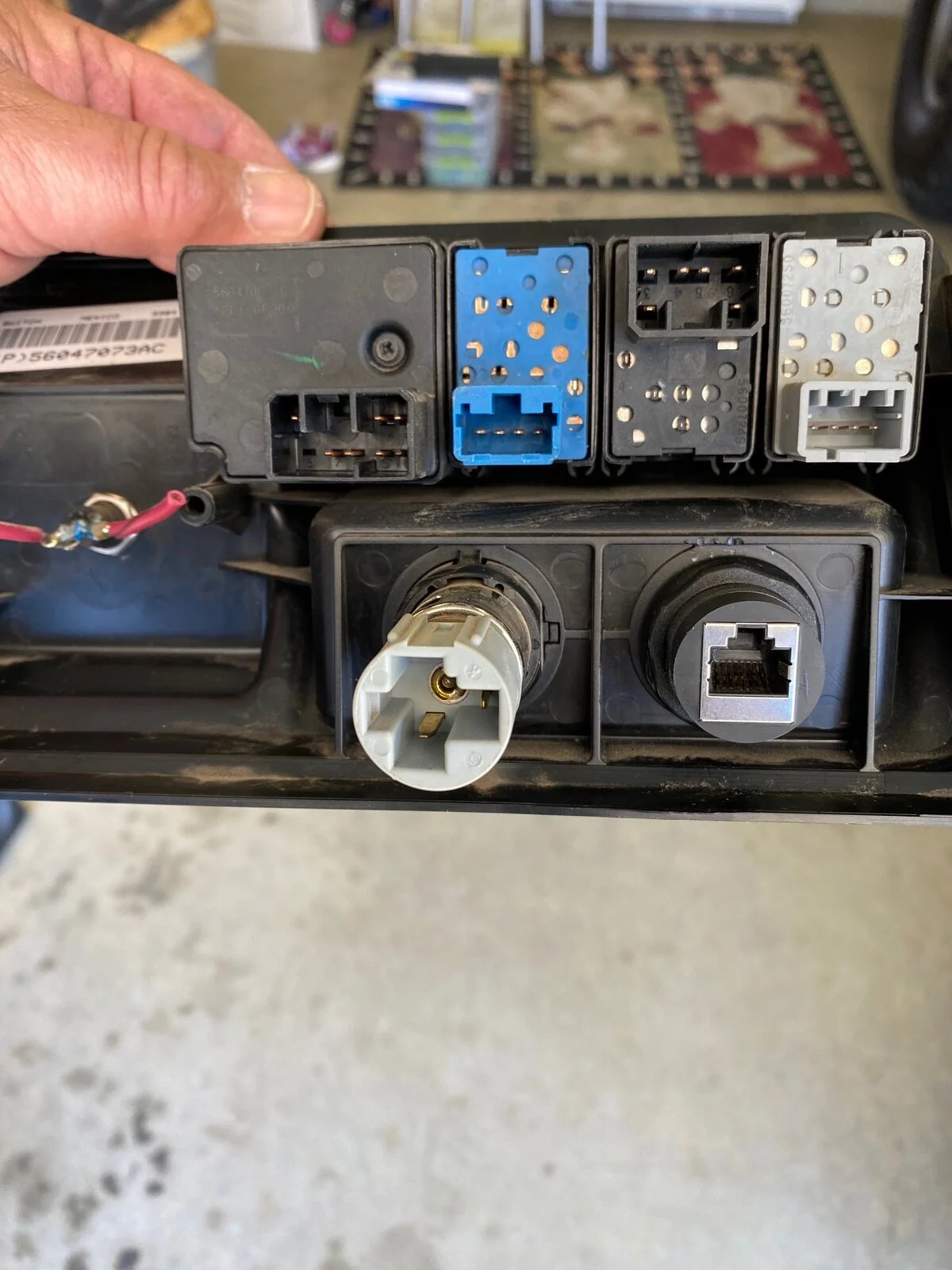

I mounted my new MXT275 on the divers side and then needed a place for the mic to plug into. Since I didn't really need 2 cigarette lighter connectors I removed one and installed a plug for the GMRS Mic

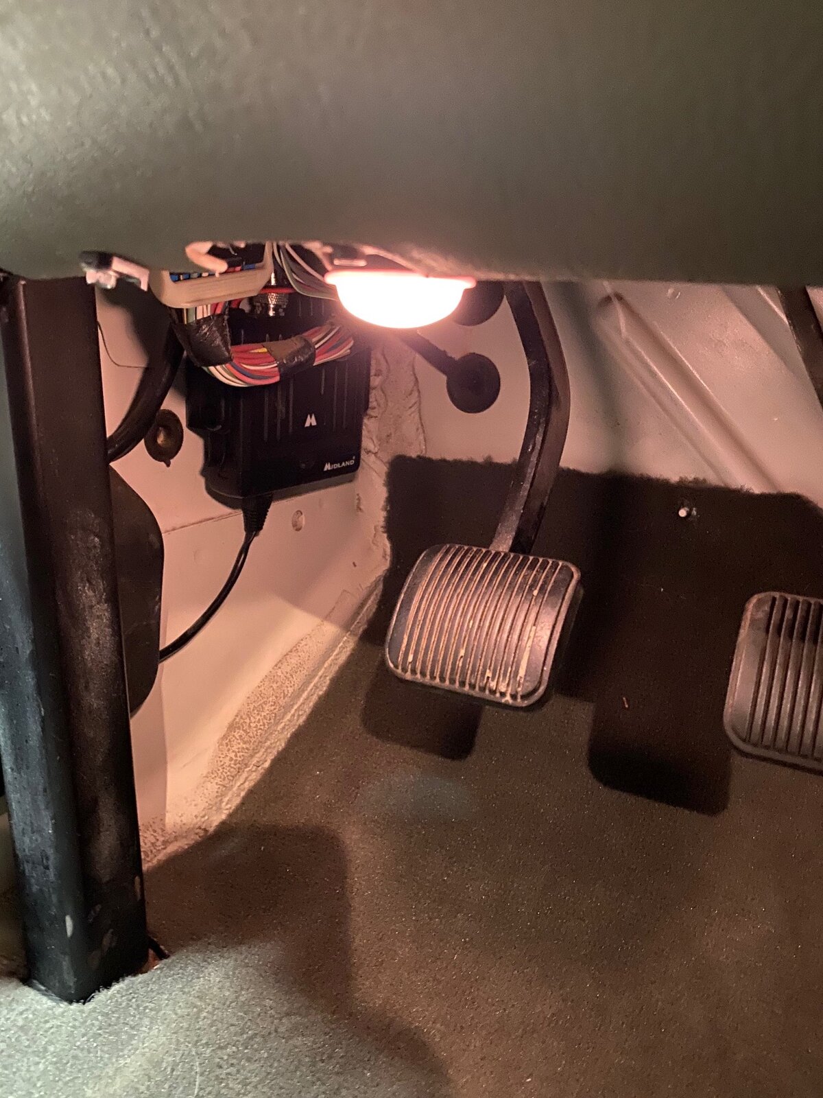

That's a pretty slick set up. Thanks for sharing.
Did you screw the mounting bracket down there under the dash? If so, I'm guessing that area has some space behind it and you don't have screws sticking out of the side of your Jeep. :oops:
That's a great idea for the mic plug.
Yes I did its double walled in that area, so no screws sticking out the other side

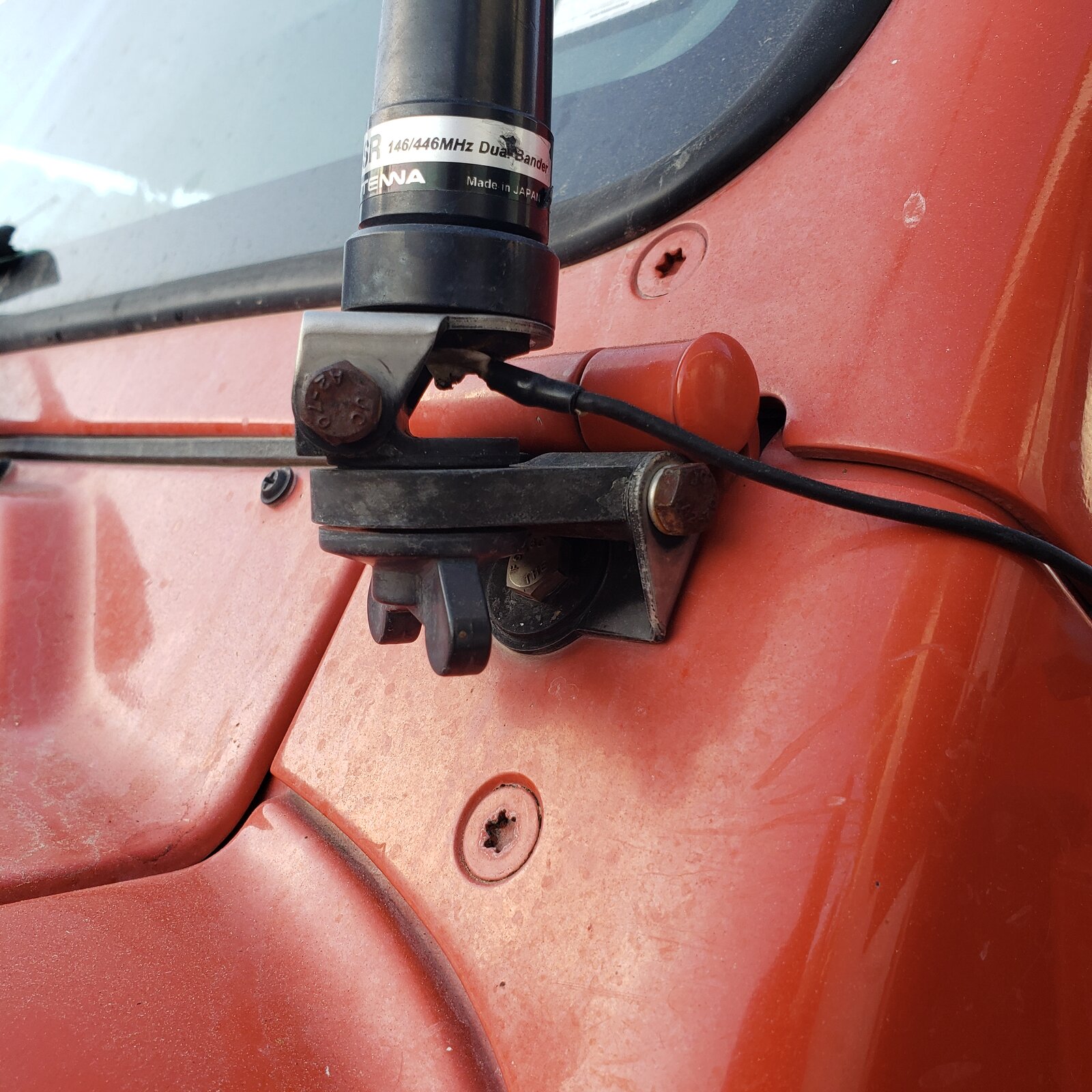

I took a trunk lip mount apart and replaced one of the windshield frame screws.
I like that spot, but I have a mount with spot lights there. I've thought about the mount that Midland calls a "ditch light mount" and sticking it out to the side.
