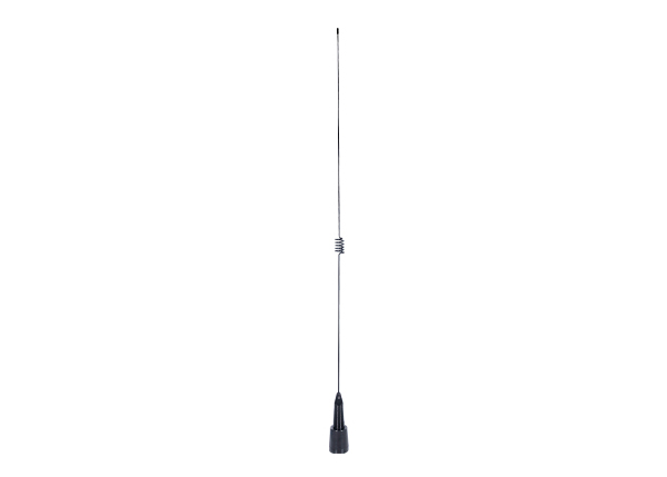

Iam using this one from Midland
MICROMOBILE® MXTA26 6DB GAIN WHIP ANTENNA, and I made my own mount. Those that know better than me do you think I will have any reception issues ? I have not yet tried it out

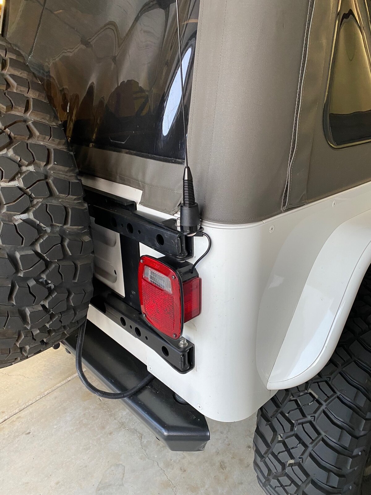

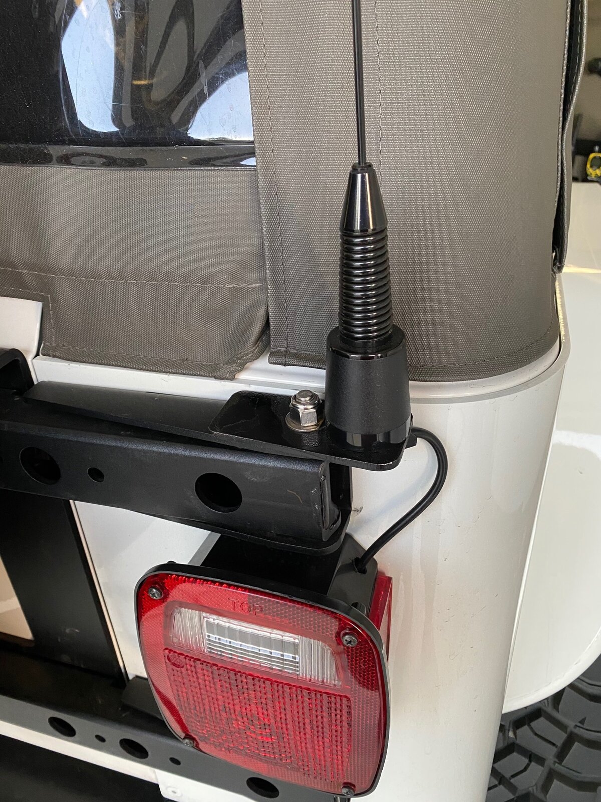

MICROMOBILE® MXTA26 6DB GAIN WHIP ANTENNA, and I made my own mount. Those that know better than me do you think I will have any reception issues?
You'll be fine. You have a colinear antenna which is actually two antennas in one. One antenna below the phasing coil and one above it. Its how they get a gain figure of 6db.
Your only issue is the roll bar and it will cause a little bit of shadowing, but I doubt you will ever notice it.
Nice job getting the coil above the tub. This helps with the tuning and operation of the antenna.

Mine works great(when cb is not in place. Ill be moving one antenna to the opposite taillight to give space between the two) I tuned/trimmed mine to read 1.14 SWR at the highest, and 1.01 on the lowest. Paired with the mxt275, I was able to talk to someone crystal clear from Burlingame CA to pismo beach and paso robles CA from using one of my known repeaters
