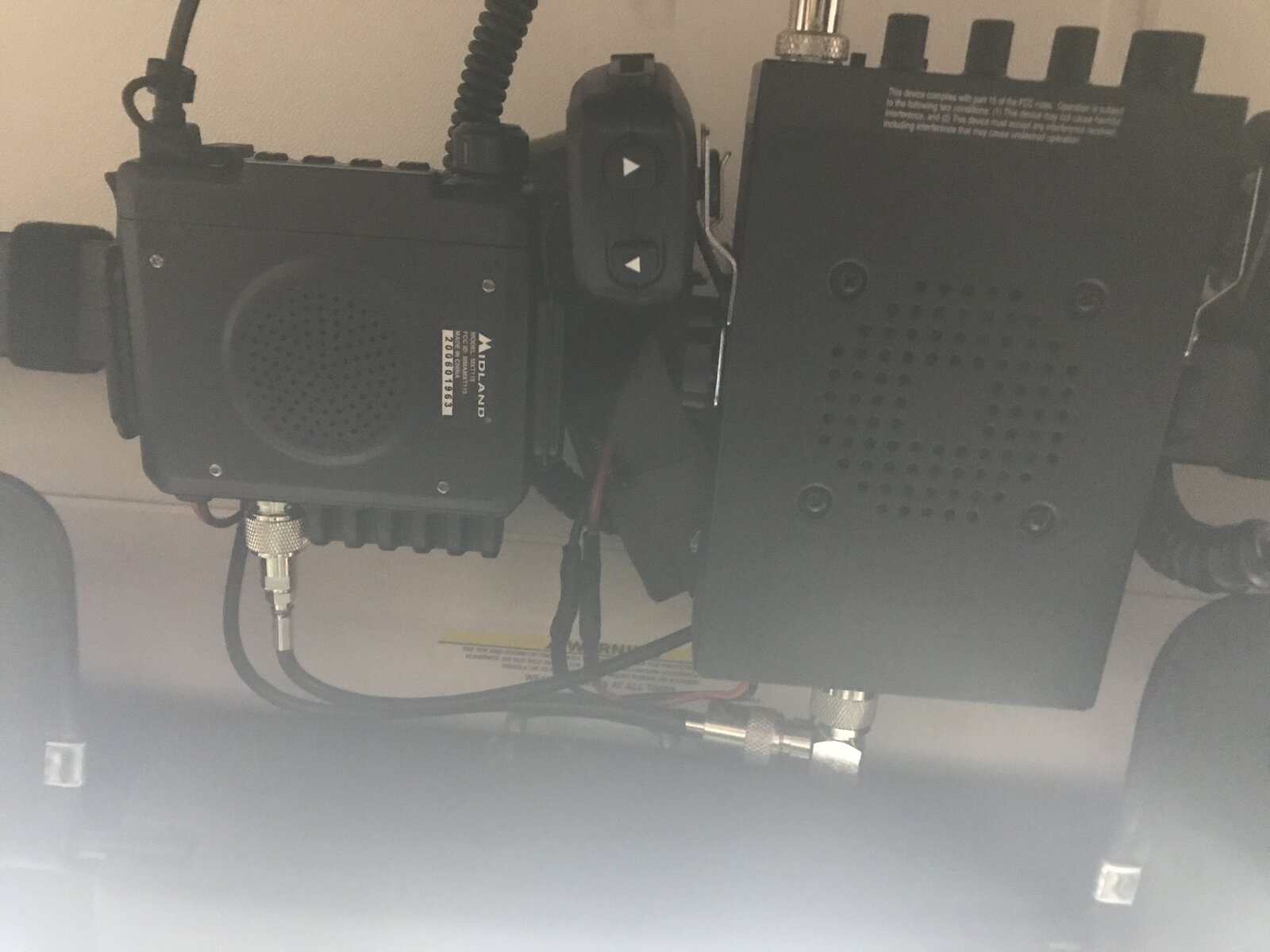

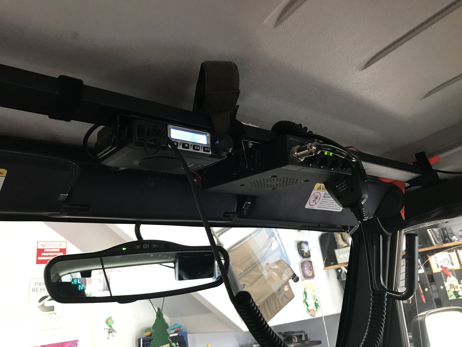

I have an ARR mount too with a Uniden 520 on it. It looks like you have a 510 or 520 too. I was wondering if the -115 and 520 radios would fit on the ARR mount side-by-side and still be able to move the visors.
Are they in the way of your visors?
I would actually prefer the -115 rather that trying to see all the controls and display on the mic of the -275. I will say I do like how the -275 would take up less space by mounting the radio under the dash.
Yes it’s a 520. Plenty of room side by side for the visors to move freely. I messed around the CB I’m top with GMRS on bottom and vice versa. I liked this way the best.
Sorry about the glare in this photo.
I just took it to give you a better idea of the amount of room. I tipped the visors down a little. Hope it helps.

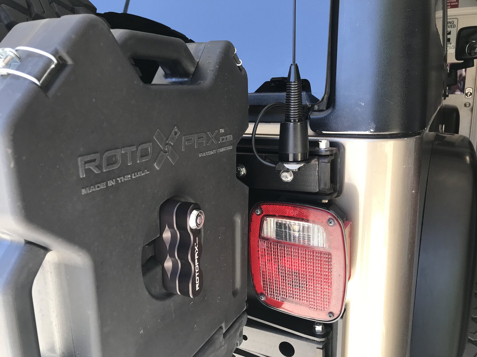

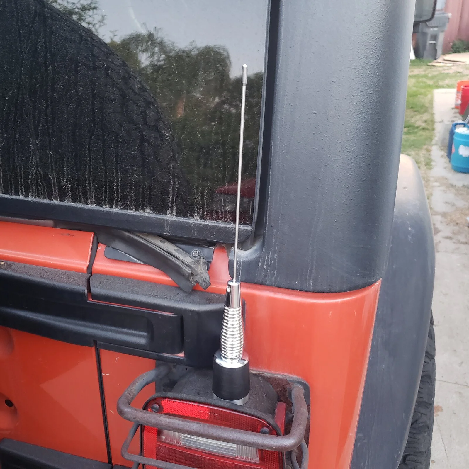

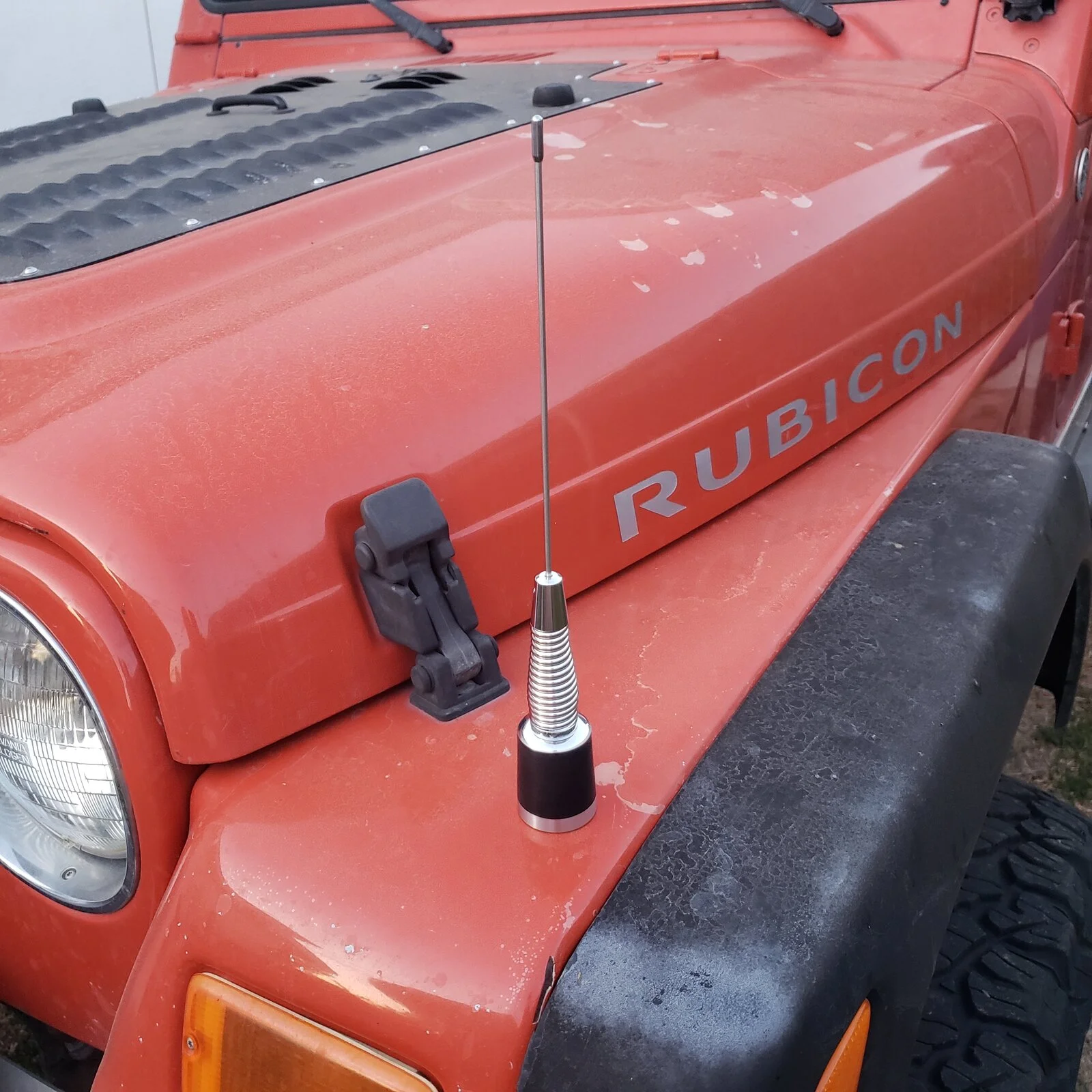

I purchased two 1/2 wave GMRS antennas to experiment with. The thing with a 1/2 wave antenna is it doesn't require a ground plane you could drill a hole right through your fiberglass hard top and with the proper length cable, no ground plane would be necessary. This is accomplished with a matching network in the base of the antenna.If this antenna was a CB antenna it would be 18' tall! As we go UP in frequency, the antennas get smaller.

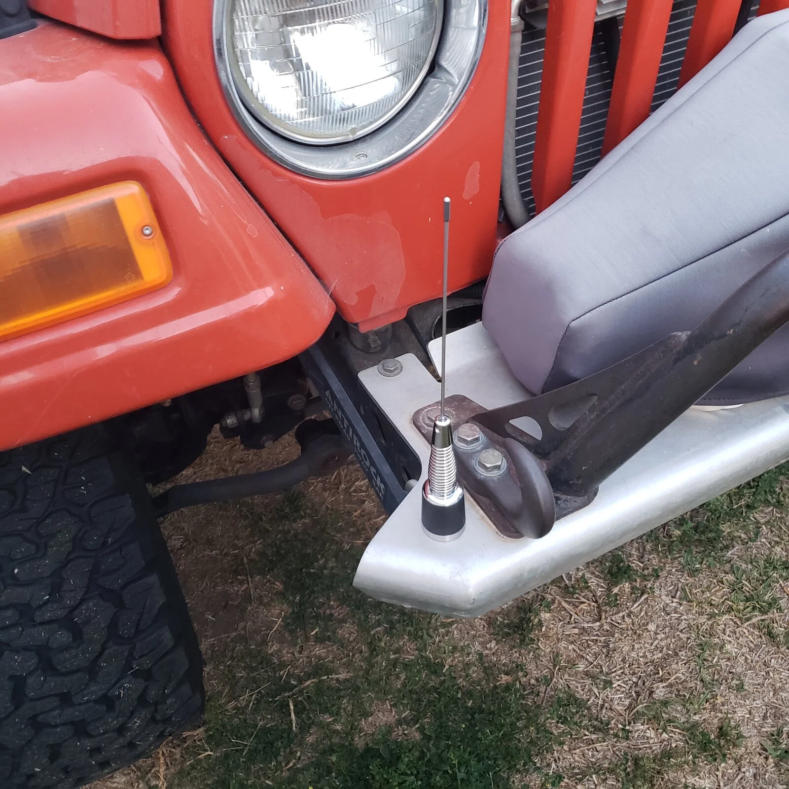

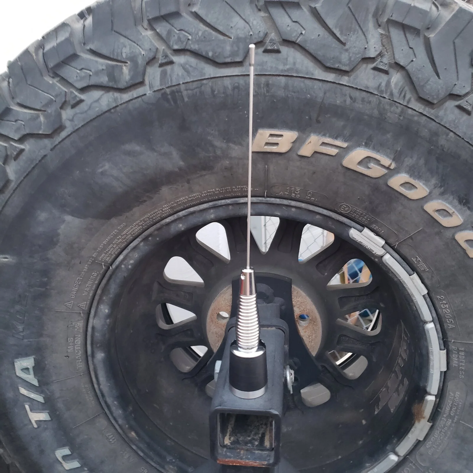

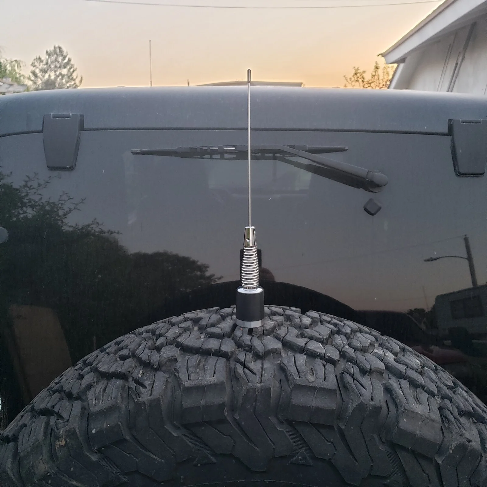

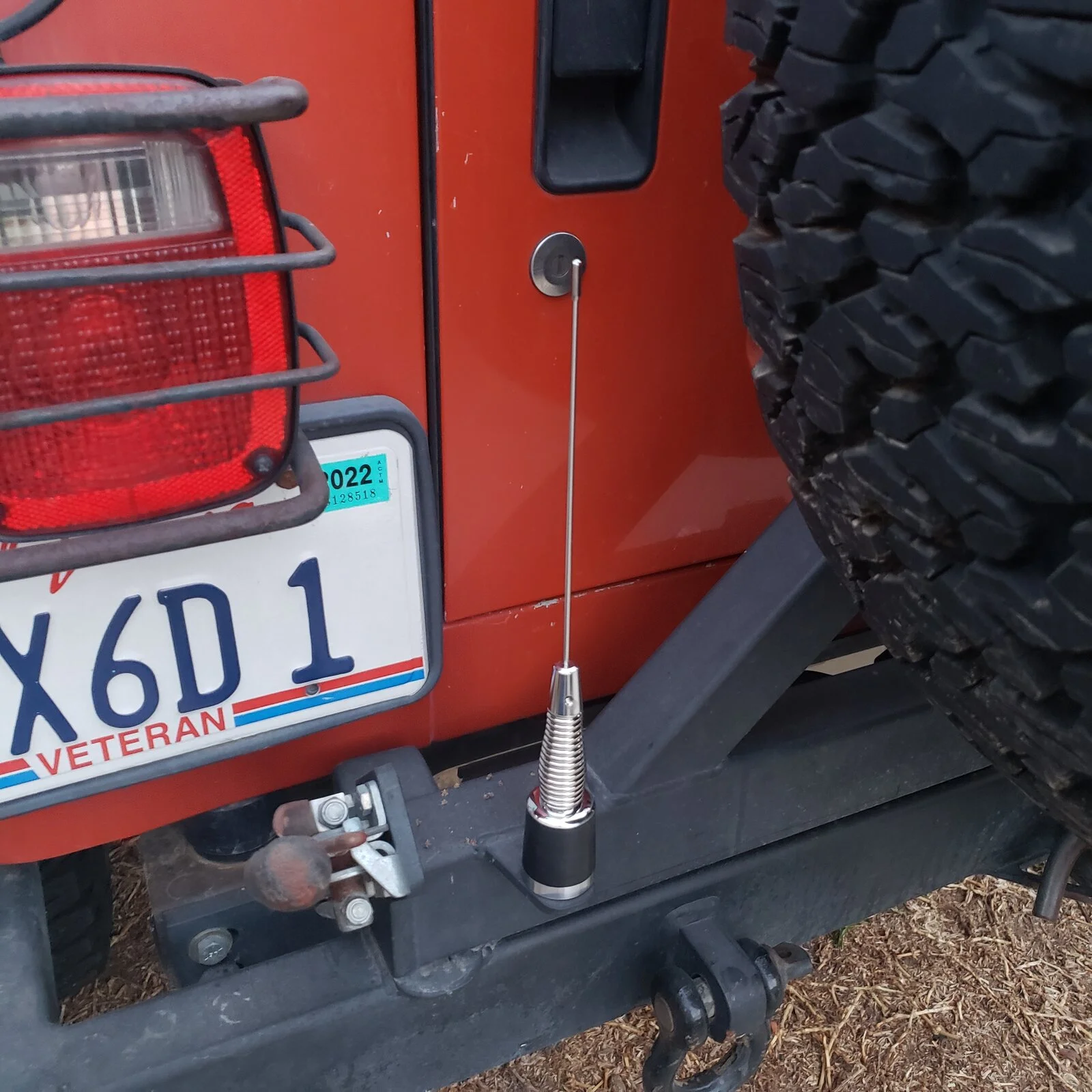

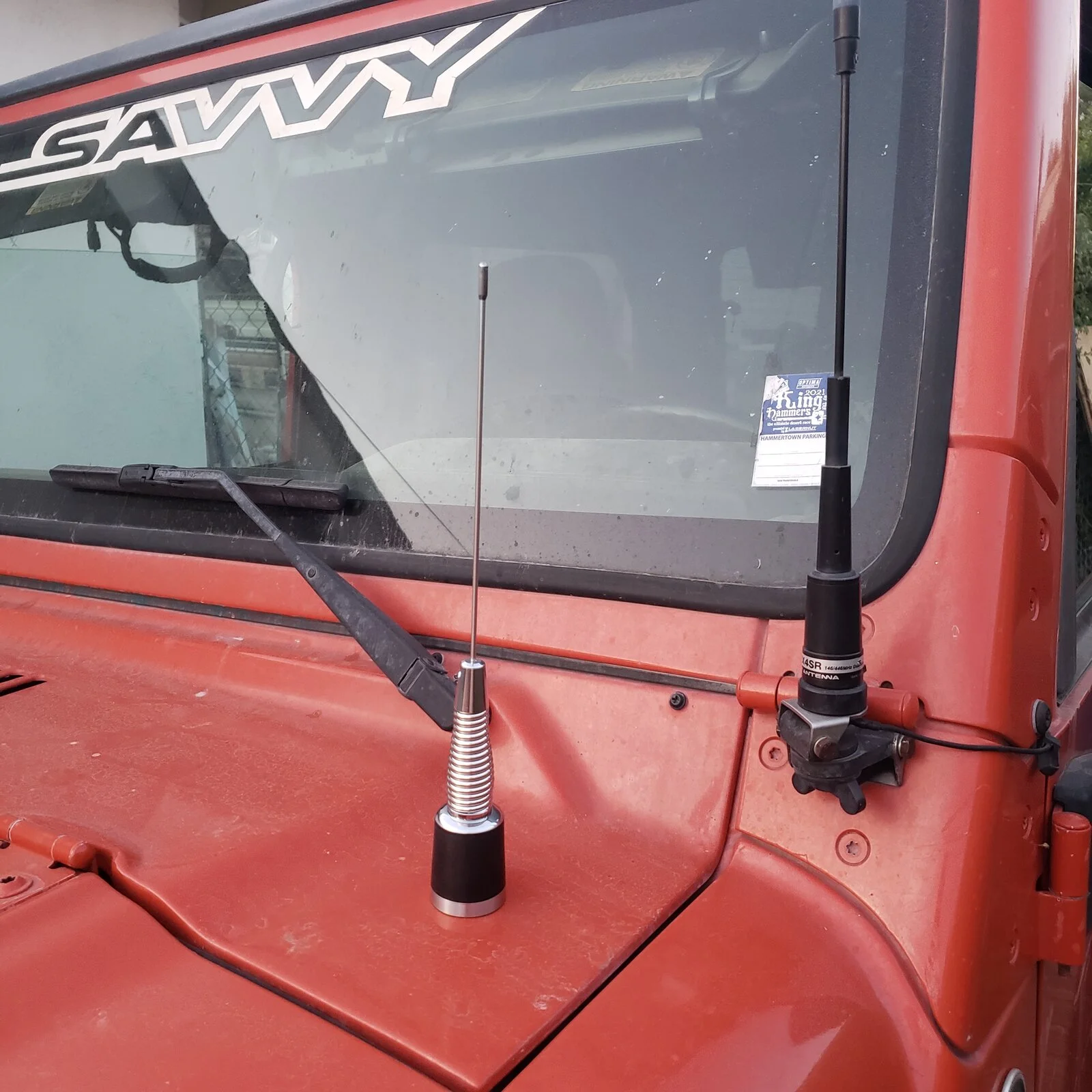

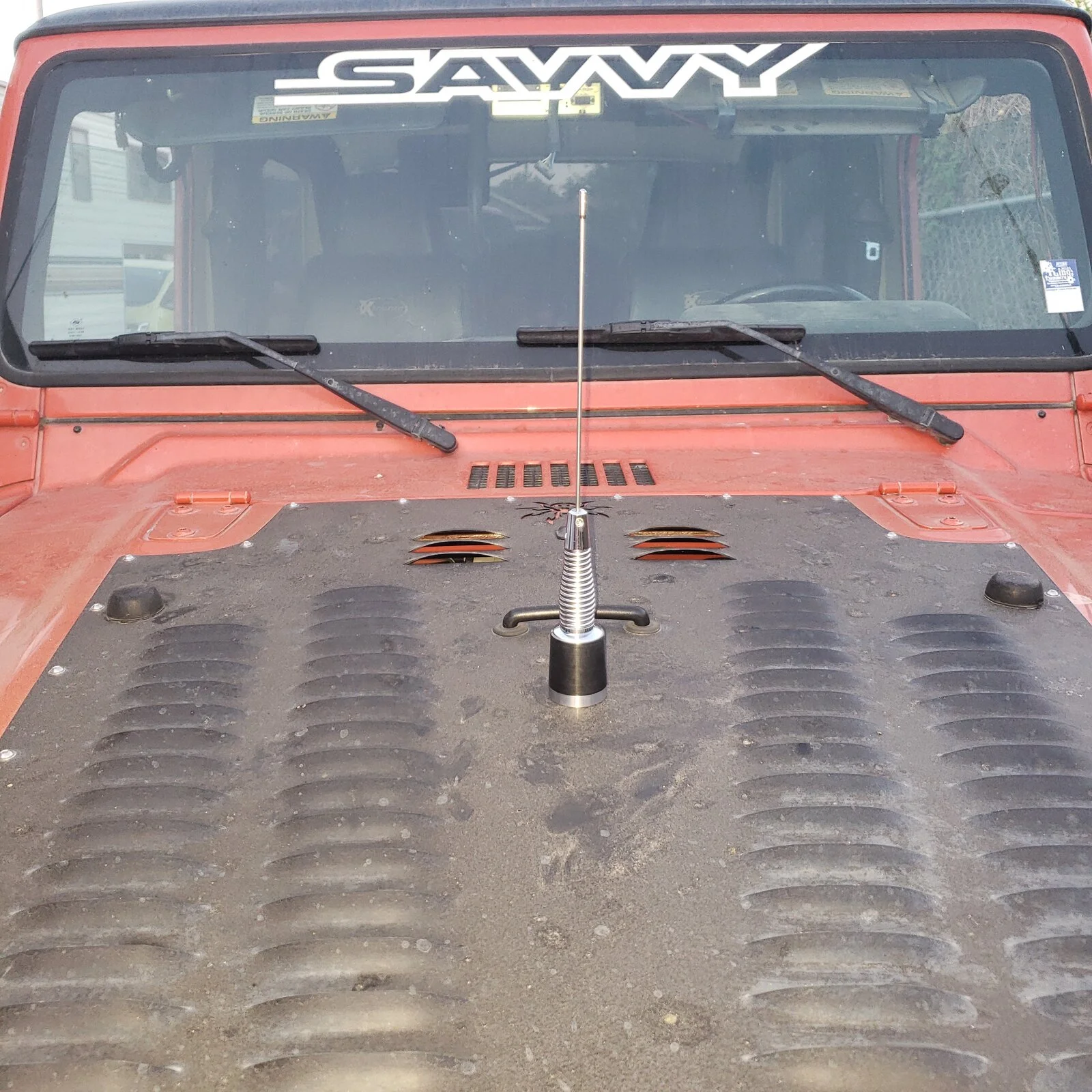

I placed it in various spots on the Jeep. Ideally I would want it high and away from any metal like roll bars, hoods, grills, window frames doors, etc. At the very least, as far away as possible. Here are a few ideas...
My favorite would be a small rack over the spare tire or an extended mount that raises it up. Since it doesn't require a ground plane there are lots of options. You still want to stay away from other metal objects the best you can.
Reactions: MountaineerTom
I have my GMRS antenna right where @Dino - KX6D has his on the front outer corner of the driver's side fender. Lowest SWR of all the places I tried, about 1.3. Middle of the hood was 2.0 - although it should be a better location. YMMV...
