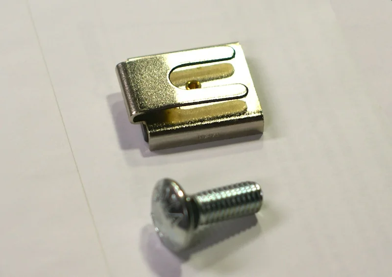

Started with a 3/8" carriage bolt.

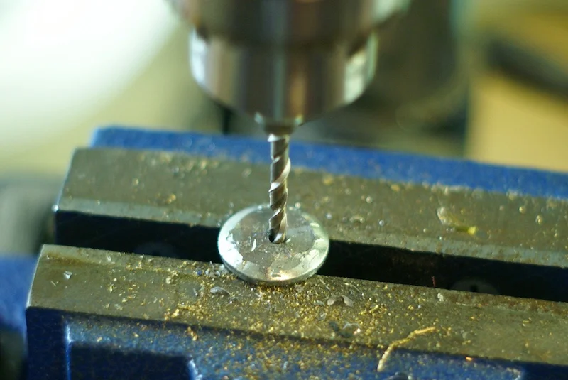

Ground the top of it flat, it now fits a standard mic clip.

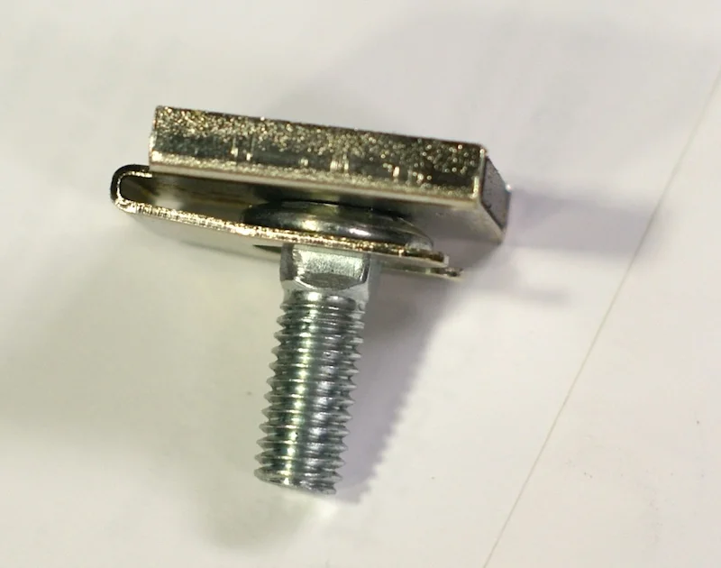

Cut the bolt off of it.

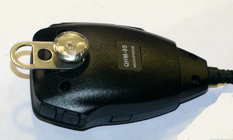

Drilled a mounting hole.
Crude, but effective.
So got my Jeep back with the Anytone mounted. Though I don't have anything to hang the mic on. It has a different connector on the back. If anyone has this attachment on the back, what are you using to hang the mic?

Ya know, I looked for one of those damn things and couldn't find one. Didn't know what it was called - so I ended up making my own.
