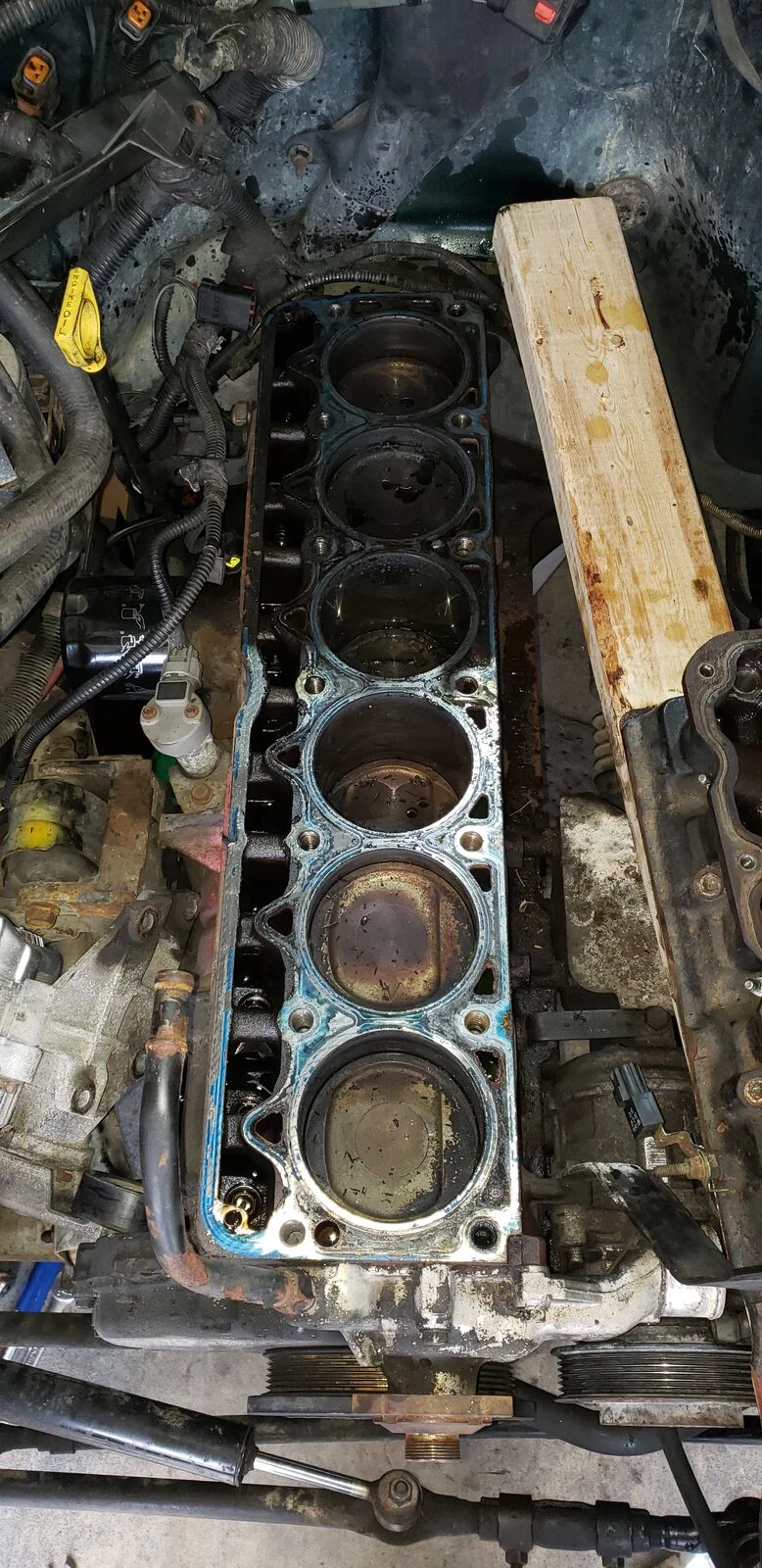

I've been following this thread since it began. I posted on it way back. I did the same thing you did with the cam and lifters with the same results. Still had the rattle. I ended up doing a in Jeep rebuild to get rid of the noise. It was minor piston slap. It ran great with the startup rattle and I'm sure it would have been fine for years.
Did you do any cylinder work or did you just replace the pistons/rings? I told myself to deal with the noise but I see myself pulling this head off and putting pistons in it 🤬
Hopefully and most likely ur cylinders r in good shape, and just require a hone job. That's all I did. My cylinders barely had any ridge at top at 150000 miles. Somehow I knew u wouldn't b satisfied with doing all that work and still having the rattle.

Don't blame u at all. After tearing mine down, I have no doubt that it would have gone on for along time. There really was no bad wear at all. Just a little on the piston skirts. I just couldn't bear the noise.
Yeah, the main reason I pulled the trigger is because my cam had galling and abnormal wear. I did hope the lifters would also fix the noise but obviously it didn't. 😑
The cylinders looked great while I had it apart. The engine in whole looked pretty good minus the cam. I was also surprised that my engine didn't have much of a ridge on the cylinders and I'm pretty sure the walls still had cross hatching.

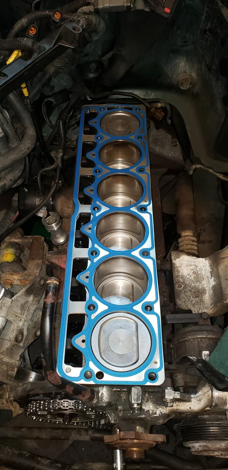

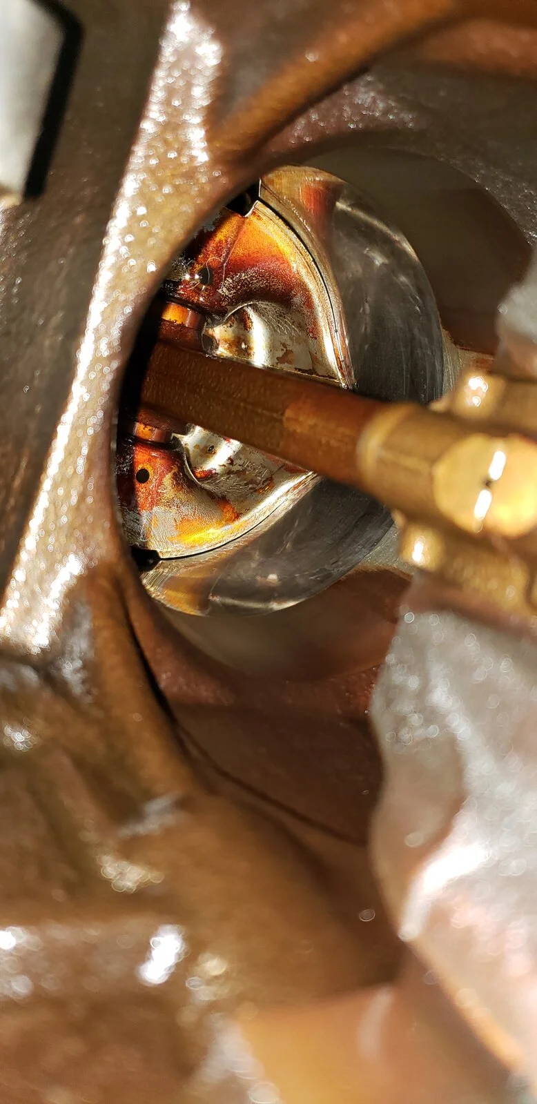

Just wanted to show I'm still observing this thread and I'm still driving my Jeep after the camshaft, lifters, push rods, rocker arms, fulcrums, oil pump etc. replacement. Jeep still makes the noise and hasn't gotten better nor worse. I drive it nearly everyday as a daily to work.
I also had checked connecting rod bearing clearance which all were within specification. I believe the sound is coming from the pistons. Maybe a wrist pin issue or piston slap. The jeep runs good and pulls hard after the camshaft swap and I currently have no plans in the foreseeable future to replace the pistons.
