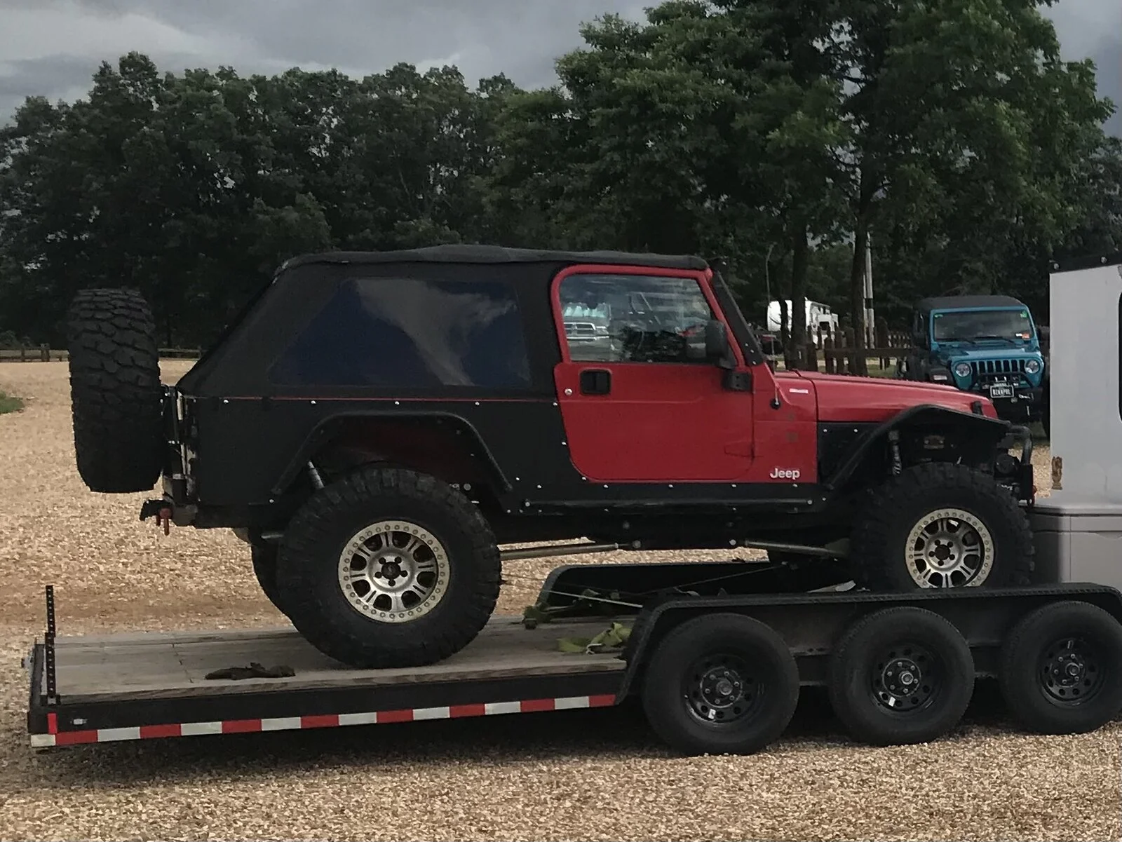

What spring brand is know for quality? I'm assuming that if I replace the springs, the other hardware isn't going to fail on me or are you saying rough country quality is such that I should consider swapping out the whole setup?

Some quick googling would suggest that currie doesn't go more than 4 inches. Is that right? I am about a 4 inch lift now and I rub. I see a couple 5 or 5.5 inch offerings by Taraflex and Rock Krawler. Are there quality 5 + springs available or do I need to go with quality 4 in springs and maybe a 1.25 body lift?
LONGJP2
TJ Expert
Aug 11, 2019
3,423
Illinois
Does the fact that I have a 6 in lift factor in in any way?
You only have a 3" lift. So you don't need a dropped pitman arm.
You should check drag link and trackbar for parallel.
I have about 15+ inches of spring (compressed by the weight of the vehicle). Should this measurement be done with the springs uncompressed?
One other thing. Whoever installed the lift did it in a way that locates the rear wheels a bout an inch and a half forward of center of the wheel wells.
You only have a 3" lift. So 37" tires are going to rub.
Axles are centered in the wheel wheel at full compression or with springs removed.

3” lift with 37’s? Yeah, that will rub. Get some HiLines or a 4” RockJock and 1.25” body lift and drop to 35’s.
AMS417
"The Ayatollah of rock and rolla"
Apr 13, 2020
1,984
Springfield MO
I ran 37's with Metalcloak fenders and 4.5" spring. Still needed a little bump stop to keep it out of the body. No body lift though.
3" is not going to be nearly enough.

Well, I have a long arm kit that will accommodate 6 inches of lift. my question is how much do I need. I am looking for a doner V8 at the moment and most of what I am reading says a 1 inch body lift makes that easier. so I am going to go that route, and contrary to the suggestion above, I will NOT be dropping to 35s... I just bought new tires that have > 200 miles on them.
My final question is, how much suspension lift do I need. If I replace the aging 4 inch lift springs that are giving me more like 3.5 right now with 4 inch curry as suggested above with 1.25 of body lift, should I expect that to work, Or do I need to go 4.5 or 5 inches? Also several mentioned fenders, I am fine up front - except that at full right turn I rub on the passenger upper control arm. I do have flat fenders so I am sure that helps. My issue is rubbing in the rear.

@toximus has a really good write-up on 37s and 4in lift, I would strongly recommend you check it out. The reason people are suggesting you consider dropping down to 35s is because that axle is known to not be up to the task of supporting 37s, especially since the ball joints are known to not support 37s, so plan that as a maintenance cost. As for lift height, that at the end of the day comes down to where you wheel and what you're using it for. I have around a 3-4in lift with 35s and highline fenders and I am more than happy with the performance, some would say more or less but that all depends on where you wheel. I think Highlines will be a must if you don't intend to bump up lift height, (metal cloak fenders don't count), I would also strongly recommend that you buy aluminum ones over steel, they are way more expensive but at the end of the day, they are worth it. Keep doing research and ask questions, these guys here are some of the most knowledgeable guys when it comes to Jeeps.

An important thing to understand about Tox's build is that he worked very hard at making all the various components and assemblies work together as a larger system.
Step one in that endeavor would be wider axles. Meaning it would be more cost and time effective to simply use a 35" tire. 😉

You need more bumpstop to keep the 37s from rubbing,more height will be a good thing but won't keep it from bottoming out.
I agree with the other advise you're getting. Those axles are too weak and/or too narrow for 37s.Adding a v8 is just going to compound issues.
Its never a good idea to run something just because you have it.learning as you go can be fun,but it can also be expensive and frustrating breaking on the trail or having a rig that doesn't work well.
Please take all our advise with good intent.we want you to succeed and be part of the community here.

It is probably worth noting that this is a trail rig only, yes I drive to and from the trail or sometimes flat tow it, but I logged less than 3K miles last year. I’m not really worried about Items that will wear out over time. I’m only worried about items that are so stressed that they are going to break all at once.
My real reason for the 37s is that in my area (Arizona) I get a lot of washes with large river rock kind of situations. I have smacked my differentials a number of times, the last time I created a leak. I’m really going for more differential clearance.
Blake I appreciate the direction to a write up, but the link is to the member, how do I find his write up? I did quite a bit of searching and did find other discussions about curry saying that their dana 44 is good up to 37, and referenced dana ball joints… then there was a debate about if they are stock ball joints. Can I simply upgrade the ball joints? I see several versions for sale between 200 and 350, which is a lot less than abandoning new tires.
Most everything I have read indicates that the dana 44 is good for 37s, though perhaps they are expecting a ball joint upgrade? Based on the fact that there is no build number on the axle tube, I believe that this is a 44 ordered from an aftermarket shop. Might they have already done the upgrade?
I don’t understand the width comments. I don’t seem to have a width issue at all except that at full right turn I get a little bit of rubbing on the upper control arm. I really don’t seem to have a front end clearance issue at all, only the back rubs. I do have flat fenders so I have a lot of added clearance over stock.

If it's a TJ front Dana 44, there are no stronger ball joints available than the OEM Spicers it came with. That's why I'm still running 35's and why knowledgeable TJ owners who actually wheel their rigs on trails tough enough to need 35's and/or 37's recommend against 37's on any front axle the factory ever installed into a Wrangler TJ.
