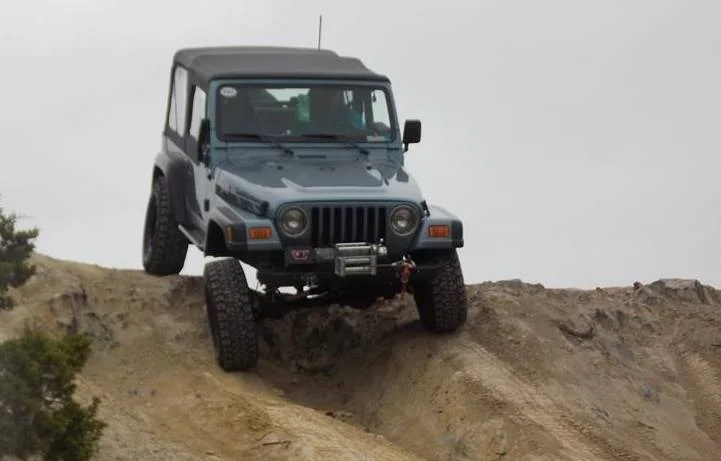

2.5 & five speed ... 4.88 gears and 33" tires is the sweet spot.
