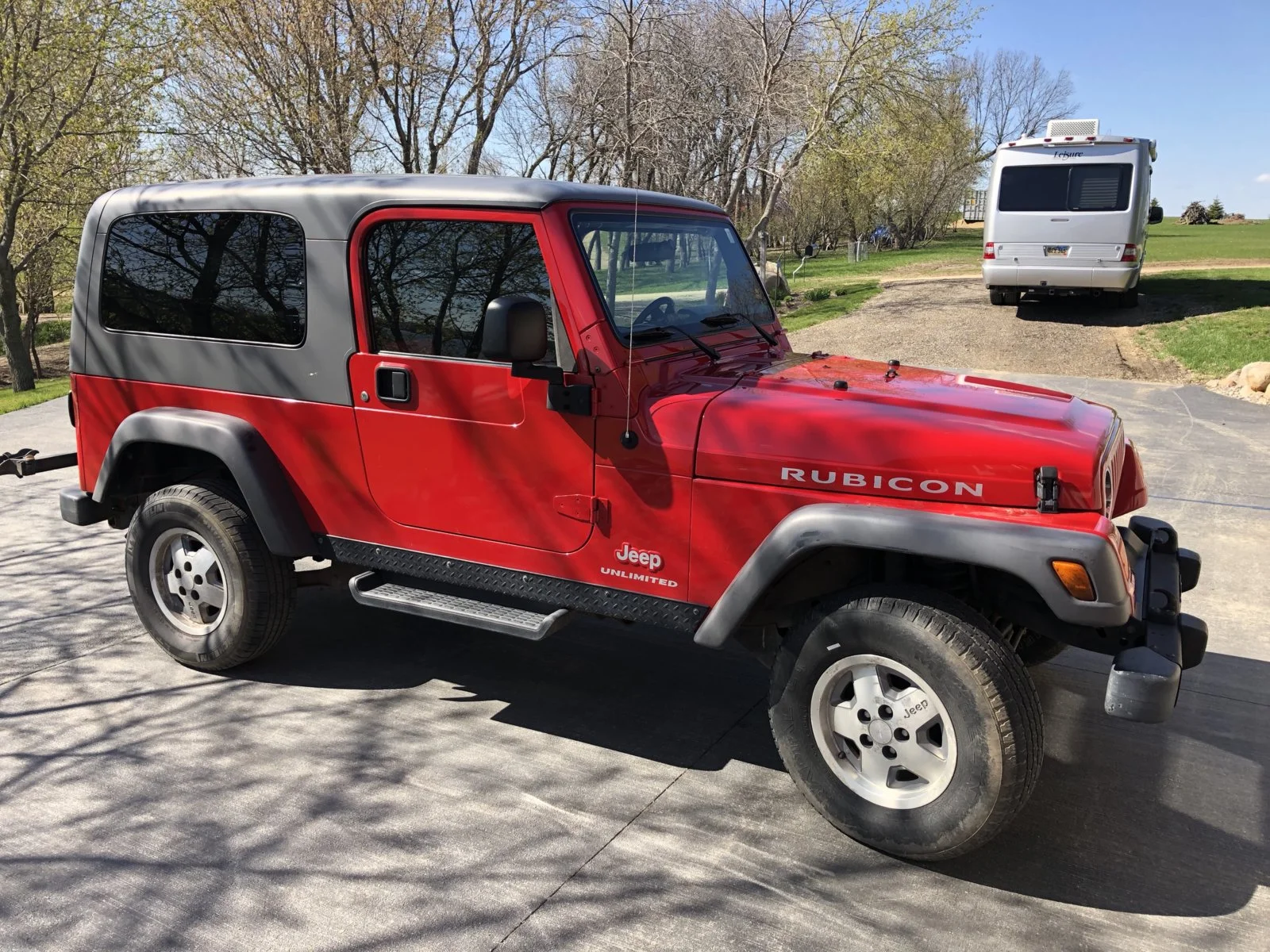

I don't want to do much permanent cutting to my 05 TJUR. So unless I can get a bolt on fender kit I'll likely do a 3~4" lift, But I will hear "I can't get in this thing" a lot!
See looks a little anemic right now.
