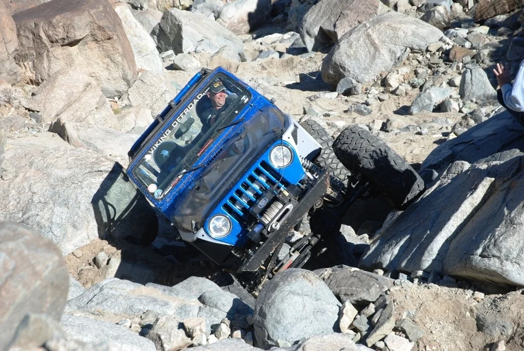

Let me ask you directly Jodomcfrodo.... are you leaning your Jeep over as steep as the below TJ is that didn't flop over? I strongly doubt it.
Here is that Jeep again... did it roll as steeply as it is leaning over? There are lessons to be learned from others.
Let me ask you directly Jodomcfrodo.... are you leaning your Jeep over as steep as that blue TJ is that didn't flop over? I strongly doubt it.
Here is that blue Jeep again... did it roll as steeply as it is leaning over? There are lessons to be learned from others.
Something interesting to mention about this one is that due to unforeseen issues it was initially lifted a few inches higher than it was supposed to be. It looks like it was still at that incorrect lift height during that trail ride. Still didn't tip.
Not too worried about side to side flopping. Like I said earlier, I am worried about stability and the front end getting light while climbing. I've put my Jeep at some serious angles (at least it would seem so from the drivers seat). Not sure how those angles compare to your picture. Just out of pure curiosity, how wide are the axles on that Jeep?
And I'm always up for learning from others. It is why I preface a lot of my posts with "I don't know" or "I'm happy to hear what others say". I've never claimed to know the answer to this question.
I'm more interested in Jerry's jeep than trying to compare ours to the blue jeep. Its on 1 ton axles and coil overs. This is comparing apples to oranges . One ton axles definitely weigh more than our Stock Dana 44's, Dana 30's and Dana 35's. Coil overs perform much differently than a shock and spring set up. I see that there are lessons to be learned from others but this lesson should be taught to someone who is thinking about building a jeep with one ton axles and coils. Not someone who is simply looking to compare whether they should do a small lift kit or a highline fender kit. @Jerry Bransford is your Red jeep on coils or does it have a spring and shock suspension?

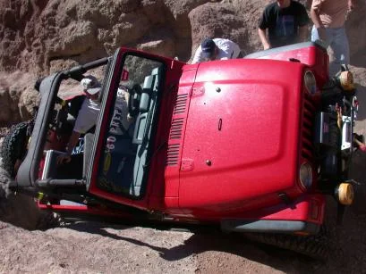

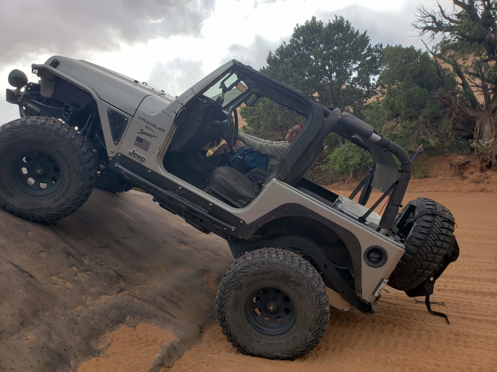

At the time this felt like I was going vertical so I got out to take a photo. Clearly you can see I wasn't even close.

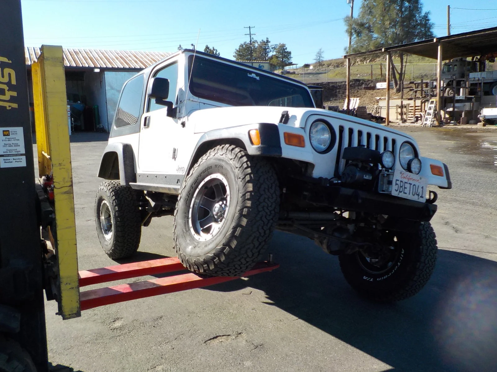

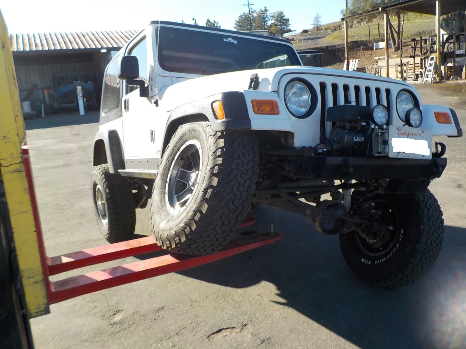

If you want a more stable rig off road, up travel is important. Whatever lift height you need for the tire size you want to run, you want to maximize up travel. If you want to play the forklift game, lift a corner with the front sway bar connected. Notice where my front tire is in relation to the fender.

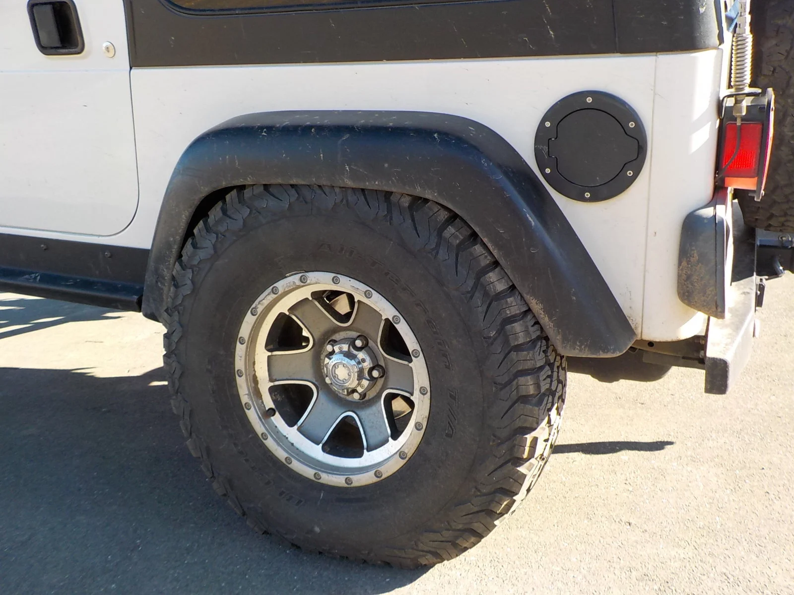

Now look at where my opposing rear tire is at and how far it is stuffed.
Ok, now disco the front sway bar and repeat. See how much more up travel I gained as the front wheel is more stuffed into the wheel well.
Notice now how my rear tire isn't nearly as stuffed and thus leveled out the jeep making it more stable while off camber?
The LCOG philosophy tends to cloud other areas of importance if you want to consider stability.
Ok, that series of photos was worth the price of admission. Thanks bobthetj03!

I don't know but the axles in the below photo of my TJ are stock width.
That photo makes me cringe every time you post it :ROFLMAO: It looks like the guy in the white shirt is actively trying to push you over.
