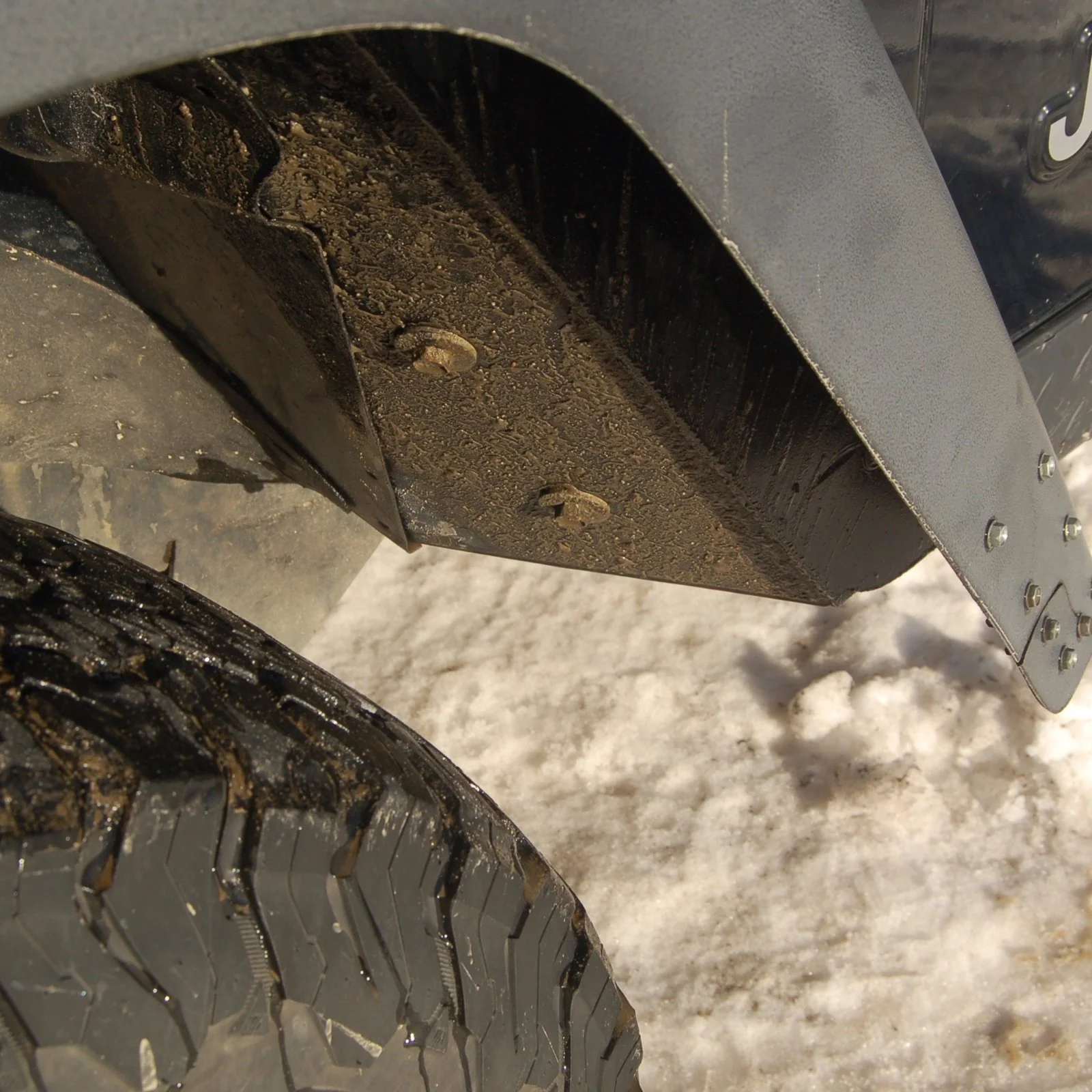

With 35s, 4 inch currie springs, and metal cloak highline fenders I can run roughly 1.25 inch bump before I can't turn the wheels. (tires hit the rear of the fender not the top) In order to get the most out of it though you would need to relocate the upper mounts or else you'll be in my boat and need to run smaller compressed length shocks until you can extend the mounts.

To each there own. I like the looks of a built TJ with high-lines, a cage, big tires, and lots of armor. I disagree about your statement that MC fenders are "half assed" they are exceptionally well built. Are there better options out there that get better clearance. Yes, but MC offers a fender that does gain clearance and is also easy enough for a hobbyist to install.

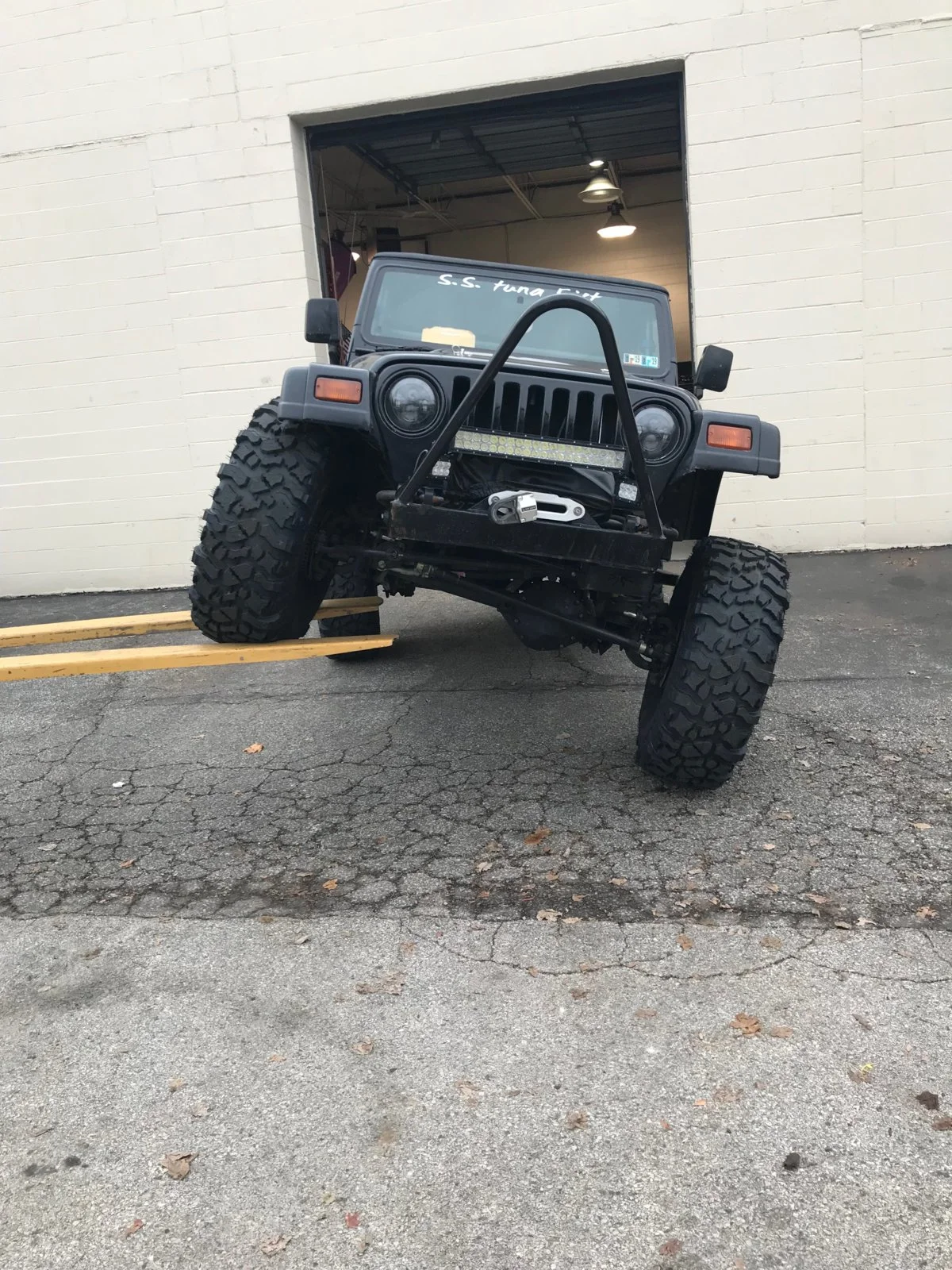

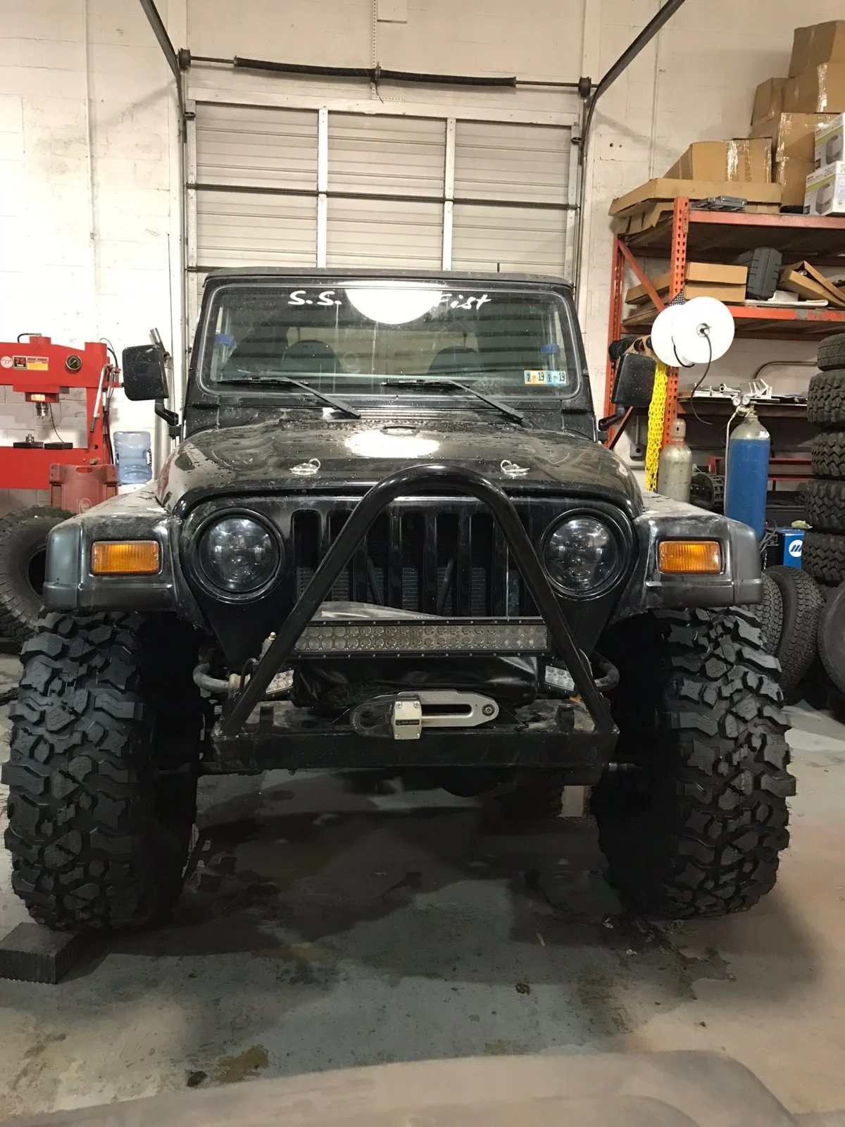

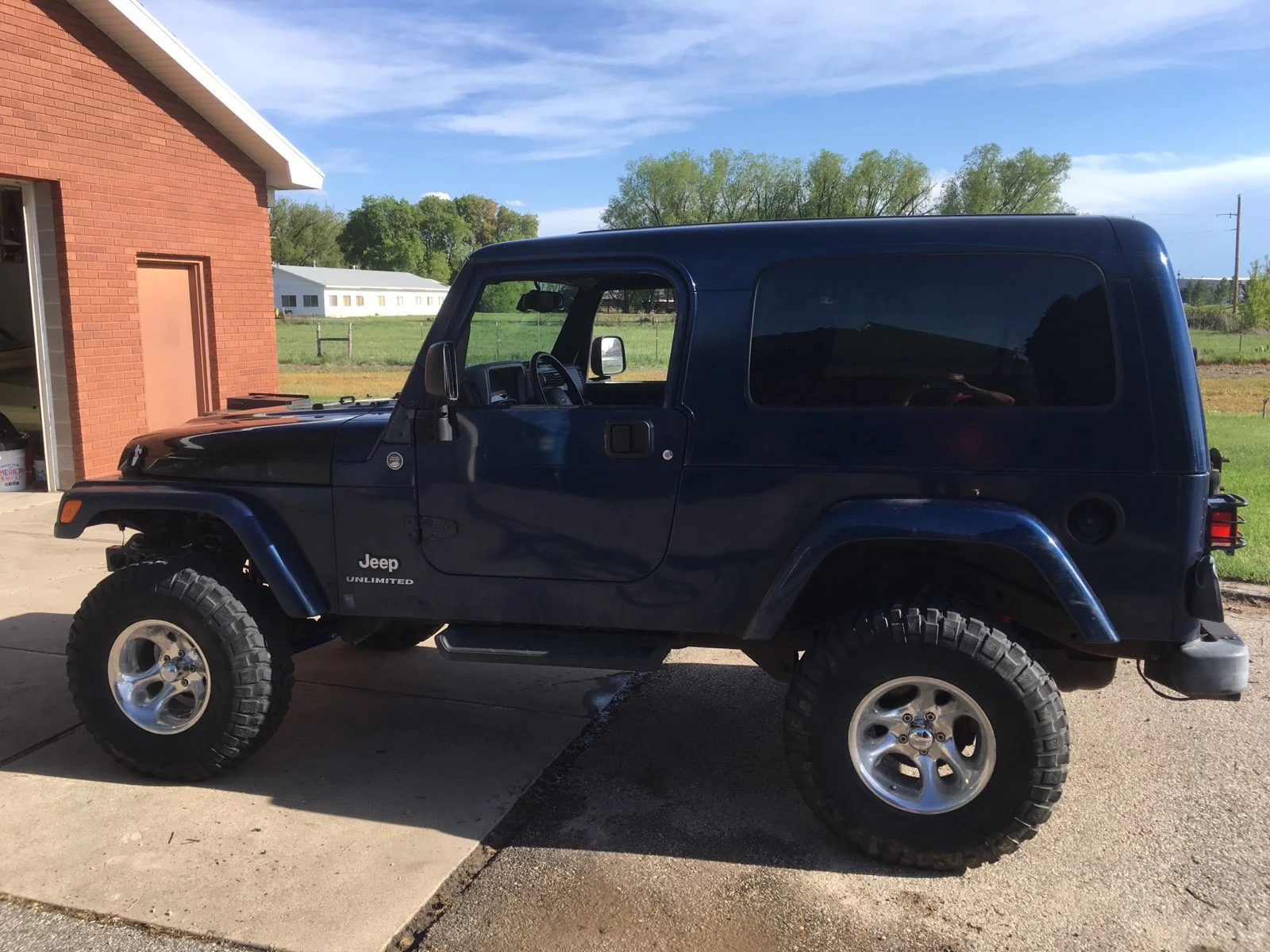

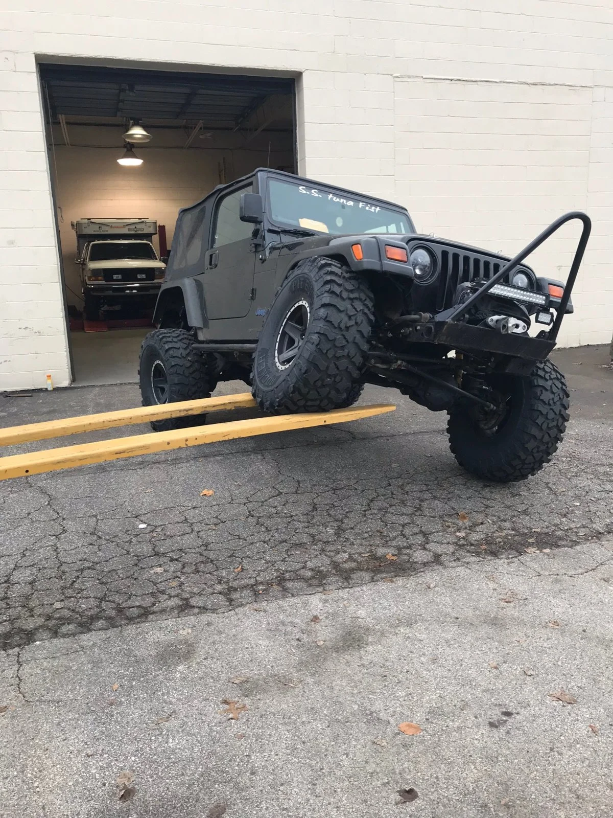

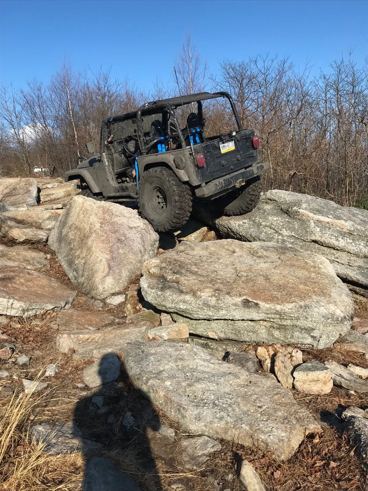

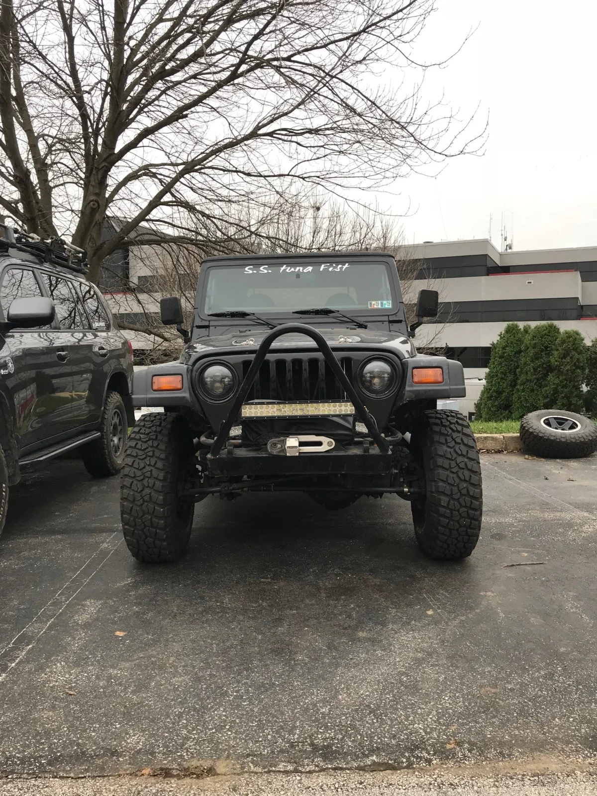

Please read because I was in your shoes. I wanted 33's and didn't know what to do. I didn't want to deal with a sye and pinon angles when I knew nothing about building my jeep. I picked and ran and still run the Ultimate 2.5 OME lift, 1.25 JKS body lift. That was an absolute fantastic lift for my jeep with 33's (first picture). and the DIY highline Kit that moved the fender up 3 inches was only added because I went to a bigger tire and did not want to change lifts or go any higher. When you add up my various lifting styles, its roughly 6.75 inches and I run 37's. I have had no problems with playing in the rocks. I am considering going to 3 inch shock to allow more down travel but I would not have been able to run my 37's without the highline.
The Ultimate OME 2.5 Lift was fantastic for me with my 33's and I highly recommend it. DPG off road is fantasic and I highly recommend the extended travel shocks.
The highline took me a whole weekend. Friday after work til Sunday around 6pm. Be prepared, it really isn't that hard to do. The battery does not need to be relocated but you will have to modify the fender brackets that attach to the firewall. You will have to rotate the evap system to make it fit under the hood (unbolt, rotate the brackets, cut one section off with a cut off wheel, and then rebolt to the fender using extisting bolt holes.
The biggest issue was the windshield washer bottle. I had to make a new bottle but that consist of just drilling a new hole into an empty bottle and moving the pump over.
This is the ultimate 2.5 OME spring and body lift with 33's. Perfect LCOG lift in my opinon IMG-0199.JPG
After everything I still have the 4 inches of uptravel from stock. I used the formula of how ever big you increase your tire size, you need to move your fenders that far away. 31's to 37's was 6 inches. I moved the fender up 6.75 by using various lifting styles. I haven't had any complains a year later and countless trail miles.
