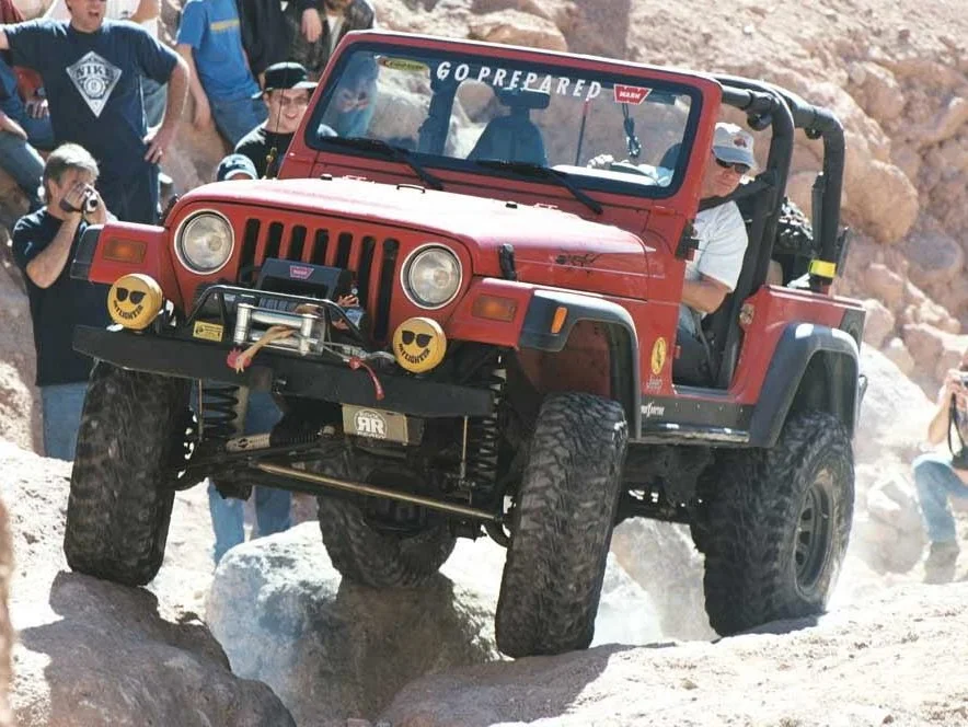

That was my previous TJ and it had a very conventional spring and shock suspension. It was actually a very crappy suspension, that photo and the below pic was taken in 2003 on the same trail the same day even before I had anything with Currie's name on it. It was very likely the kludge suspension I had about that time with Rock Krawler 5.5" springs, Teraflex 1st generation control arms, Doetsch Tech DT-3000 shocks, and that was about it. If anything it had an extra-high COG due to its 5.5" suspension I am fairly certain I was running at that time. All the clearance I had on top of those 35" tires reassures me it was the RK 5.5" springs I was running for a year or so before converting to the Rubicon Express suspension lift... another bad choice.

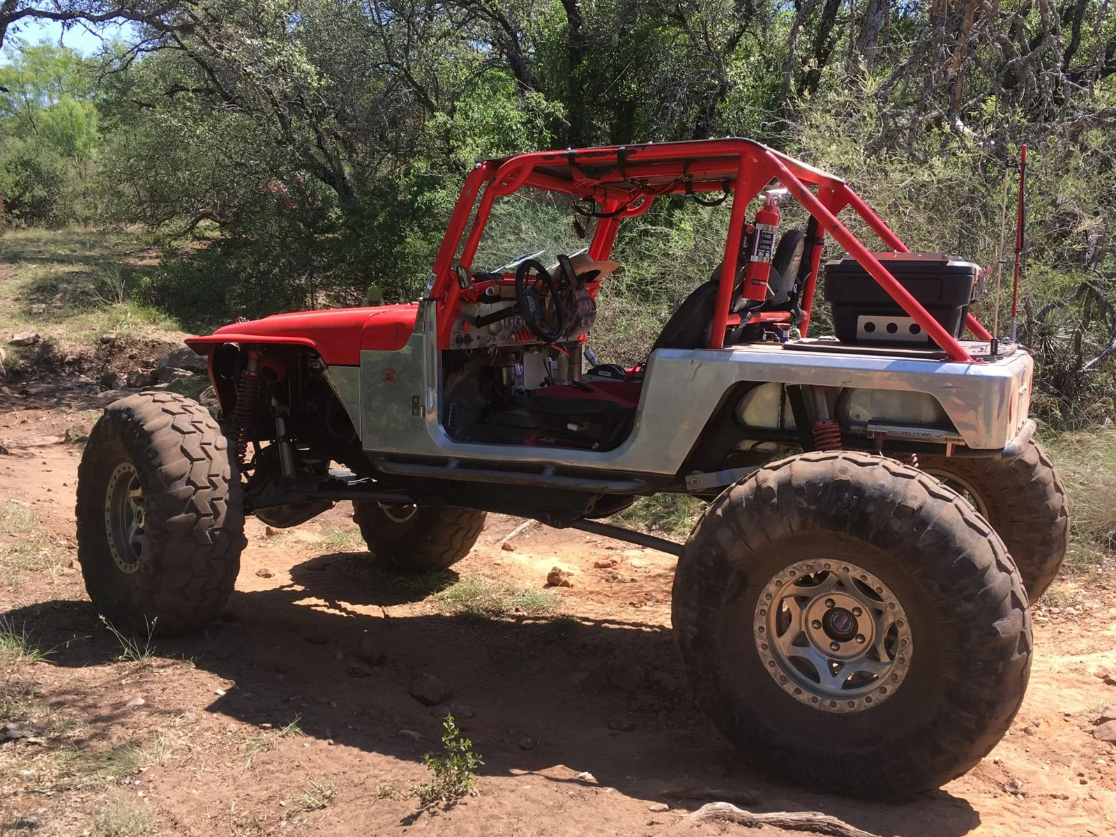

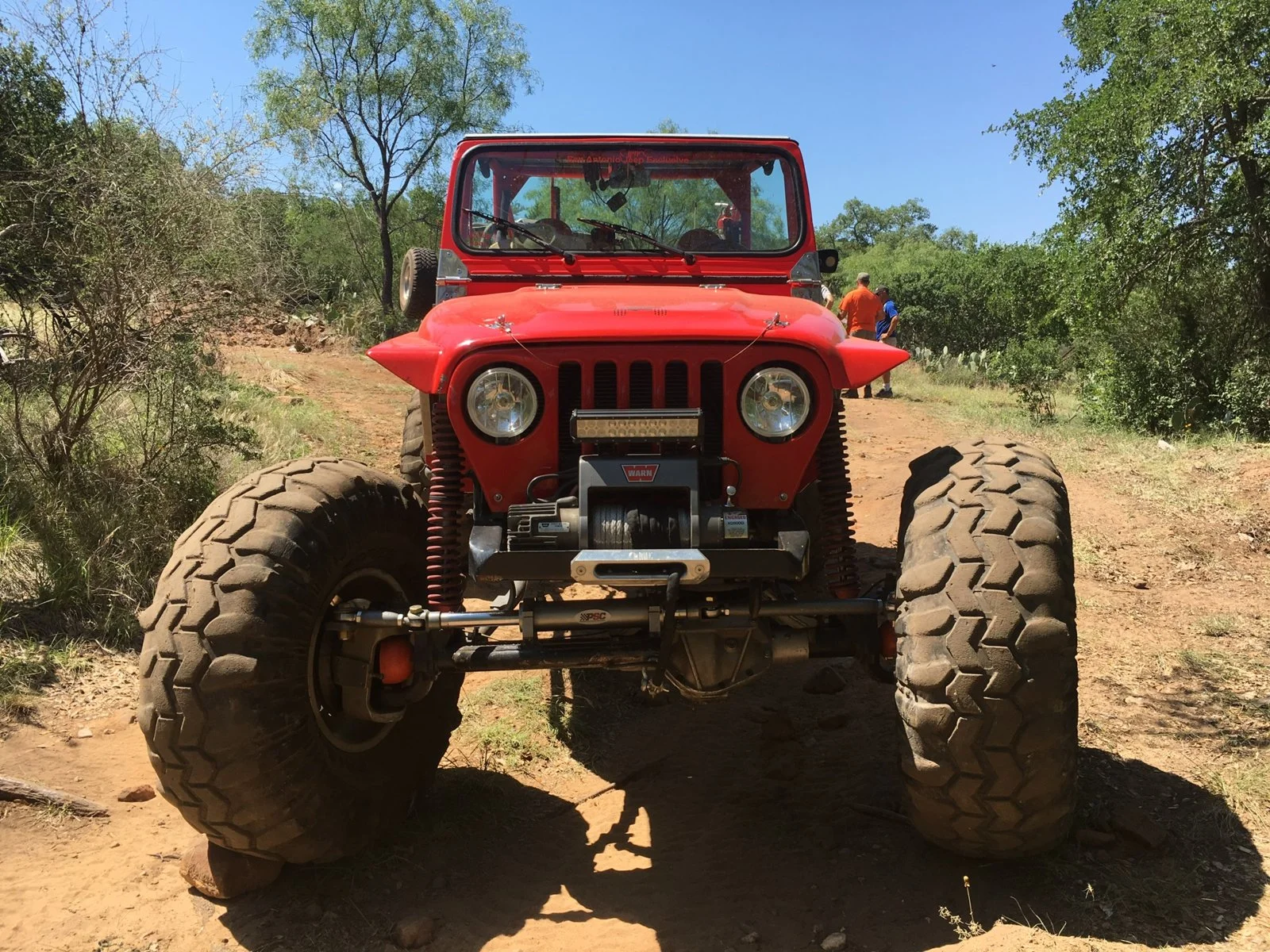

The orange rig you posted up moved the body out of the way of the travel. There is also a lift for sure, but moving the body out of the way is one way to maintain up travel.
The orange rig I posted is also 0% Jeep. It’s a complete custom chassis along with everything else. It is low compared to what it would be if it were built on a TJ platform. I’m comparing apples to oranges here, but I would like to have “orange rig” performance out of my TJ if at all possible.
Still, it’s just a lot of cutting on a TJ tub, right with wider axles. I’ve seen a CJ narrowed. That was the best way I’ve seen yet to maintain the Jeep tub, preserve the up travel and basically be a buggy.
If you’re asking about the orange rig, it isn’t any Jeep body at all. It is a custom body with a Jeep tailgate. The grill isn’t even from Jeep. The only Jeep on the thing is a CJ tailgate if I remember correctly.
I don’t think you’d be able to achieve what the orange rig has if you started with a TJ tub or a TJ frame.
I wasn’t asking anything, I understand what you’re saying about the orange rig. I was just saying that the rig I posted above is about as close as you can stay to a Jeep and near the capability of a buggy. In other words, if you wanted to do something like the orange rig but keep your rig like a Jeep, you could aim for something like the pic above.
