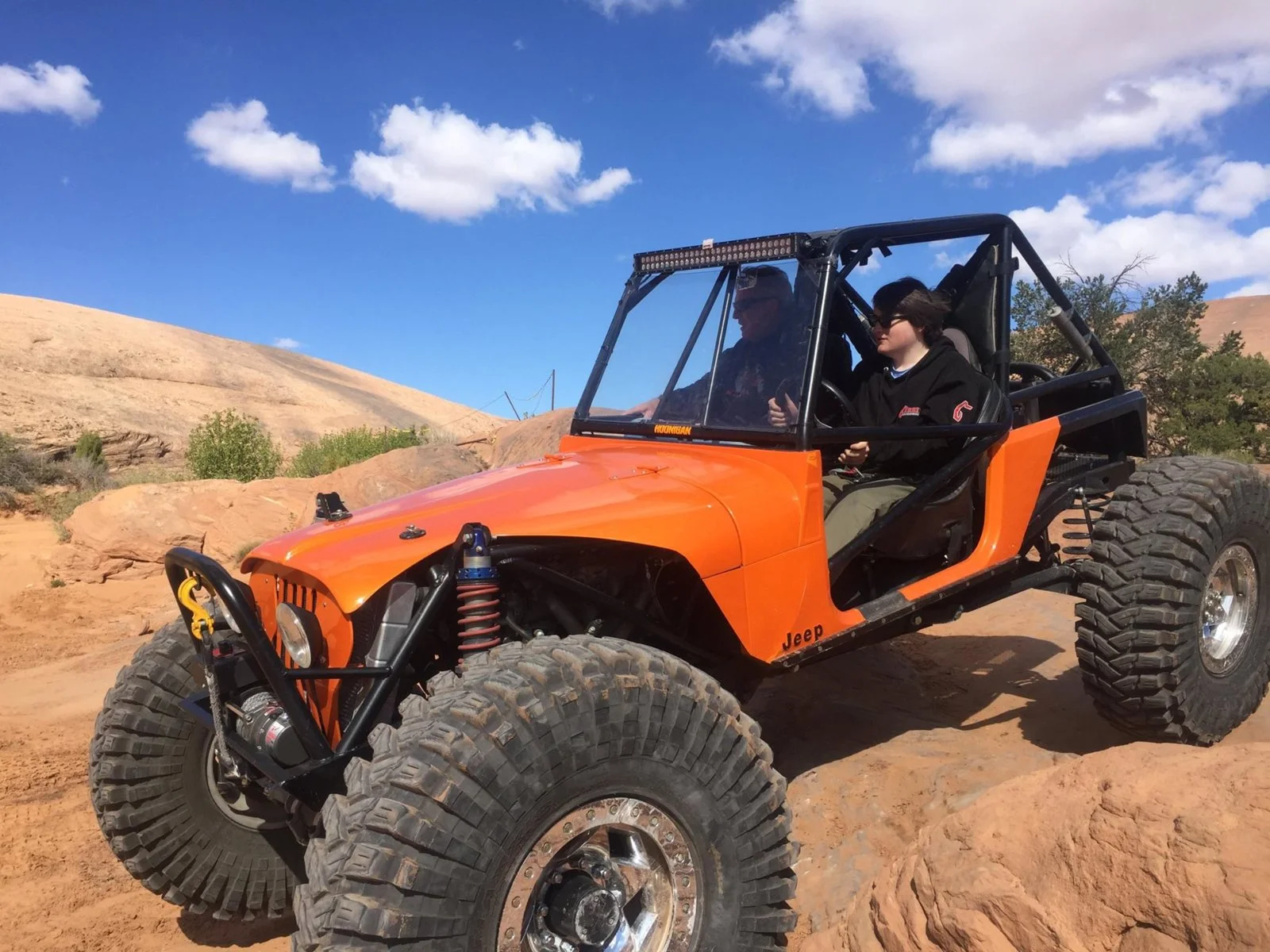

Some of my ideas on this come from comparing apples to oranges. I've attached a photo and a video of the buggy I was able to drive in Moab a few years ago. I've never driven a vehicle off-road that seemed so stable. You could point this thing at pretty much anything and it would crawl right up with no drama (no hopping, no feeling the front end getting light, nothing). There was one climb on Poison Spyder where a TJ with a 5.5" long arm almost ended up rolling over and was saved by the tire carrier. I drove this buggy right up with absolutely no problems what-so-ever. Whether it is possible to get buggy-like performance out of a TJ, I'm not sure. But I would like to get as close as humanely possible.
The buggy is pretty low when considering it is sitting on 42's. It is also a lot wider and a lot longer than a TJ. I know I am comparing two COMPLETELY different things, but I still think there is something to be learned.
