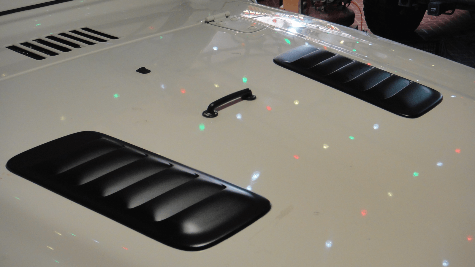

I installed a couple of 5.9 ZJ vents in mine. I did not do it to lower engine temp, but to help excess heat escape. I can touch the prop rod after wheeling now without it damn near burning, and the hood temp is quite a bit cooler.
I have the drip pans on, and ZJ guys say removing them helps the heat get out faster.

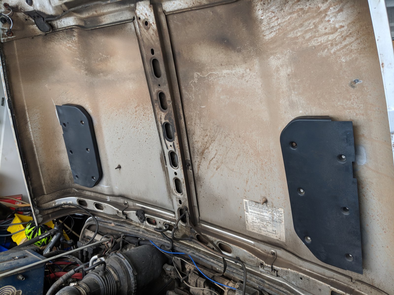

Nice vents! When I found mine in the junk yard, the PO had chopped a big hole in one of the drip pans. I patched it with a sheet of ABS plastic.

For anyone who thinks that the drip pans are needed to keep water out of the engine bay (and off our oh-so-sensitive under-hood electronics), take a look at the inside of the hood and tell me that drip pans make any difference at all.
Reactions: jjvw
x2. When I take my Jeep to the self service cash wash I will usually give the engine bay a spray on low pressure.
I can't think of a aftermarket louver panel that has drip pans. But, my ZJ louvers had them, so I used them.

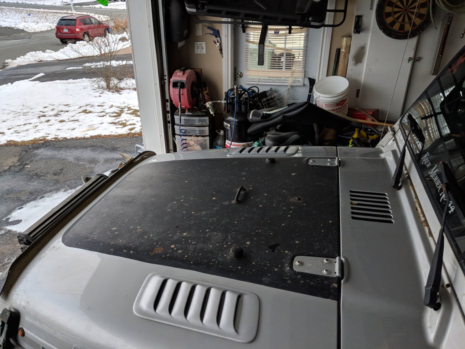

I installed a pair of Gen Right long narrow vents to help with heat soak. Of course a week later I read about the factory fix. But as others have found, it keeps the engine compartment temp down. And you can touch the hood even when the engine is hot AND the Arizona sun is HOT!
