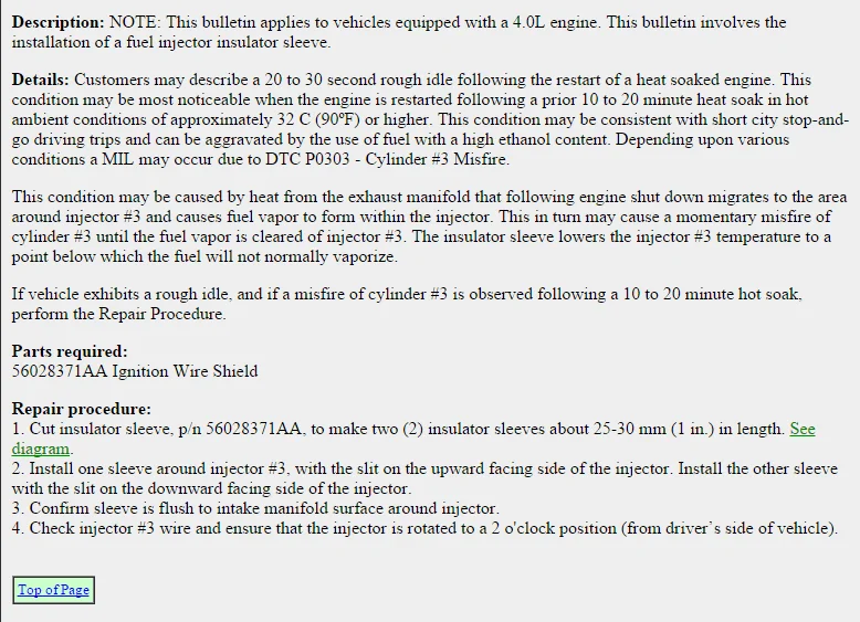

I installed a pair of Gen Right long narrow vents to help with heat soak. Of course a week later I read about the factory fix. But as others have found, it keeps the engine compartment temp down. And you can touch the hood even when the engine is hot AND the Arizona sun is HOT!
What is the factory fix you refer to?
This is it.
