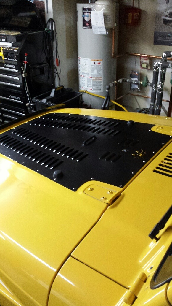

Here's my Poison Spyder hood. Very good product, instructions were well done and the template that came with it made it pretty much fool
proof. Also good info. on youtube.

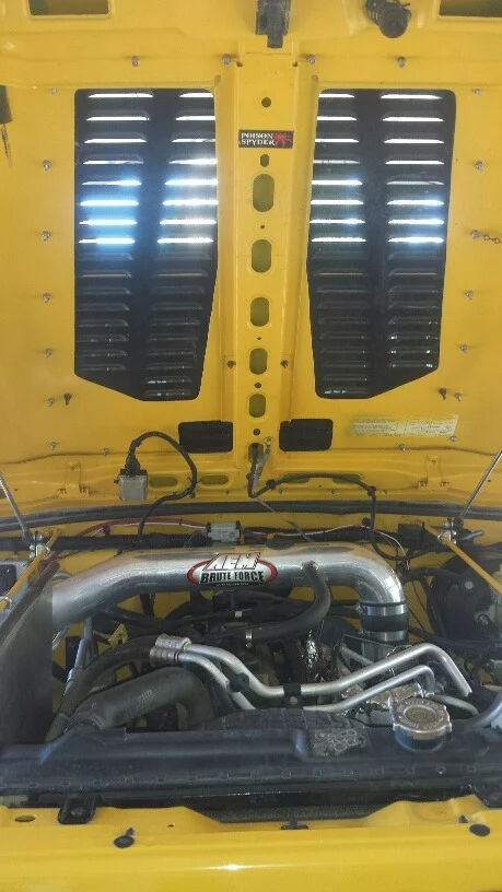

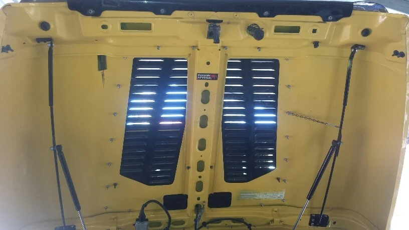

What’s it look like under the hood where you have to cut? Any pictures?
Here's a couple of pics for ya.
The mod. is not that difficult, good thing is the kit comes with a great template, almost fool proof if you follow the instructions.
