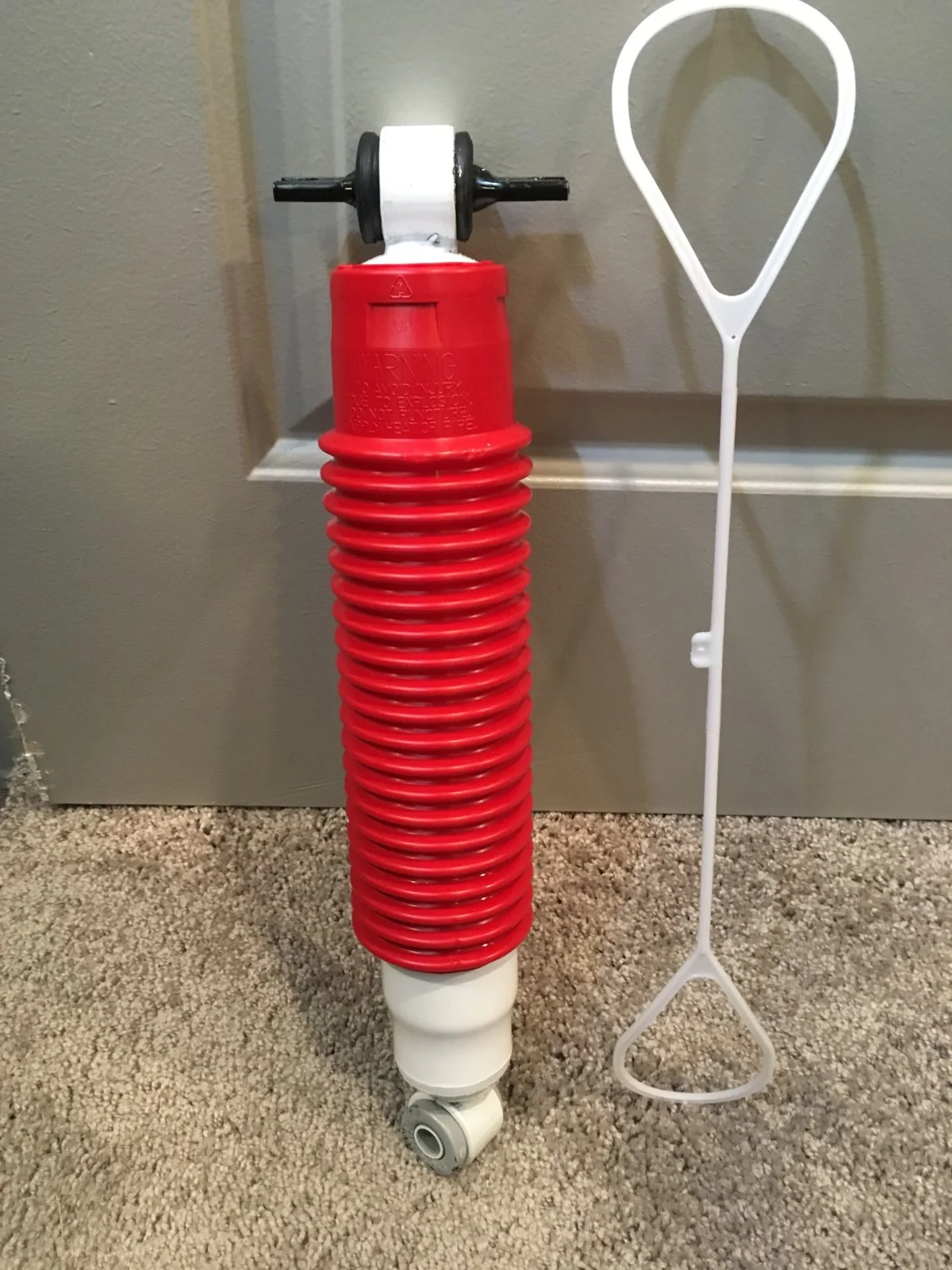

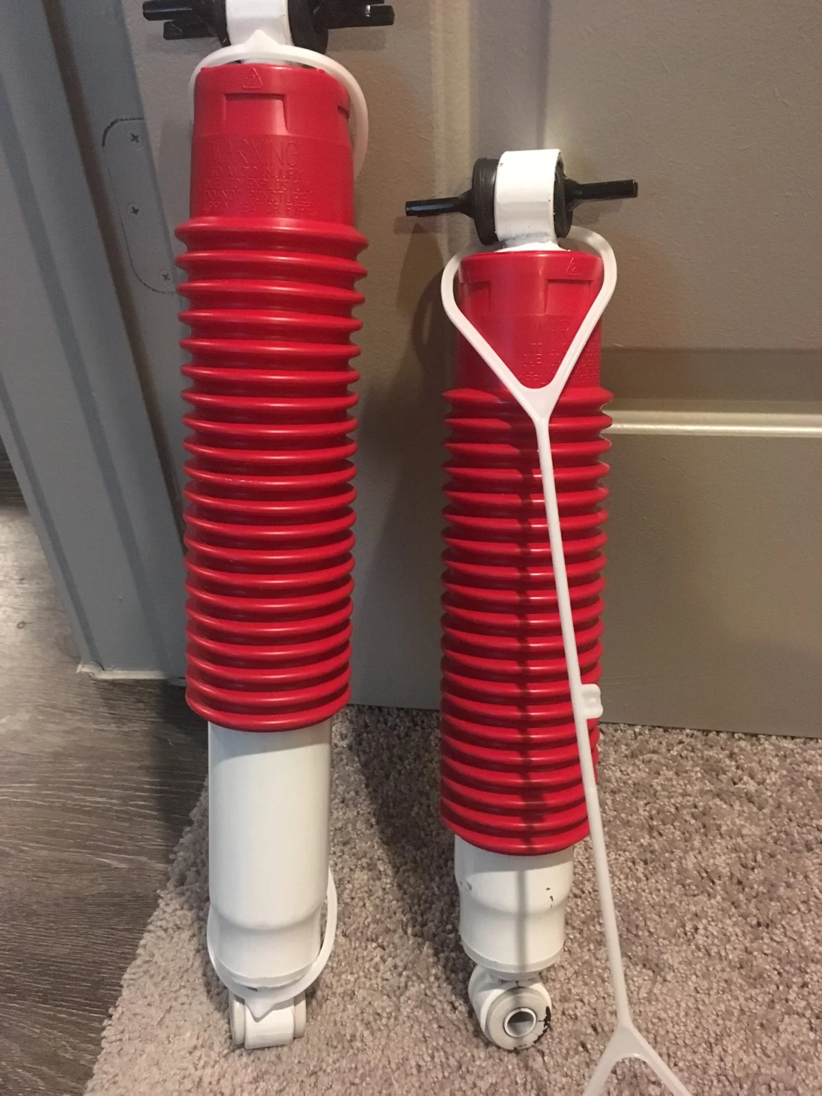

I received Rancho shocks that would lock when compressed. You'll need to remove the springs and cycle the axle anyway to determine bump stop extension needs.
Rancho RS55256 Locked in Compression #2.JPGRancho RS55256 Stuck Compressed.JPG
View attachment 73617View attachment 73618
Lock? Or would they just stay at where they were positioned? If so that's just how hydraulic shocks work... they don't push back out after being compressed after you let go of them.
Locked, turn/twist and pull hard to unlock; there is no twist or turn action to un-lock during operation. These shocks are pressurized, low pressure rear, high pressure front, so they will "push back out" when compressed and healthy.
