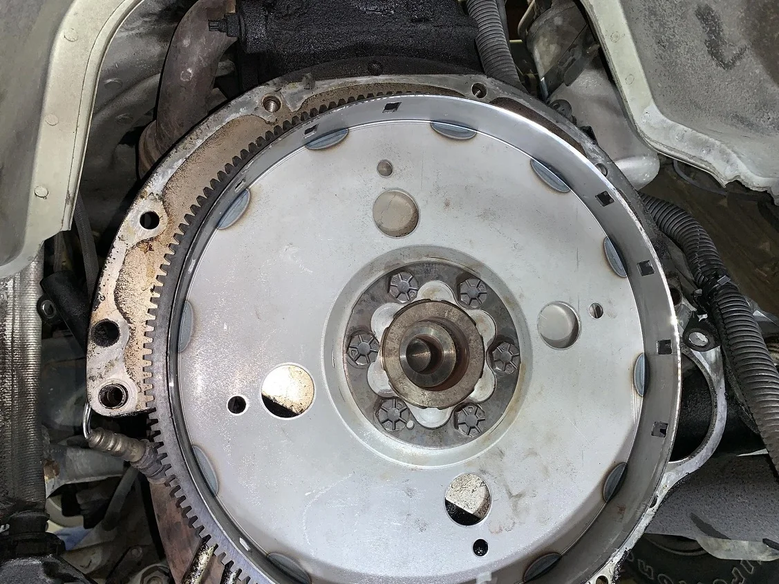

How to remove flexplate mounting bolts
Thanks, Jerry! Yeah, Most of my stuff is 3/8", so that's good to know. I'll probably make a trip to HF today. Thank you!
Pneumatic tools are so yesterday...like Jerry said go to harbor freight and buy an impact gun they are a game changer
Agree….but I do miss the “vzzooom” sound when it really breaks loose! Feels like you got something done….or you’re in the NASCAR Pits!
Heh, heh....I have an 18volt Ridgid impact drill all along and didn't realize it....heh, heh.
Flexplate off! NASCAR indeed, cpwolf. Feels good I'm actually on the second half of this whole transmission ordeal. Thanks, guys. I greatly appreciate all of your input and insights.

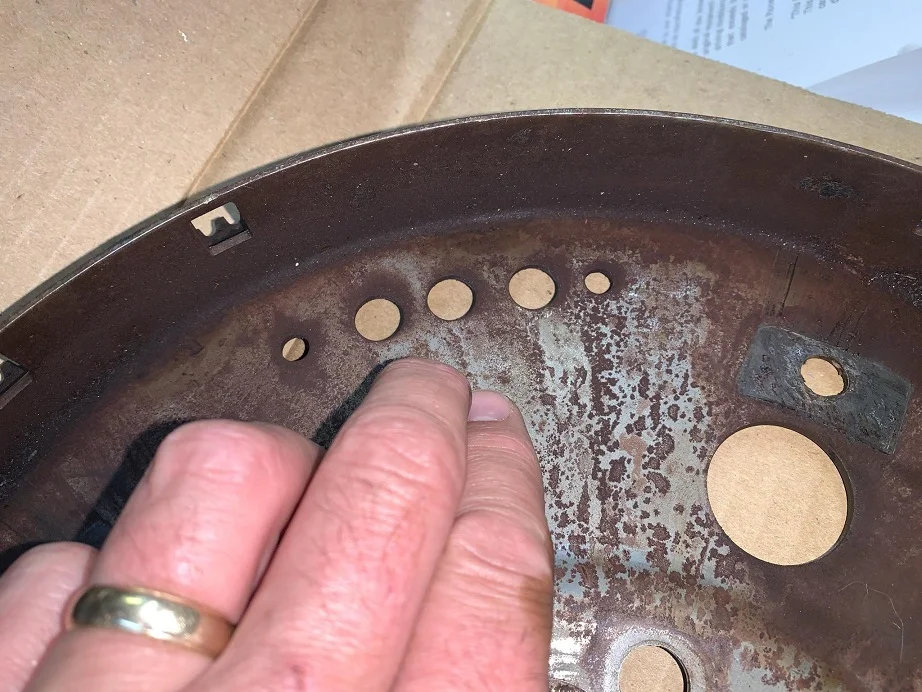

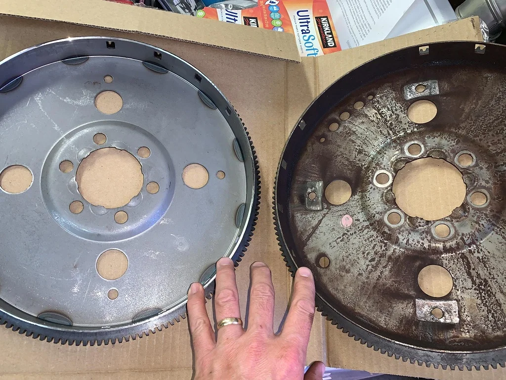

Everything on the new flexplate looks similar to the vehicle's original except for the absence of these holes. Are the holes a type of weight reduction for balance? Should I be concerned? Also, does the flexplate have to go on in a certain orientation (note the original also has a splotch of pink paint?) I can compare the new flexplate's position in relation to the photo I included in this thread's original post, but I'm not seeing any discernable notch or indicator the new flexplate should be mounted a certain orientation (other than backwards, that is)
❓One more question: what are the cog teeth around the perimeter for?
EDIT: nevermind I searched and learned: Like flywheels, flexplates normally handle coupling to the starter motor, via teeth cut along the outer edge of the plate. These teeth give the flexplate a gear-like appearance, in spite of this being a secondary function.
Yes, the bolts are offset slightly where it will only go on correctly if they all line up.
Exactly as you describe. Thanks!

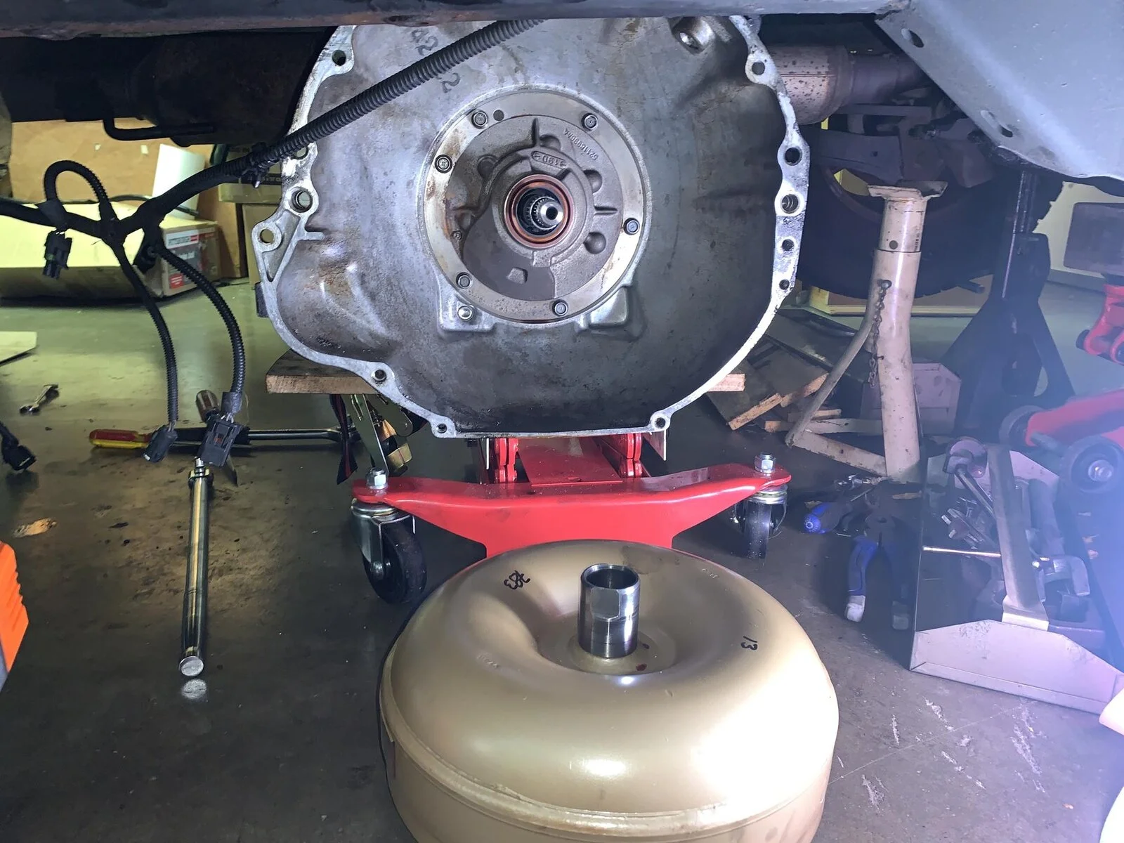

Are there any good videos or threads detailing installing the new torque converter? There are several videos I have located, yet none for a TJ Wrangler. Is the procedure pretty standard (partial fill of the TC with ATF and some of the ATF on the spline?) I'm keeping the housing under the vehicle as it won't clear the jeep's height and I'm hesitant to jack up the rear further. That should be okay, yeah?
