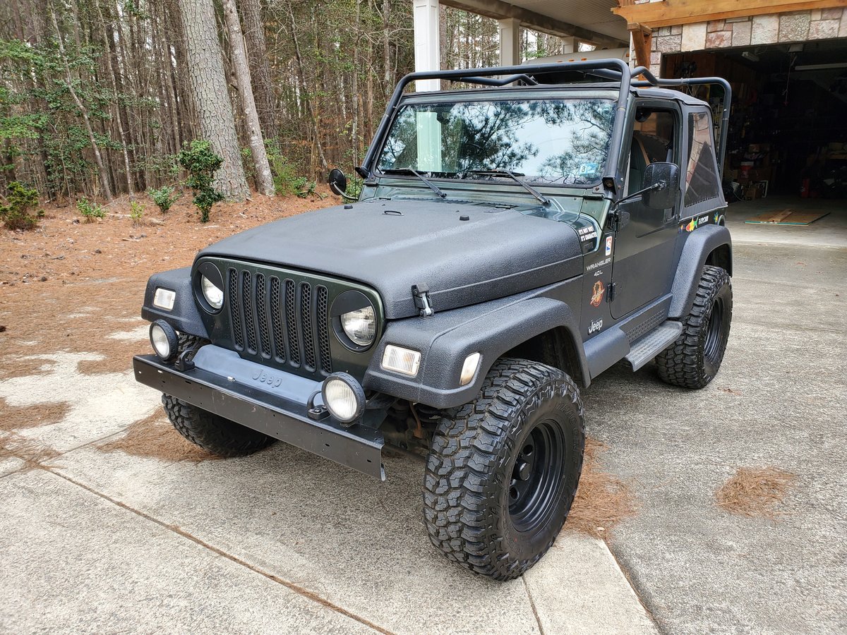

I've got a 97 moss green Sahara that I'm transforming to a black theme. Didn't want to spend the $$ for a proper exterior paint job so I tested out and ended up using a roll on bed liner material. Turned out pretty well for the first sections I've done.

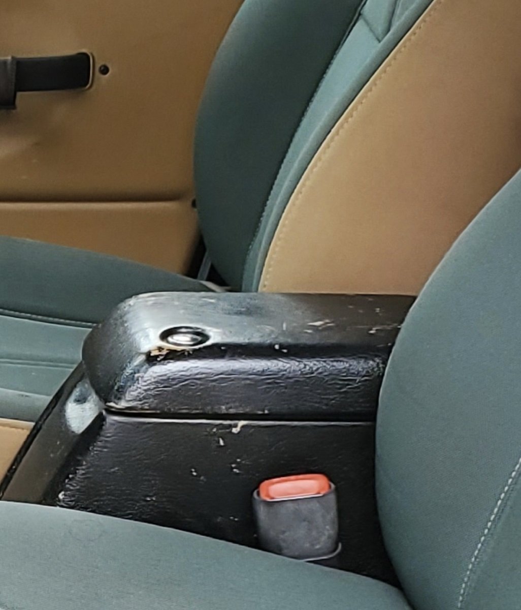

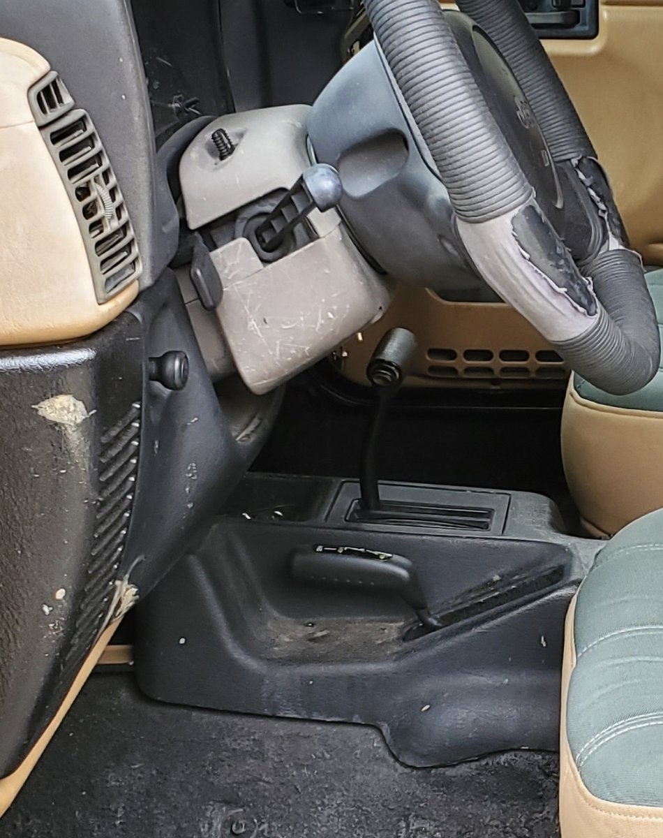

Just ordered the Landau Black and Dark Slate and plastic adhesion promoter. My center console has was previously painted (no idea with what) and that paint is slightly chipped on the armrest area but appears to have held up pretty good in the lower section. Any suggestions on how I should prep that? I'm assuming the adhesion promoter won't work on that since it's already painted?
I think I would probably just leave it there and take my chances with it, instead of trying to remove it. If it doesn't flake off when you pick at those bare edges, I would do a little more in-depth scuffing to those bare edges with the scotch brite pad, just to try and taper them off the best I could. After that, I would carry on with the adhesion promoter just as I would on an unpainted surface. It's not necessary for the painted areas, but it will be for the places where the paint has flaked away. The paint that remains on there is doing the hard job of bonding to the plastic, and acting as your primer. Now all you need to do is change the color of it. But, on pieces with areas that have numerous, scattered areas with no paint covering the plastic, you might as well give the whole piece a coat of adhesion promoter.
One thing to remember when you're using the scotch brite pad (and most especially when there's already a coat of paint, the more you scuff things up, the more original texture you will lose.

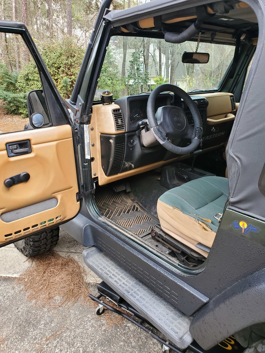

@mrblaine I just saw the picture you shared of your painted trim bezel. Do you happen to have any more pictures you can send over?
Also, if there's any helpful info that you know of that can be added, it would be much appreciated.
FYI those pics of the dash were from the build thread by @ObiWanWebWheelr and @mrblaine titled My LJ Thread - A MrBlaine Spec'ed LJ Build for Daily Driving and Weekend Adventure

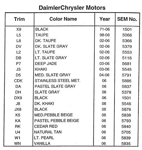

I got some helpful info yesterday. I got back in touch with them at SEM Products. I was initially referred to the 15833, but I showed the results that I had with the 15833, so he went back in to research it. He came back and told me that the 15833 was in fact a lighter shade that was used in 2008, and then told me that our color needs to be mixed. The color for that is shown in the "Trim Codes Formulas" on their resource page that I sent a link to.
Here's the one showing our khaki (PN: 5545):
