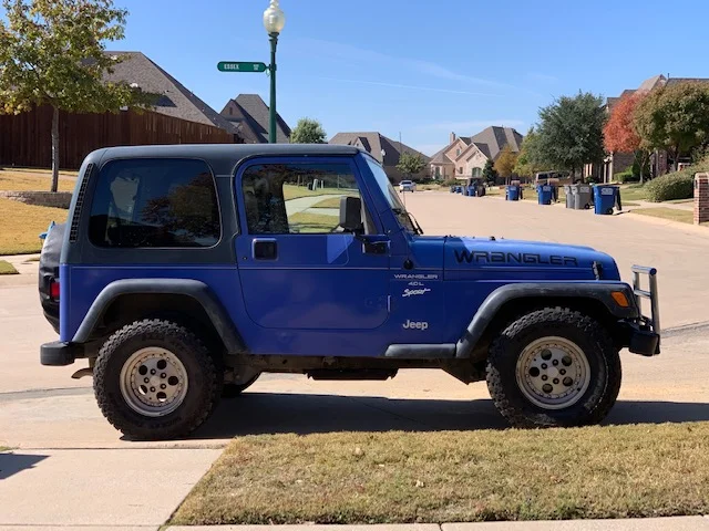

Introducing Big Juicy
I've got the story of the rebuild captured in a thread on the main forum, because I figured that would be more interesting to people. Given that I've got zero replies on it, maybe I was wrong. :)

Neat, match the recycle bins !!
