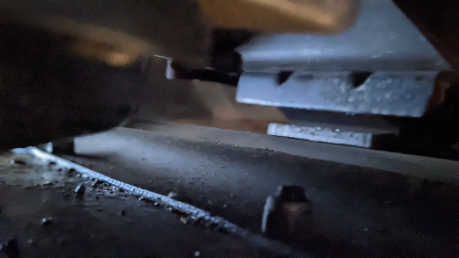

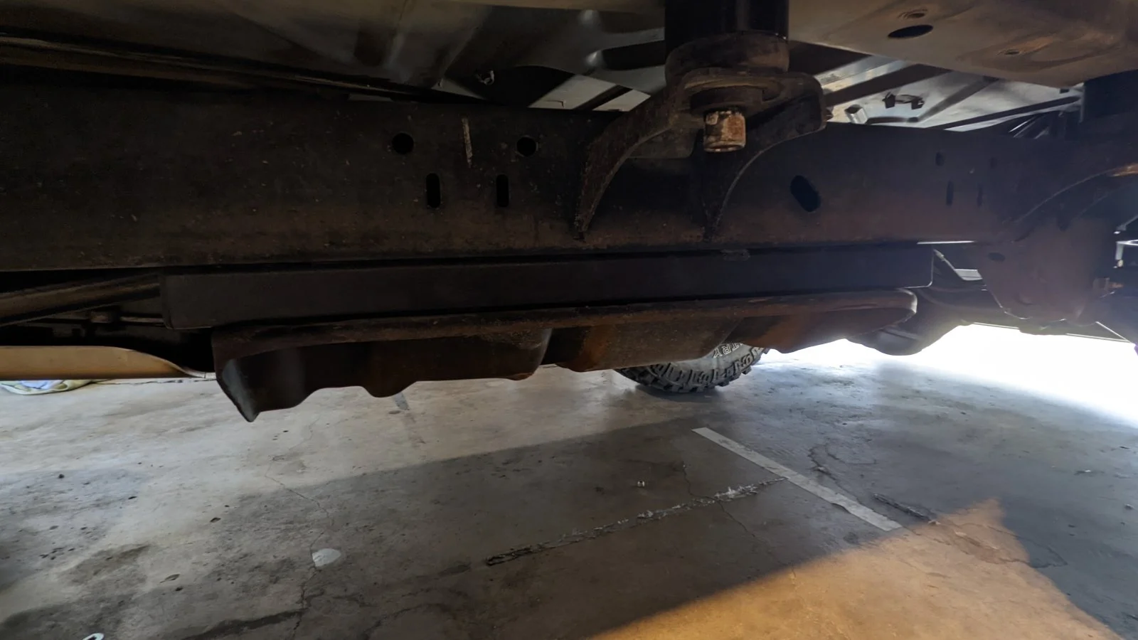

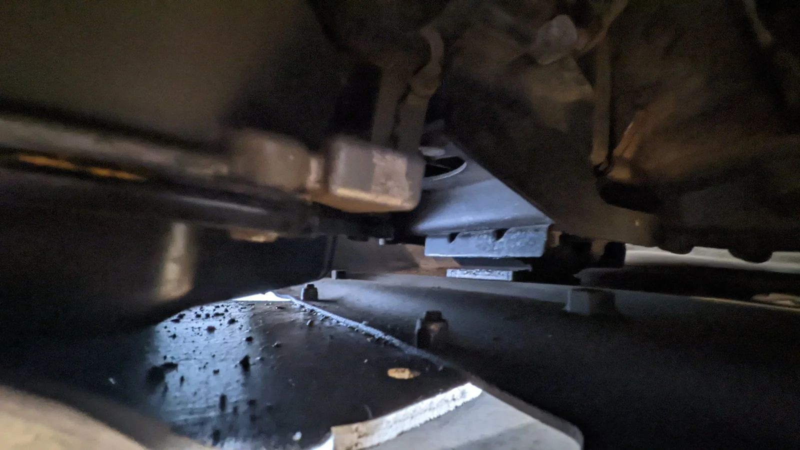

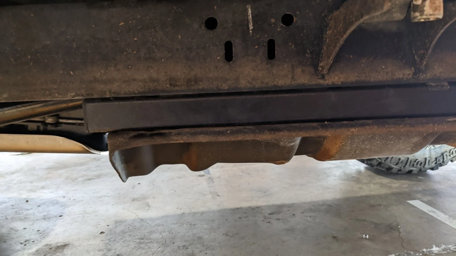

Looks like the skid was lowered? Can I simply remove this and replace w/ a new skid?
You have an engine skid? I'd match that height if you can. It was great on the trails.
But for zero cost you can take out those skid spacers. Assuming you have the stock bolts.
