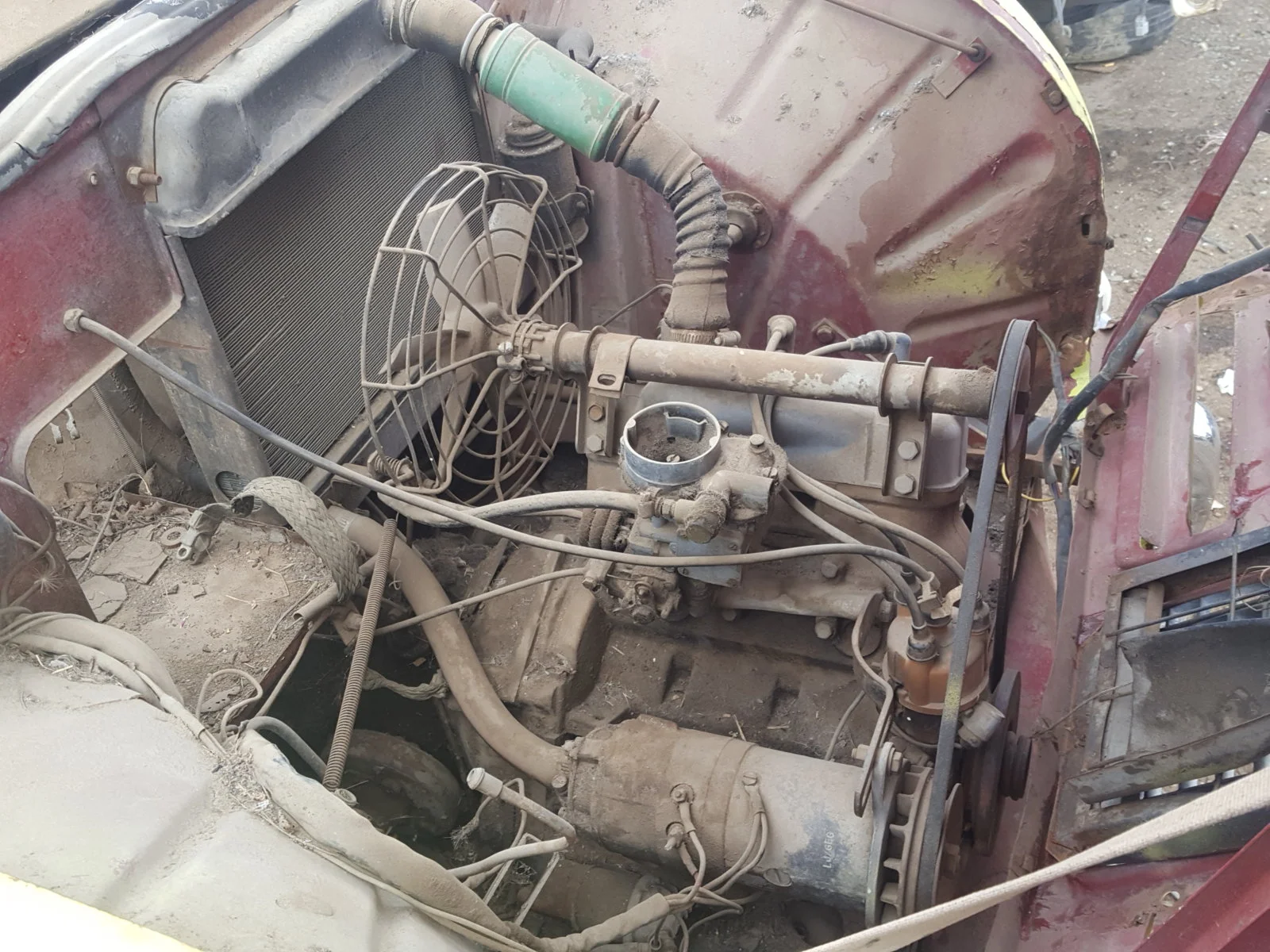

Are we going to start listing off other engines? Here's an old Saab with a mechanical fan.
