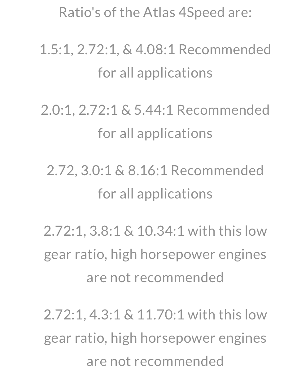

Makes sense. If I understand it correctly (might not), a 4 speed Atlas would be the only option for a similar gear set up with my AX-15.
I run the second option - the 5.44 low. I love it, but never use the 2.72. Always run either 2.0 or 5.44 offroad. Very easy to swap between the two using the single planetary shifter.

Of those, the first two look like the only real options.
I would disagree somewhat. The other options are good also I think for those who have a manual transmission. The 10:1 or 11:1 compounded crawl ratios IMO are usable if you have a manual.
My 5.44 low is OK but I can think of times even when with my auto I wished I'd had a little lower crawl ratio.
