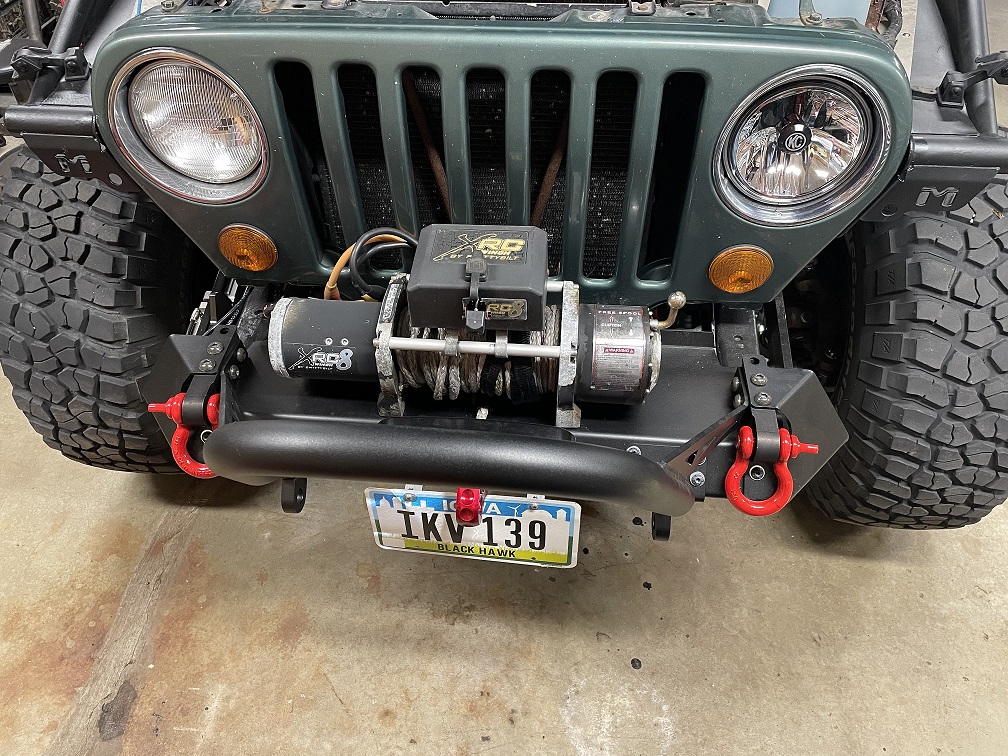

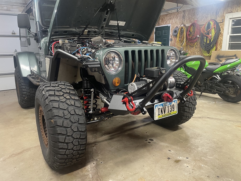

Aside from ordering the majority of the parts, I decided to start with the headlights (lets be honest, they just showed up at my door first):
When I started my headlight search, I really had no idea what to get. It hadn't yet occurred to me to check this forum, So I just started searching and set my search bar to filter the results High to Low. Probably sounds silly to do that, but I am the sort of guy who does not like to bling out his ride with lights in every direction and hanging from every post/corner of the jeep. So I really needed my headlights to be high quality. I really only see me maybe someday adding a couple of fog lamps and possibly something to supplement my reverse lights someday.
For headlights, I ended up going with the KC HiLiTES 42361 Gravity LED 7" Headlights:
I got them from quadratec, but you can find them all over the place online.
https://www.quadratec.com/products/97025_0041.htm

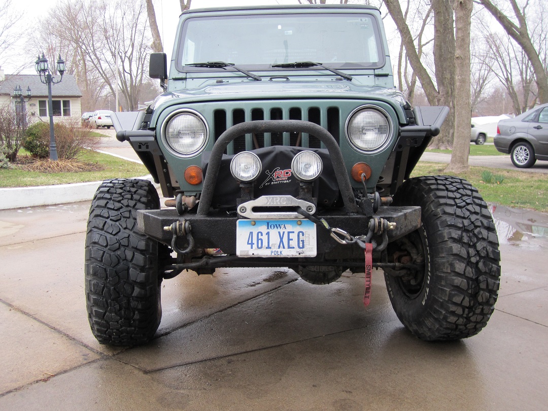

Some of these pictures I have already uploaded for different reasons, but this time I'm highlighting the evolution of the headlights:

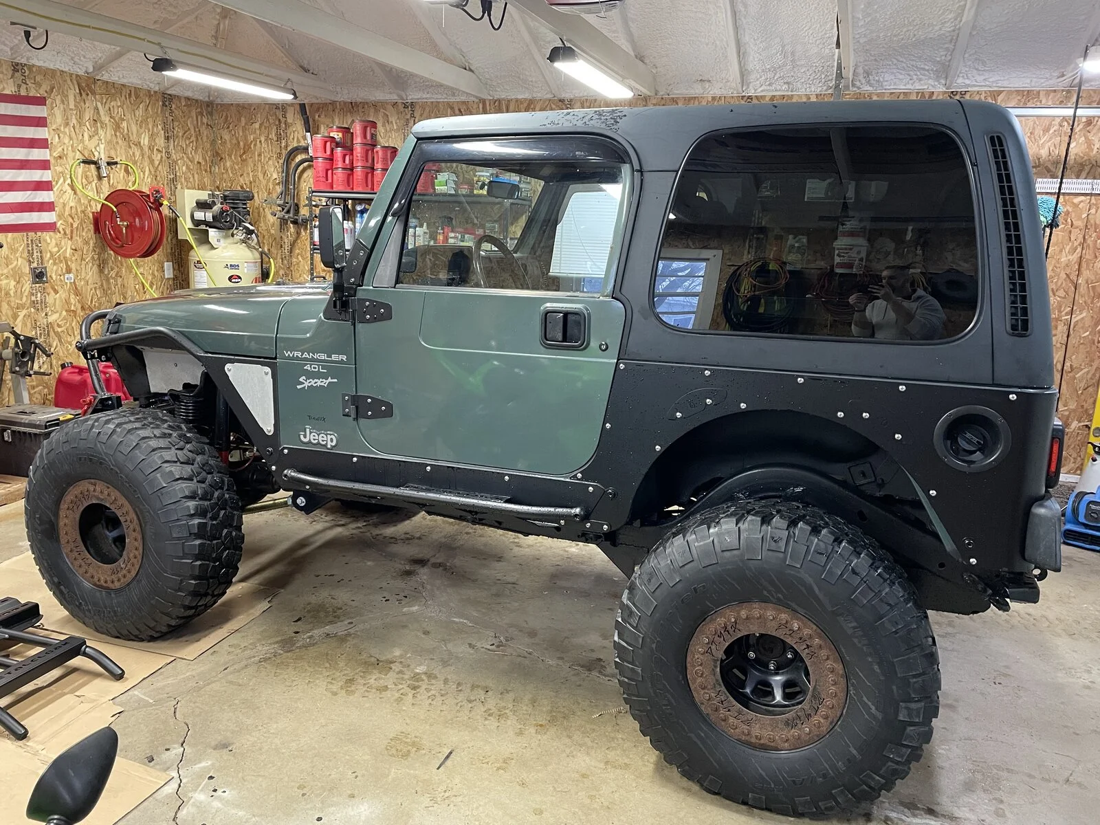

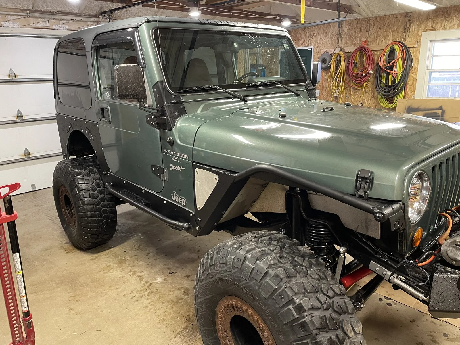

OK!!!! First, let me try to explain the body shop trip.
My jeep had rust rot in all of the typical spaces with the exception of the frame. My frame only had one soft spot that we were able to repair without wrapping the frame or replacing any sections. So I needed that repaired. Of course, once I knew it was going to a body shop.... I came up with a list. 😇
Here is the original list:
Repair frame
Repair/replace the tub side of the body mounts
I had actual holes in the rear of the tub down low on either side of the tailgate that needed to be cut back and repaired with new metal
Adjust driver door that wasn't closing right
Spray POR15 inside of frame rails
Clean up surface rust in rear wheel wells, and paint them black
Once he had the jeep in his shop, we added the following things to his list:
Clean up surface rust in driver/passenger floor pans and coat with POR15

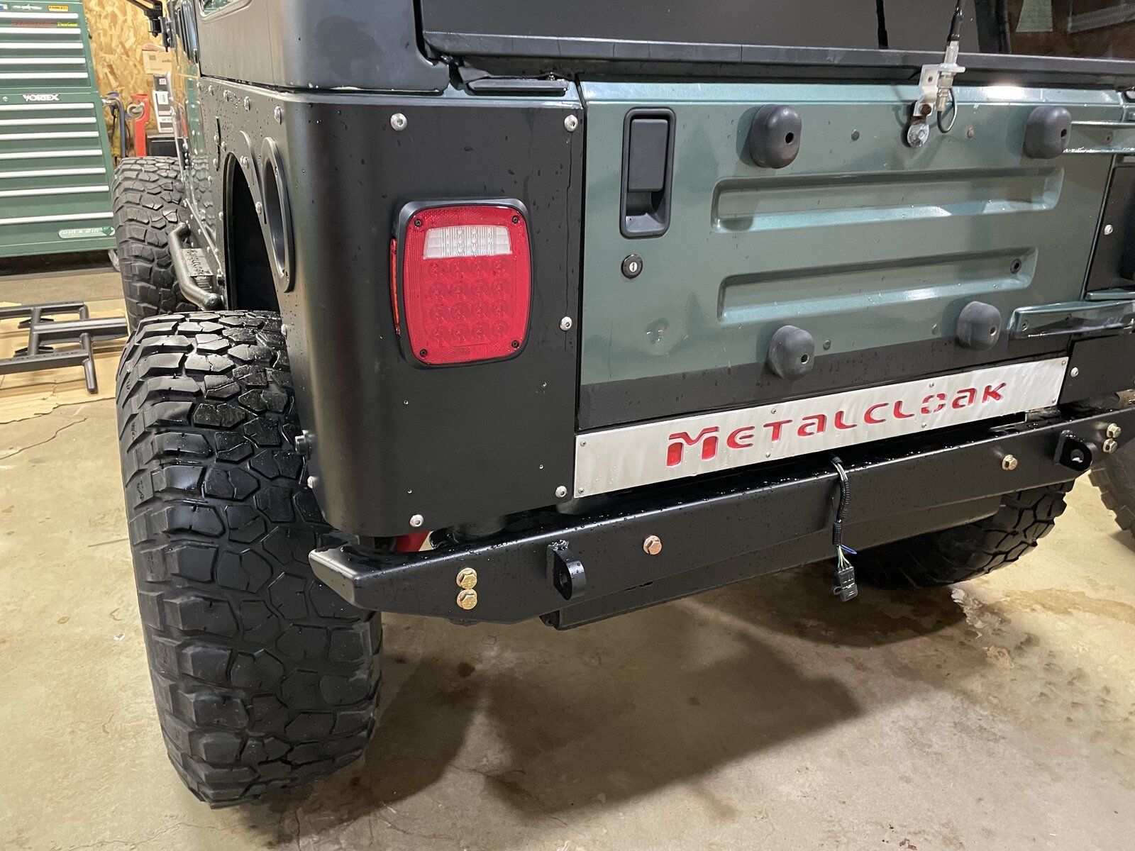

and... a little treat to myself... mount my new MC rocker slides, corner guards, tail lights, tramp stamp, and rear bumper! (he offered... how could I say no???)
When I got the jeep back today, He said, "you know, by the time we got done bolting on those panels, we all really liked that jeep! That thing is bullet proof!" :LOL:

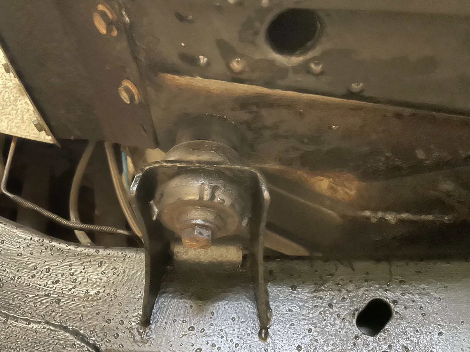

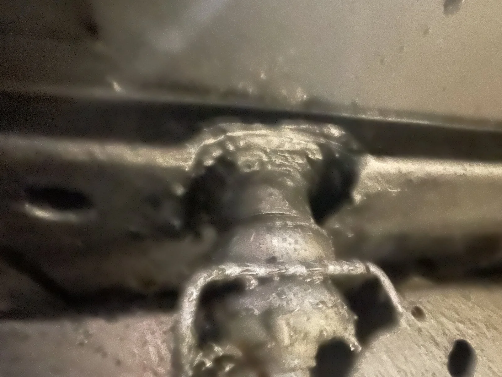

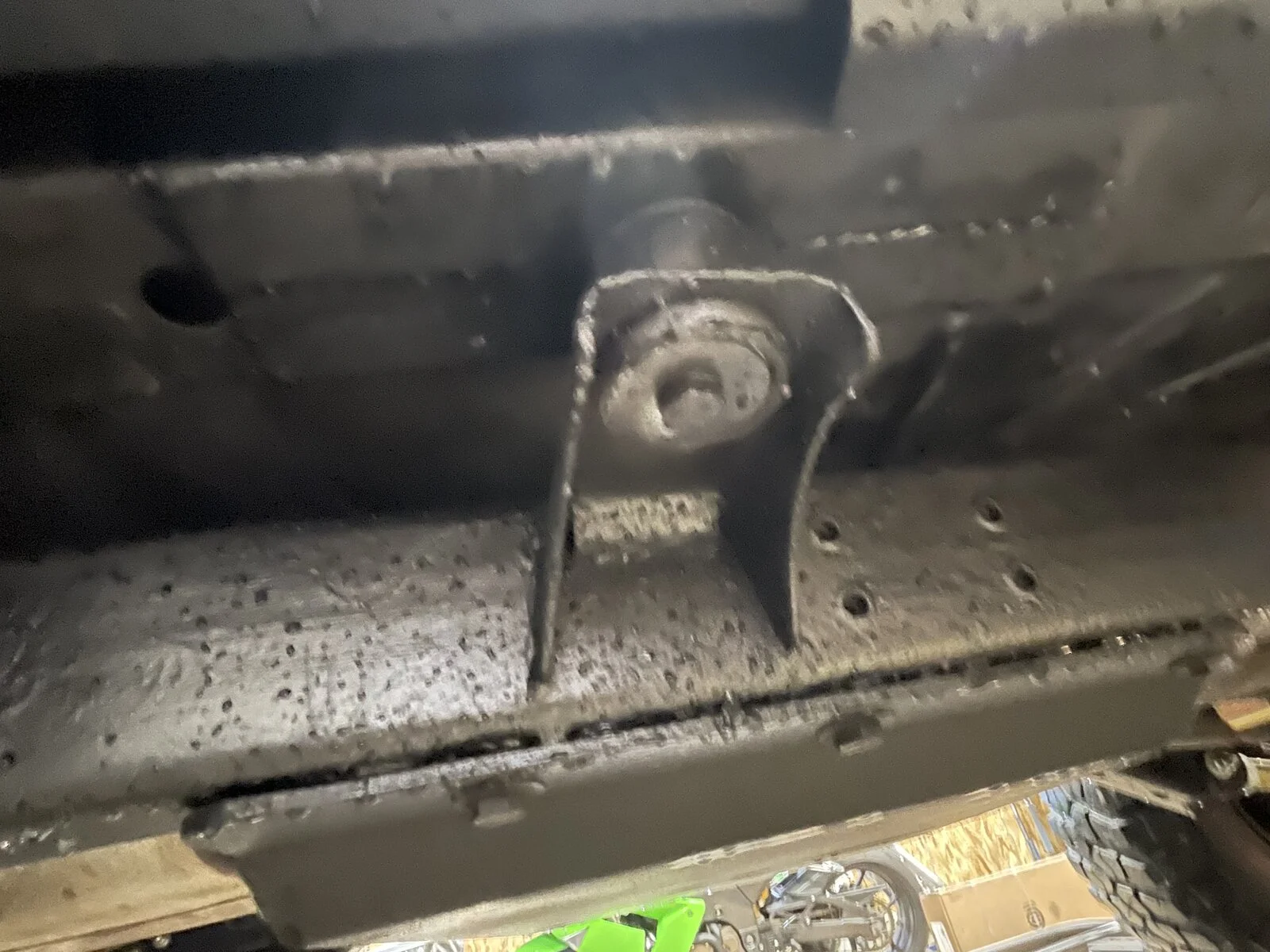

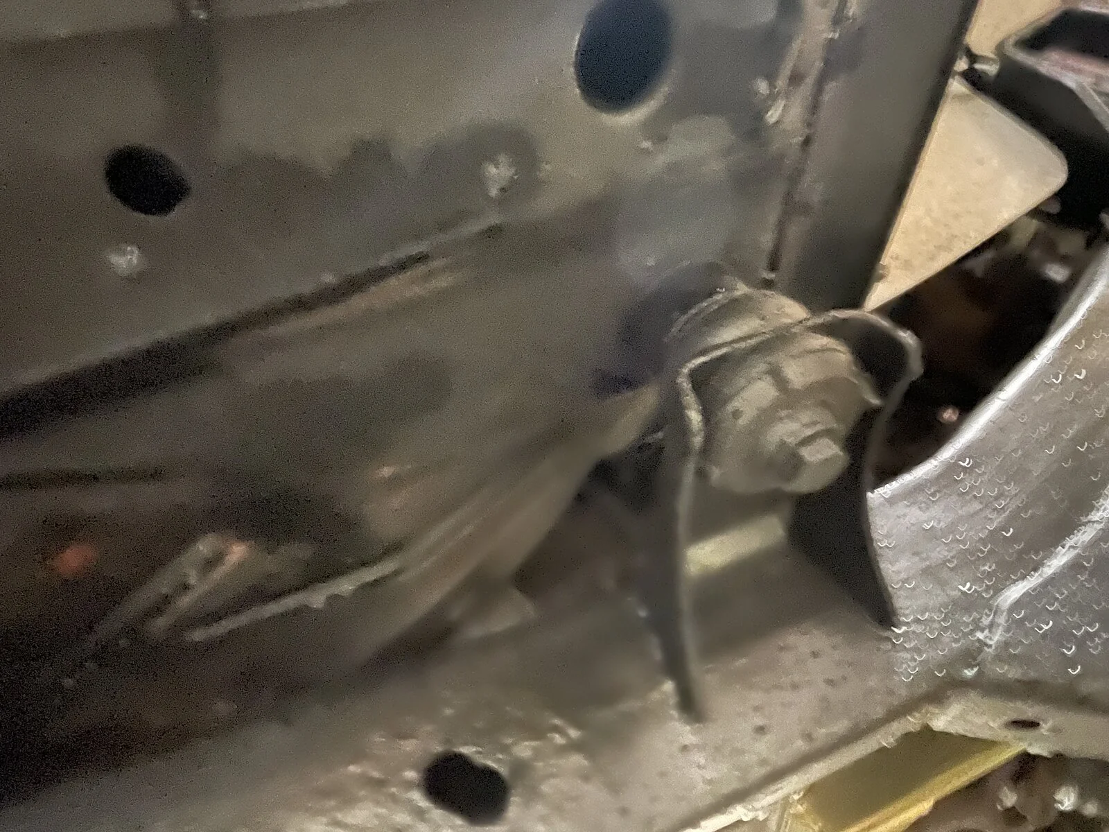

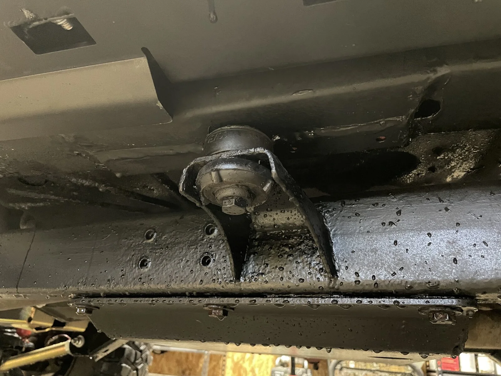

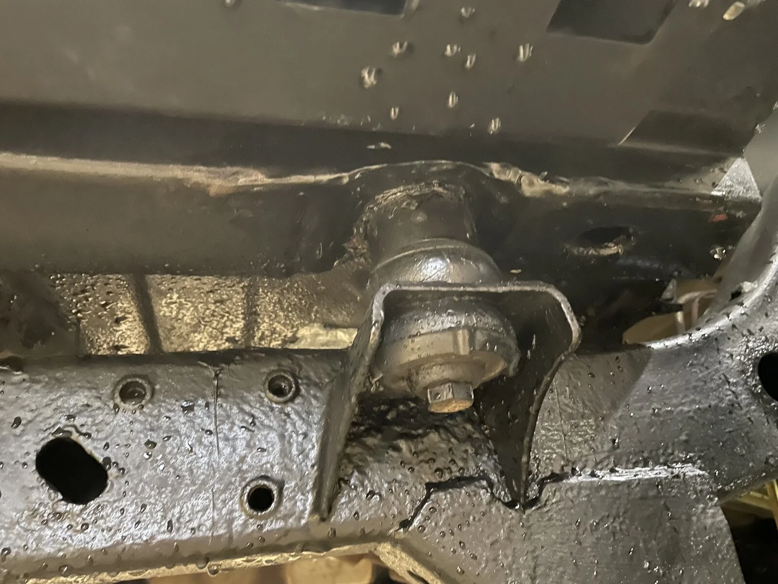

First, Let me show you his work on the body mounts. Its a little hard to see because it has all been painted (don't mind the water spots... I had to wash it after knowing it had been driven on Iowa roads in the dead of winter):
Didn't realize how blurry they were until i went to upload them!! Grr... They aren't the most glamorous pictures to take, so I was in a hurry.

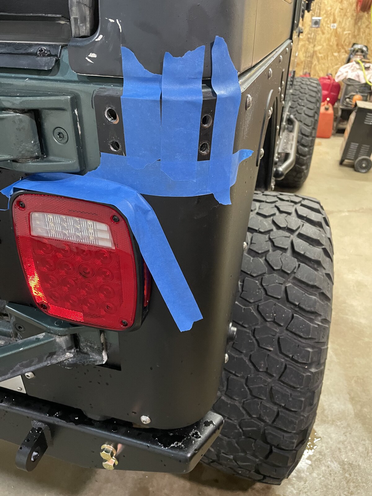

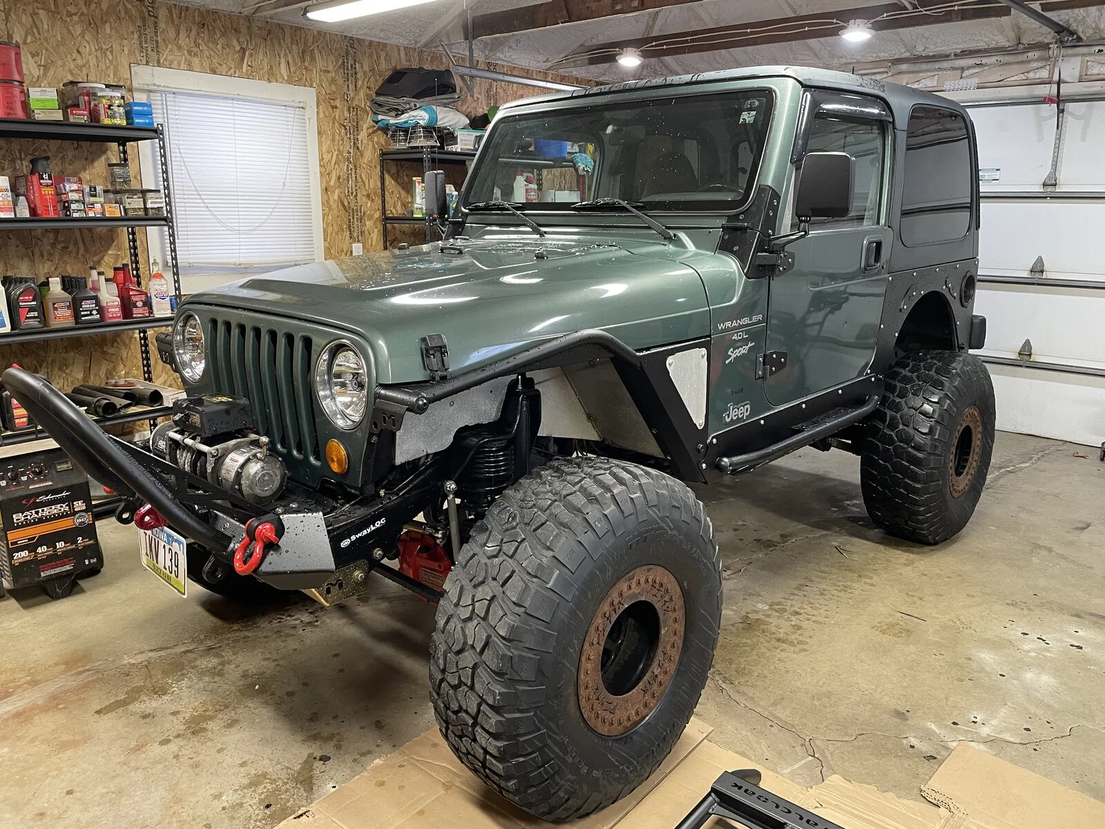

I didn't waste any time today starting on my next project. Some of you may have noticed a little mistake made at the body shop:
The license plate bracket was NOT suppose to go back on. IDK where the miscommunication happened, but it happened. Its not a huge deal, but it did result in four holes that would not have otherwise been there. bummer, but oh well. I took care of that right away.

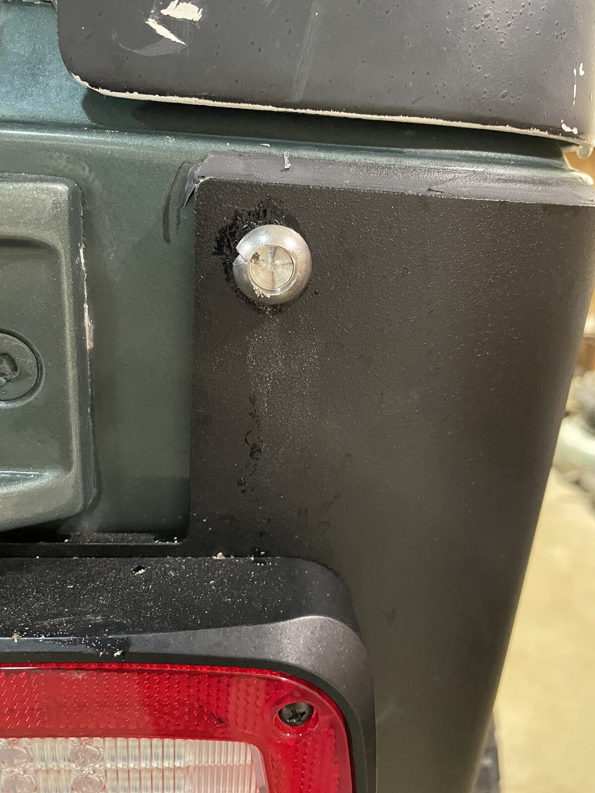

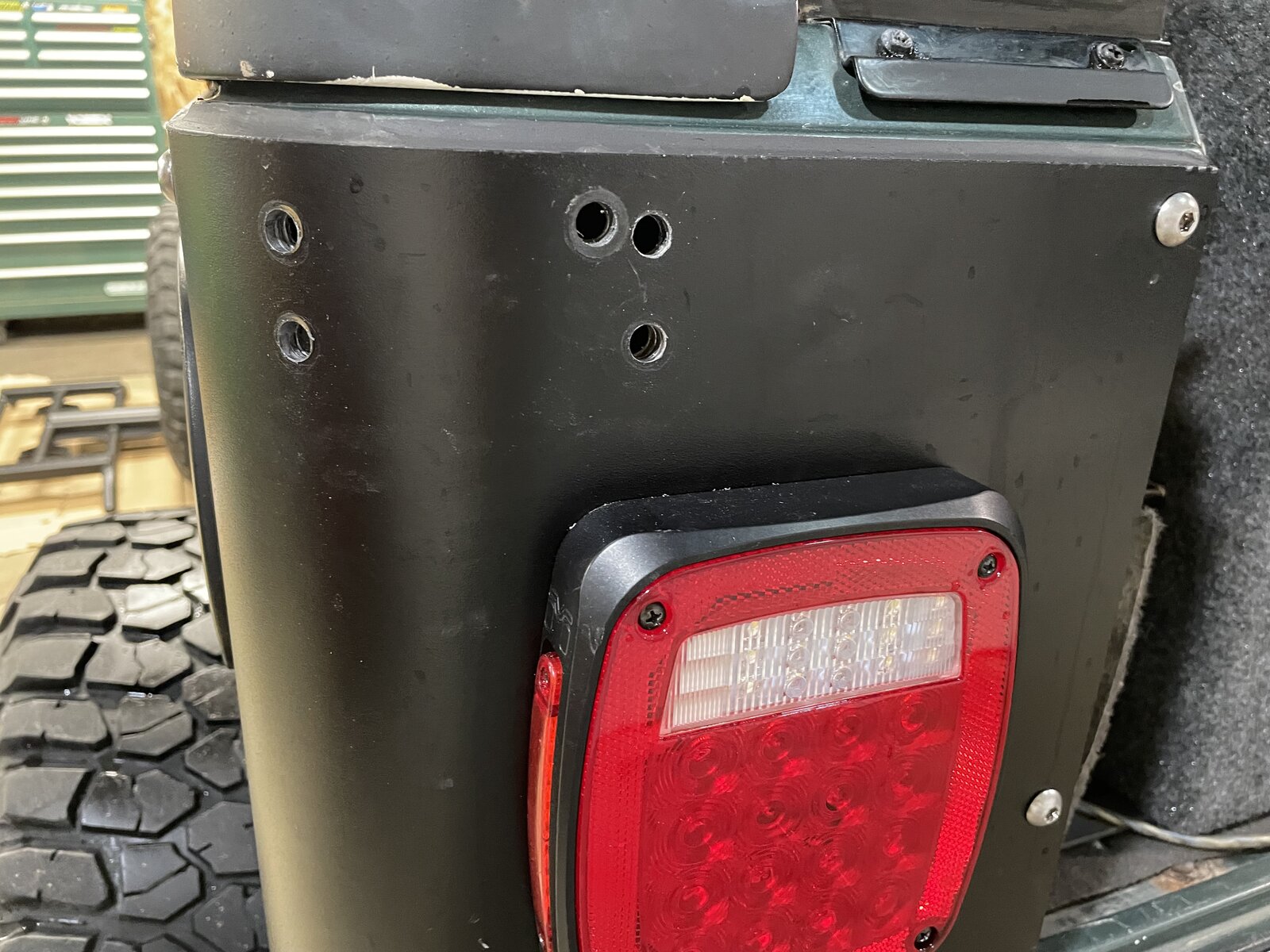

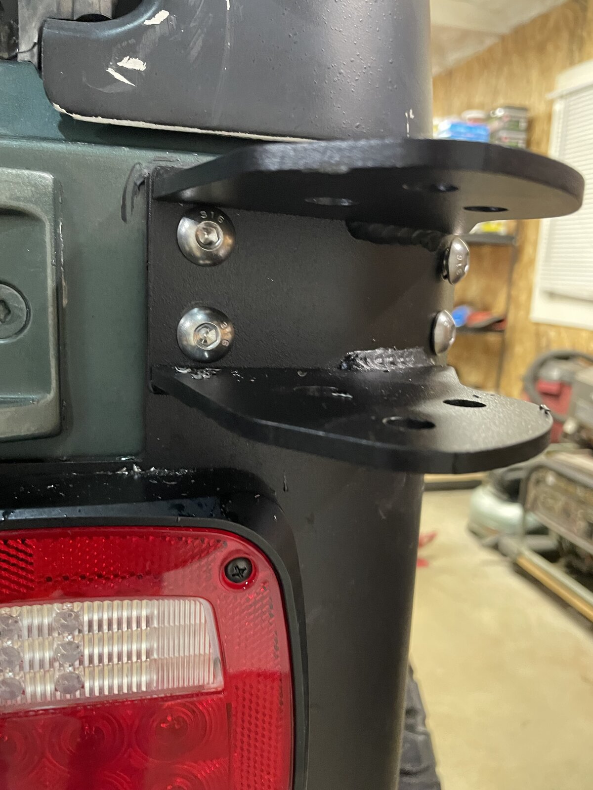

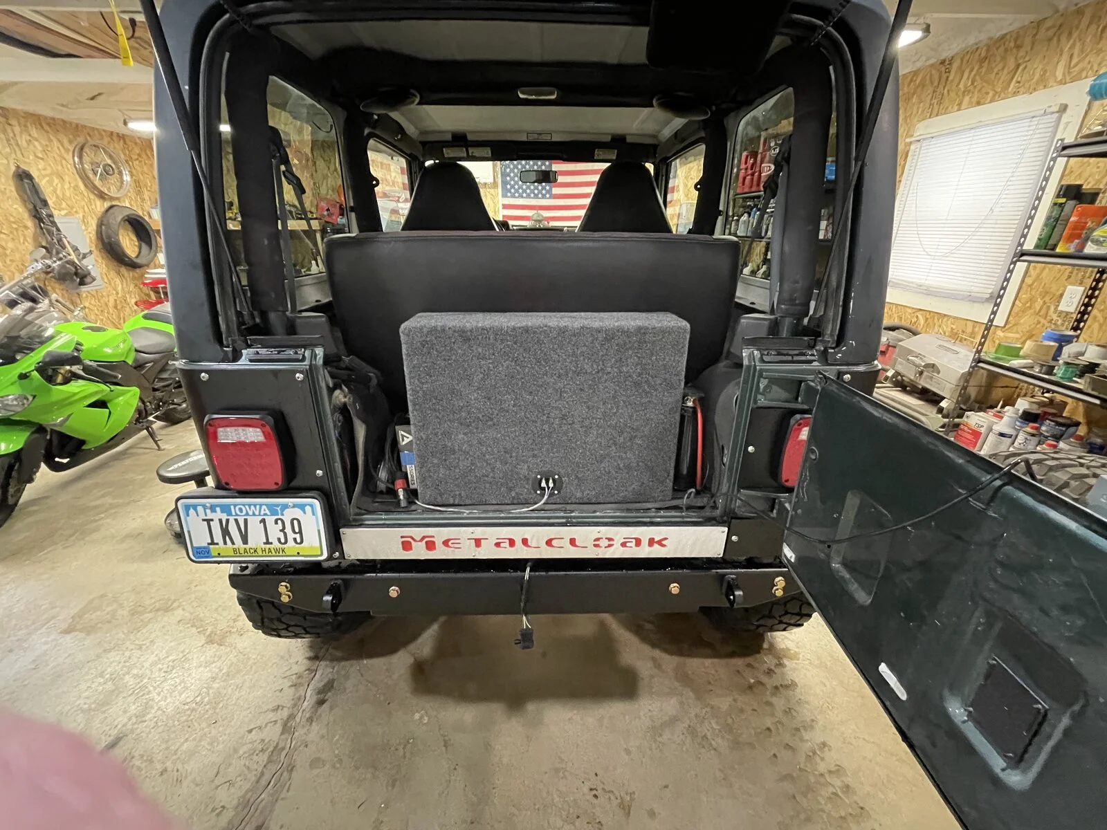

Because I can hardly walk out of the garage with only that accomplished, I decided to go ahead and start installing the tire carrier. I had to run and grab a step up drill bit and a center punch (No idea why it took me so long to buy one), but then I didn't waste any time:

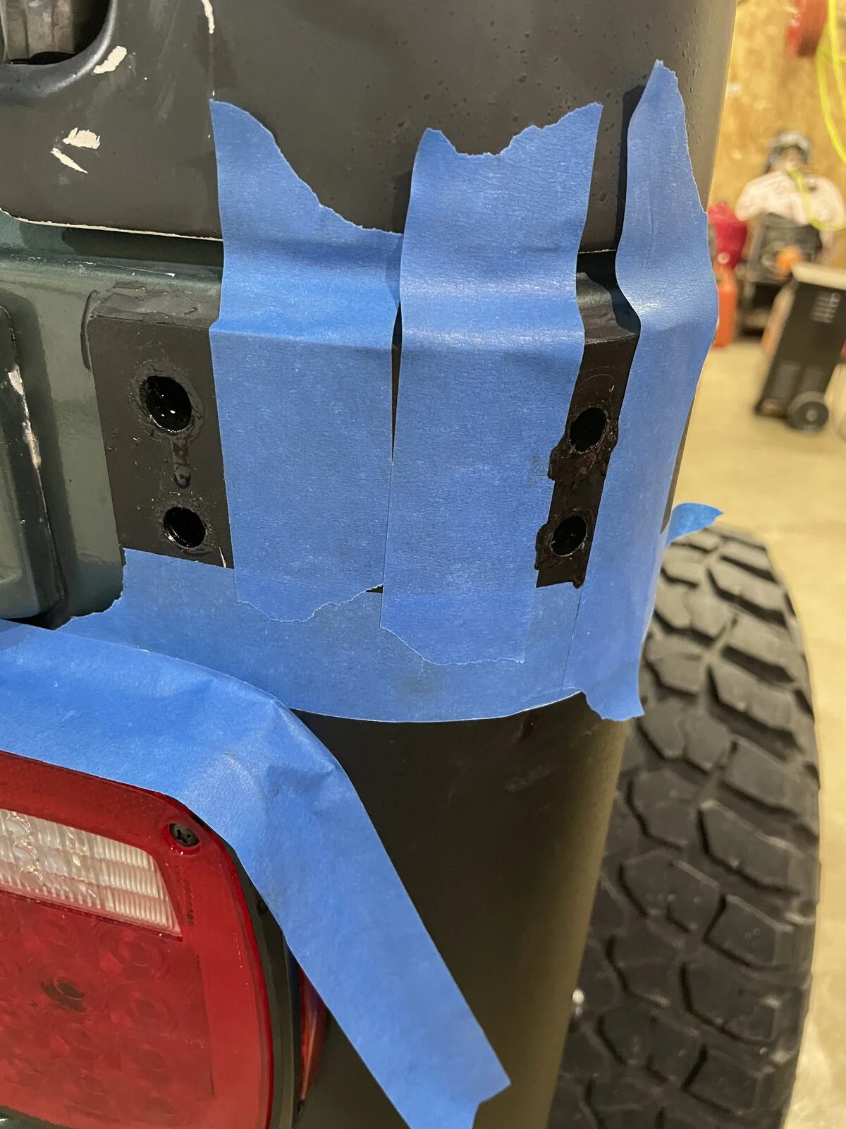

I removed the mounting bolt that was in my way, set the bracket up where it belongs, marked the holes, center punched them, and drilled them out to 3/8":

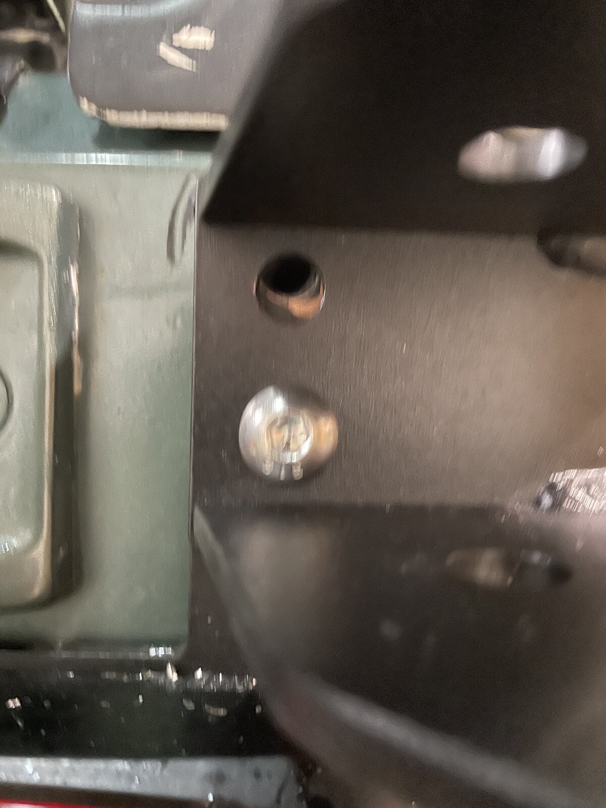

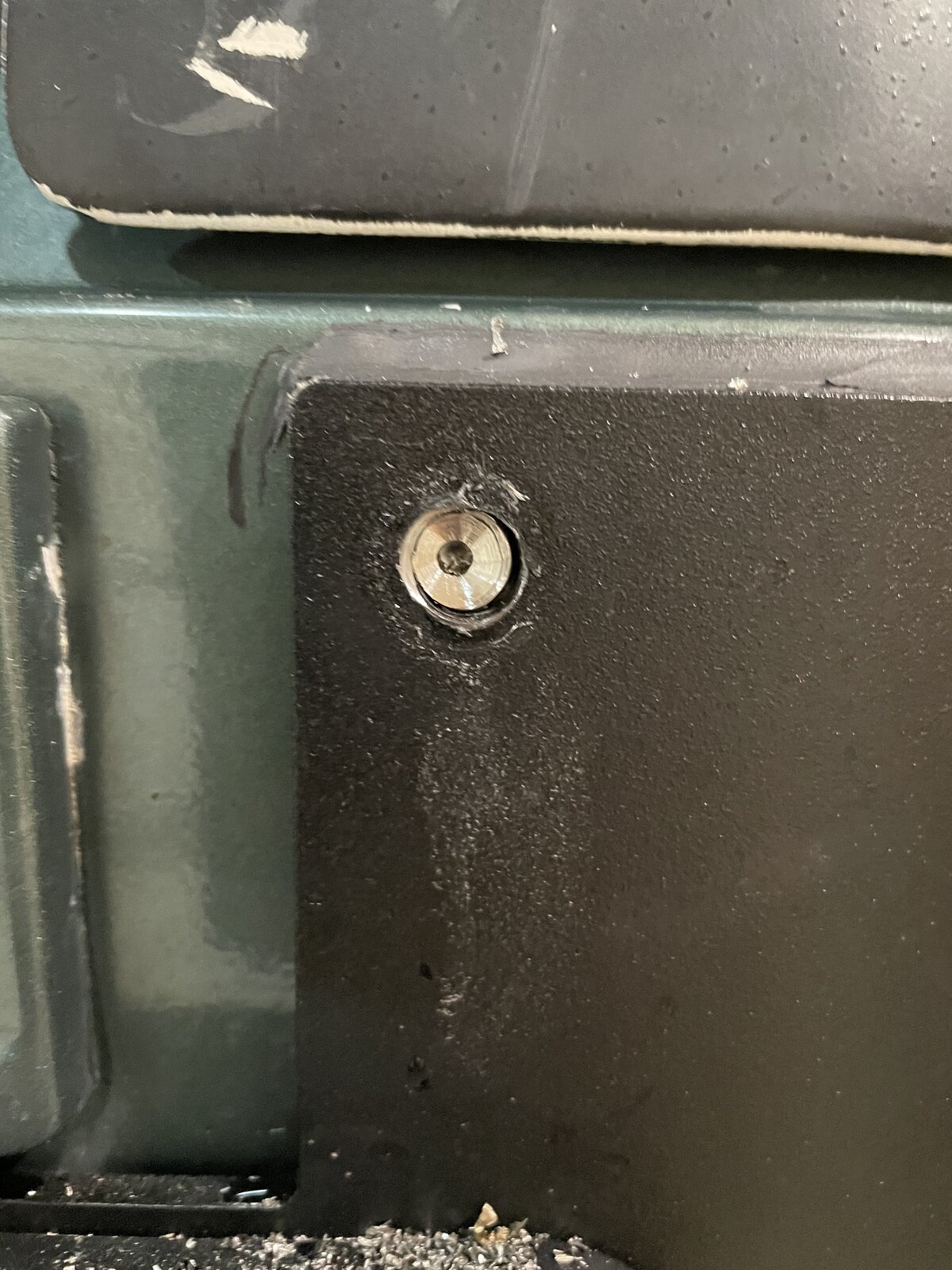

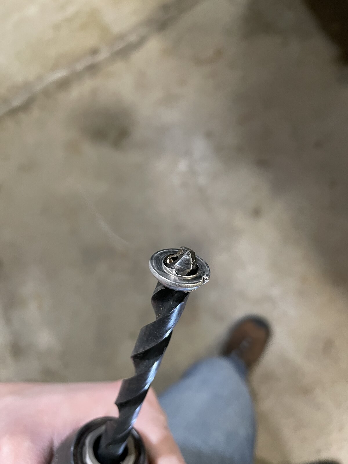

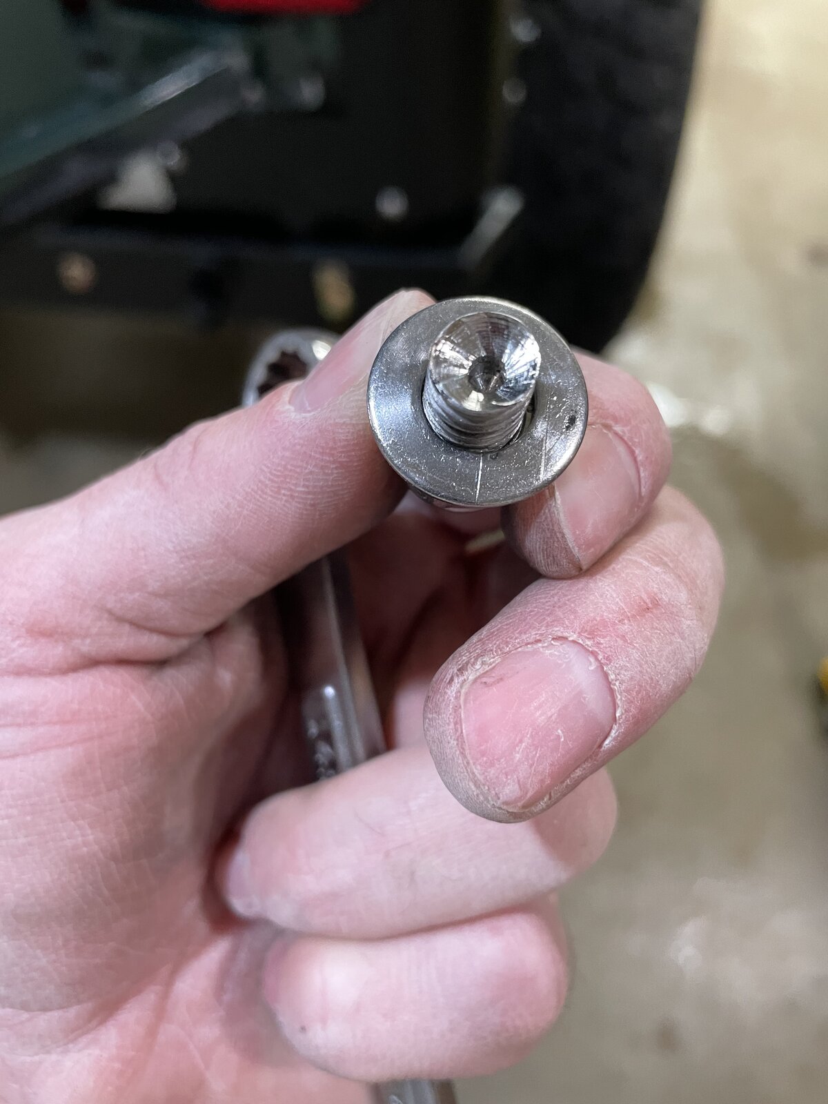

Went great. The passenger side, I wasn't so lucky. Would you believe that one of my brand new alan head bolts got stripped already trying to get it out. IDK if it just got twisted in there or what, but how annoying. Anyway, one benefit of working on Iowa jeeps, is they give you plenty of experience removing stuck hardware! I just drilled it out. It was about a 10 minute inconvenience.
I drilled out my bolt holes for the Passenger side bracket and ran into another slight problem. The corner guard bolt hole didn't quite line up right.
I just bolted up a couple of the other bolts tight and redrilled using the bracket as a guide for my drill. Worked out just fine.

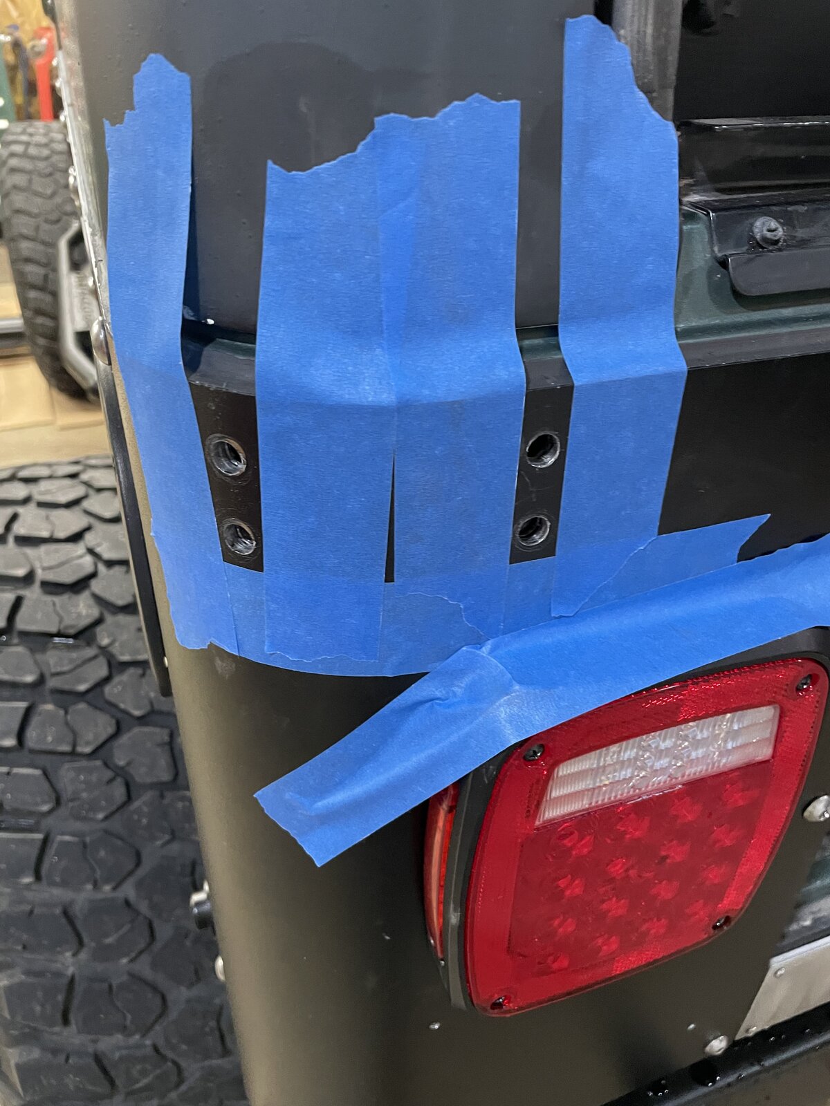

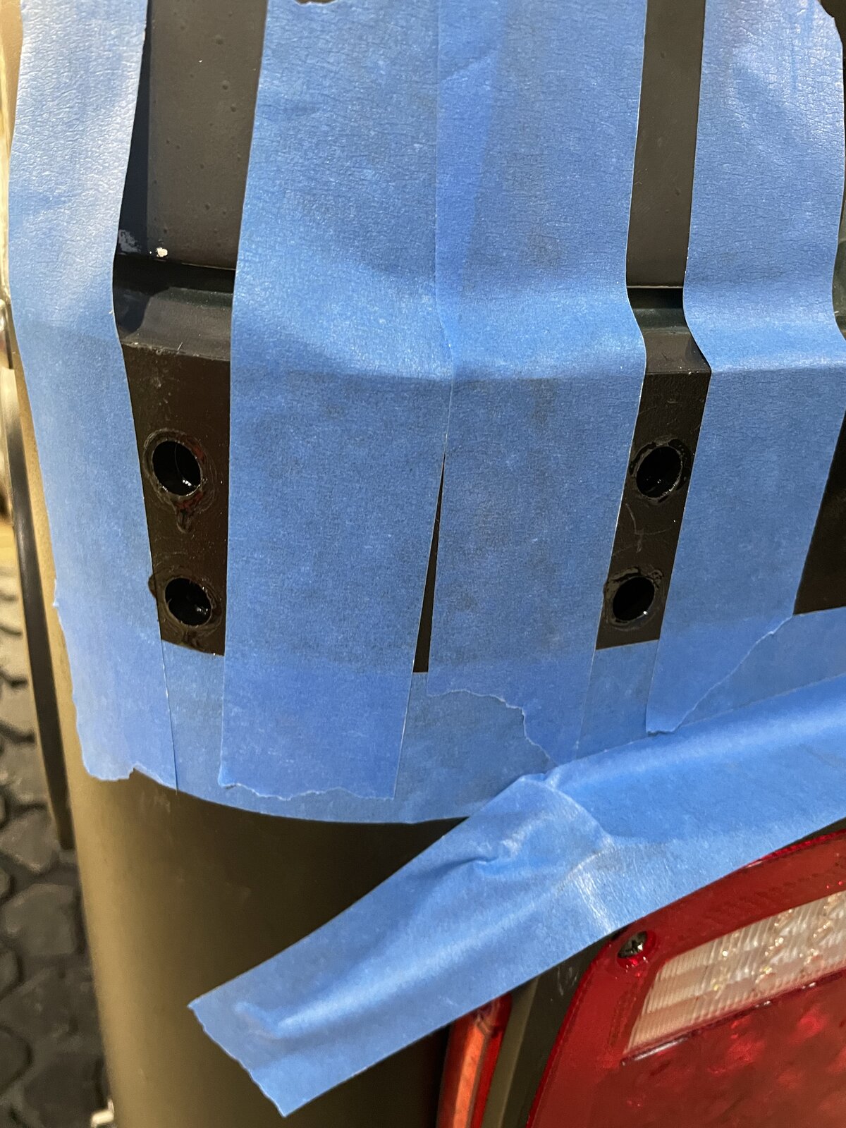

Next up, I wanted to paint the holes. I'm paranoid about rust now, so why take any chances right?
It will all be covered up with a bracket, so I didn't need to get carried away with the tape. I used a q-tip to apply some POR15.
After that, It was inside for supper while I let the paint dry. I may have it all mounted by tomorrow. We shall see!

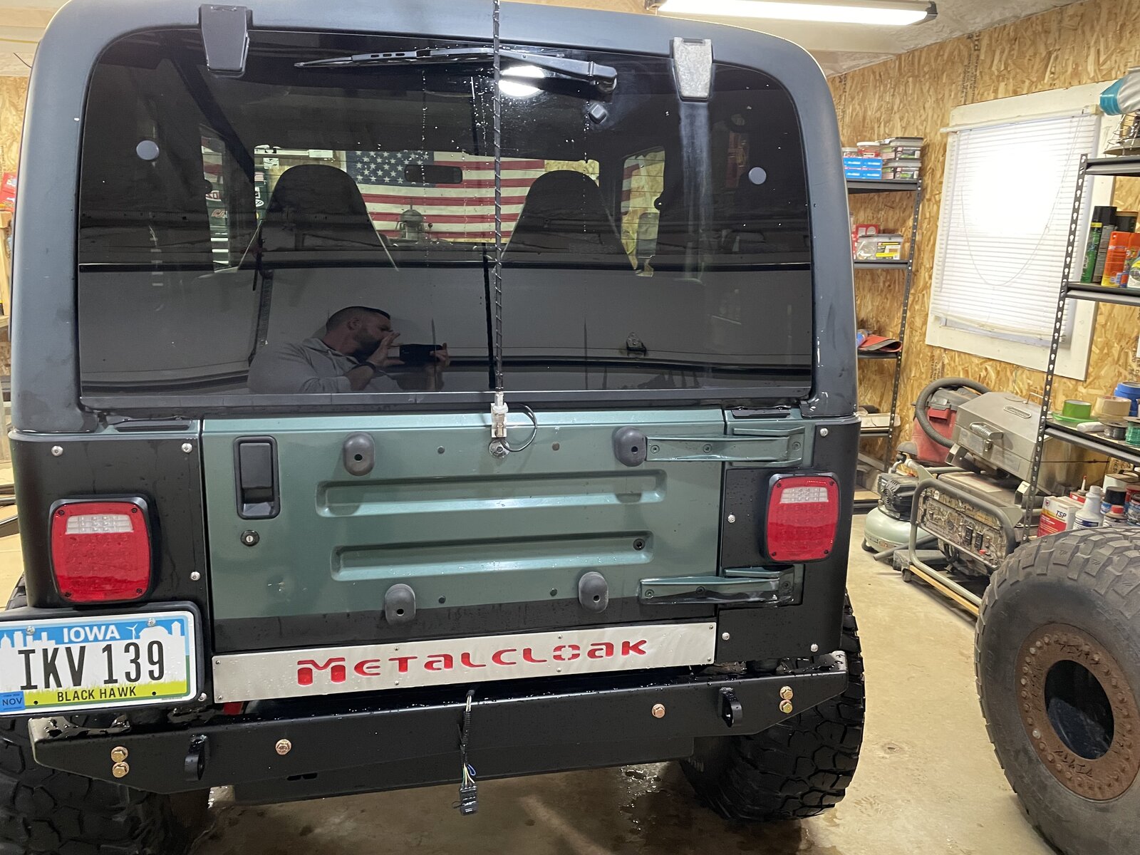

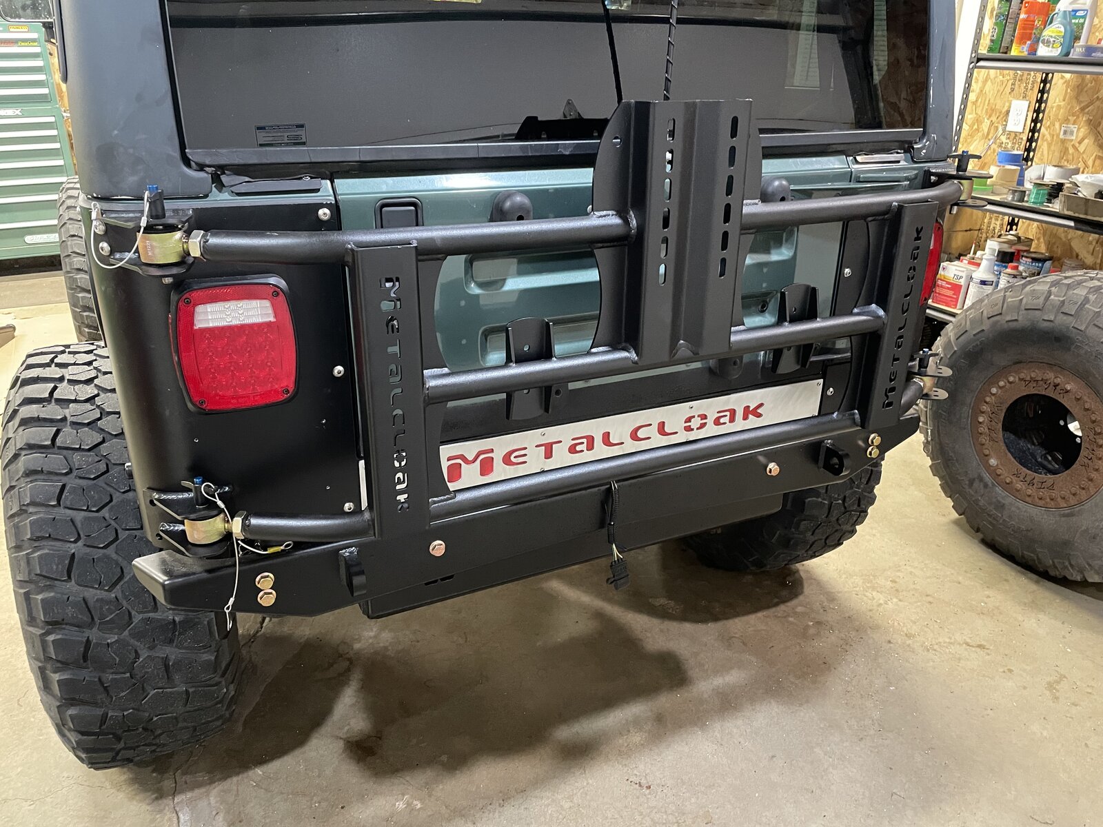

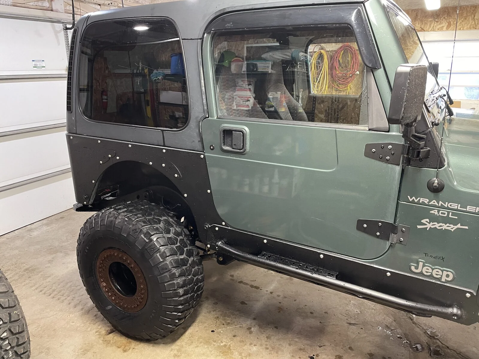

@Wildman is correct. I went with Metalcloak. I was able to get a little further on it today before I decided to call it quits for the night. I got the top two brackets installed and the tire carrier mounted. Tomorrow I'll be all set to mark and drill holes for the lower brackets. I had a hell of a time getting the pin in on the driver side, so I'm hoping it will be easy to adjust it to make it open and close without too much effort. I won't know until I get those lower two brackets bolted up.
Here is how she sits for tonight:
