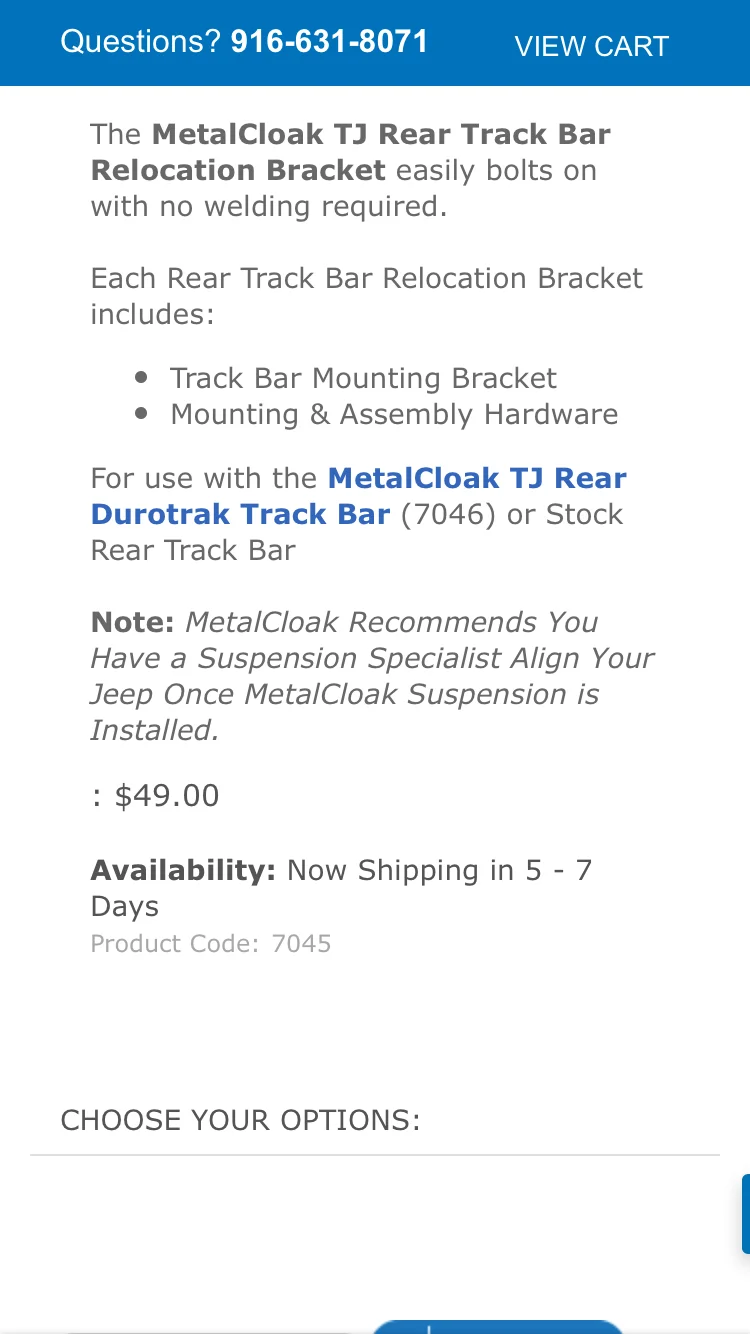

Just an update, Jeep is in the shop getting the entire clutch serviced (All parts that can be serviced that can be). I contacted MetalCloak about the rear trackbar relocation bracket making sure it will work with my lift and stock trackbar. The rep I should with said absolutely not, contrary to whats on the website I shouldn't have been able to buy just the relocation bracket. Currently waiting to hear back from one of the MetalCloak managers to purchase the rear adjustable track bar without the bracket. Morris 4x4 got back with me about the front adjustable track bar and offered to send a free Currie shirt my way to eaze the inconvenience. Started getting some regear and locker quotes from some shops locally. More to come!

They said the bolt hole size on the relocation bracket is completely different than the bolt hole size of the TB. I didn't get an exact measurement but it was off a noticeable bit.

Why did the MC rep say the rear trackbar relocation bracket won't work with the stock TB when the website clearly says it will????
Edit: sorry! I read your post more closely. Still, I hope they fix the website

The OME relocation bracket will work with the rear stockbtrackbar and you could save some coin, unless your all in for the MC
