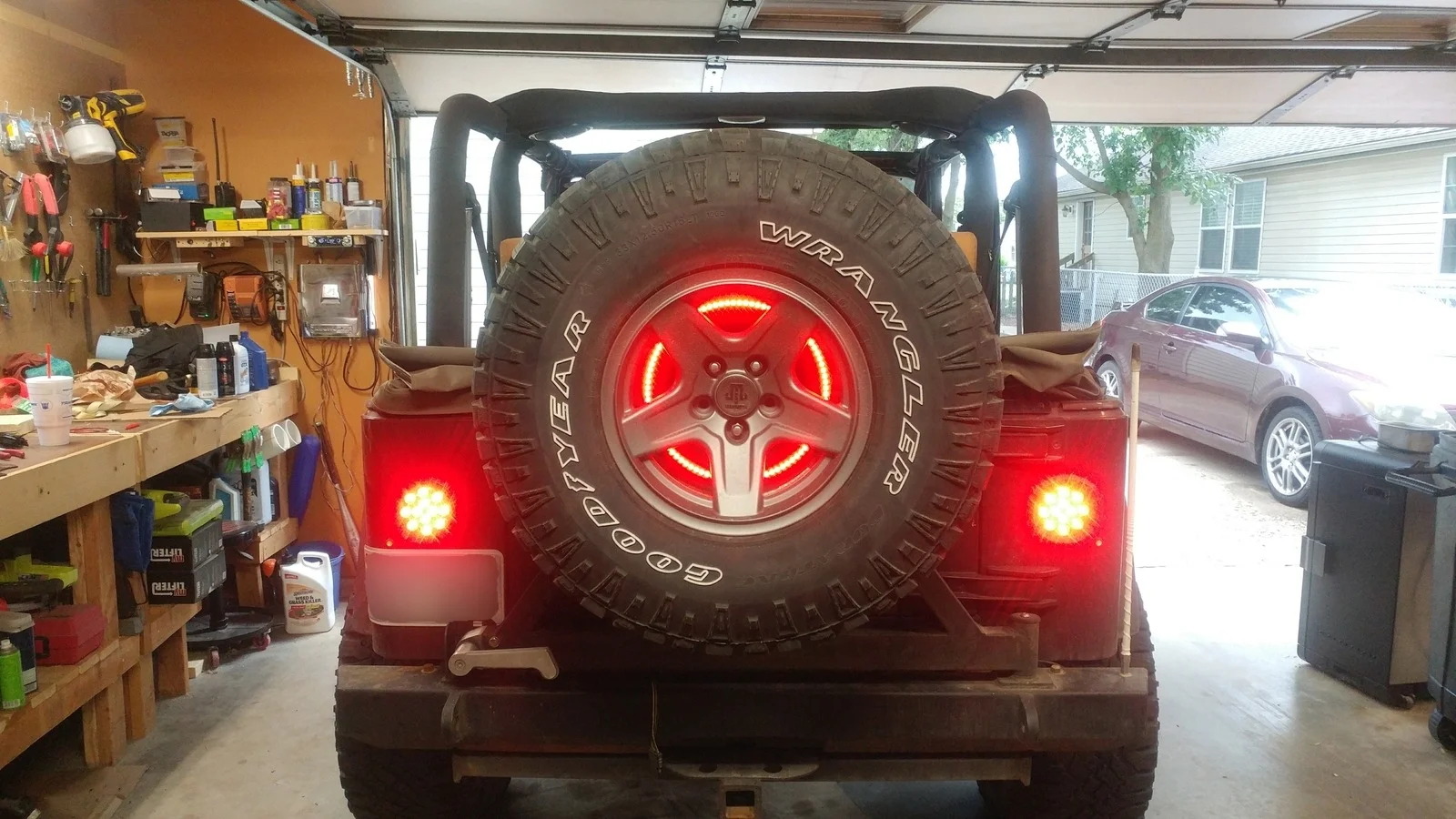

Hey everything is looking awesome! The fox shocks look killer.Can you do a write up on that third brake light? I love the way it looks, and would like to add it to my TJ thanks James!
Yes, write-up or direct to the good one!
I don't know how I failed to response to this either, sigh lol. I don't think I can share the link from the other forum, but I can post the photos and text giving all credit to the original author (Hardermods on WF):
Finished Project
This image has been resized. Click this bar to view the full image.
Items needed:
1 Side Emitting LED Strip (Red)
2 Home Depot 5 Gallon Bucket Lid
3 Clear Silicone
This is the LED strip I used, it can be cut down every 3 LEDs which is perfect because you only need to cut 3 off. There are power leads on both sides, but since you are powering with 12+volts you only need the leads on 1 side.
The slash is where you can cut them
I just drilled holes in the bucket lid, 3 in the middle for the studs on the spare tire bracket and 1 at the bottom edge for the wires on the led strip ( you can kinda see that hole on the right hand side of the lid)
Feed the wires of the strip through the hole on the edge of the bucket lid
I put a dab of silicone every couple of inches in the groove of the lid, might not be needed but I like the reassurance of it. The only place it is truly needed is at the end, where you cut the 3 leds off needs to be resealed, so I filled the groove then pushed the end into it. Sorry no pic of that.
Here is how the LEDS fit in the groove of the lid.
I hard wired mine, then put the lid on the tire mount, put the spare back on and tighten down the lug nuts.
If you want to be able to remove it without cutting wires you could pick up some waterproof 2 wire connectors, then put them in line.
Deutsch Connector You need a crimper for these, listed below
Deutsch Crimper
@Mr.Maim Found these which are also a great alternative if you do not wish to buy the crimper needed for the ones I mentioned.
2 Wire Waterproof Connector
I try to give credit where credit is due, epic third brake light mod. Plenty of light at night and not that expensive. I'll try to pay closer attention in the future so I don't take days to answer questions lol.
